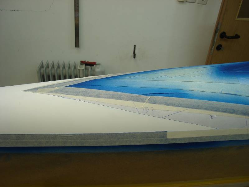

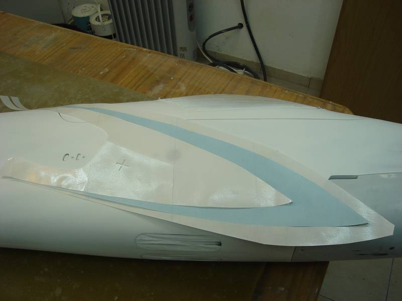

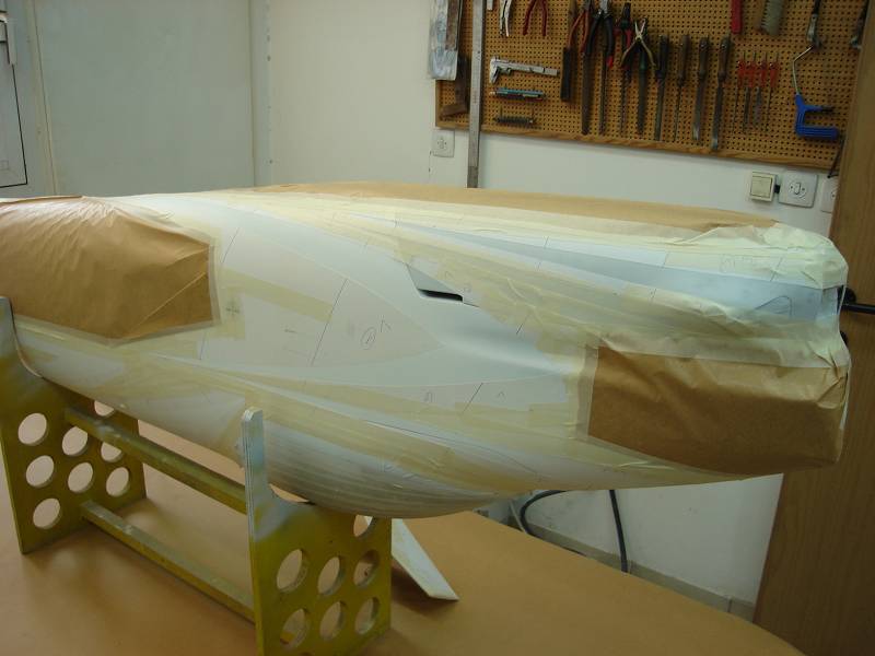

Covering before painting.

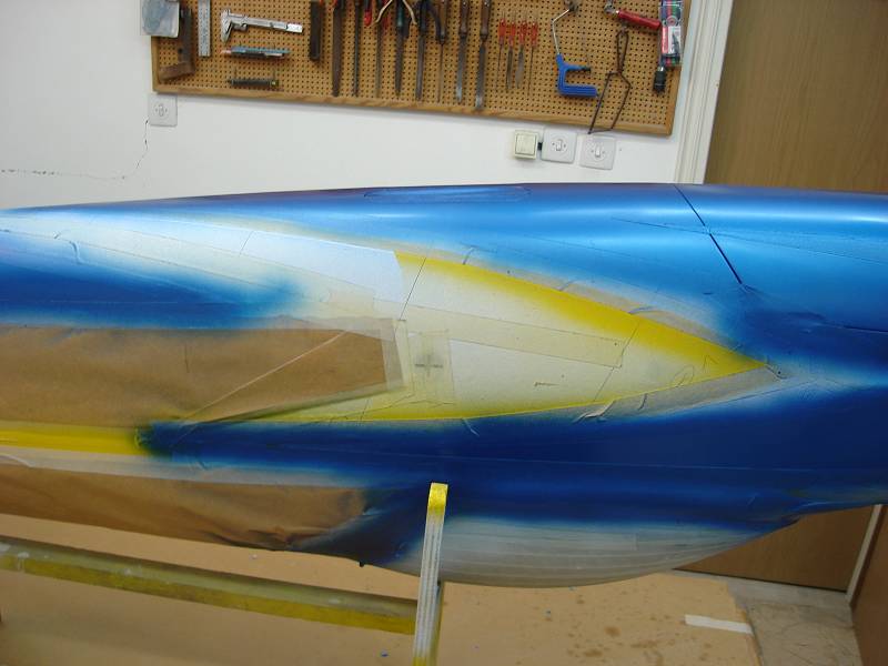

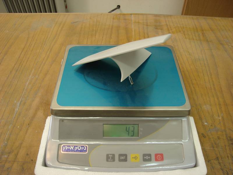

Step 1 = Light grey coat
This color makes small holes and small defects more visible and save coats (weight) with the darker colors.

Weights after step 1 = 903+159+72+43+32=1,209 gram
Step 1 = 50 gram (1,209-1,159)

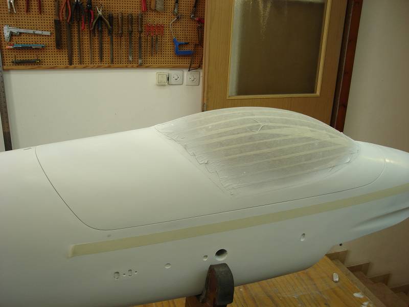

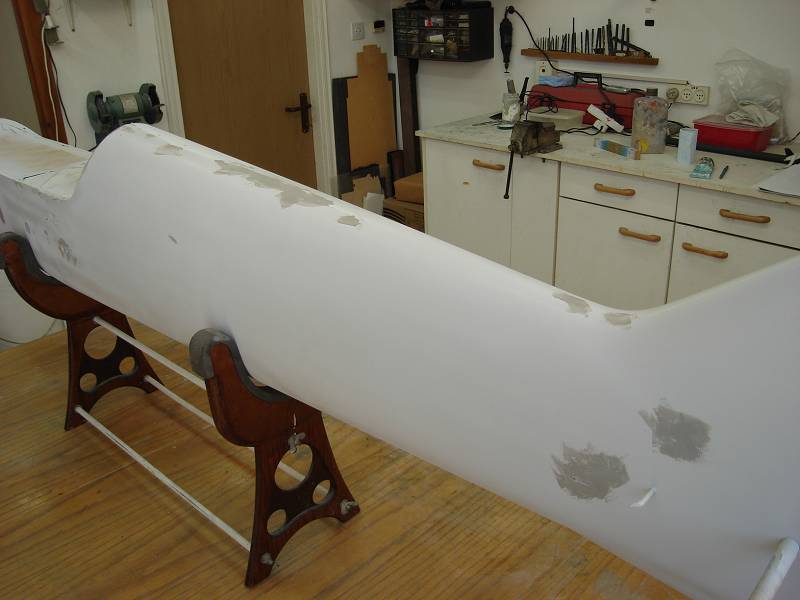

Old 02-12-2008 | 05:01 PM
  #232
najary's Avatar
Joined: May 2003
Posts: 1,201
Received 37 Likes on 32 Posts
From: Ramat Hashrone, ISRAEL
Default RE: Electric Osmose Building

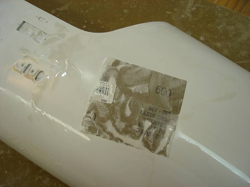

Step 2 = Applying car-kit and sanding.

Weights after step 2 = 893+158+71+42+31=1,195 gram
Step 2 = -14 gram (1,195-1,209)
Total weight from step 1 till step 2 = 1,195-1,159=36 gram.

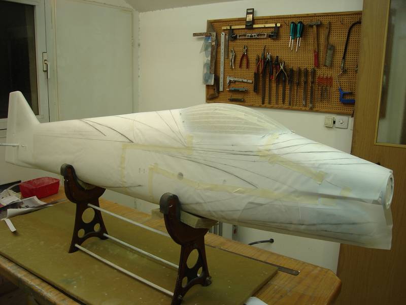

Old 02-16-2008 | 12:16 PM
  #234
najary's Avatar
Joined: May 2003
Posts: 1,201

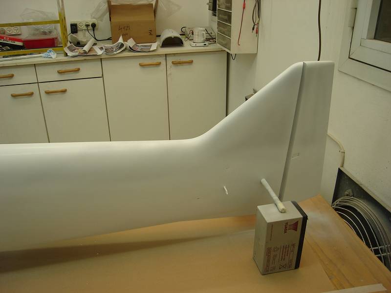

Step 3 = White coat and sanding.

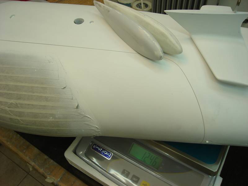

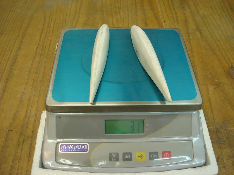

Weights after step 3 = 1,246 gram
Step 3 = 51 gram (1,246-1,195)
Total weight from step 1 till step 3 = 1,246-1,159= 87 gram.

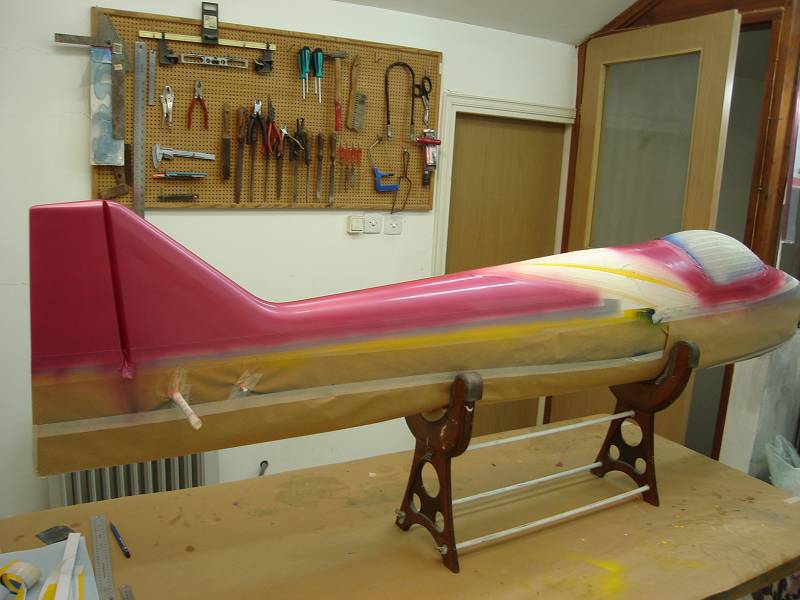

There will be a small delay in the Osmose Building as I went down to the studio today to get Issac paint my new wheel pans.
See profeesional at work.
Amram

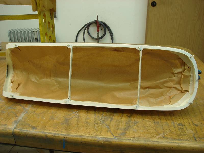

Old 02-18-2008 | 03:54 PM
  #240
najary's Avatar
Joined: May 2003
Posts: 1,201

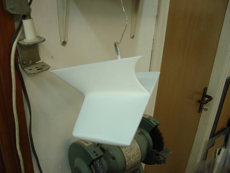

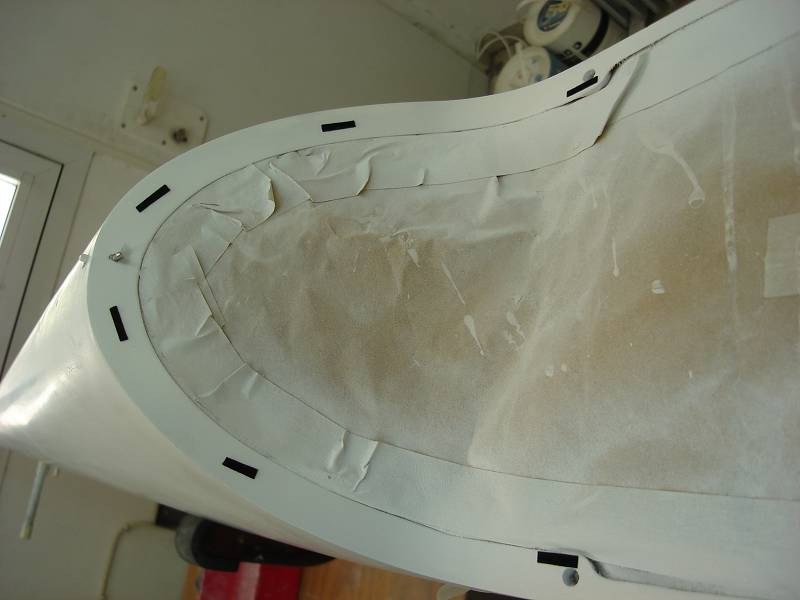

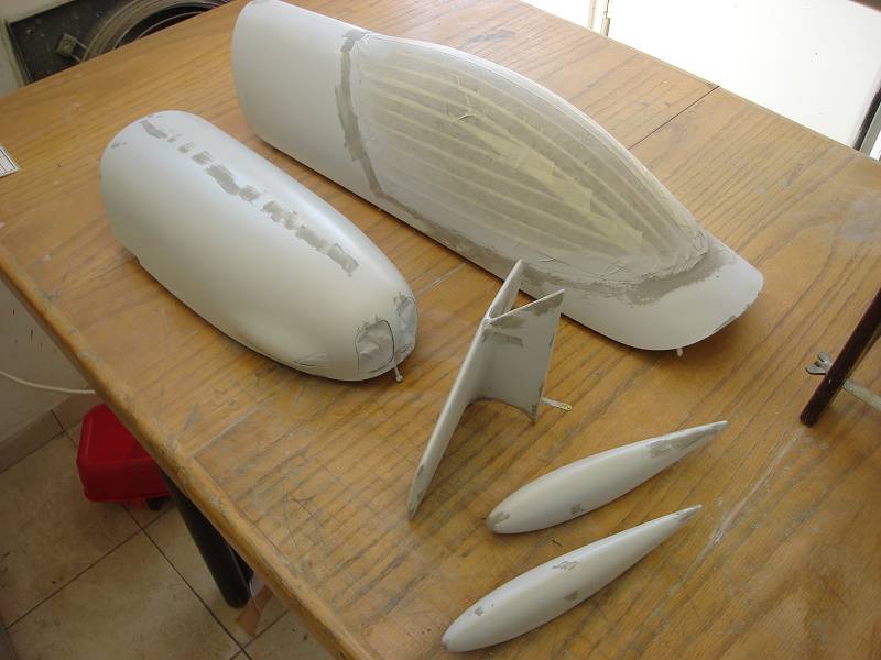

Step 4 = Assembling the canopy and the belly pan.

Step 5 = Drawing the scheme on transparent drawing paper.

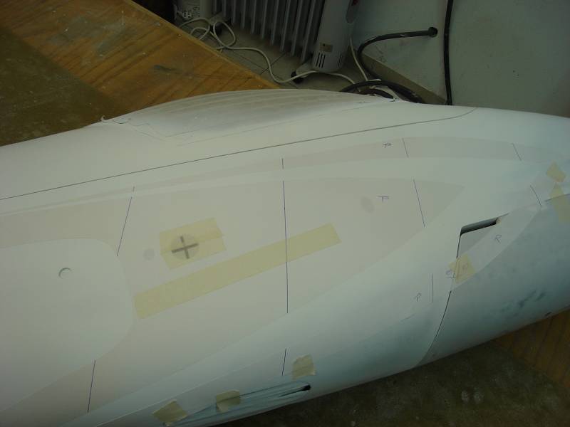

Old 02-19-2008 | 05:16 AM
  #242
jnp
Joined: May 2006
Posts: 44
From: Johannesburggauteng, SOUTH AFRICA
Mmmmm .......not the way to do it Isaac !! How about giving Amram the spraygun and teach him to spray paint . I am sure the paint will run once ....he will have enough time to figure out what went wrong whilst sanding it out and it will never happen again .......and best of all you can continue with your work !
Old 02-19-2008 | 05:38 AM

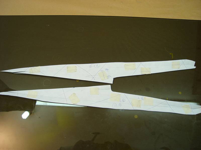

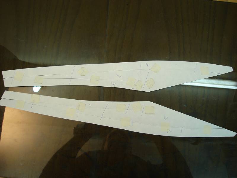

Step 6 = Preparing Bristol paper patterns.

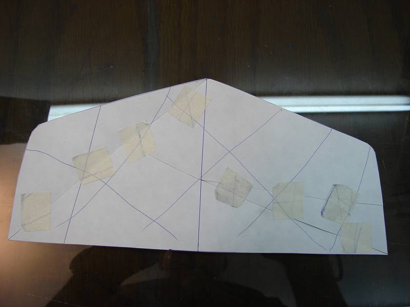

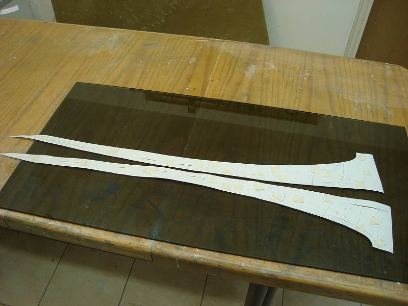

Step 7 = Preparing patterns made of perforation paper, (right and left).

Step 7 = Painting yellow.

Step 8 = Painting the other colors.

Step 9 = Paint repairs.

Step 10 = Smoothing the seams between the colors.

Weights after step 10 = 1,271 gram
Step 4-10 = 25 gram (1,271-1,246)
Total weight from step 1 till step 10 = 1,271-1,159= 112 gram.
