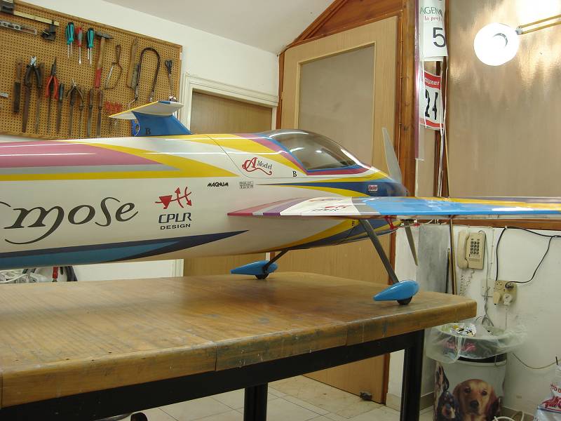

OK, your work shop is entirely too clean !!!

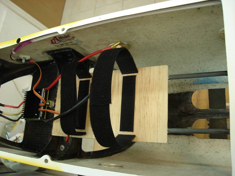

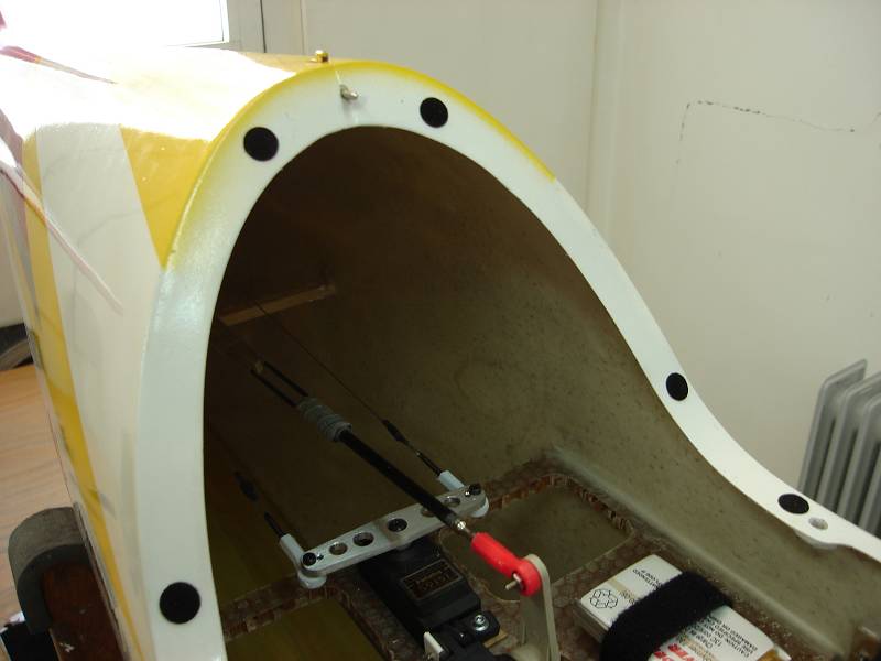

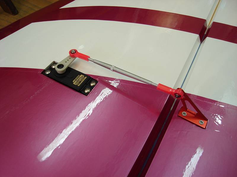

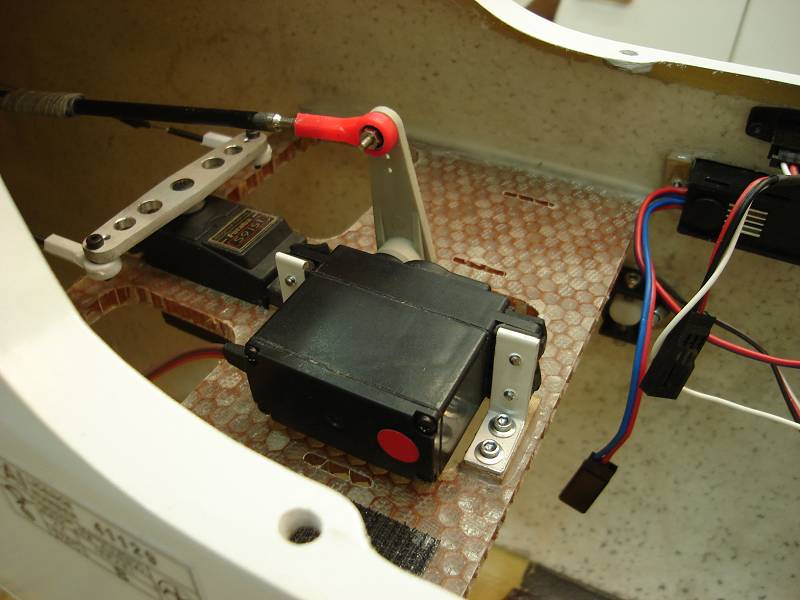

Hi,
Why so big elevator servo arm?
Old 02-29-2008 | 12:17 PM
  #281
My Feedback: (25)
Posts: 1,579
Default RE: Electric Osmose Building

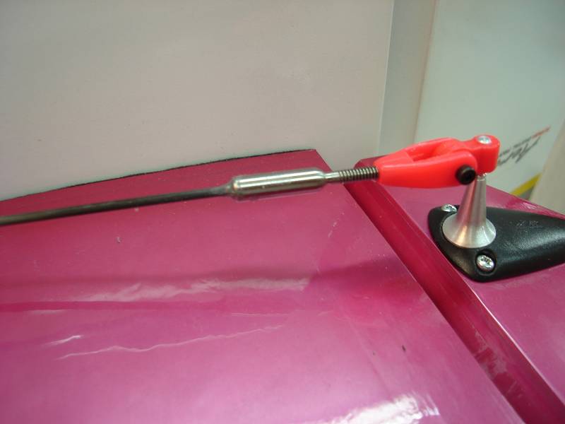

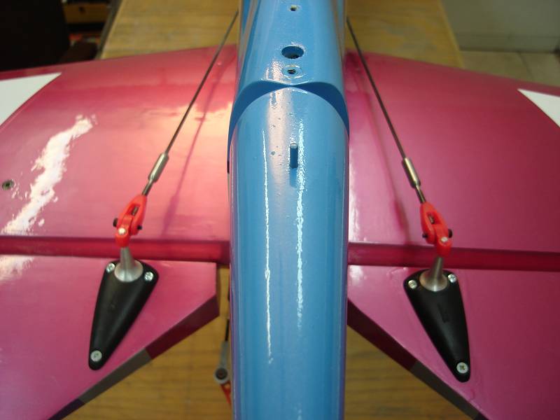

Isaac,
Who makes that pushrod that you have on your ailerons? I like that.
Ryan
Old 03-01-2008 | 02:07 AM
  #282
najary's Avatar
Joined: May 2003
Posts: 1,201
Received 37 Likes on 32 Posts
From: Ramat Hashrone, ISRAEL
ORIGINAL: Ryan Smith
Isaac,
Ryan
Hi Ryan
MK makes that, It is the lightest pushrod I know.
Regards,
Isaac Najary

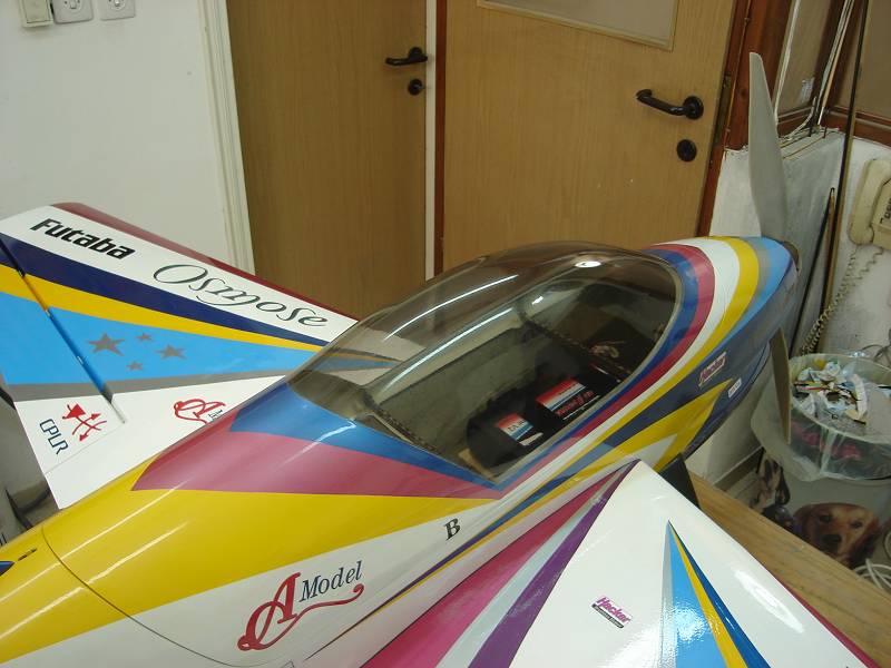

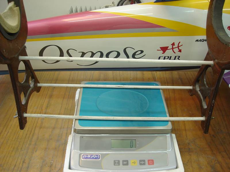

Old 03-01-2008 | 12:31 PM
  #283
Joined: Sep 2004
Posts: 1,199
Received 47 Likes on 24 Posts
From: placentia, CA

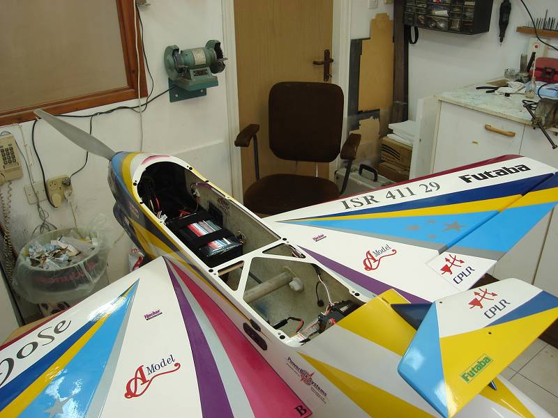

Hi Isaac,
Great looking build, nice job. What is your latest weight estimate for this?
Steve

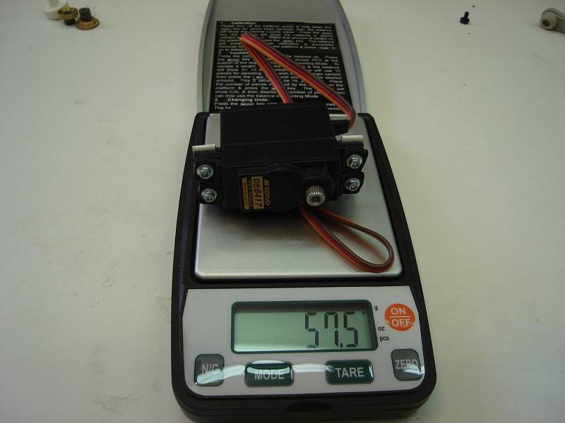

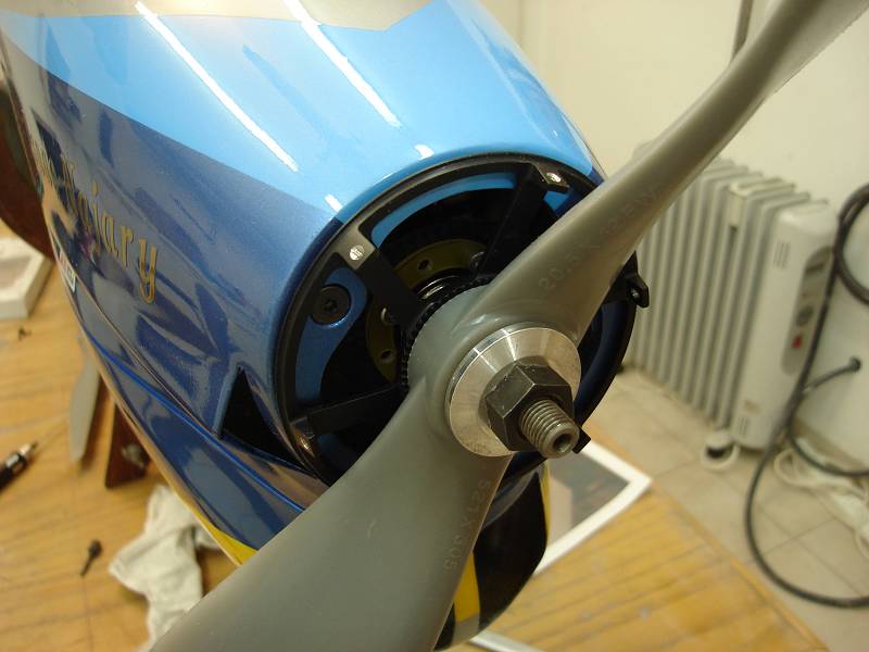

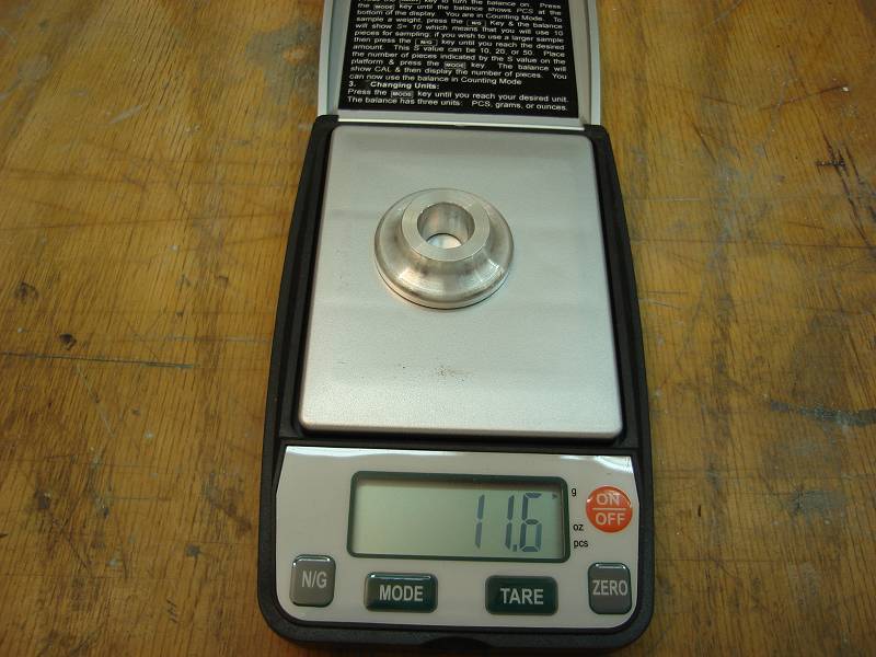

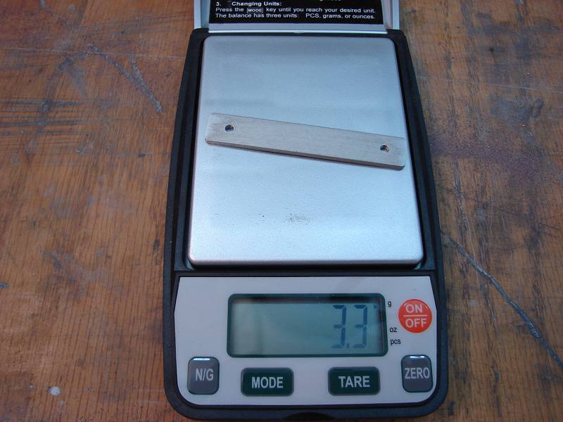

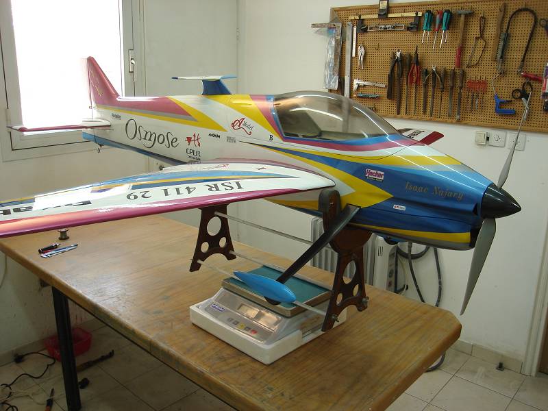

Old 03-01-2008 | 07:02 PM
  #284
najary's Avatar
Joined: May 2003
Posts: 1,201

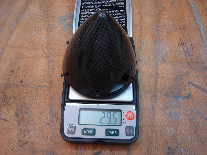

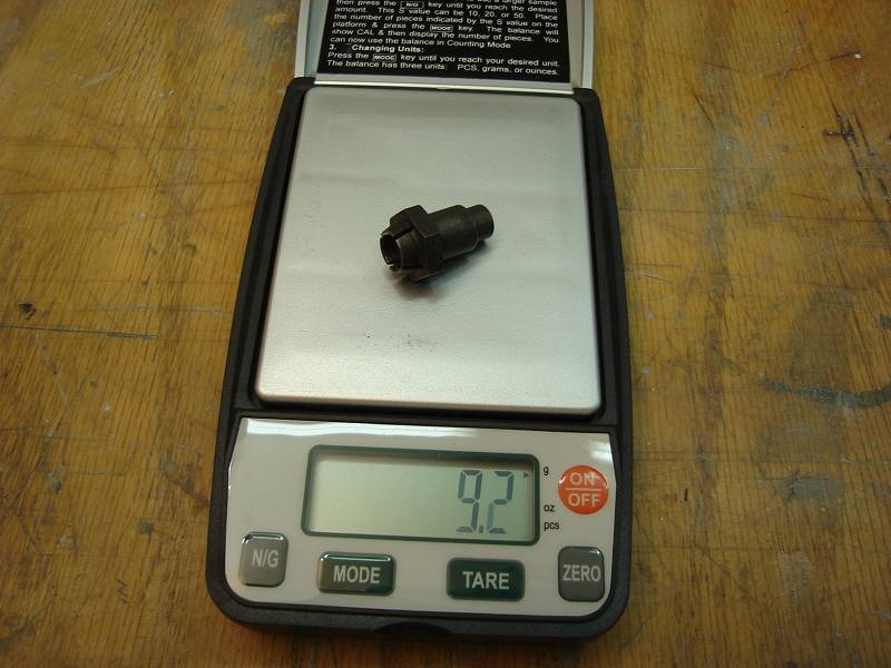

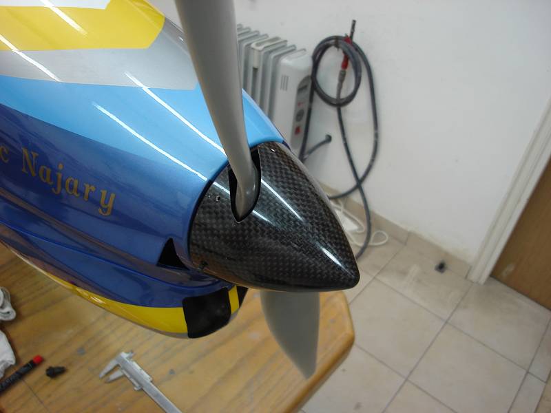

Spinner - 17.9 gram (29.5-11.6).
Or 8.7 gram ? (17.9-9.2)[:-]
It almost have no backplate so I think maybe it is possible that some of the airflow from the prop root will help cooling the motor ?
Isaac Najary
ORIGINAL: Nickolas
Hi,
Hi Nickolas
You definitely right, it will be replaced.
Isaac Najary

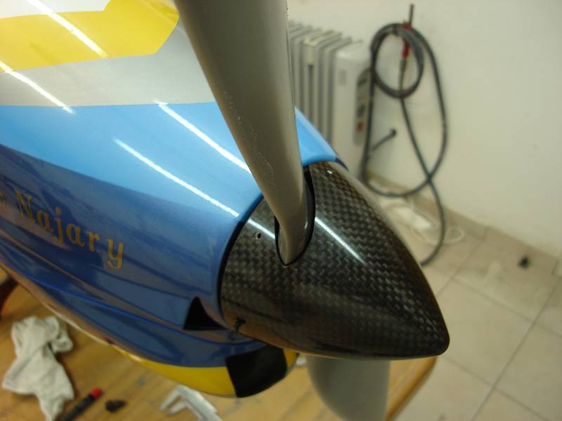

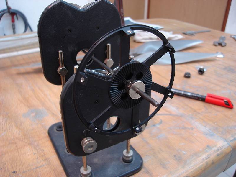

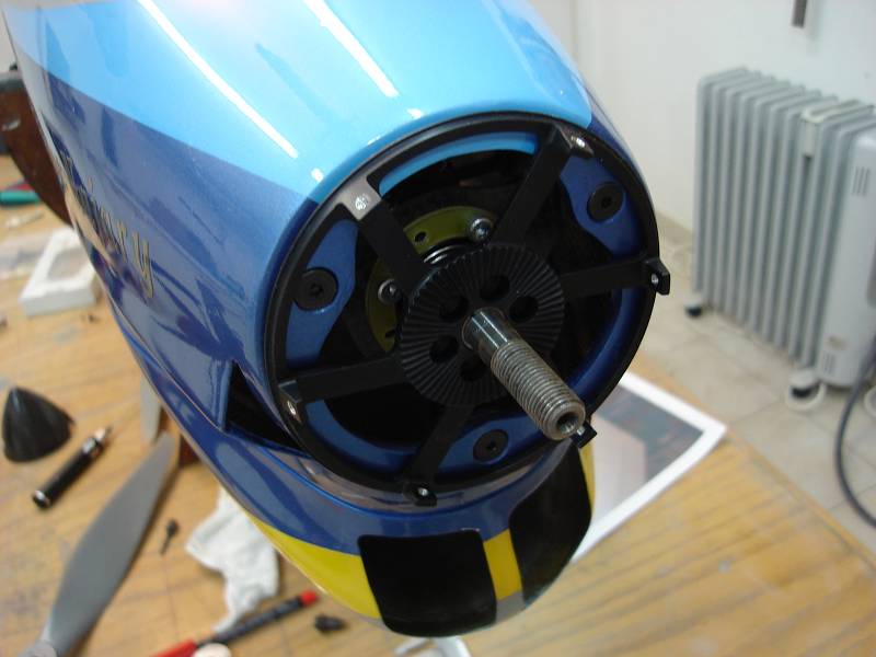

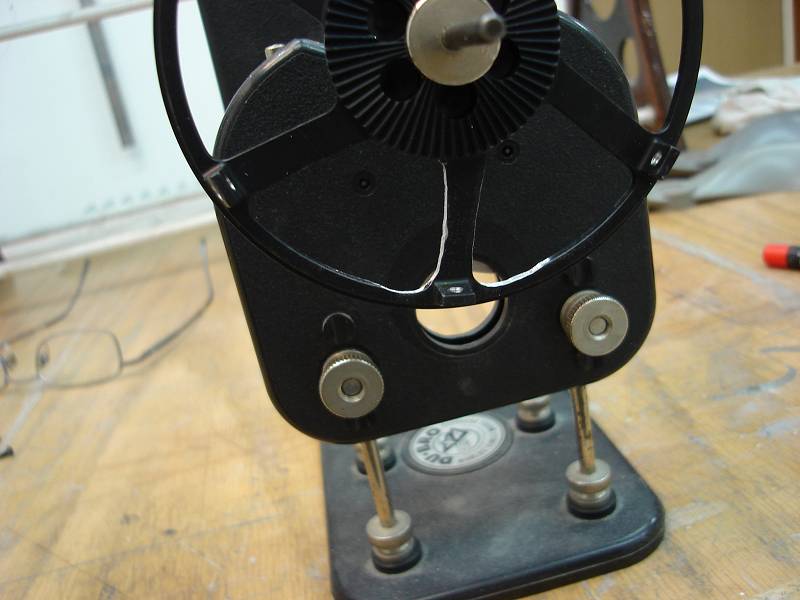

Old 03-01-2008 | 09:02 PM
  #288
Joined: Feb 2005
Posts: 1,081
From: oakland, CA

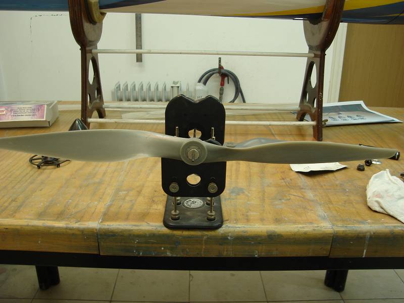

Issac,
Great build thread.

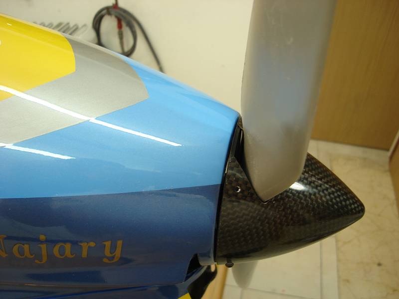

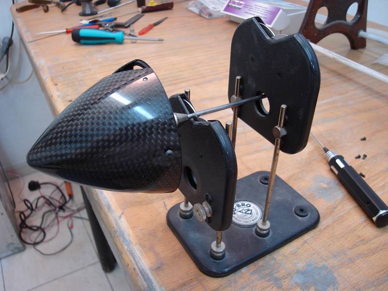

How do you balance your spinner? Did you separate the back plate from the spinner cone? How can you tell it's out of balance, and what can you do to fix the problem?
Thx,
Adrian
Old 03-02-2008 | 12:40 PM
  #289
najary's Avatar
Joined: May 2003
Posts: 1,201
ORIGINAL: riot3d
Issac,
Great build thread.
Thx,
Adrian
Hi Adrian
1. Separate the back plate from the spinner come.
2. Check the back plate for inbalance, sharpen useing a file on the heavy side for balancing.
3. Assemble the spinner come and check for inbalance, use sandpaper in the inside of the spinner come if necessary.
Regards,
Isaac Najary

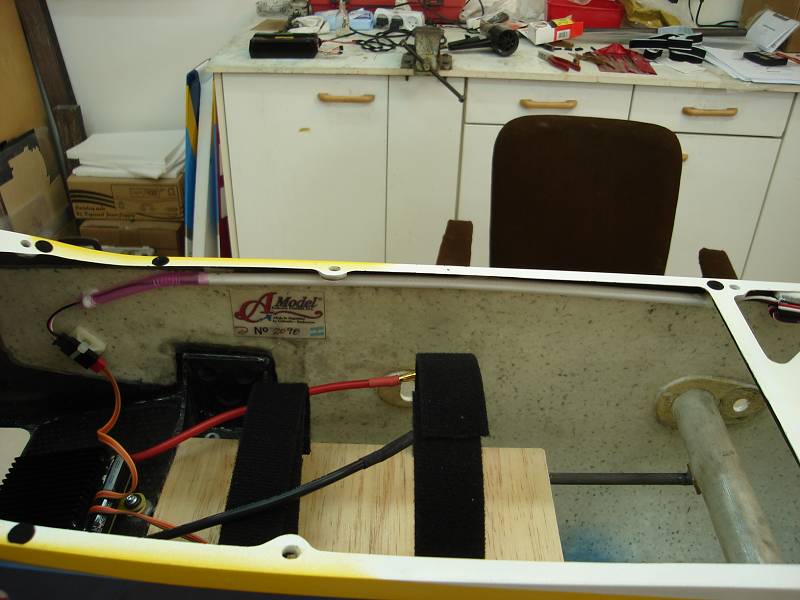

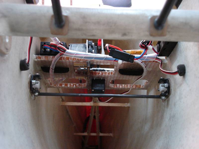

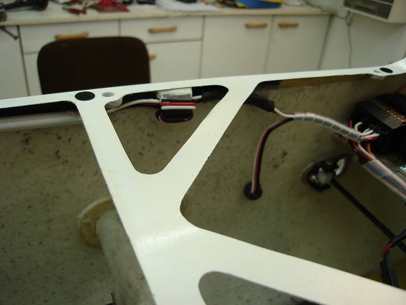

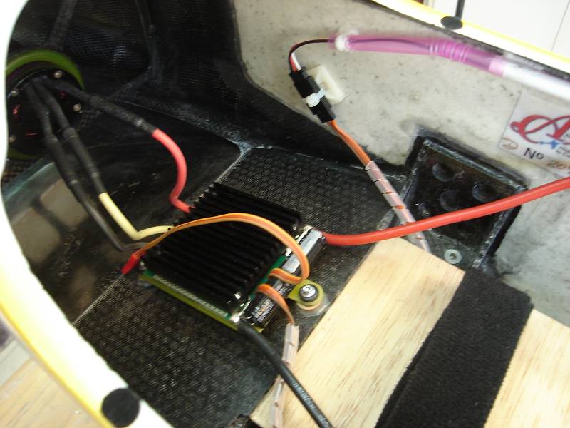

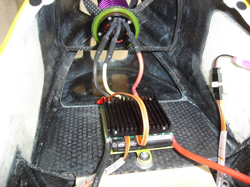

Hi Isaac,
I spoke with some of the electric guys here and they advised me to put a ferrite ring between my JETI Spin ESC and the receiver throttle channel...
I can't see one in your pictures so i just thought it was worth mentioning.
best wishes
David
Old 03-04-2008 | 11:14 AM
  #295
Dave Kelly's Avatar
Joined: Jul 2003
Posts: 137
From: Edinburgh, UNITED KINGDOM
Isaac,
Sorry i missed it..i see you have one fitted.
best wishes
David

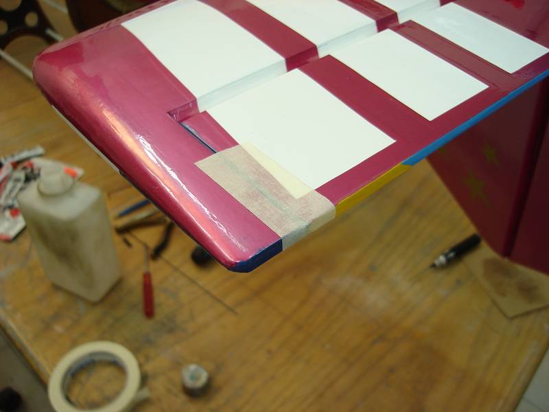

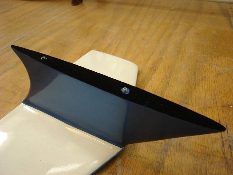

Final assembling
ID:	894831   Click image for larger version
ID:	894832   Click image for larger version
ID:	894833   Click image for larger version
ID:	894834   Click image for larger version
ID:	894835   Click image for larger version
ID:	894836   Click image for larger version
ID:	894837   Click image for larger version
Old 03-04-2008 | 04:18 PM
  #298
najary's Avatar
Joined: May 2003
Posts: 1,201
Final weight = 4,864 gram.
ID:	894851   Click image for larger version
ID:	894852   Click image for larger version
