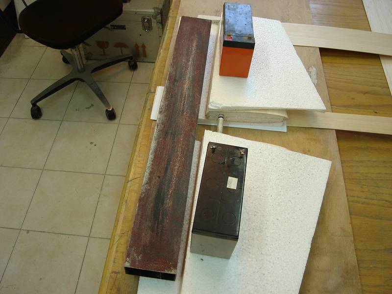

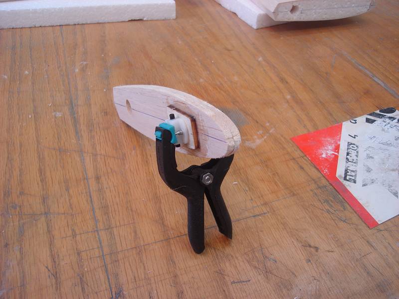

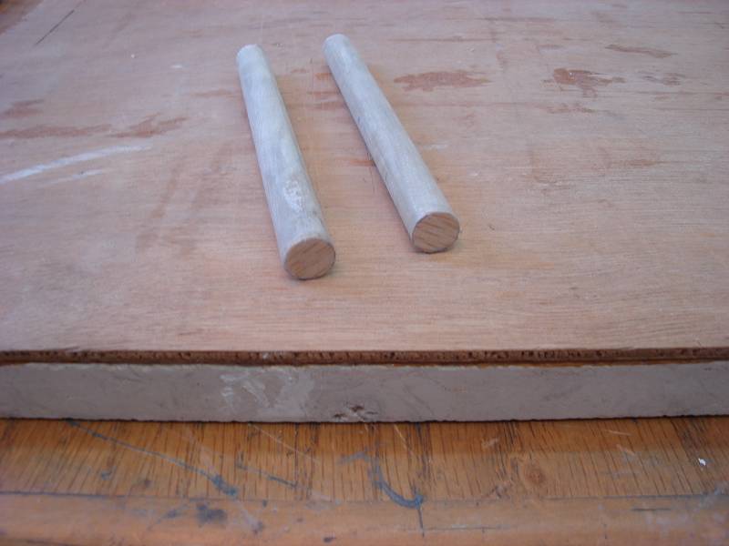

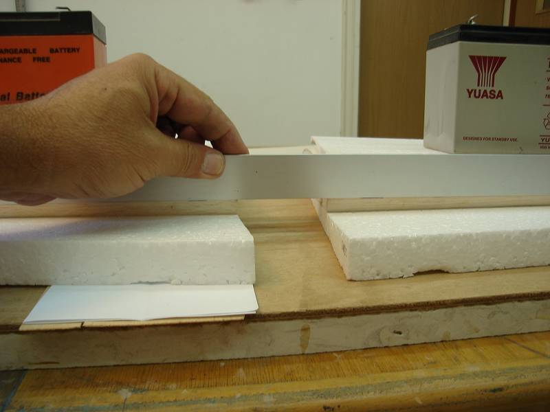

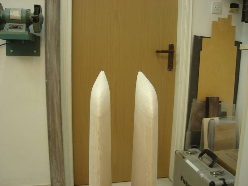

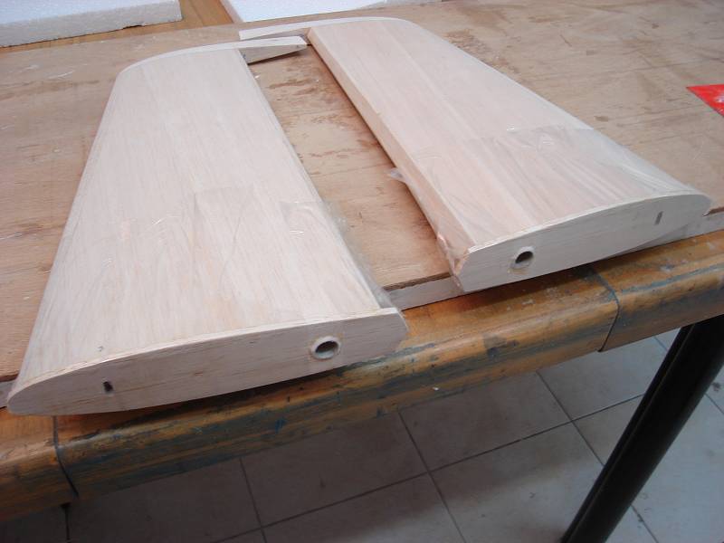

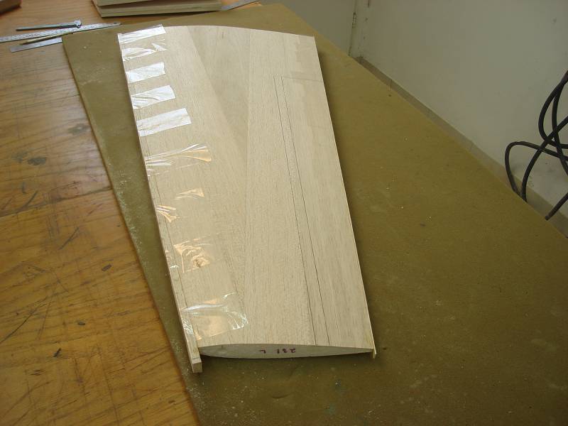

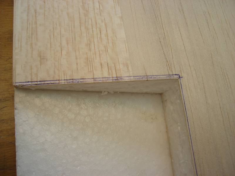

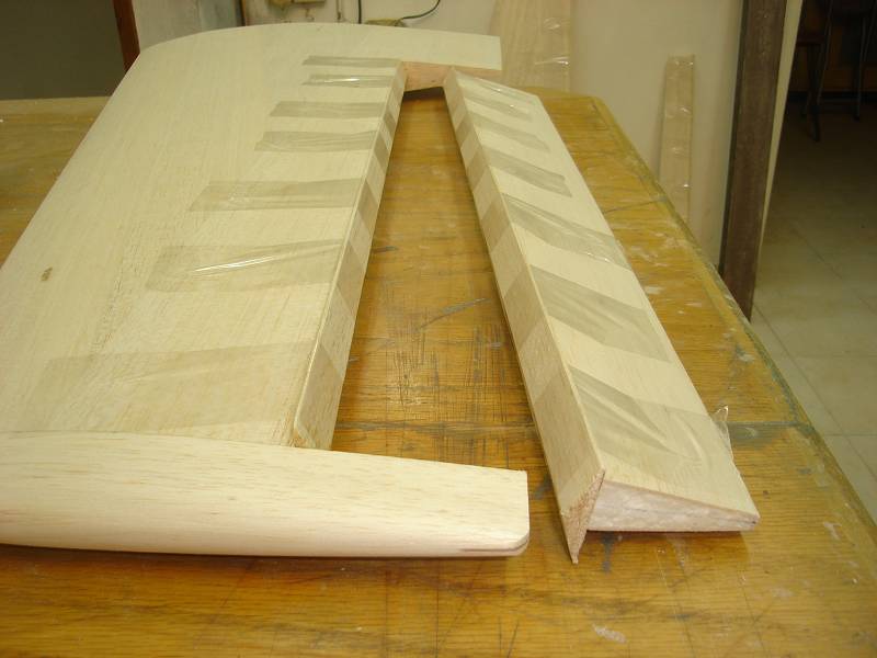

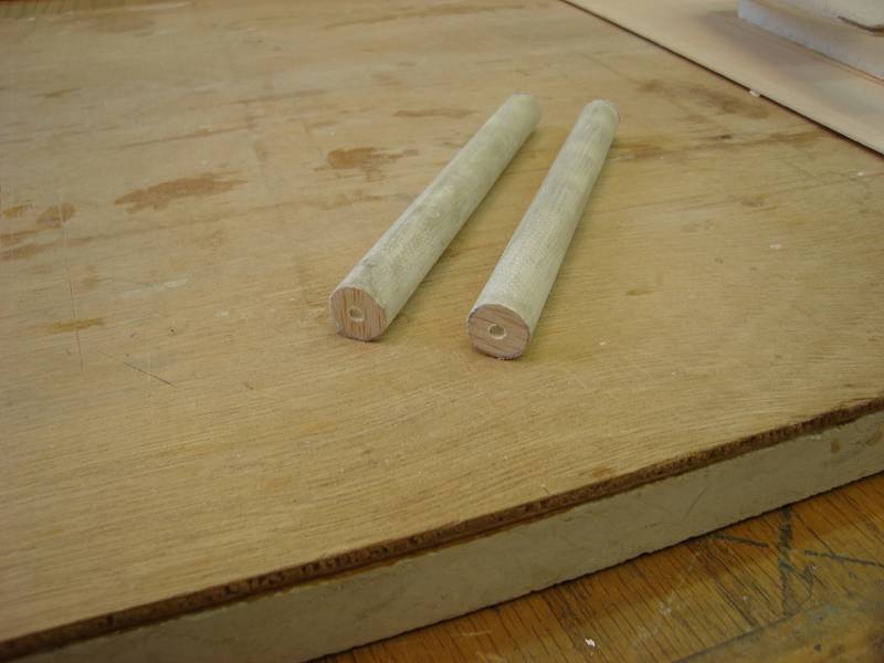

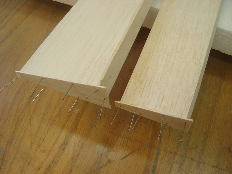

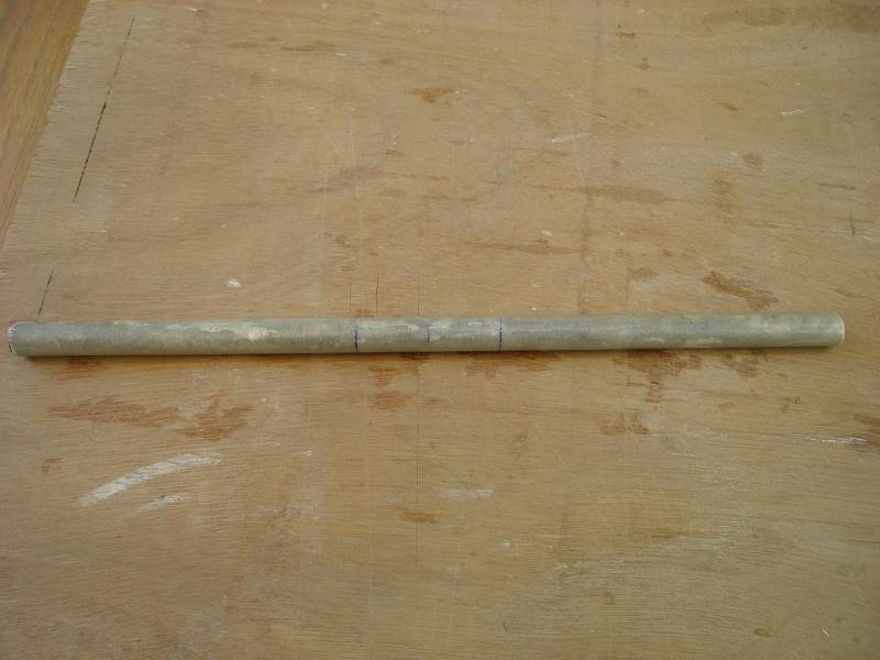

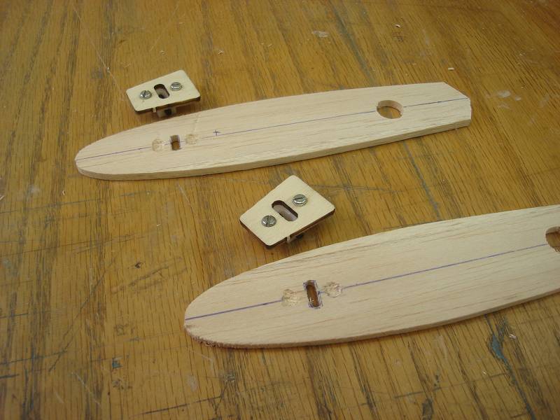

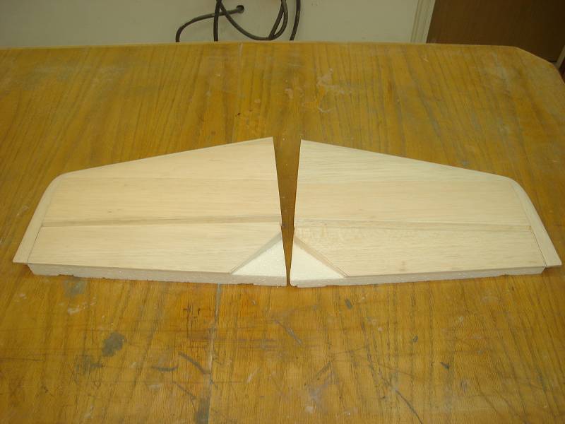

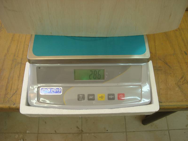

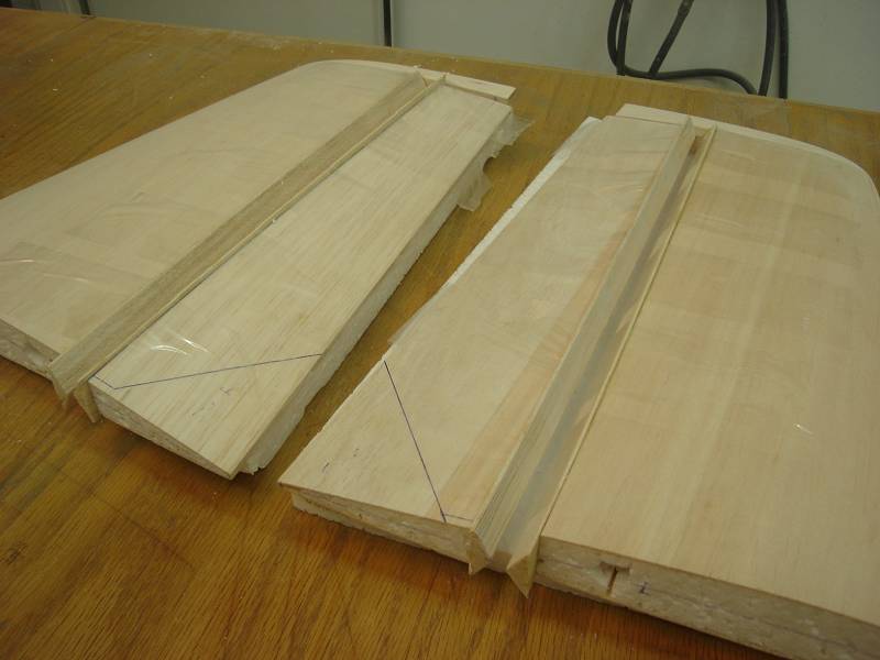

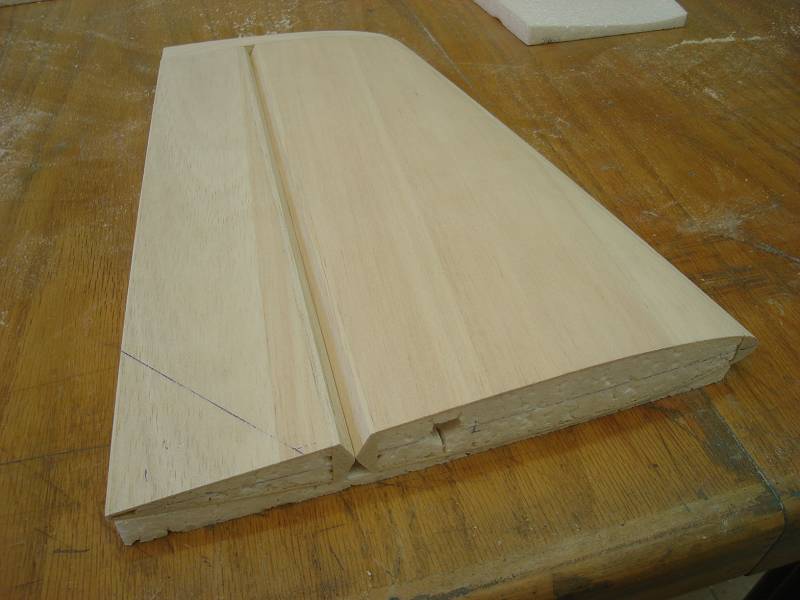

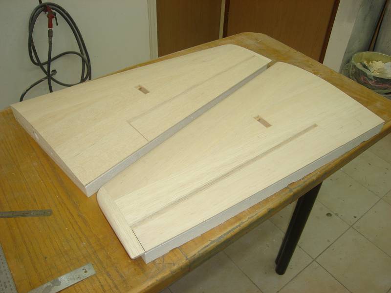

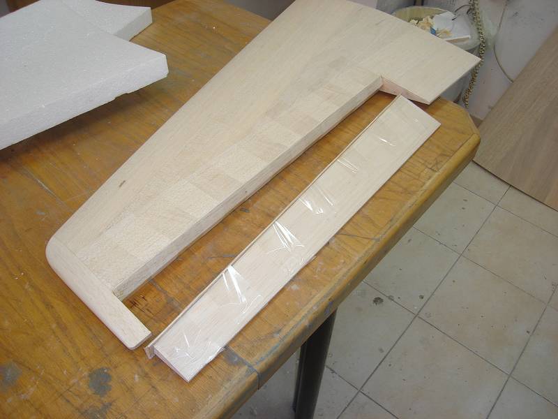

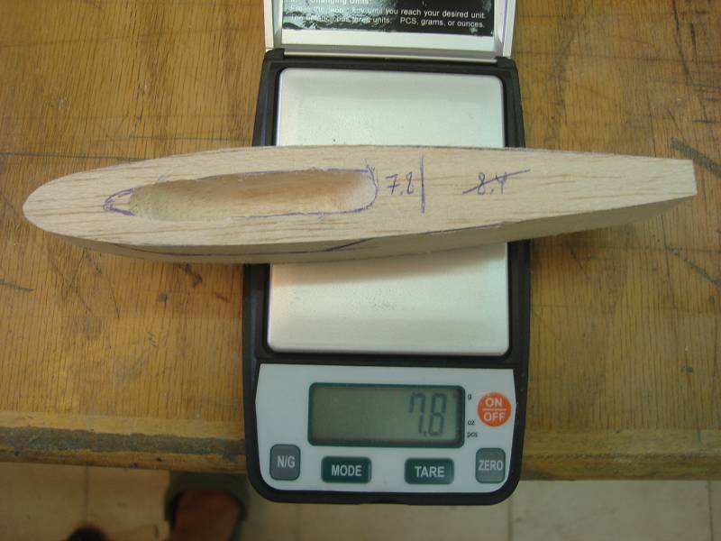

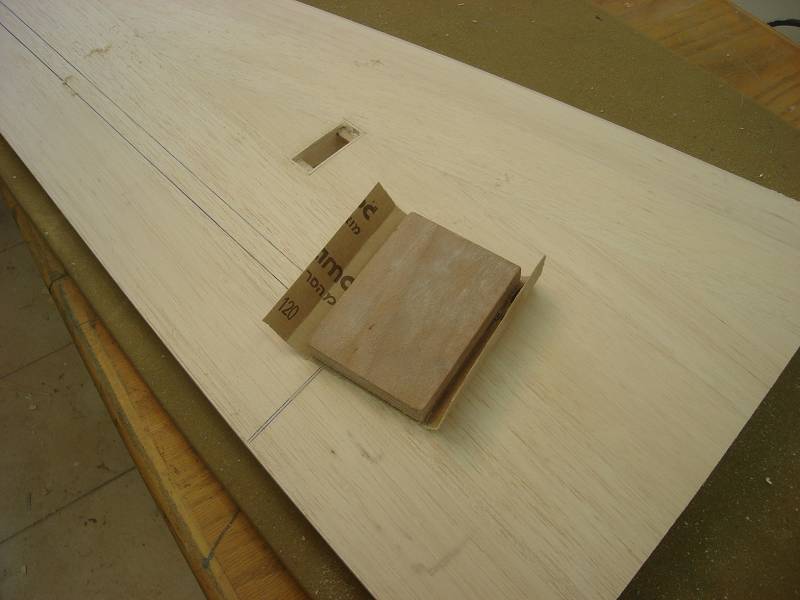

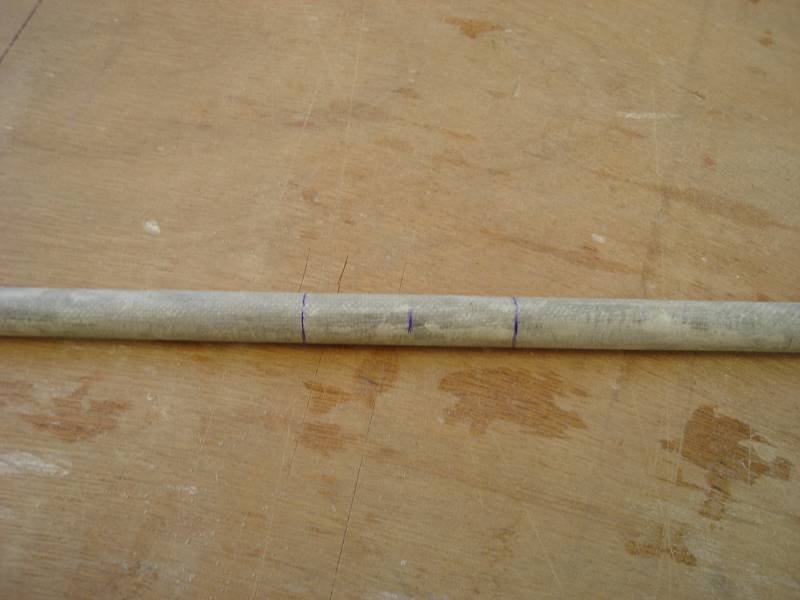

For those of us who have no building experience, Here are some pictures:

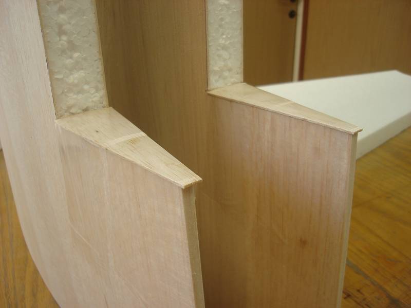

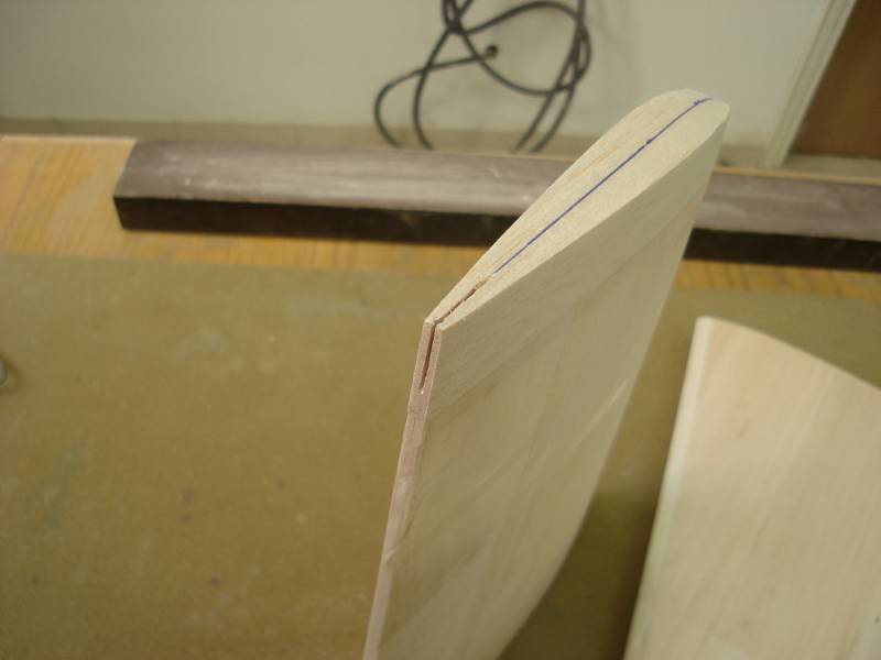

more

Thank you Juan
Yes, the reason for the ply is to strengthen the tips, I try to build the ship that it will look like new one after hundreds of flights. According to my experience, sometimes the tips are damaged during transportation.

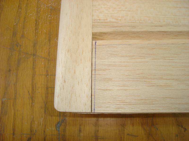

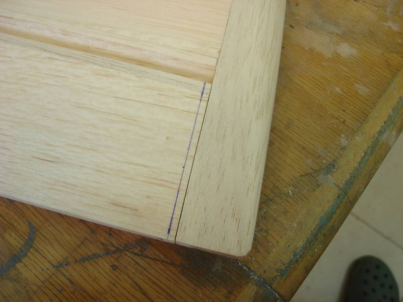

Hi Roly
The marking is 2.5mm from the wing tip, that allows 0.9mm gap after gluing the 1.6mm balsa sheet.
Isaac Najary

Hi Roly
Mine came out straight from the box.
I suggest using the straight angled balsa on the wings/stabs (not on the ailerons/elevators).
Glue on the ailerons/elevators a new balsa sheets, about the same thickness as the original spars.
At first sand it flush with the ailerons/elevators skins, and then sand the triangle shape.
Goog luck.
Isaac Najary
