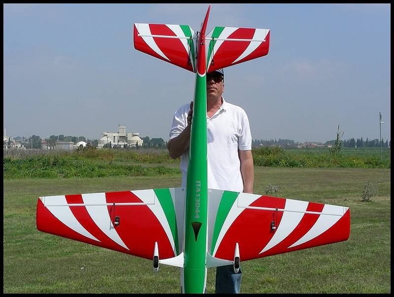

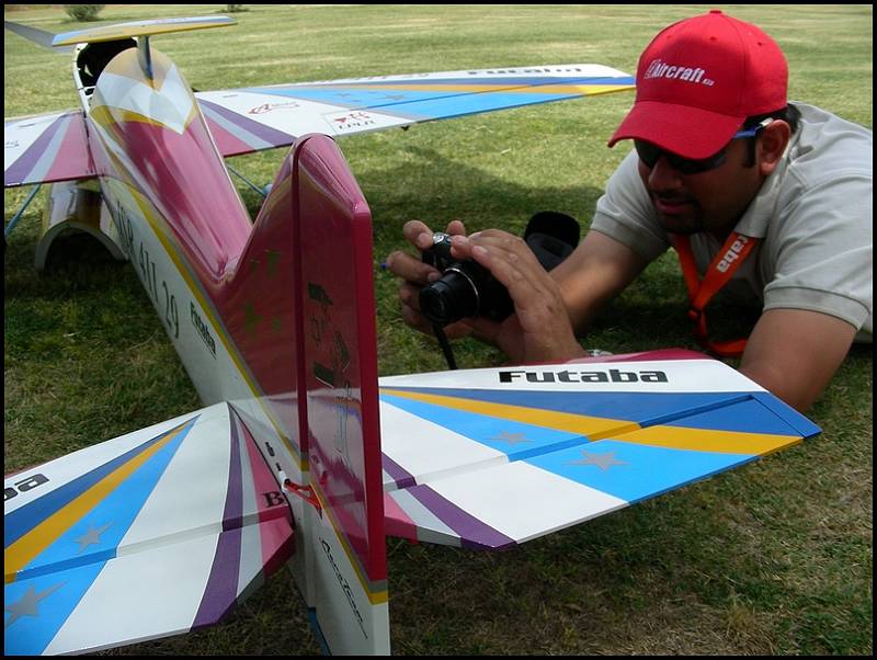

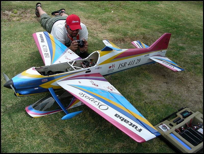

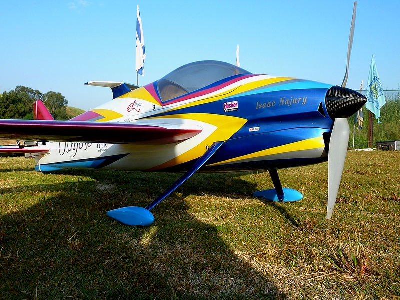

Came all the way to take close-ups of the famous model.
Close to 500 flights still like new.

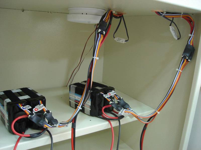

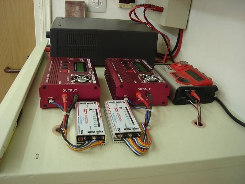

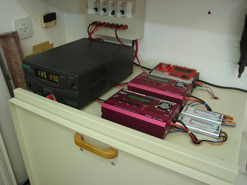

Here is an improvement to the Safe charging system,
See posts 320 - 325.
Regards,
Isaac Najary

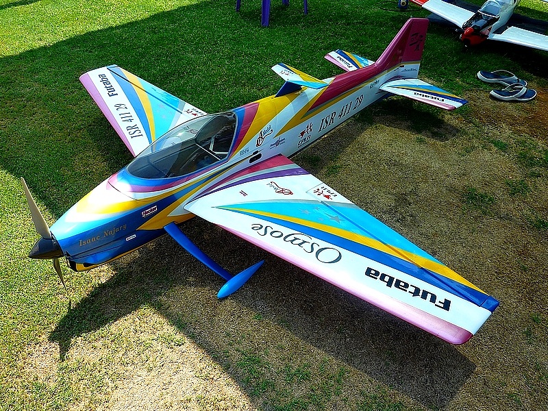

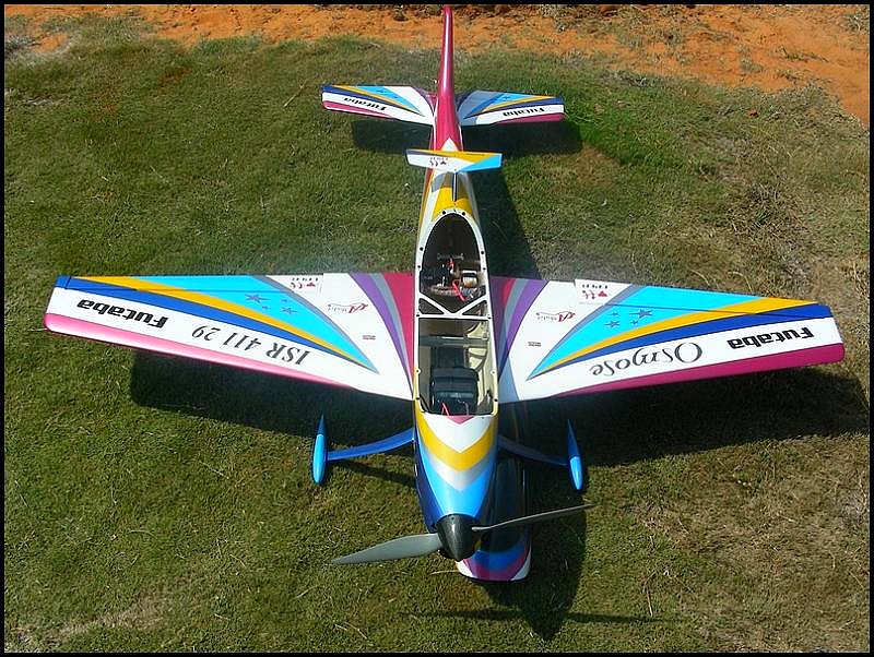

Unbelievable - After 550 Flights still looks new.
Picture taken at Petach-Tikva RC Field on #3 Qualification F3A contest for EC2010 - Austria....
Amram Leshed

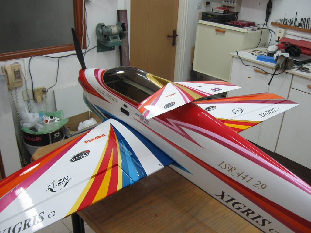

Old 02-13-2018 | 02:29 PM
  #372
Joined: Jul 2009
Posts: 15
From: Copenhagen, DENMARK

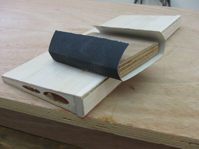

Excellent old thread. I am about to build my first F3A kit and will use this as my reference manual.
Question: making hinge list for the wing and stab, is it stock triangle list you have used, like 25mmx25mm as an example, and then flattened the angle like I try to draw in my example?
ID:	2254548   Click image for larger version
Old 02-13-2018 | 03:26 PM
  #373
My Feedback: (121)
Posts: 2,313
Received 40 Likes on 39 Posts
From: glen allen, VA,
That is one method. Typically the width of the balsa required to make surface LE or TE is not a standard dimension for triangle stock; so you have to use sheet balsa of the appropriate thickness. As long as the center line is straight and accurate once completed.
Good Luck!

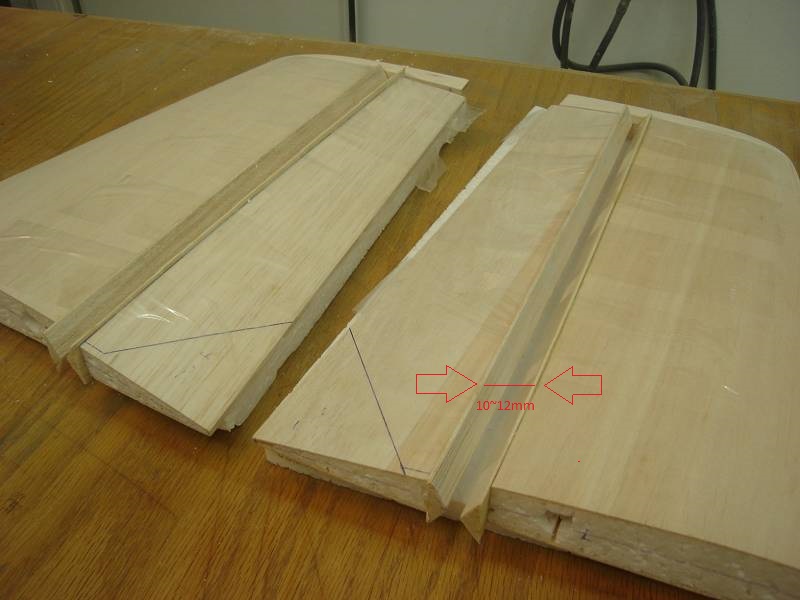

Old 02-13-2018 | 04:10 PM
  #374
Joined: Jul 2009
Posts: 15
Thanks.
I checked another one of Isaac's threads, and it looks like it is usually a 10mm sheet balsa on each part + a smaller 2mm, then sanding to shape
Would this distance be ok as in picture 3, marked in red? ( 10-12mm )
( pictures are from other threads.. )
