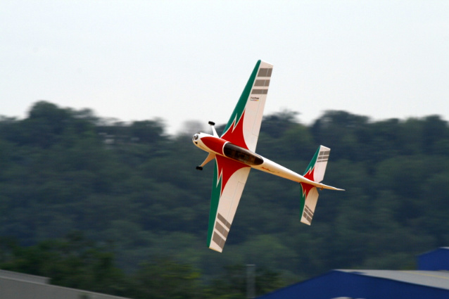

Greetings guys from sunny Malaysia. I finally got my Angel up on 5S with the 'right' motor. At the moment my specs are as follows:
Motor - DualSky XM 4260-6 (566 KV)
ESC - DualSky 60A with built in switching UBEC
Batt - Flight Power EVO25 5S 4,900
Prop - APC 14x10E
Servos - JR 539s all round
RPM - 7,600
Amps - 50A
I love the power for F3A flying and I must say that this plane flies so clean and so well, I got literally no coupling for KE at all. Gonna practise hard (meaning no more stick banging) and then see how she performs in some local competitions.
Prop - APC 14x10E
RPM - 7,600
Amps - 50A
