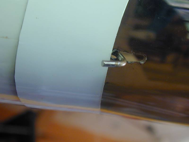

My canopy also required two fingernails to pry open, eventually you will break off the lower edge of the canopy, and the rear overlapping section will also break off, be warned spare canopies are a bit like hens teeth, i.e. don't exist.
Simple sliding catch in the canopy solved the whole matter, catch secures the canopy and the bent over arm aids the removal.
Thought you may like to see a couple of pics of the IC version as well, please don't take any notice of the throttle link, it was temporary to set up the regulator.
