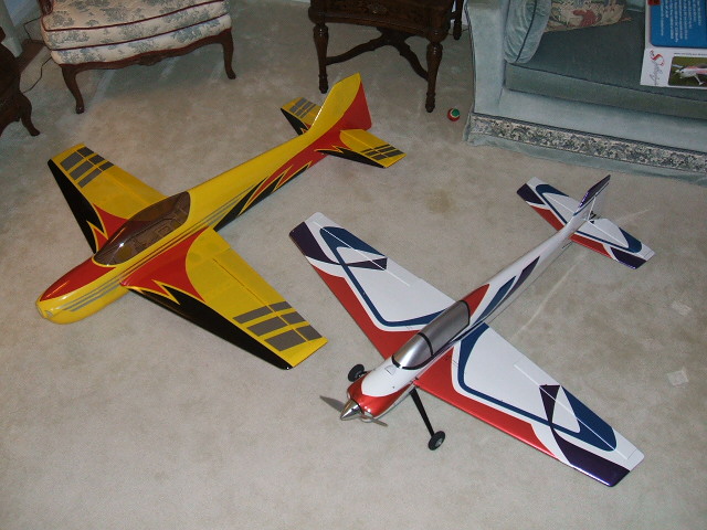

Hello,
After following this thread for a little while, I finally decided to bite the bullet and get the plane. Sprit Model only had the yellow version left which suited me well, since I like the color: it is an easy color to see at a distance. The plane arrived in 6 days and in perfect condition. When I first lifted the shipping box I was surprised as it felt heavy, but after taking the it apart I realized that it had been lined with 3 mm plywood! Needless to say, the plane arrived undamaged.
My first impression was WOW! Very nicely built plane and very light. I am currently working on a Fliton Extra 330 (the 60" one) which is also very well built but not as light. I am impressed. I am just getting started in pattern and would like to use this plane as my pattern trainer, but also hope to take it to a contest or two to see what it is like. I would just be flying the sportsman schedule.
I have enclosed a couple of photos of the plane next to the WM Groovy 50 3A which I currently fly. The Angel is definitely bigger and the fuselage just looks huge by comparison. The Groovy weight 5.5 lbs ready to fly (electric) and I am hoping to keep the Angel under 6 lbs. The Groovy is a good flier, but I suspect that the Angel is a much better plane.
Can't wait for spring.
Teo
Teo

The Angel will knock spots off the Groovy, in fact the amount of trimming and mixing work I had to do on my Groovy to make it fly straight always made me feel it was not a good airframe, as I have had to do so little to the Angel makes me like it more and more.
Mike

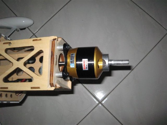

Hello guys,
Thanks for the advice. I did notice that the mounting pattern for the AXI is a little bigger than that for the Hacker, so I was going to ream out the holes on the AXI moung slightly in order to get everything to fit. I do not want to alter the plane at all in case I need to switch motors.
tIANcI: Do you recall how tall your so-so vertical with the 4120 was? Also, I was wondering what prop you were using at the time. I ran the numbers again last night and they seemed O.K. If need be, I can go to a 15x10 prop on 5 cells and not blow the motor or controller. My intent was to use a 14x10 initially.
I do agree that for its size, the airframe is quite light. It is quite a bit bigger than the Groovy, but will only be slightly heavier. The Groovy does handle the wind reasonably well. I suspect that the Angel will get bumped around a little. Is keeping it at 6 lbs or less too light for the plane? If that is the case, maybe I should just switch to the 4130 and move on...
Thanks for the tips,
Teo

Teo ... I think might have been a 14x7, maybe its me not pulling enough amps. Perhaps with a 14x10 she will have more bite. I settled on the Hyperion 4025-15, that was spinning a 16x10 and can handle 16x12 too. On the 16x10 she was nice, I can pull nice big loops. I am sure with the 4130/16, 6S and 16x10 she will be amazing. 3D alley!
The motorcalc says about 1KW for your 4120/18 on 5S and 15x10. Should be enough for freestyle flying. My Ms Wind 50 on 5S is only pulling 900W with 120 oz thrust on the DualSky motor calc, that is enough for her to pull KE loops. Let me know how she flies on the 4120/18, I may use the same motor for my next Angel.
As for weight, the Angel is nicer to fly pattern with some weight. If you were to go 6S and 3,300 packs she will get bumped about a little if its windy. Also, at the top of a loop or a Cuban, if you do not keep the throttle up a bit, she will just hang at the top ...
Remember to reinforce the battery tray if you are flying hard or with bigger packs. It no fun seeing the battery dangling outside the fuse, its way too nose heavy to recover!
