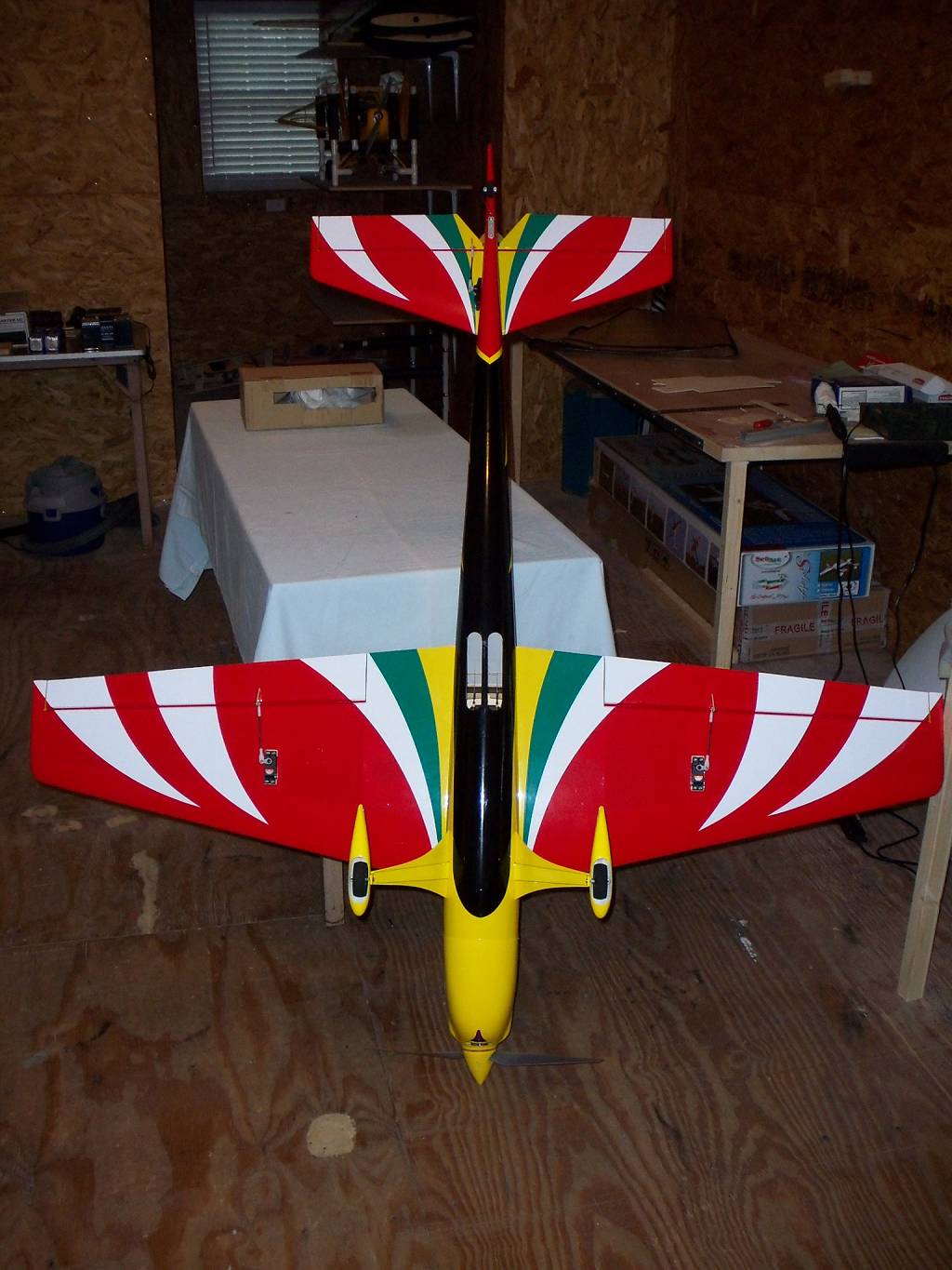

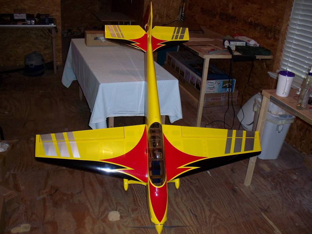

Hey Everyone,
As promised, I am attaching some pics of the bottom of my Angel with the yellow and black color scheme. As you can see the bottom is quite different than the top. But I am not sure that at a distance it will contrast all that much. I have found that just about any color scheme will sillioutte on certain days anyway. I believe that Mike has the right idea, don't fly the darn thing so far out as to where you cannot see it....lol..
All I lack with mine is setting the throws on the control surfaces. I did a final weight check as listed below along with the equipment that I have. Will be ready to fly it when the weather cooperates, which looks like it will be a week away as of now. The only mods I made, I removed the magnets and installed a hatch latch in the canopy. My magnets were so strong that I actually had to use a rod from the bottom to help push it off the first time I removed it. My first Angel had cracks along the bottom edges from where the previous owner used his fingernails to help remove it. On that one, I simply sook a piece of white electrical tape and doubled it over and attached it to the inside on the top rear of the canopy to where it stuck out about 3/4" when the canopy was closed. That way when you wanted to remove the canopy you just lifted the piece of tape, and it pulled it right off. I never had any issues with the canopy coming off in flight even with positive and negative snaps, but then again, it had really strong magnets on it.
Hacker A50-16S
APC 17x8e prop
CC ICE75 ESC
CC 10amp BEC
Futaba R608FS 2.4 mhz receiver
JR DS821 Digital servos all around
Turnigy 6S 25C 5000mah battery
Anderson Power Pole fuselage mounted arming switch
RTF weight 3.175kg (7.0#)
I will most likely wind up with a APC 17x10e prop but all I had at the moment is a 17x8e. I will post the static results when I get a chance to check it and fly it. Ground clearence is okay with the 17" prop, but it will most likely pick up some grass stains from the weeds, etc. just like my Wind does at our field. We will see....
Note - I also checked incidences and the wings are zero zero with respect to the stab.....
Larry....

That is great. You should have yours pretty soon. I was wrong in my prior post. There is a little yellow on the bottom as you can see on the fuse. I was going on memory from looking at the wing and stab panels. I have built and assembled a lot of planes over the years, and I have to say that this plane is the truest plane I have ever assembled. Everything went together flawlessly. I also have a Wind 110 and had the Miss Wind and they were fantastic also. But this one beats them all, hands down. Also, I didn't mention it in my previous post, but I had to install my receiver and arming switch behind CG to allow a little room to adjust the CG. I guess using the heavier 6S 5000 battery pack is the main reason. Right now, I have the receiver mounted on a little platform I installed in the turtle deck area behind the rudder servo. At 145mm CG, my rear of my battery pack is about 1/2" in front of the wing tube. Plenty of room to go forward, but not backwards. I have my ESC mounted under the battery tray just in front of the landing gear plate. I preferred this location versus on the side of the fuse where the instructions call for. This way it is out of the way when installing and removing battery packs, and it is a straight shot to the motor with the wires. Just a heads up if anyone is thinking about installing a light servo in the rear for elevator to save weight. You are gonna love this plane......

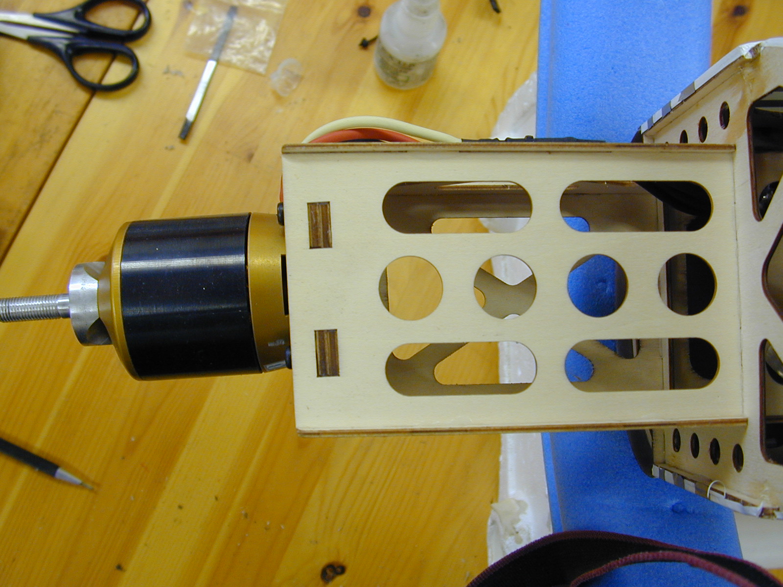

I bought the glow conversion kit to install OS 55 AX.
I can not identify where to place 2 wood parts. I think that they are the gasservo tray, but I do not know how to install it.
Any of you have pictures or description about that?

When I did the conversion for a pal of mine there where no instructions or materials kit available, its a very easy job, go back to page 6 and you will see what I did, the only thing not detailed on the Sebart instructions is the cut out I put into the bottom of the fus to accomadate the silencer inside the cowl, makes a much neater installation.
Mike

Hey Guys, just reading my way through all the pages in this thread as I've bought a 2nd hand Angel complete, but the motor box was knocked off. I'm going to make a new one from ply. Could someone do me a favour and measure the distance from the bulkhead to the front of standard elec motor box? Also keen to know if there is any side and down thrust built in?

My Electric version is in my workshop at the moment, will measure it tomorrow for you if someone does not beat me to it.
Don't forget the reinforcing washers for the incidence pins, after prolonged use they start to develop play.
Miuke
