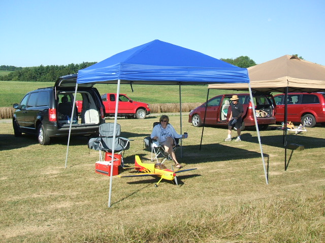

Hello all,
Took the Angel to its 1st pattern contest (my second) and the plane served me very well. I am just getting started, so I am currently flying Sportsman. The weather at the contest was just about perfect with sun on both days and light winds.
My set-up is somewhat modest in terms of power: AXI 4130/16, APC-E 16x12 prop, 50A Castle ICE controller and a 5S battery. With this, I have about 900 watts to fly on which is a little less than the 1000 watts I was expecting (which is what I get if using a 70 A Jeti Opto Plus controller). All up weight is about 6 lbs, give or take an ounce of two. On calm days, this is more than enough to fly the sequence well; however, on windy days, it could use a little more speed. All in all, I am very pleased with the plane. The only concern I have is with how lightly the plane is built: I am not rough on my planes but I wonder how long it will last.
At any rate, if you are thinking about getting started in pattern this is a great starter plane. I have enclosed a photo of Corine and the plane taken just before the start of the contest.
Teo
