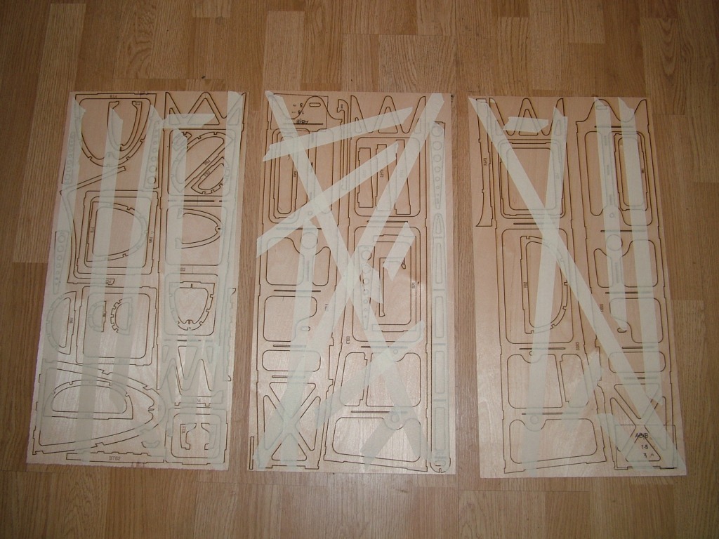

Here's the wood version i was talking about. It was designed as electric only, but with some effort it can probably be converted for glow power. Comparing to the composite fuselage, i had to simplify the shape as much as possible for easier construction. I had only 15 days to design the whole structure, so i didn't have time for a paintscheme or pretty pictures In order to keep the costs to a minimum, i had to split each side of the central fuselage box in 3 pieces and use smaller and a lot cheaper plywood sheets. The structure will be covered with 1.5mm balsa and the canopy and motor cover will be fiberglass construction.
I got the lasercut parts and i started building the prototype yesterday, so this time you'll see a few building pictures, not just Solidworks renders

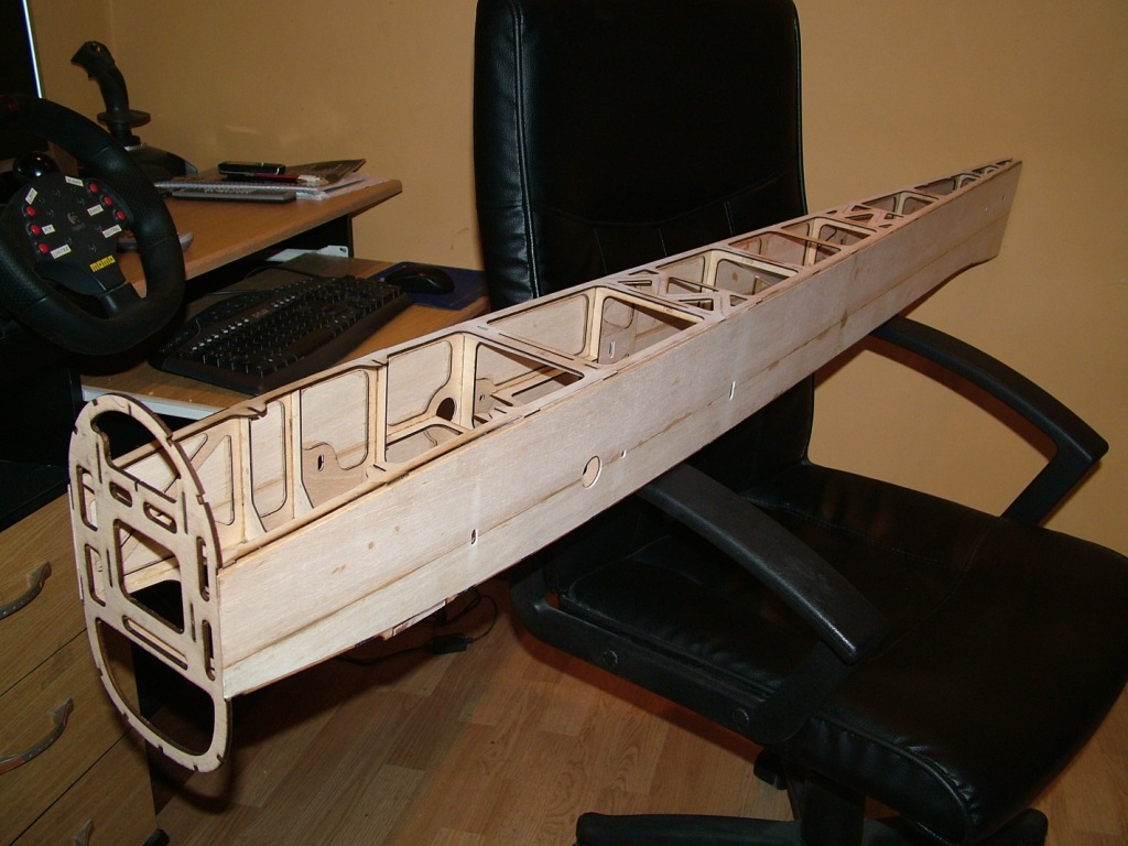

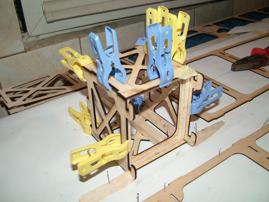

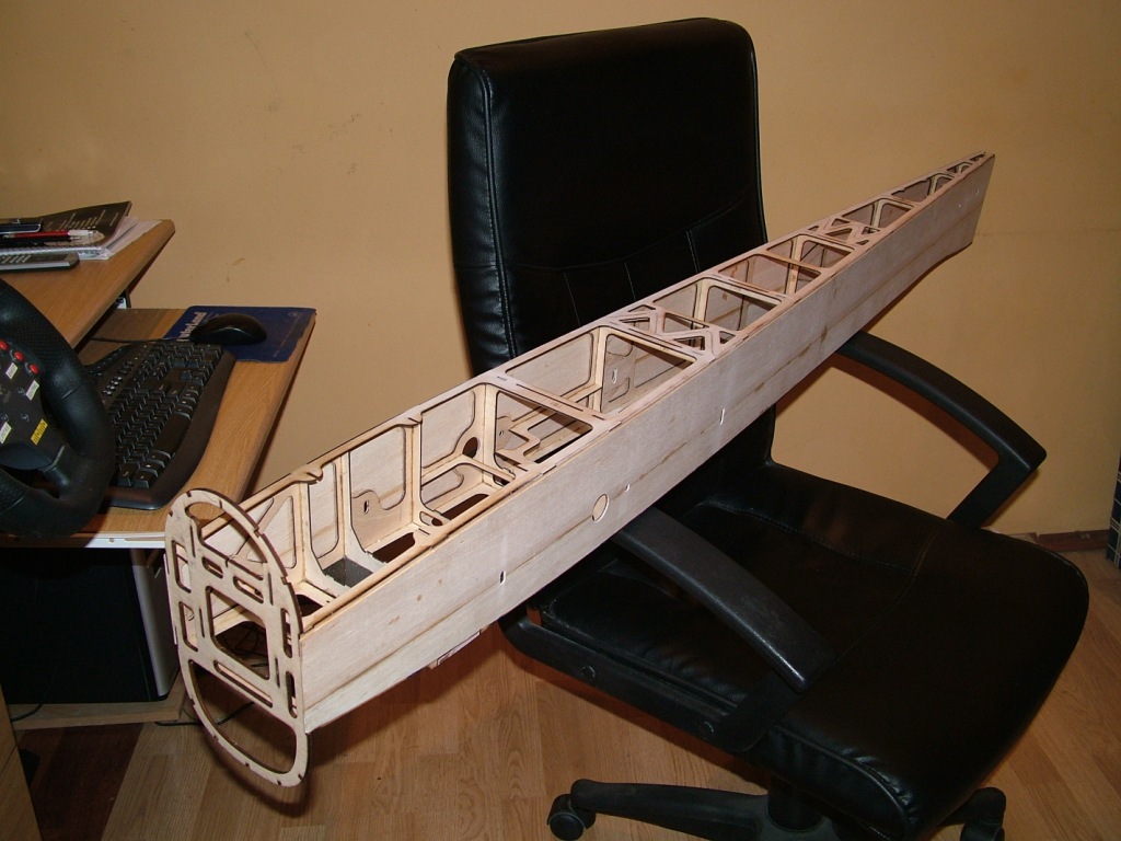

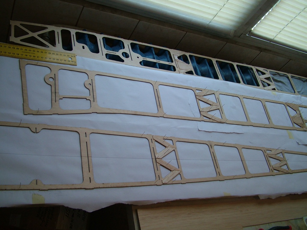

The lasercut parts look good, maybe the 2mm plywood parts are a little burned around the edges but it should be ok. I started by assembling the sides of the fuselage central box, and while waiting for the epoxy to cure, i put together the basic structure for the canopy an cowling mold plugs and started working on the motor support.

just a little note, i think you need to make something to force the air getting out of the fuselage.
in the F3a Sebart models they just open an air exit on the down part of the fuselage and cover with orocover one of the vertical parts of fuselage, or in most of oxai models they put a 45 degrees balsa sheets just a little bit before the wing tube in the fuselage.
probably you already think what i just told, but i case you don't...

I thought about it but haven't decided exactly where to cut the opening for the air exit. It will be somewhere behind the wing, on the belly but i'll try to avoid cutting any of the balsa stringers. The 45 degrees balsa sheet is a good idea.

I was a little busy last week, but i finally found some time to work on the fuselage the last couple of evenings. The fuselage box is now finished and the hot air deflector installed.
I am still amazed how well all the parts assembled together without sanding anything and how stiff the structure is. I made a few small mistakes though, but it's nothing serious.
I cut 2 more firewalls and i'll use carbon cloth on both sides to make it stronger.
