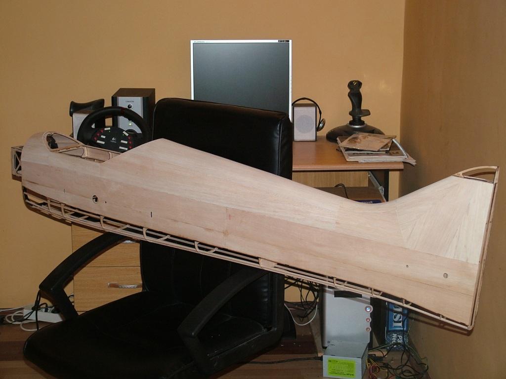

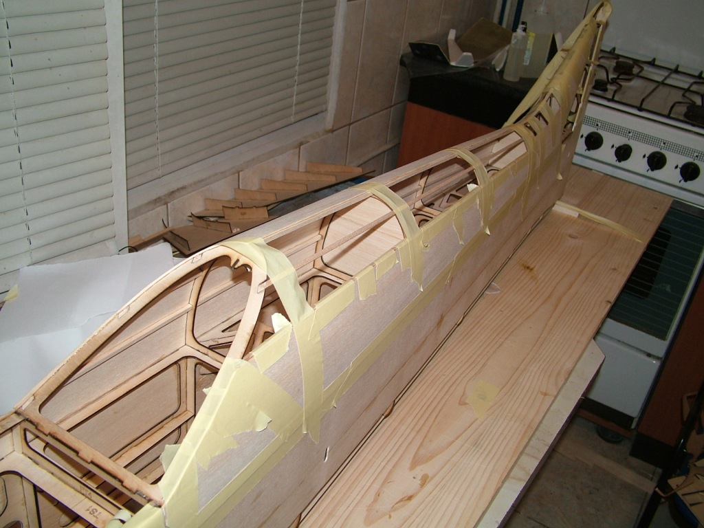

Old 09-05-2009 | 12:42 AM
  #79
Joined: Aug 2006
Posts: 520
Received 62 Likes on 28 Posts
From: Trollhattan, Sweden
Default RE: Designing a new pattern model
Time for an update:
The new carbon laminated firewall is quite stiff and i decided to use it. I also assembled the fin and added the formers for the belly and top of the fuselage. The stringers and balsa skin are next.

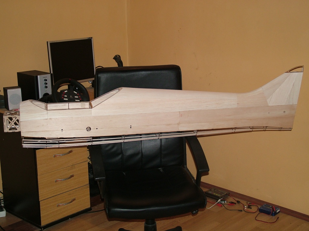

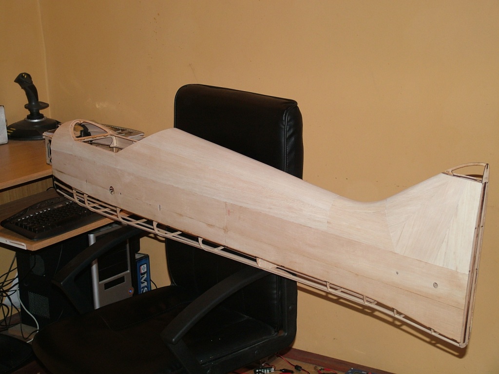

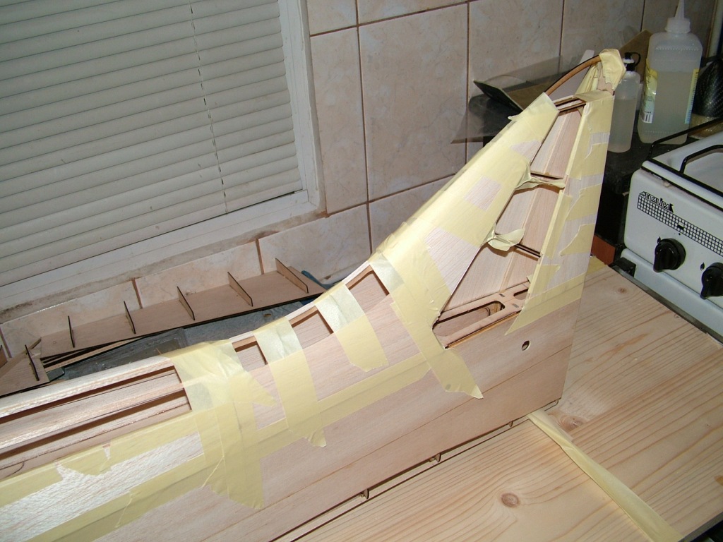

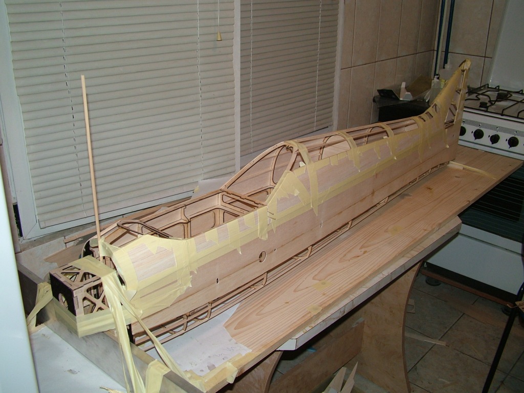

Old 09-13-2009 | 01:49 AM
  #83
Joined: Aug 2006
Posts: 520

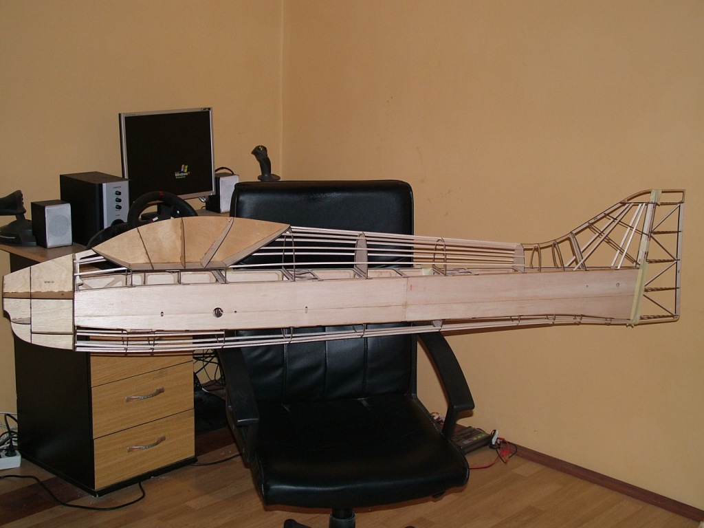

It finally starts to look like a plane...
I started working on the rudder, but it's not finished yet. The fin was glued to the fuselage using a laser level tool for alignment.
I added the stringers on the top and bottom of the fuselage and took a few pictures with the cowling and canopy mold plugs to get an idea of the general shape and dimensions.

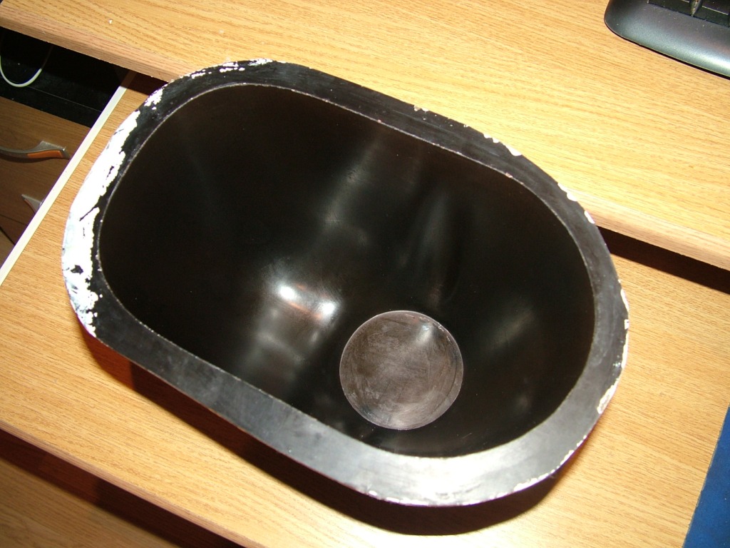

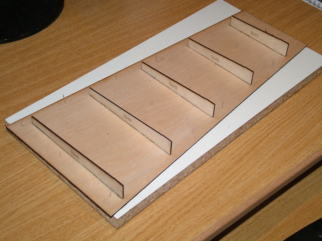

Work on the model continues, and the canopy mold is finally done. I also designed and lasercut a frame and attached it to the fiberglass canopy. It still needs some work to make sure it fits perfectly, but it's not bad so far. I'm waiting for the CF landing gear to arrive and i also ordered 25g/m2 fiberglass cloth for glassing the fuselage.

beautiful job.....
but why did you select the airfoil you used??
