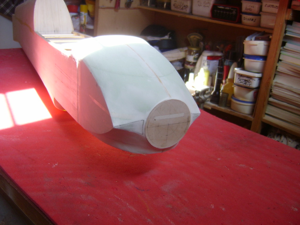

The wing is 212mm wide at the tip (measured at the tip of the aileron) and 460mm at the root (measured along the side of the fuselage), which gives a ratio of 2.16.
I think 3:1 would probably be too much.
The weight of the fuselage including the rudder, canopy and cowling is 1250g. I know it's probably on the heavy side, but it's the best i could do with regular balsa sheets. The canopy and cowling are a little bit heavier than i expected (110 and 115g ) but i'm going to use them anyway. Since it's my first 2m model, i have no idea about the final weight at this stage. There are a lot of experienced builders here, so i'm looking forward to hear your opinions about this.

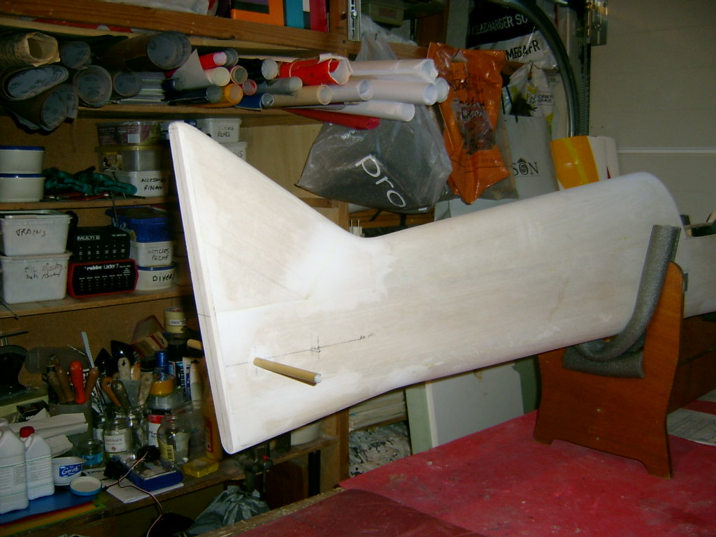

Hi Alex,
Yes getting on the heavy side.
1100 to 1250 glassed and painted would be good. My Oxai Ventura is 1120g painted inc the rudder.
You mentioned waiting for glass cloth @25g for finishing. That will take a lot of resin to fill.
I would sand & seal the balsa first, get 15g cloth and use lots of microballons. See BM3 threads here.
If that gets much heavier you will not have a model that reflects the potential in your design.
Also go to extremes to get light wings and tails to compensate some.

Hi Alex
Just to share with you my little experience.
On my wooden fuse (similar volume as your own), before putting glasscloth I put dope on balsa. Then I put 25 g glasscloth with resin. Weight with resin after sanding is about 100 g.
But to get good finishing it's need to put primer. So primer is a litlle heavy 60 g. Paint is 40 g and clear coat is 40 g. 240 g total weight of finishing.
I think to get lighter is to replace glasscloth and resin by "japan paper" with dope. It's less resistant but you 'll have no problem with electric motor because less vibrations than thermic motor.
In this link see pages 25 to 27, finishing with silk, talc and dope (very long to do) : http://translate.google.com/translate?u=http%3A%2F%2Ff3a.sakura.ne.jp%2Fradioc ontroll%2Fspecial%2Fmake%2Faddction%2Faddction_01. html&langpair=ja|en&hl=en&ie=UTF-8
Claude
Claude
#119
Thanks Claude.
It looks like the Addiction is about 125g lighter than my model at this stage. It's not too bad, but i have to consider the fact that the electric setup is heavier.
I put dope and talc on the rudder this morning to see how it goes and it turned out fine, but the mixture was a little too thick and sanding it took some time. What was the dope : talc ratio for your mixture? I don't know exactly what dope is, so i used nitro laquer instead. I would also like to know if i can use this mixture for things like canopy fitting, where the layer needs to be a little thicker or is it better to use epoxy+ microbaloons?
I will look for "japan paper" here, but if i won't be able to find it i'll have to use the 25g fiberglass cloth.
The approximate weights for each finishing step is very useful.
Foofydoo, the cost of laser cutting was about 200$.
