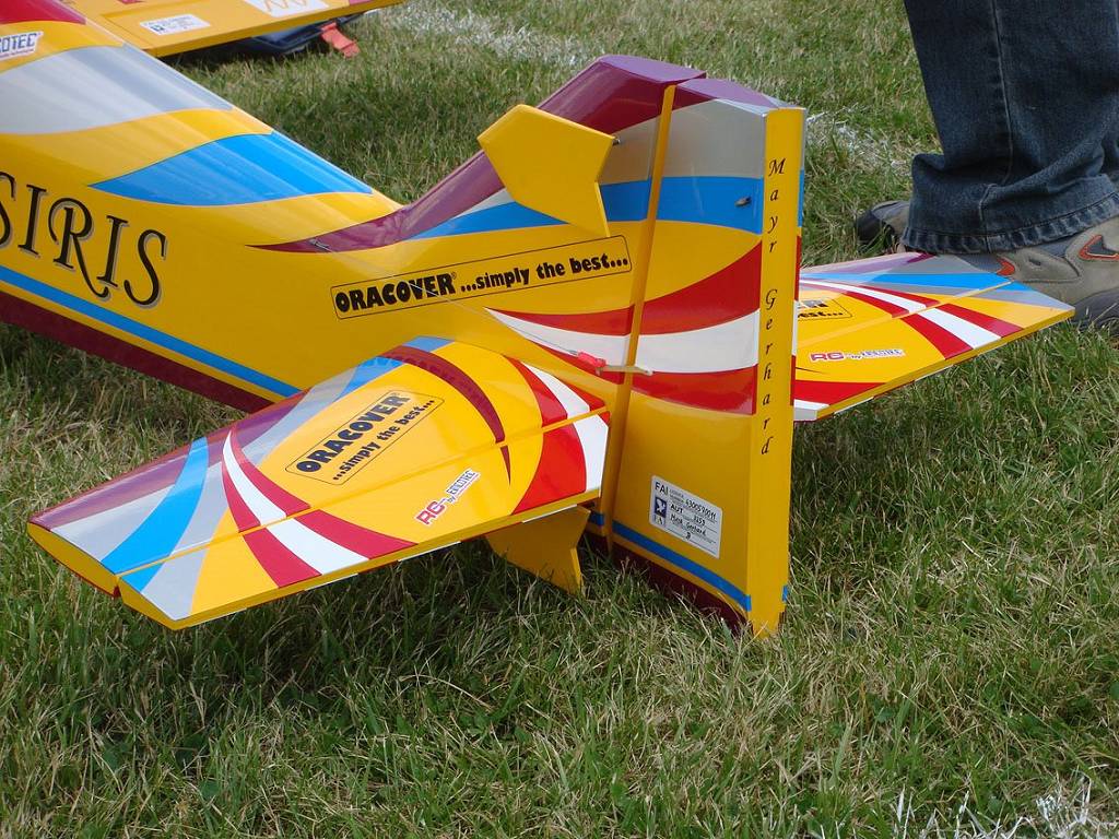

Lots of different theorys out there . . Pattern planes have had razor sharp TE's through to the current trend of thick TE's . . and flutter hasn't been a concern with any of them. Sealing the hinge gaps, correct linkage geometry and servo choice, is considered the appropriate method of handling flutter. 3D throws are a 'flutter' concern, particularly when using analog servos (not recommended), as small amounts of servo travel are used to control large surfaces for general flight (i.e. low servo resolution).
The attached pic is of Gerhard Mayr's own design . . it finished 5th at the World Champs, so I guess thick TE's work as intended for him. Definitely most new F3A designs do not have thin TE's and the rudders are surprisingly thick.
I would just build it as it is, and wouldn't bother sanding the TEs down . . doubt you would notice any difference in flight.

Gerhard Mayr DID fly his Osiris well, Some people had commented that his style was the the most accurate of the worlds.
Gimmick? Could be....

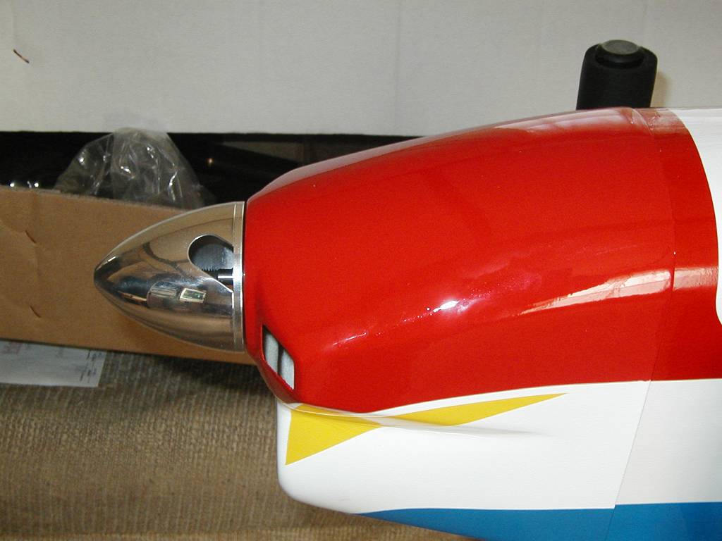

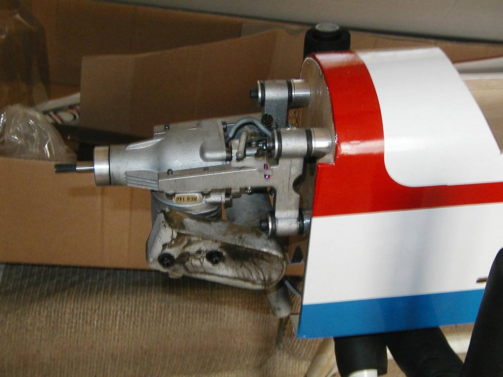

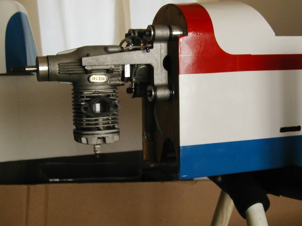

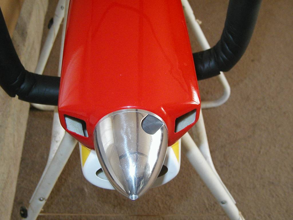

here are some pics of my engine instalation

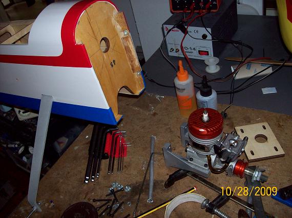

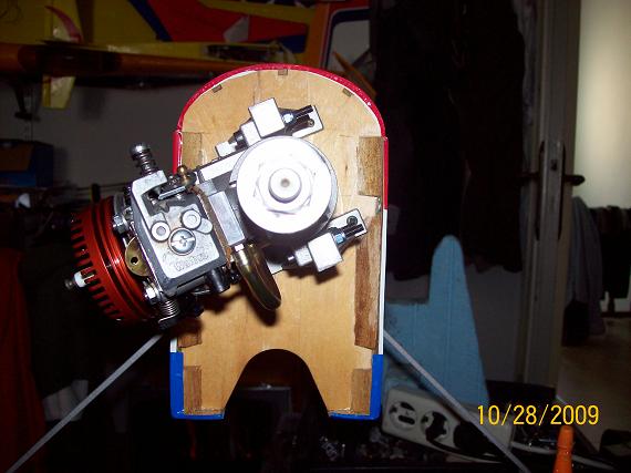

Hello there !!i just got mine and i started it yesterday ! The only think i m concerned is how to instal the MVVS 160 + tuned pipe (it must be instaled at about 200 degres if i want to have the pipe under the fuse)
Old 10-27-2009 | 05:16 PM
  #45
Posts: 501
From: mt.pleasant, PA
Default RE: MODEL TECH 2M REMEDY
aandreas
putting a tuned pipe on a 2stroke engine is going t be very diffacult as you can see the drop from the exaust port to the pipe chanel is 3in. so it will require a custom header I don't want to go that rout

yes it is quite far from the exhast port but if i put the motor sideways and down i thnk it will be ok The only negative about this is that i ll cut the cowl ..

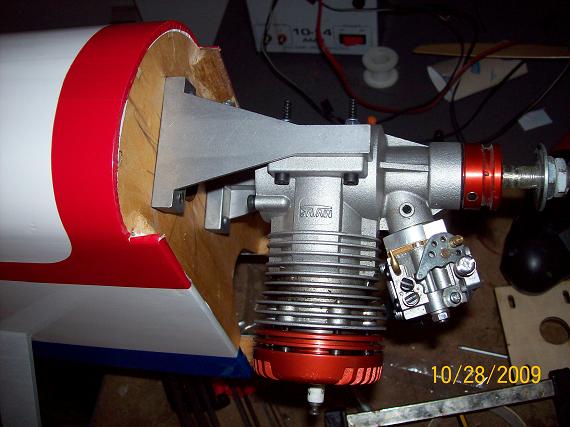

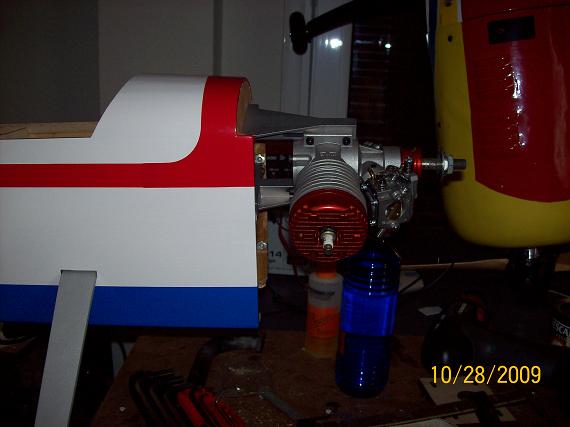

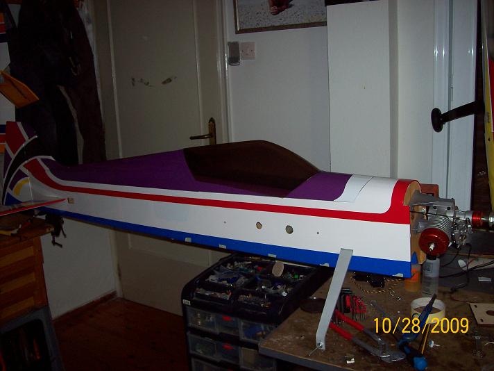

well i did some work ... and the most important i put the engine at the wright spot ...
im finised with the higing and the throtle servo ..thats for the moment

the hardware for the controle horns for this plane is junk I will change it to more sturdy hardware what they supply is only about 4-40 realy light for a plane this size

hi! i ll use the hardware suplied ...i think its fine ..!(i had an ULTRA RC GILE 202 about the same sise that came with more or less that kind off hardware and it was just fine ....so im sure its ok!
