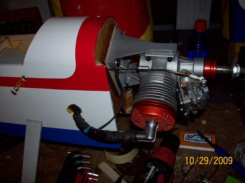

Here are some more of my REMEDY ..Ι have the model finised now and im waiting for the wether to be litle better to test it
My setup is
2x hitec 5625 aileron
2x futapa 3050 elevator
1x futapa 148 throtle
1x tower TS-160 rudder
350cc fuel tank
MVVS 160
tuned pipe
2200 lipo +flightpower 8A regultor
1250 li-po for ignition
all up weight without cowl is 5600gr

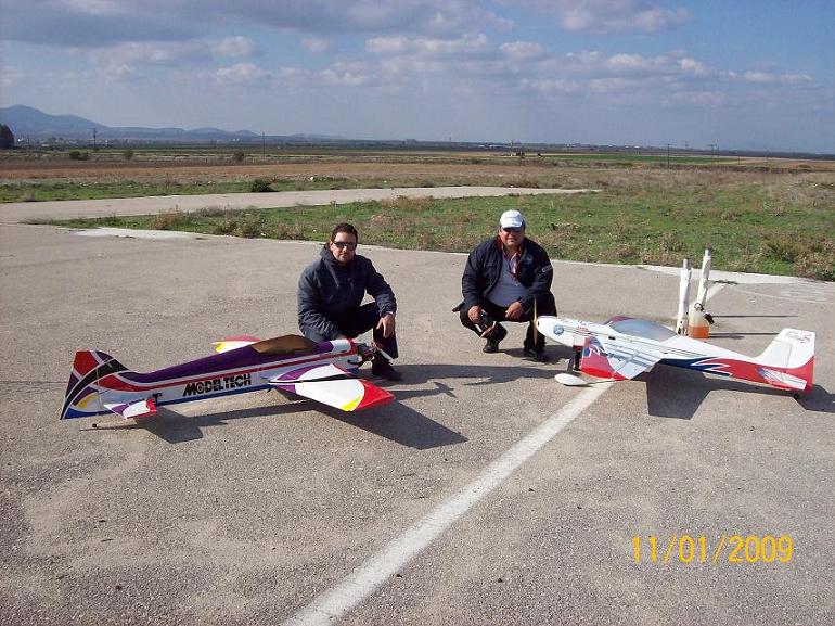

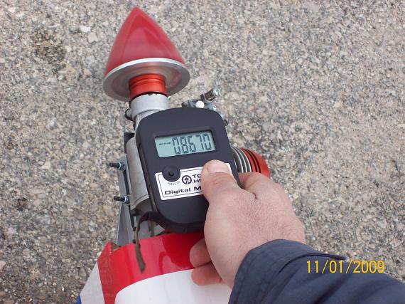

Marko i did my first flight today with the REMEDY and its ok with the 1.60 i used 18x8 wood prop and apc 18x6w for 3D. The plane dosent feel so light as a funtana 140 but its more acurate for mixed flight
My MVVS goes up to 8670 and more with the APC and its ok for me ...i think a glow 160 would be better ,but thats what i have .

i want to say trhat it does not feel like a very lightly loaded big 3D plane like the FUNTANA 140 ,or like a big foame.but this is ok for this tipe of plane ...it is a good model dont have any fear [sm=thumbup.gif]

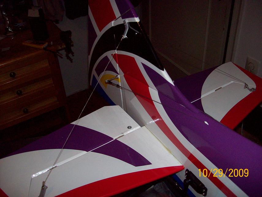

Kit quality (relative to price) exceptional good except for the quick links (absolute garbage; way too much play in screw threat and after one time opening they stay open).
Flying wires construction not very good. I would prefer a reinforced horizontal stabiliser instead. My tip for future builders (and also for the manufacturer ) ; reinforce the horizontal stabiliser by adding a carbon rod and forget the whole wiring s@%$t.
