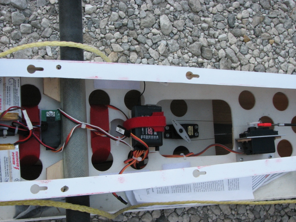

Jason, do you have a picture in this series that shows the SA 4 lead servo extension running
back to the dual elevator servos?

There's not much to see going down the back of the Valiant.

Old 12-07-2009 | 07:42 PM
jlkonn's Avatar
Posts: 1,418
From: Back home in, OH
Default RE: pull-pull setup for pattern
Jason,
Thanks for the pix of the extensions.
I've heard of them but I've never actually seen them.
I think it's a slick idea!
You sell them right?
JLK

What is this extension? What does it do?

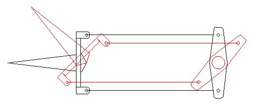

The pulley system, to me seems to be a bit of false benefit.
let me explain with the power of pictures!
As I see it, having a set up the same as JAS's (which is the way I do it) seems the most logical. to fixed points on the rudder and the servo arm. As the arm travels the lengths stay the same right?
With a pulley, they don't, calculating the distances between the horns mathematically, the long side would need to GROW to keep the tension on the lines the same, so essentially what i think occurs is the tension on the cables is balanced, but the OVERALL tension increases, which I'm not so sure is a good thing.
Anyway, some food for thought.

Yes, SA has them, but they are not listed on the site. We are actually in the process of redoing our site, again, and going to be doing it in house. In the meantime I've been adding to my weebly site in the SA section.

Ryan, true, the mathematics can't be beat, and on such a short run the % elogation is quite high, but when in place in the plane where your lengths are over a metre, you'd barely notice it I think. Come to think of it who acutally tests the tension on their cables apart from giving them a "twang" every now and then?
I'm just cheap and can't stand paying a lot of money for a pulley I guess. [:@]

ORIGINAL: Rendegade
It looks to me like the distance between the servo wheel and the rudder horn would change an equal amount on both sides (and at the same rate), as long as the rudder horns are centered around the hinge axis. What I believe the effect of the pulley would be is to create more sensitivity near the end points - it would take some of the sinusoidal response out of the system and make it more of a linear response. The cable should remain the same tension throughout the full range of motion.
Old 12-07-2009 | 11:43 PM
Joined: Mar 2003
Posts: 1,881
From: Perth, AUSTRALIA
Ooh, I hadn't thought of that.
I guess it would take 50% of the sinusoidal travel out of it, the only true way to get a linear travel would be to have another pulley in the control surface.
That being said, do we want linear travel? having expo in the system would say not.

ORIGINAL: Rendegade
In this case the effect wouldn't be noticed around neutral, as it would be identical to a straight rod at the neutral point. However the straight rod would become less sensitive as it moved closer to the endpoints, giving your more response at full rudder deflection.
Actually it's starting to sound like a pretty cool setup. Fun to think about, probably more so if I wasn't getting my brain kicked by finals this week.

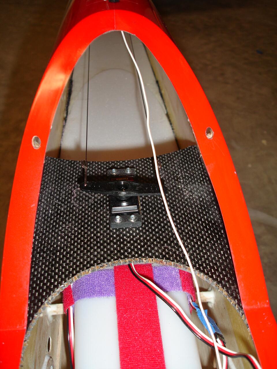

Just in case. If you need to make it simpler and save some weight you could thread the wire as shown in the picture.
VB

Way back.....my EMCs used pulleys on both the servo and rudder ends.....looks cool....works....no real advantage in practice. Since I started flying Wistmodel stuff, I use the horns they supply....slight ackerman on the servo end.
Recently, I switched from the servo end shown by Vince to clevises on both ends...because I was breaking cables after 200-300 flights as they frayed on the servo arm. Lots more pressure and wear on cables now than when the 2M stuff was smaller.

Hi Dave,
I think I got the idea from you. I never had problems. I remember that I cut the sharp edge of the horn hole with a Xacto knife. Probably this is the reason I never had problems. This sharp edge effect is also present using clevises. In those cases, I grind the sharp edges in the connecting rods to reduce the chance of cutting the cable. Well in FAI you are doing the knife edge loops. That puts a lot of pressure on the cables.

I thread servo arms for foamies at the like, (using kevlar thread) the same way Vince does, but I have to admit I can see this being a soruce for failure, with metal cables, radii is just too tight for metal to go around without a kink, and as anyone who flies CL knows, kinks are no-nos!

Vince,
I think you are right on both ideas....I think we did discuss this many years ago, and it was before KE loops. I am using the vinyl coated Kevlar from ACP, and it has no problem "weaving" through the servo arm, but even after radiusing the holes in the arm, the cables still fray with the current planes/schedules - wasn't a problem from 1990 - 2003 <G>.
