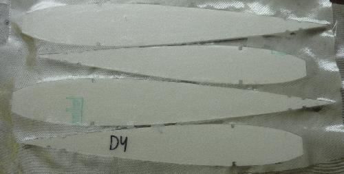

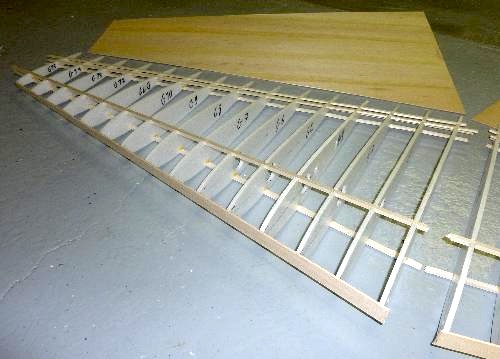

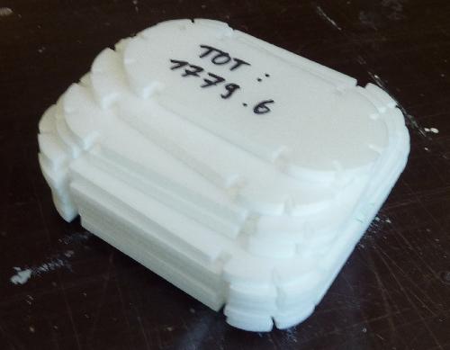

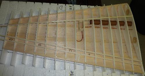

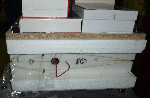

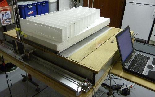

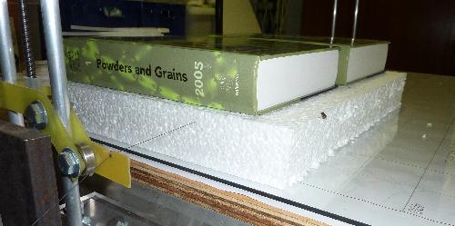

The rib are made of 6 mm depron. I'm using a technique derived from the "laser method". Pieces of depron are placed to form a comb. Afterward, the ribs are cut with a CNC hot wire. This method is very nice because (i) the ribs are cut very precisely and (ii) the remaining part will form a support for the assembly and for the sheeting.
The first rib and the one situated at the extremity of the sheath are reenforced with 100g/m2 glass fabric and epoxy.
After the cutting, the ribs and the longerons are glued with alyphatic glue.

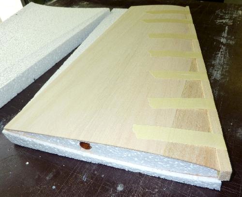

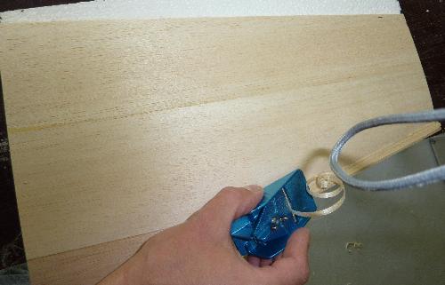

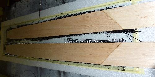

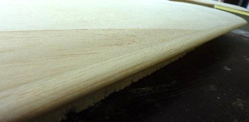

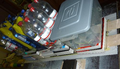

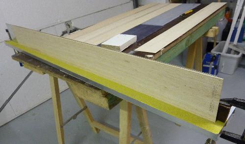

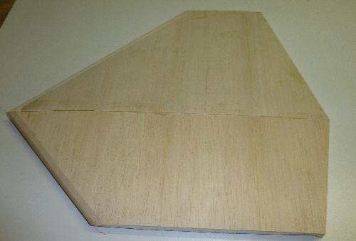

The sheeting is made with 1.5mm balsa. On the next picture, the sheets of balsa are sanded to obtain straight borders, assembled with tape and glued with alyphatic glue.

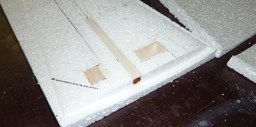

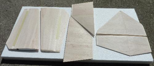

The stab and the rudder are made with foam sheeted with 1.5mm balsa. The two servos for the stab are placed inside the stab.

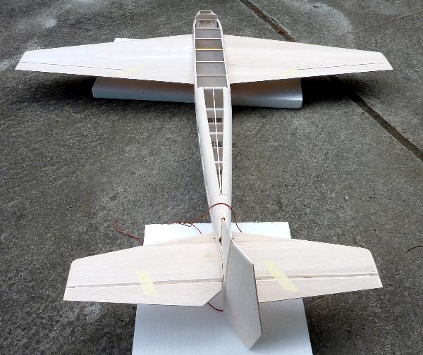

Then, I continue to post some pictures
The stab, the rudder and the small vertical wings are finished!

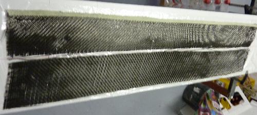

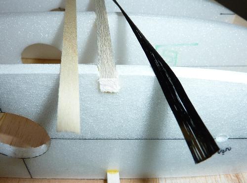

The longerons of the wing are reinforced with carbon, epoxy and a thin hard wood.
The trailing edges are also reinforced

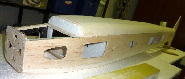

Now it's time to start the construction of the fuse!
The motor, the controller and the Lipos come from china. I know that the small turnigy motors are very good if consider the price. I will test this big one.

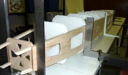

The fuse will be constructed from 6mm depron formers.

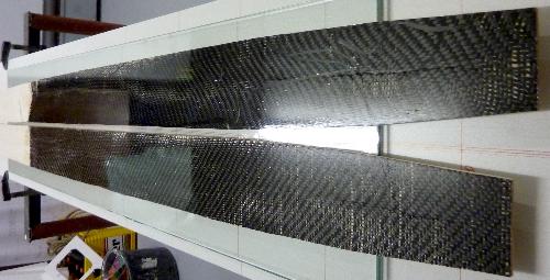

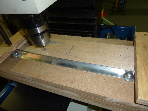

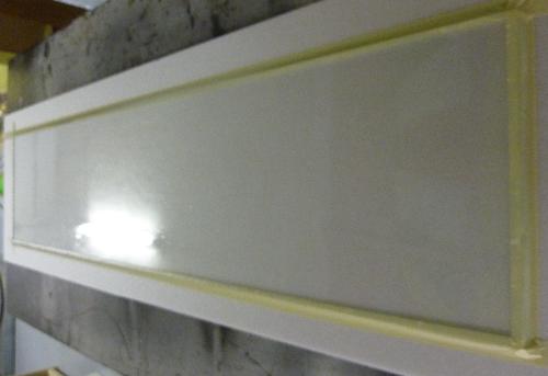

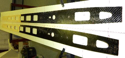

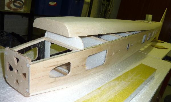

The fuse sides are made with 4mm balsa partially covered by 160g/m2 carbon fabric + epoxy. A glass plate is waxed and coated vith PVA. The two pieces of carbon fabric are imbibed with epoxy and are placed on the plate. Then, the balsa is compressed on the fabric during the epoxy curing.
The holes are made with my new CNC mill.
The work on the wings is also going on.

The construction of the fuse evolves slowly
Any remarks about this construction?

ORIGINAL: geoffroyBelgium
Very interesting, and good work. One thing I have noticed is that when making flat panels, as you are doing here, the PVA is not always needed if you are laying up an a really smooth surface. I have not tried glass, but have done this with 3mil mylar sheet stretched over a smooth surface, and it does not even need waxing. The mylar sheet peels right off.
Old 06-05-2010 | 09:38 AM
Joined: Dec 2008
Posts: 52
From: LiegeLiege, BELGIUM
Default RE: Construction of a 2x2 pattern plane: the ANTI-GRAVITON
Yes it's not necessary to use PVA in addition to the wax. It was just a security because I'm scared to have my stuff stuck on the mold. To have a perfect surface quality, it's even better to avoid the PVA.

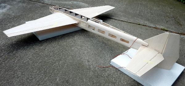

The work is going on slowly.
Still a lot of work...

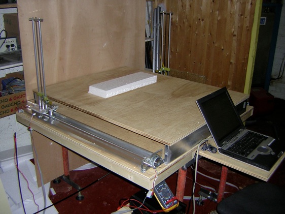

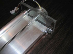

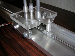

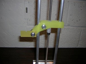

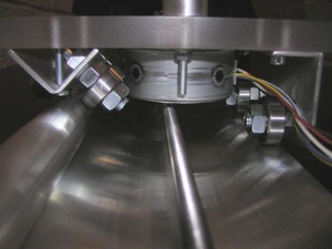

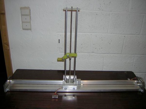

Geoffrroy, very nice thread, keep posting. I like your foam cutter, is it hand built?
Bundu
Old 06-21-2010 | 03:04 PM
Joined: Dec 2008
Posts: 52
Thanks. I need some motivation to finish the work now...
Yes the foam cutter is a selfmade one. Here are some pictures:

I'm approaching slowly the end of the construction. But still a lot of work to do...

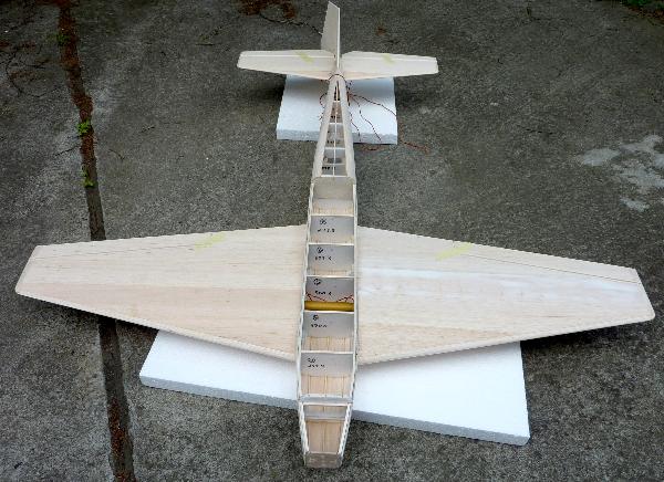

We are close to the first fly!
I can post more pictures if you are interested

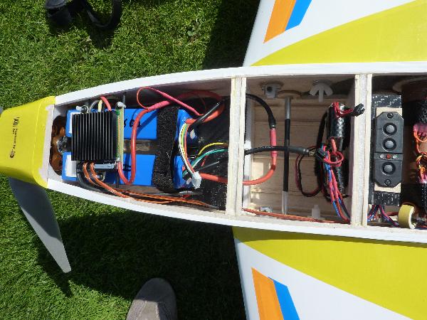

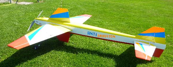

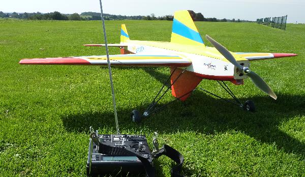

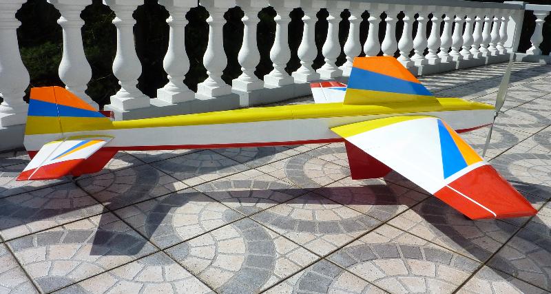

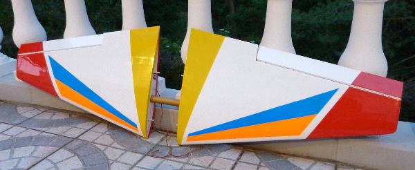

After a crash due to a radio problem (probably induced by the carbon inside the fuse...), I replaced the turnigy motor and controller by an AXI 5325/18, a Jeti SPIN 99 opto controller and an APC E 19 x 12. I keep the lipo turnigy 20C 8S 5000 mAh. I have really more power and the weight of the plane is now only 4.6 kg ready to fly.
I'm really happy. The flying characteristics are awesome.
Someone have some news about Nat Penton?
Thanks to www.insightrc.com for the informations about the voodoo express.
