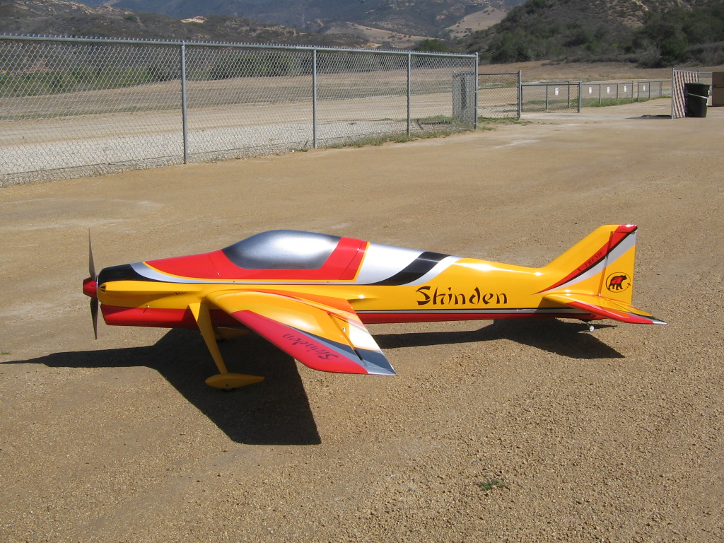

desertrider49 02-21-2014 09:41 PM
1 Attachment(s)
This is my new Shinden. Today's maiden was uneventful, couple clicks of aileron and a couple clicks of elevator. Knife edge went to the canopy so I'll slide the batteries aft tomorrow.
http://www.rcuniverse.com/forum/atta...mentid=1971017
Jeff Worsham 02-22-2014 09:00 AM
Well done! Is it one of the newer "lightened for electric" Shindens? If so, what's the setup and all up weight?
desertrider49 02-22-2014 08:04 PM

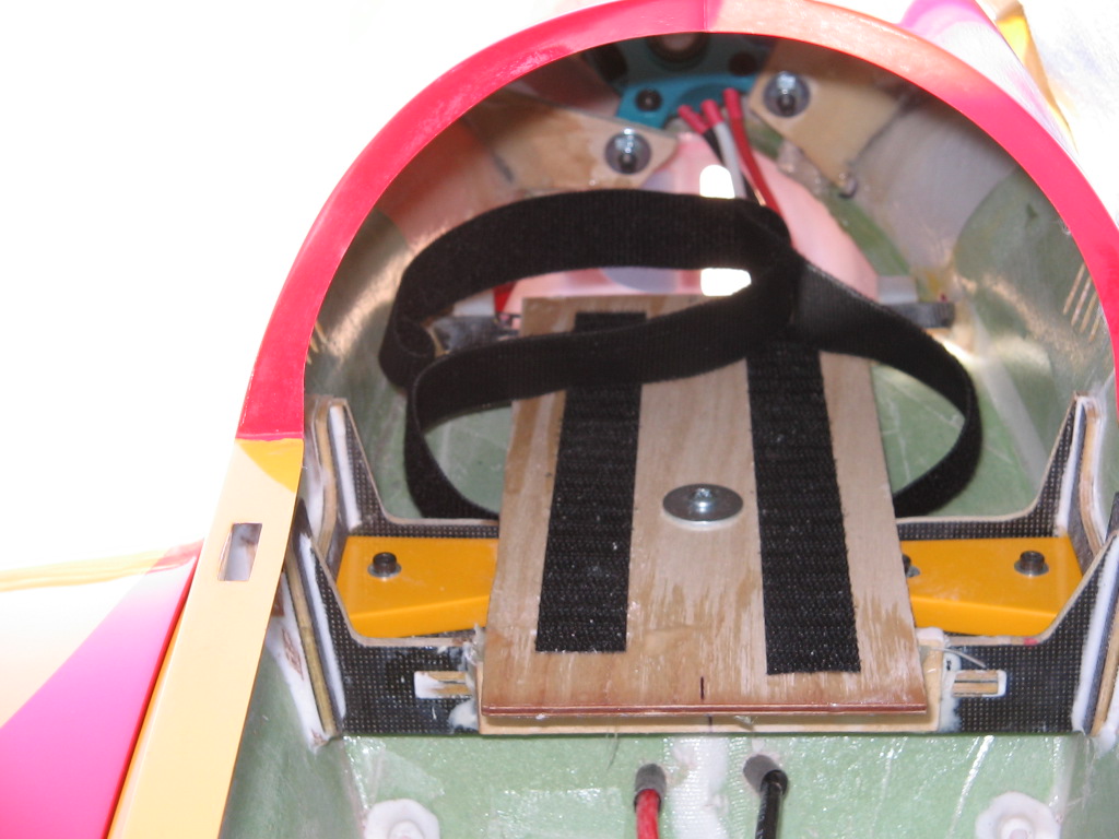

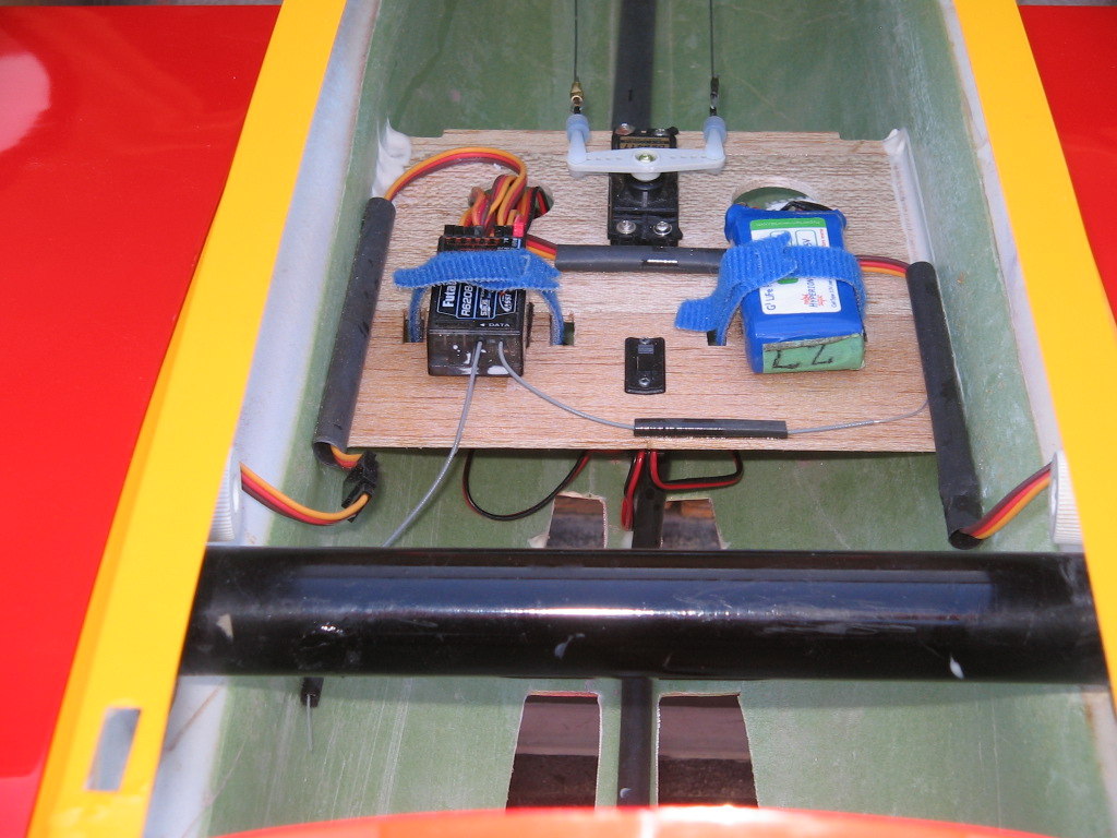

2 Attachment(s)
Yes, it's the electric version. I'm using the Hymax motor, Castle ESC, JR 8411's in the ailerons and rudder, and Futaba 9650 in the elevator halves. I see you are signed up for the Apache Junction Contest, Maybe I'll be there. The weather girl is calling for rain next weekend. Bummer
http://www.rcuniverse.com/forum/atta...mentid=1971337http://www.rcuniverse.com/forum/atta...mentid=1971338Here are a couple more pictures. Weight ? don't know, I'll never be good enough to go to the Nats so weight isn't a concern, BUT it's lighter than my Valiant.
Jeff Worsham 02-23-2014 05:43 PM
Thanks for the extra pics and info. About next weekend, I was going to say "you bring the plane and I'll bring the scale" but what the .......RAIN??? And Sat/Sun are the only days predicted for rain out of the next 10days! I sure hope they're wrong....
