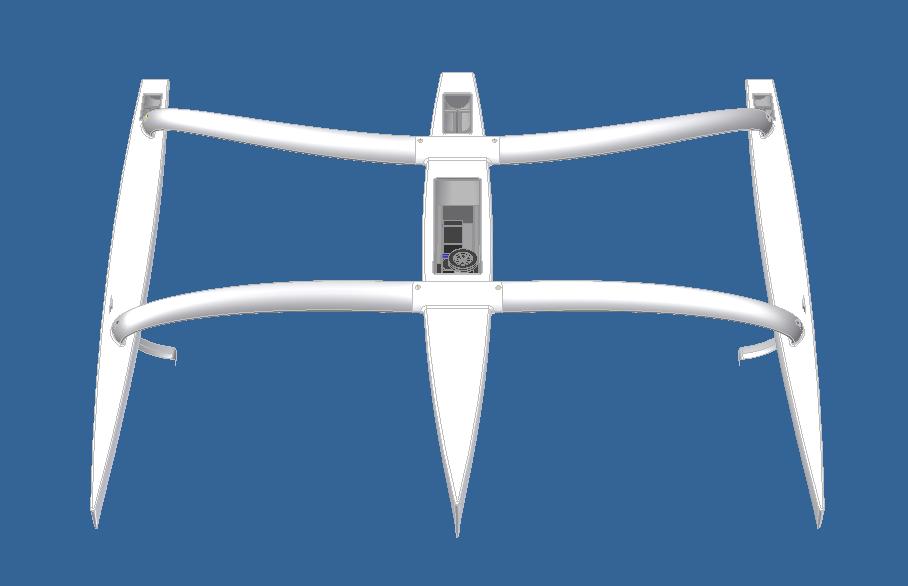

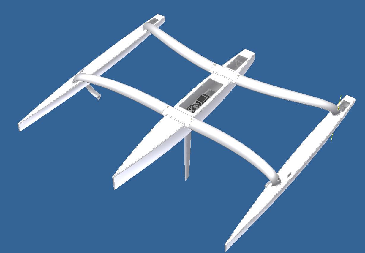

I“m already working on the design of "Nightmare Mk VIII".
All coordinates for new floats (more volume and even flatter keel rocker, higher freeboard at the bows))
and new mainhull (center of gravity even more aftward than before, higher bow freeboard as well)
are already here. Curved crossbars, if desired; - but everything else remains like it was on the Mk VII.
Is there anybody out there, who is able and willing to transform these data sets to a complete Autocad plan?
Cross sections, centerboard position, rc-set-up, rudder steering details, A-, B-, C- and D-rigg-dimensions and so on.
I definitely would need your help here.

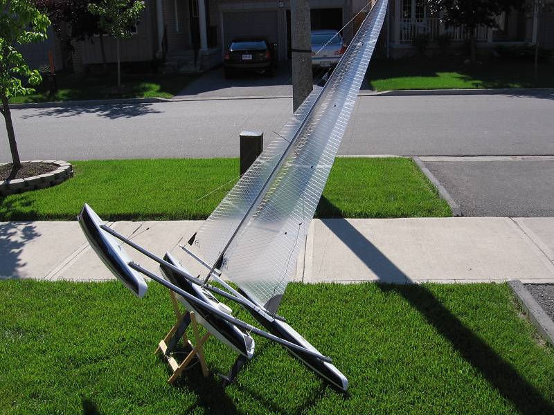

I am starting a new build the "Snapdragon" trimaran using the Traplet plans. I also got the Freight Train plans from Traplet and may try building that one in the future. Has anyone built and sailed the "Snapdragon" and if so are there any pitfalls to avoid. I am a very experienced builder and just completed a USOM. Being an accomplished multihull sailor of catamarans (Hobies, Tornados, Nacras) the thought of building a model multihull was intriguing. The Snapdragon plans do have good template details, but they lack overall details on radio placement shroud attachment and crossbar details. I can certainly overcome this, but if anyone has some thoughts to share I would appreciate it.

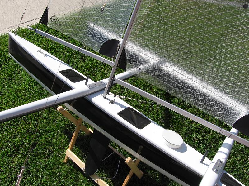

The Snapdragon built is moving along. The main hull is complete- no deck or internals yet. and I've set up the forms to begin planking the first float. I have decided to alter the crossbeams and go to a molded CF reinforced curved beam, versus the straight CF tubes on the plan. I am also going to angle the floats up slightly, versus having the decks at the same elevation. I will be going to a curved deck profile at the bows which will get faired out as it moves aft. This should give it a little more forgiveness if it buries. I'm also laying out the sailplan and rigging details. I'm planning on using a profile similar to my USOM with a B rig sized jib (30%) and a larger more powerful main. It should come in around 1100 sq ins or thereabouts. It should be ideal as it will get sailed predominantly in the lighter winds that we have here. Mini40 - I wouldn't mind getting a look at your latest Nightmare plans/sketches to see were the design ideas are evolving in this class. I've seen photos of the earlier versions and I like the overall look of the design. You can reach me at [email protected]. I'll post some photos of the build as soon as I get a chance.

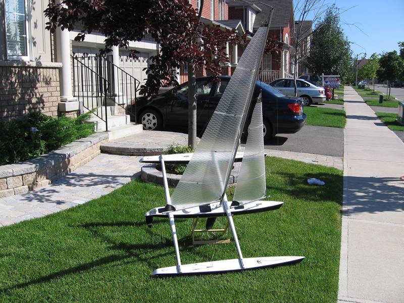

The left picture was made by TomTest:
During the german "Aartalsee-Multihull-Meeting" in 2007,
The left boat (yellow and purple) was designed and built by Karl Schmidt (nickname SKAUT) from AUSTRIA, who just won the latest Multihull-race series in FRANCE!
The boat on the right right side was designed by Peter Gernert (nickname WIESEL) from Germany.
The picture on the right side was made by Eric Gielen:
This is the carbon/epoxy prototype of the "Nightmare Mk. VII,
which was designed by me - Ernst Zemann, Vienna/Austria - and was originally built by me, together with Eric Gielen at Austria - completed with the great help of Karl Schmidt, who took a lot of care for very good sets of sails!

Some more pics. File size limits what can be sent at one time. The boat sails great. It is very quick to accelerate and has minimal tendency to bury the bow. It tacks very well, as long as you maintain a little boatspeed going in. I wish I had taken some pictures on the water but it will have to wait now until spring since my local sailing site is as hard as rock right now. The sails were made to my spec by Rod Carr of Carr sails. He did a great job and the workmanship is first class. The sails measure in at about 1100 sq in. All the rigging is from Midwest Model Yachting and is predominantly Sails Etc hardware - again first class. Over the winter I will be experimenting a little bit with different size fins and rudders. The current rudder does have a "wing" to help drive the stern down and bows up on acceleration, but I will be making several other shapes (mostly longer) and probably try some without a wing. The boat is not "superlight" and comes in around 5.5 lbs fully rigged. I will be building a couple of other new boats over the winter as well including the Nightmare Mk VII and I will be looking at possibly making a series of moulds this time versus the glass over balsa that was used on this tri. That way I can experiment with different cloth weights, including carbon fibre. Looking forward to the next series of builds.
Dear Kerry,
now as I can see the details of your boat i really have to say you did a great craftsmanship job! Well done, man!
And 5.5 lbs. - that should be only 2.5 kgs., if I didn“t calculate wrong - which is also a very good (low) value.
I would be very pleased if you could find the time during the winter,
to build one or two of my "nightmare"-designs and be able to sail them against your current boat next spring!
If you are really into making moulds let me tell you, that I do not ask for any royalty fees if you use my designs -
not now and not for the future.
If you have any chance to get into production with these boats, just do it!
