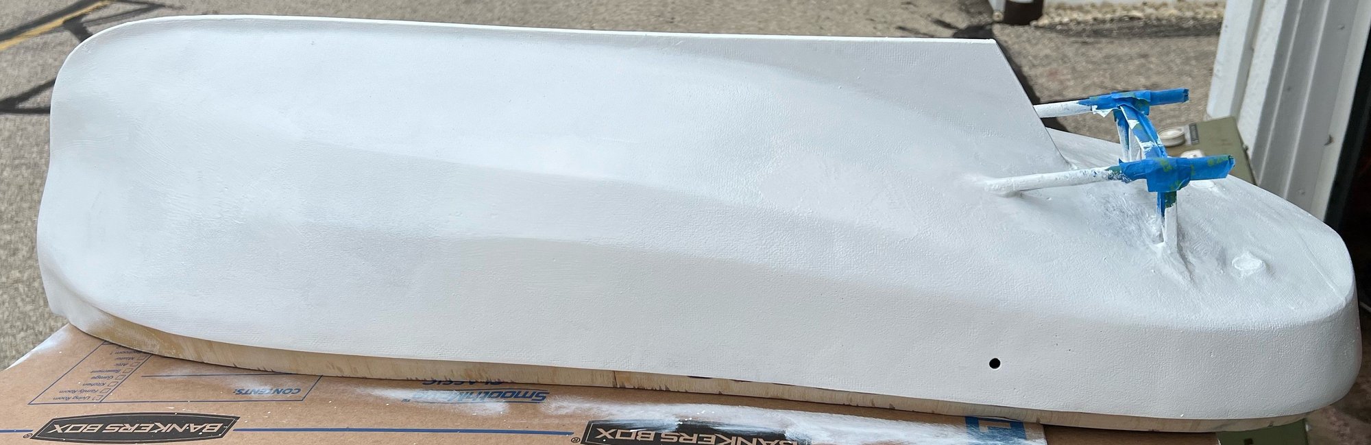

Old 11-06-2025 | 04:36 AM
  #94
Joined: Dec 2012
Posts: 97
Received 75 Likes on 51 Posts
From: La Crosse, WI
So I'm not sure what happened over two years ago, but my photos were NOT uploading on here. Today they work. Here is the first gelcoat layer. I since did more coats, and sanded it smooth. I will still need another layer of gelcoat over that to get the build up I want.
The following 2 users liked this post by birdo:
Browneye (11-06-2025), Super18 (11-06-2025)
