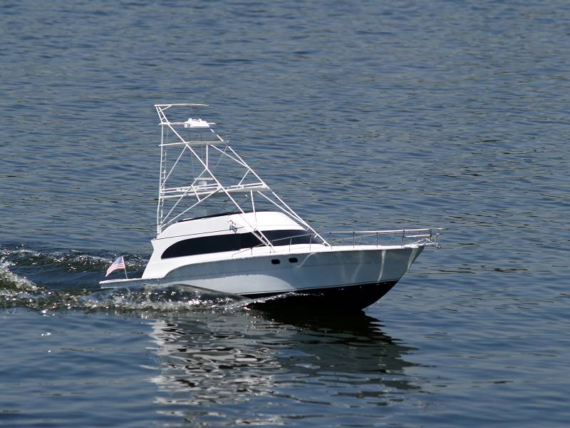

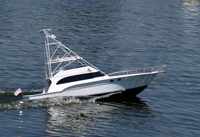

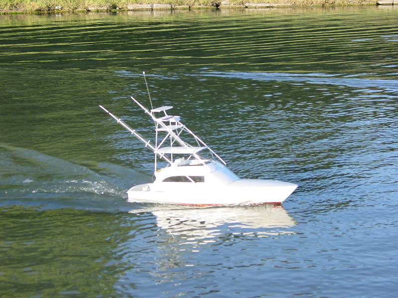

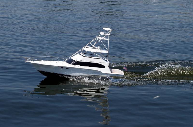

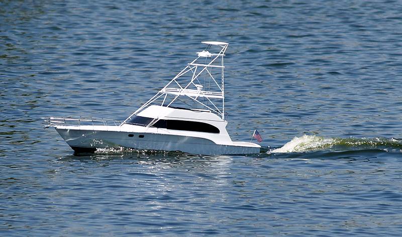

I noticed this thread did not have pictures of my Donzi. Must correct that. Kmot took these pictures and I think they are fantastic.
ID:	548499   Click image for larger version
ID:	548500   Click image for larger version
ID:	548501   Click image for larger version

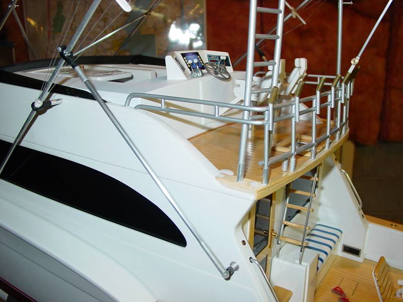

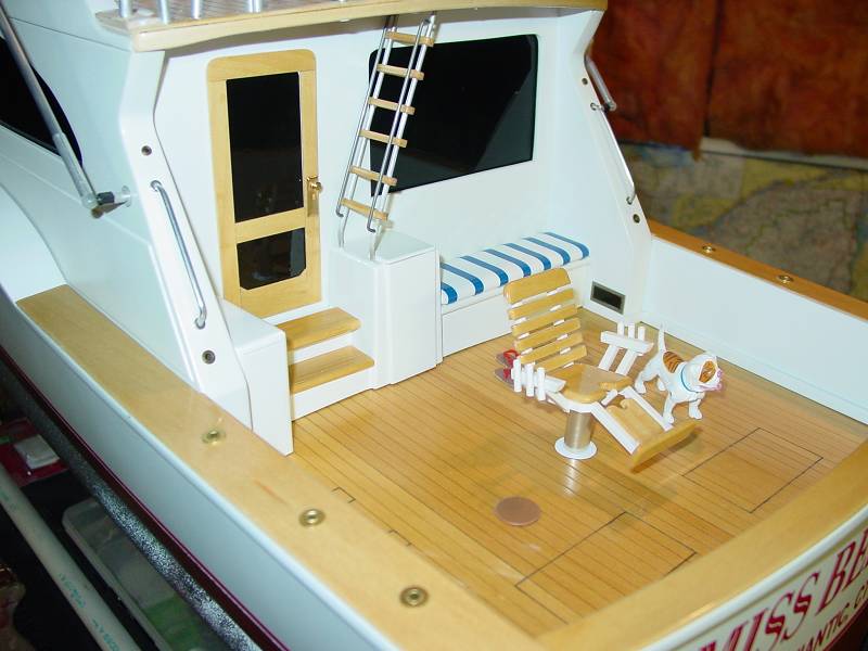

Hey!!since we're showing boats....why not
ID:	548821   Click image for larger version

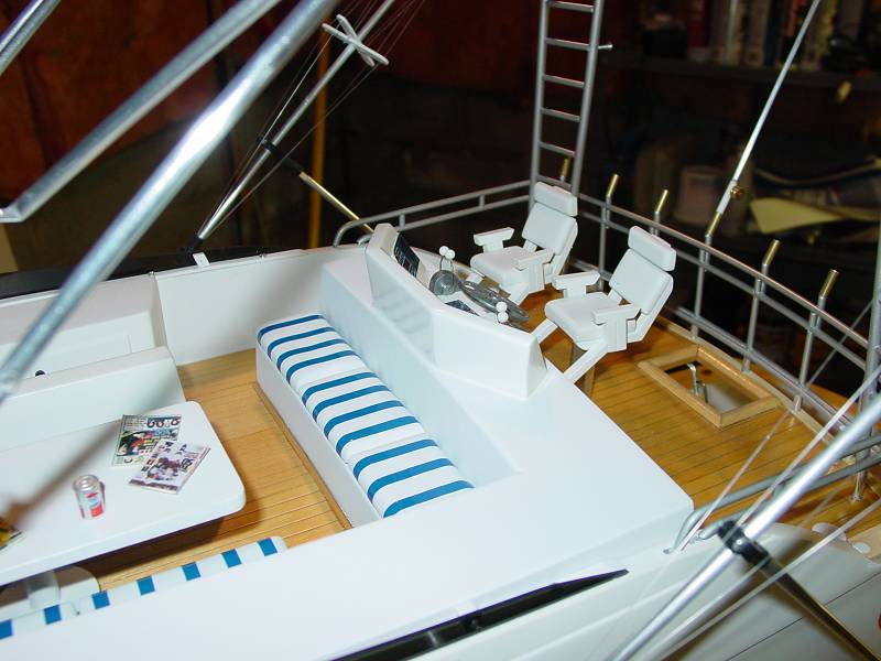

a few more

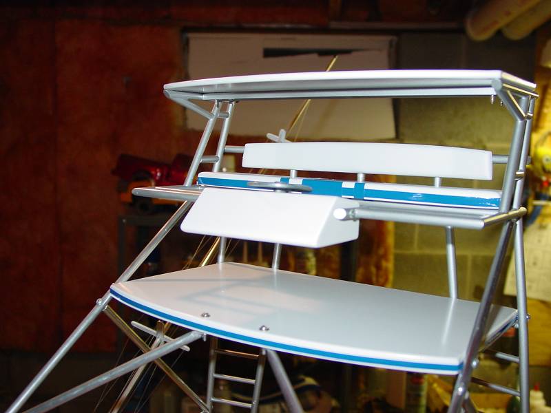

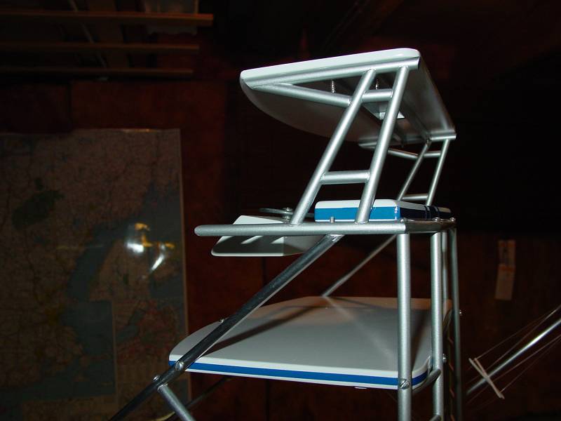

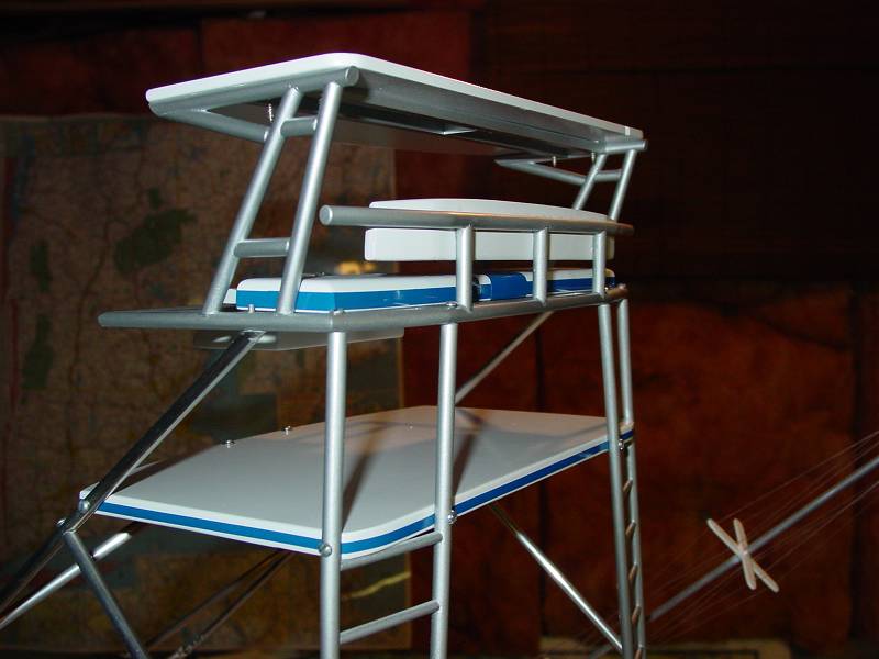

Upper Tower
ID:	548867   Click image for larger version
ID:	548868   Click image for larger version

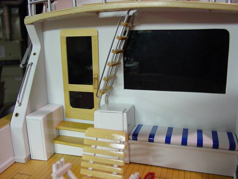

cabin top

bvanter5
Where did you get the screws for the tuna tower, what was the price, and approximately how many screws did you use for the tower?
Old 10-31-2006 | 11:02 PM
  #144
Joined: Aug 2004
Posts: 91
From: Middletown, CT
Default RE: Donzi
Brent, I counted about 30 screws, I couldn't remember the size. However I picked them up at my local Ace Hardware store. These screws are so small that they kept them behind the counter in sorted case. They were also priced about 5 cents a piece. Are you building a Donzi...can you post some pics?

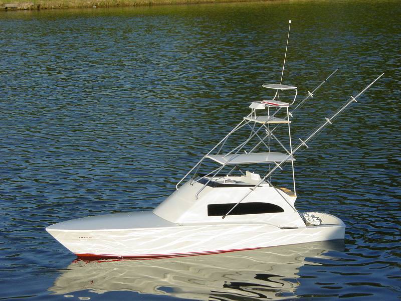

bah, this is my next project, I need to finish my chris craft. u163665-those pics look real, if I saw that in a boating magazine, I wouldnt think it was a model for a second. very nice!
