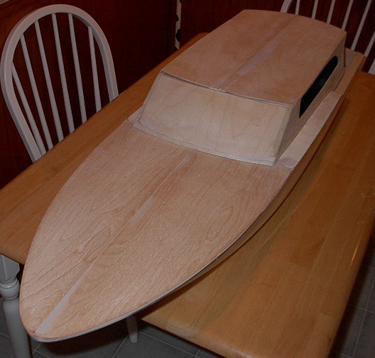

Old 11-15-2006 | 10:12 PM
  #183
Joined: Aug 2006
Posts: 9
From: McKinleyville, CA
Default RE: Donzi
Finally as promised, here is my Donzi as it stands today. I'm pretty happy with the progress considering I have no building experience. I was suprised at how hard it is to get everything all squared and lined up. I've had to do a lot of fudging (for example the front of the windshield did not line up so I had to make a few creative adjustments). Right now I am trying to make the back deck line up with the transom. Oh well, guess that what makes this model worth it in the end.[>:]

Questions for anyone..... On Step 24 the directions state "Make up the marking guage in Fig. 8. Use the guage to draw a line on the FB deck 1/16" in from the edge of the cabin on both sides. Use the guage to strike a line across the front of the FB deck." I have looked over the blue prints in Fig. 8 and for the life of me I do not know (and don't see) the marking guage mentioned in the directions. Does anyone know exactly where they are on the plans and what is the marking guage? Also my FB deck did not line up right on the front of the cabin. One side is flush with the front of the cabin and the edge on the other side sits back approximately 1/4". Is this going to be a problem or should I build up an edge level with and flush with the front of the cabin using Bondo?
Last question....On step 25, I understand cutting the strip to match FB-3, which is later called FB-1. Now does FB-1 positioned on the edge of the cabin and then trimmed flush or is it set in 1/16" from the edge of the cabin? Long winded questions, sorry, but any help would be greatly appreciated.
Old 11-18-2006 | 12:38 AM
  #189
Joined: Aug 2004
Posts: 91
From: Middletown, CT
Default RE: Donzi
Brent, I ordered a new fresh manual from Dumas, and they have deleted part of the directions you refer to. Section 24 now starts of with....
"Draw a line on the FB deck 1/16 in from the edge of the cabin on both sides"............
This was deleted on the updated manual - "Make up the marking guage in Fig. 8. Use the guage to".....
Section 24 is to help you determine true center of the deck and the proper placement of the FB-1's
let me know if this helps
B
Old 11-18-2006 | 12:44 AM
  #190
Joined: Aug 2004
Posts: 91
Default RE: Donzi
Brent to answer your second question.....the FB-1's are set in 1/16 from the edge....hence the direction to draw the line 1/16 from the edge to gauge this in section 24. You can also refer to FIG 11 on the plans...it gives you a cross cut of the deck...look for the FB-1's, this might help make a little more sense.

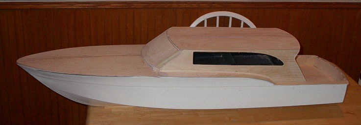

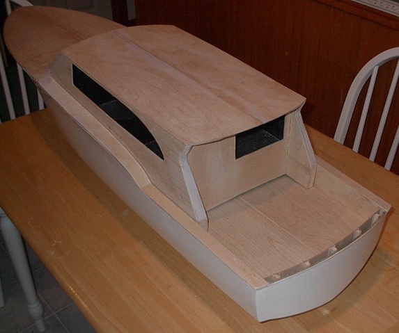

Added a scratch made diving deck made out of styrene plastic

looks very nice, and scale too.....could also add a swing-down ladder, but that may be going too far, anyway, just an idea...

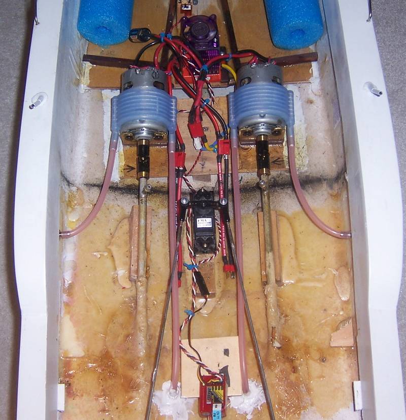

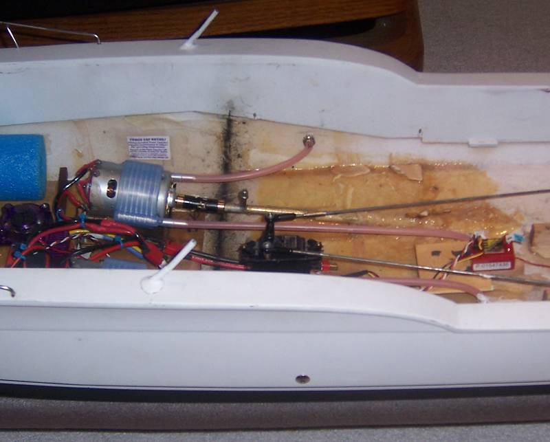

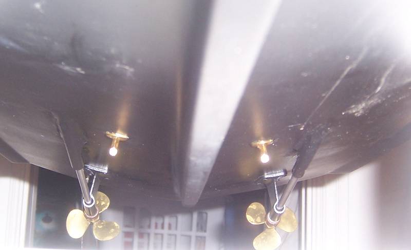

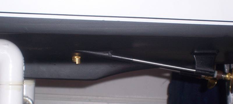

Water cooling.
This is my new setup for water-cooling - just tested today - perfect SoCal HOT day. These silicon jackets do a superb job of keeping the motors cool. I am taking on a little water - now to find that leak!
I bought the cooling jackets, Prather water outlets, and Octura streamlined water intakes from www.offshoreelectrics.com

you may also want to consider a pump as the water will pass through, even when at slow or no speed

I was a witness. It worked great!!
