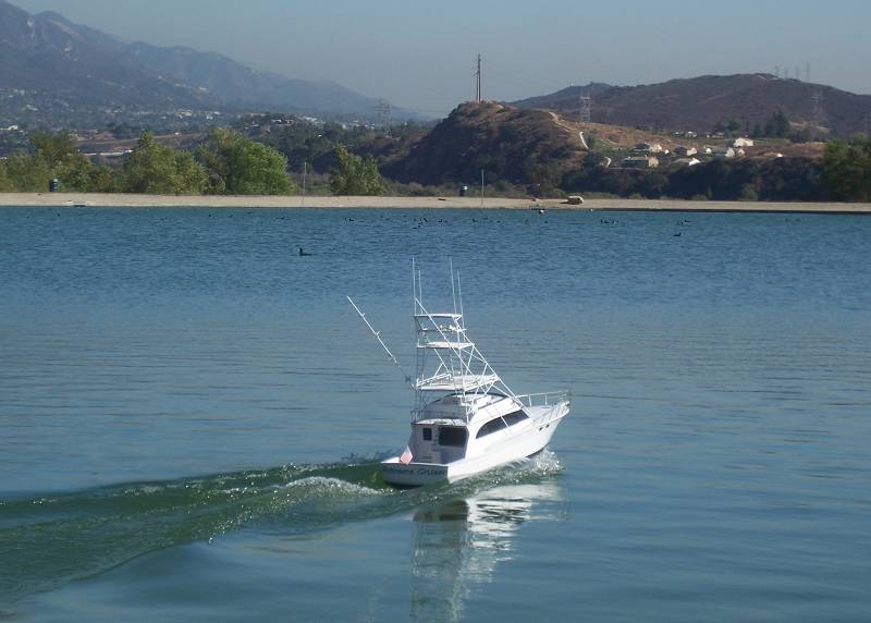

I took some onboard video from my tugboat (thanks to the help of Kmot) today at Hansen Dam - - different perspective of the boat.
http://www.youtube.com/watch?v=GWWgu841m2E
Pictures below.

u163665....she looks great in the water, I will take some pics tonight or in the morning, and post them tomorrow. I tried viewing the video, but it was still in process.

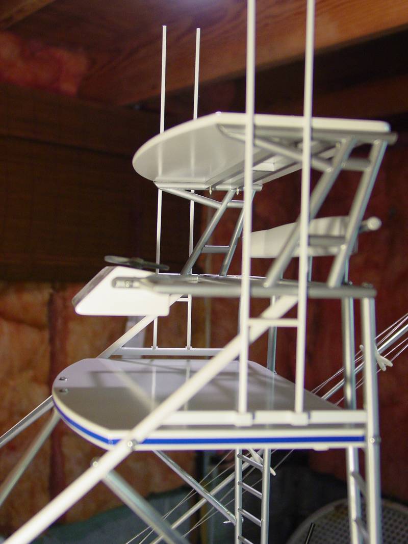

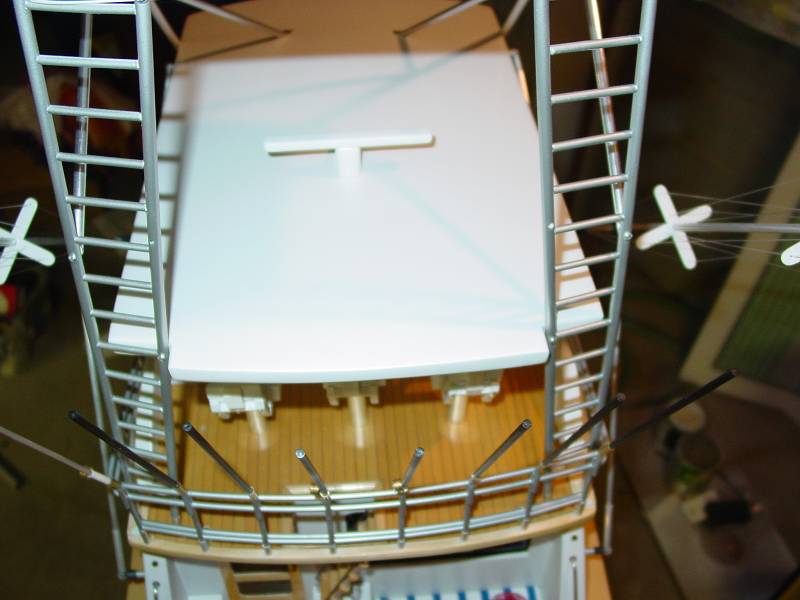

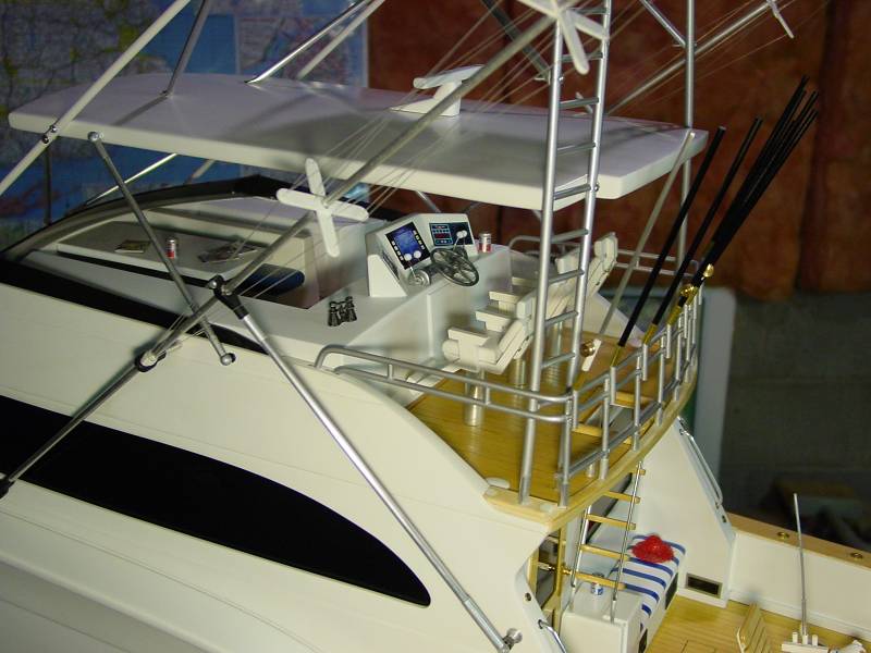

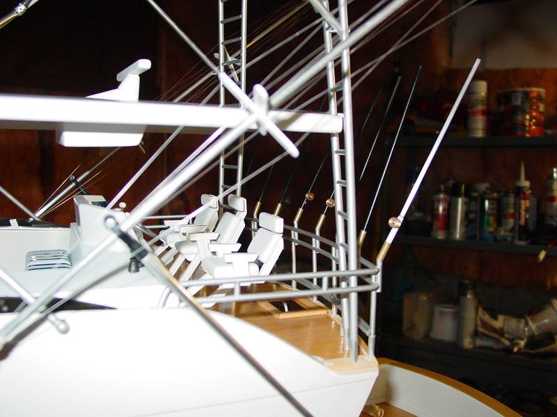

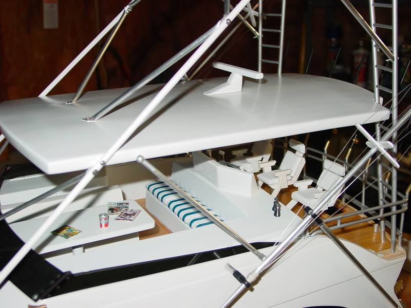

Here ya go....some updated detail added to the cabin and tower

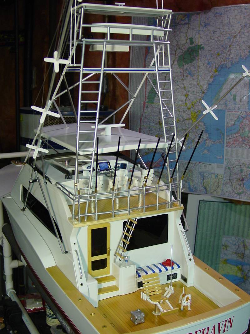

I have to do 3 pics at a time....RCU can't handle the large pic files

From: Middletown, CT

bvanter, how did you make the seats on the second level of the superstructure?? and are you using the wooden dowels or the meatal rods??

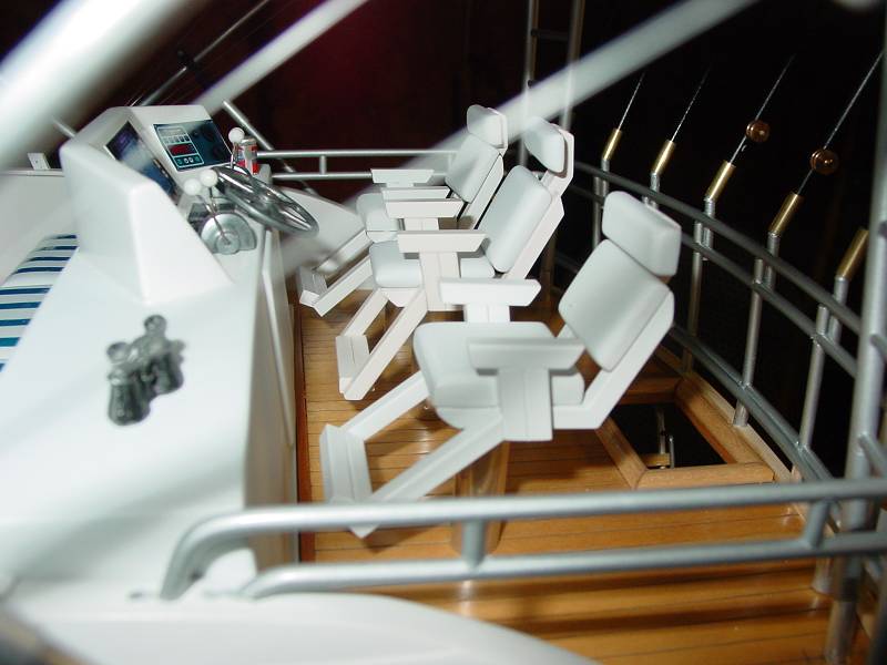

Default RE: Donzi
saleens7, I have been looking for the dinghy, but haven't found the right scale.
The chairs were scratch made using styrene plastic for the frames, and balsa for the cushions.
The tower super structure including the tower bridge was made of Styrene rod or tubing. I found this much stronger and resistant to impact that wooden dowels, and also easier to work with than aluminum tubing. If you go that route be sure to use the correct bonding solvent ( CA is not the way to go ) . The correct solvent actually melts the plastic styrene at the points of contact...which allows the plastic to become one piece.
I used Tamiya plastic spray paint...which also bonds to the plastic in the same way
My hull is fiberglass...which was purchased a few years ago. I heard that Dumas is migrating their hulls to ABS....however I couldn't even find the Donzi kit on the Dumas site.

Thanks for the kind words everyone.
saleens7...I used 3/16 size for the tower structure . I don't have any of the old packaging, but I believe I took a 3/16 aluminum rod and matched it as close to the Styrene rods

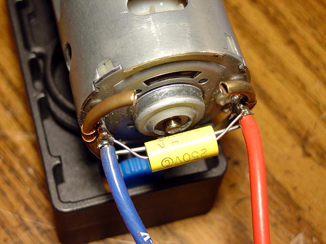

Matt,
That Gundert silicone cooling jacket requires you to seal all openings in the motor first. You should consider brush cooling as well. Most of the heat is generated there.
