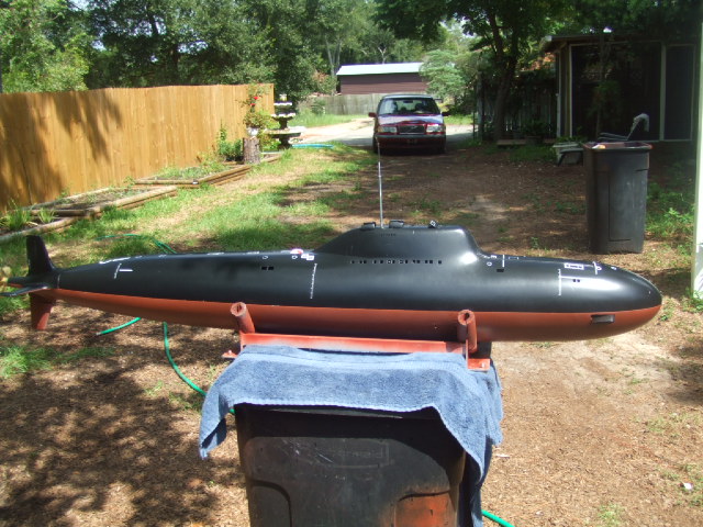

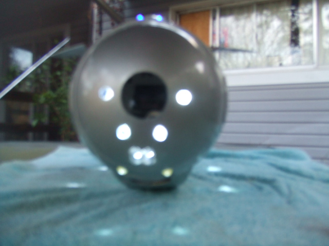

Thats good but try 2 to 3.5 hours of continuese running under and on top in a city pond 180x 80 mtrs and 12ft deep even has a young Aligator or in cristal clear 72 degree year round river spring water ,the current is a blast to run along side of the pontoon boat and run without moving over any ground!
Nedles to say the sub must run good!

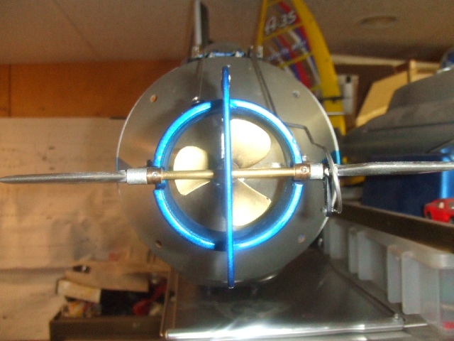

Here is my Octura and 5ft Alfa,compressor bassed ballast system.http://www.youtube.com/watch?v=hdXQb856Vf0

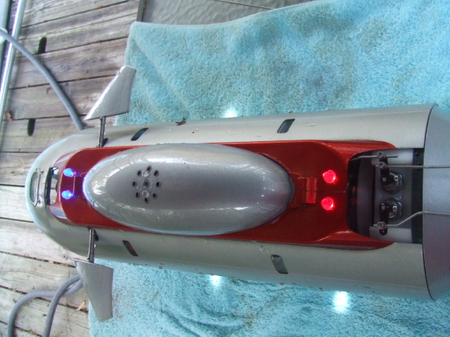

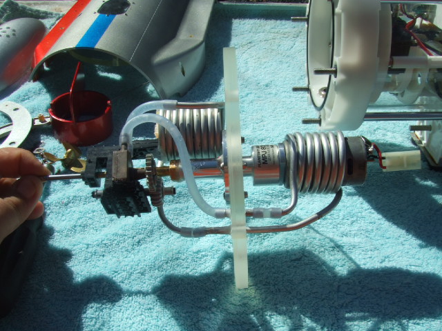

Some more at the Spring
http://s82.photobucket.com/albums/j2...nt=genfish.flv

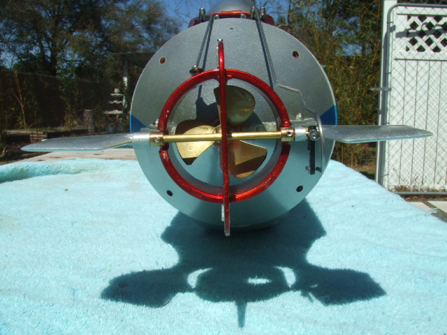

These videos where taken with the SB-2 a ThunderTiger sub called SB-1,I modified extensivly for these deep dives and cave deep dives.
A fantastic sub that is inexpensive super reliable and easy to modify and improve its performance,great dive system!

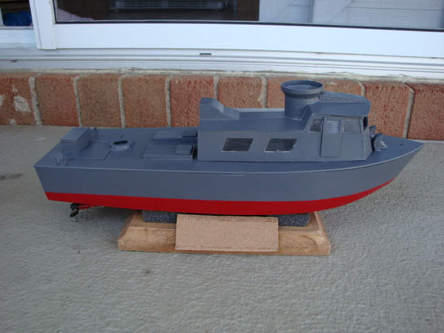

Old 01-08-2010 | 05:16 PM
  #37
Joined: Nov 2005
Posts: 650
From: Buenos Aires, ARGENTINA
Default RE: New ballast system
Thanks. An article related to another RC convertion, a 1/125 Fletcher class destroyer, the USS Johnston (Battle off Samar) was sent to MMI, I hope to see it published soon.
And now I am in the process of scratch-building a PCF "swift boats" that were used in Vietnam. MMI is waiting for me to finish it to have it published.
Regards
Robert

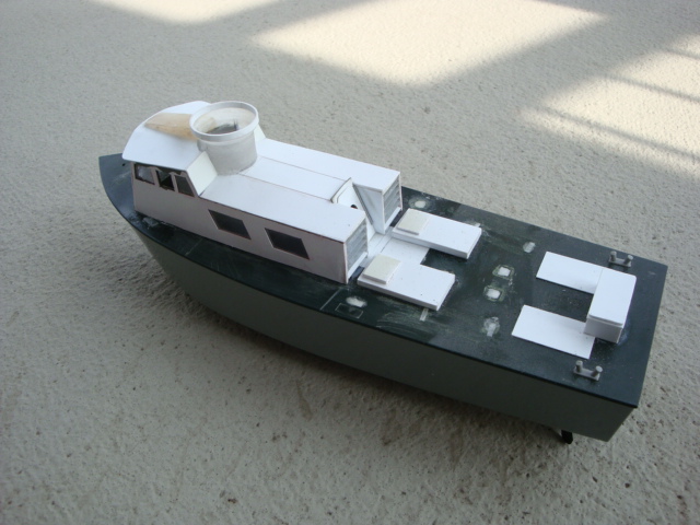

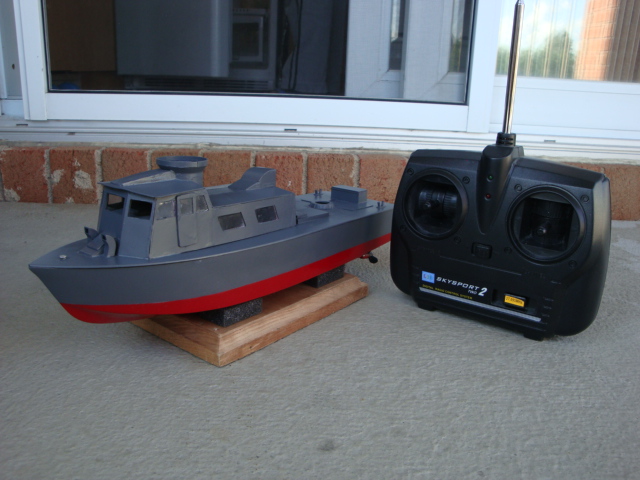

ORIGINAL: rva1945

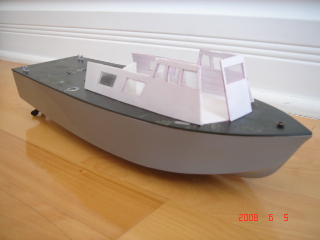

And now I am in the process of scratch-building a PCF ''swift boats'' that were used in Vietnam. MMI is waiting for me to finish it to have it published.
Regards
Robert
Ahh gotta love those little PCF's! Had a semi-scale Vosper patrol boat that I purchased one summer, modified the lower hull and and scratchbuilt a new superstructure and a few deck details. Haven't added the railings yet but hoping to do that soon. She is approximately 1/45 scale, the lower hull isn't exactly to scale... but heck, its good enough!
