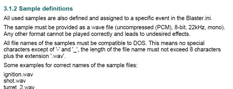

I have some experience with Elmod Blaster III only, but I think it is similair
1. First of all You need Micro SD card reader ( USB version?)
2. Remove SD card from Blaster , place it into the reader, and connect the reader to PC. The content of the SD card should appear as aaditional drive in Your system (Windows?). Now You can copy and delete all files stored on SD card
3. Backup all original files stored on SD card onto Your hard drive.
Blaster gives opportunity to use up to eight different sound tank projects. Each sound project is stored in folder named 111, 110, 101 etc. Name of the folder refers to jumpers J1, J2, J3 position on Your Blaster module /Jumper J4 is not used in sound selection/
For example
J1 J2 J3
1 1 1 Tiger1
1 1 0 Tiger 2
1 0 1 Tiger 1
1 0 0 Panzer IV
0 1 1 Panzer III
0 1 0 T34
0 0 1 Panther
0 0 0 Abrams
1- jumper closed
0- jumper open
Each sound project stored in folders 111, 110 etc consist of several "wav" sound files (8 bit 22 kHz). The configuration of sound files is stored in text file named "blaster.ini" . See attached file for details
File Type: pdf

1. each wav file name should be compatibile to DOS - max 8 character lenght
2. wav format must be 8 bit , mono, 22 Khz
3. file name in blaster.ini and in folder must be the same
see atachment

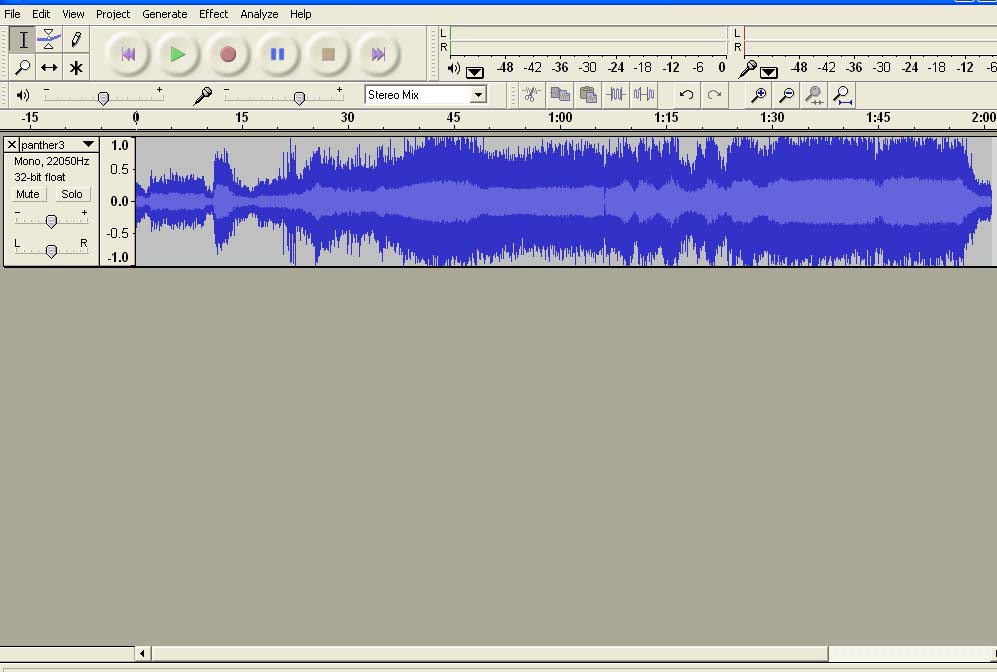

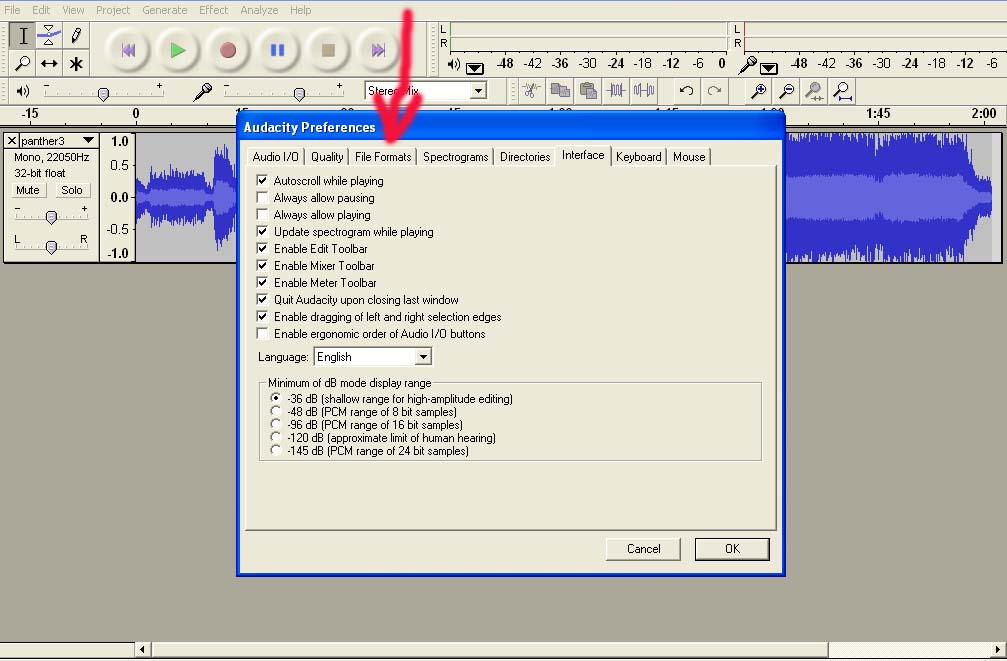

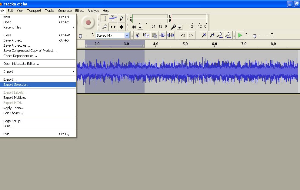

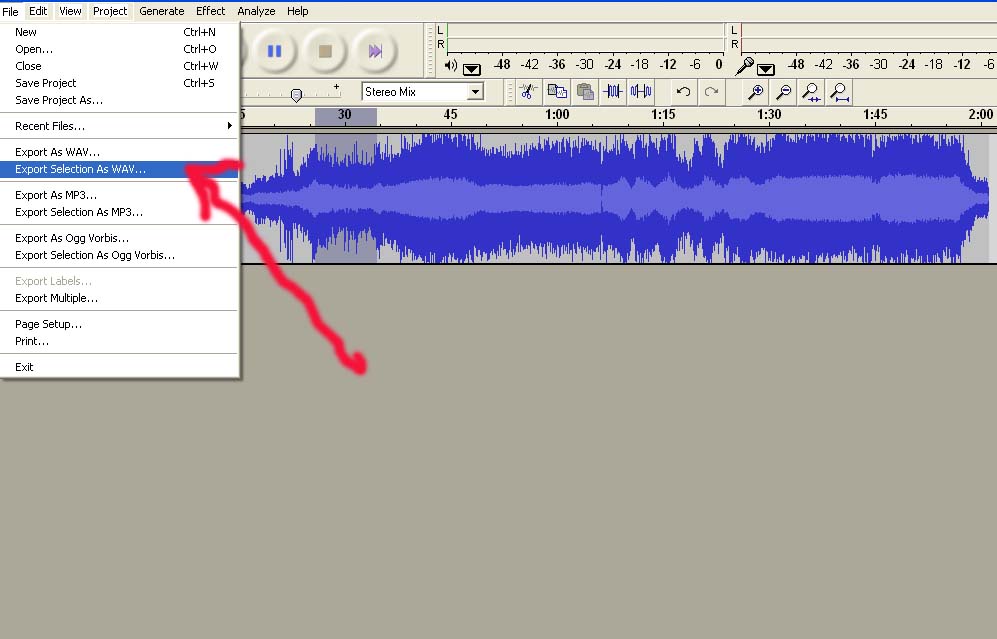

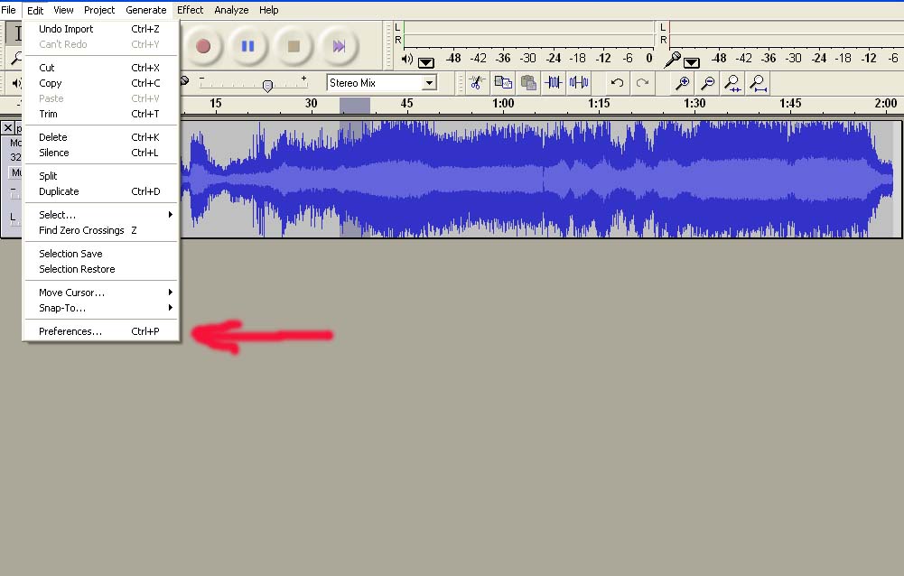

Example how to convert mp3 file into wav, 8 bit mono using Audacity v1.2.6 software
- open mp3 sample
- set in Audacity Preferences valid output wav format /Edit- Audacity Preferences - File Formats/
- select fragment of sound file
- export selection as 8 bit wav mono

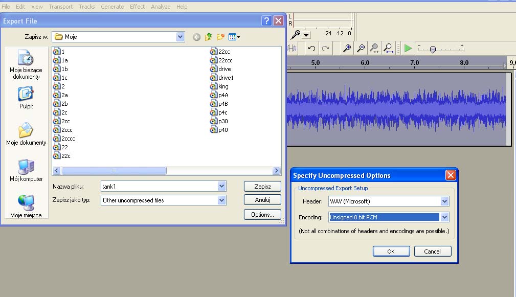

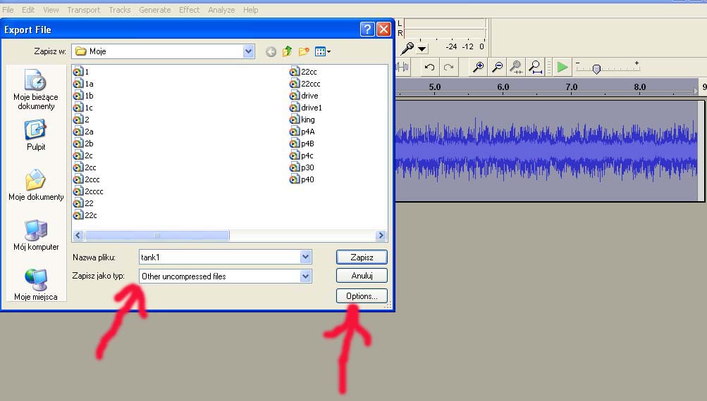

And the same with Audacity v 1.3.11 beta /how to set proper output wav format/
Export Selection / choose "other uncompressed files", then press button "Options" and set proper wav file format/

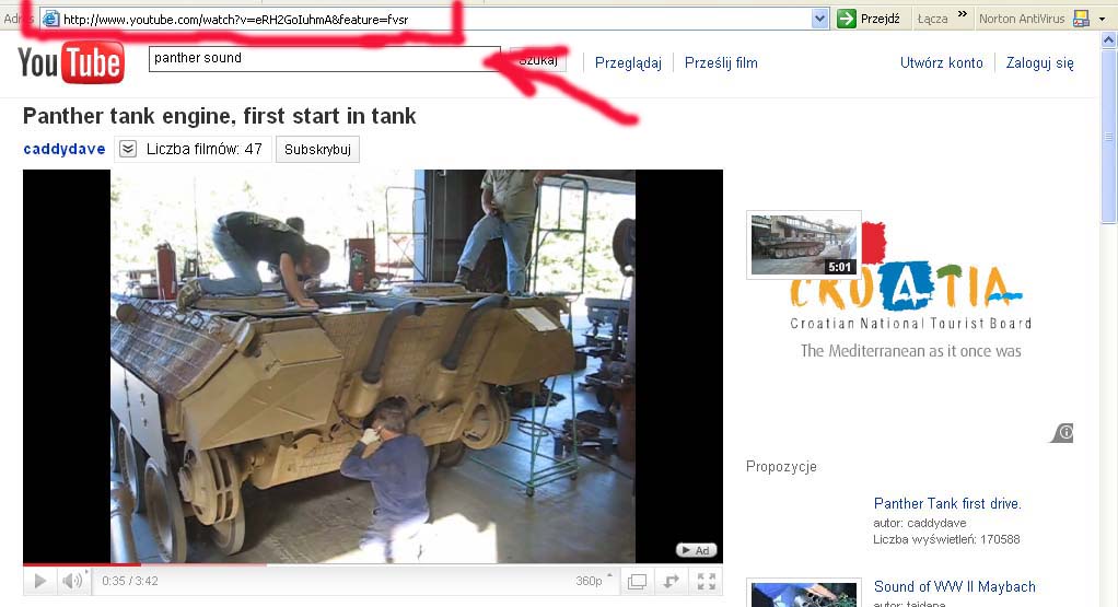

For example You can use keepvid.com
1. open choosen video on Youtube
2. copy URL adress of that video and paste it into www.keepvid.com (URL dialog)
3. push button Download
4. select desired video format - for example flv - low quality
5 save the flv video file onto Your hard drive
Later You can extract audio track from such flv video using free Any Video Converter software and save it as mp3
http://www.any-video-converter.com/p...or_video_free/
The next step You can use Audacity software opening this mp3 file, edit and convert it to wav 8 bit mono
