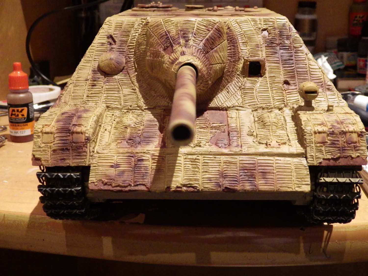

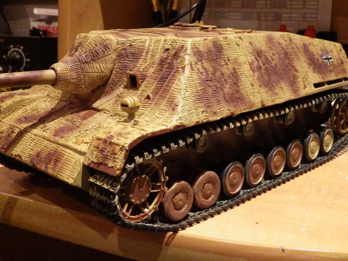

Jagdpanzer with FPV
Joined: Aug 2011
Posts: 1,063
From: Cambridge ON, CANADA
Yeah I said it, this is the first 1/16 scale FPV system available that would take a few tweaks and you can pop it in almost any tank. My prototype is a Jagdpanzer because it had lots of room and an FPV system is perfect for a TD.
I will have this ready with this in about 3 weeks, still early but I am getting very close to having a finished system that will be very easy on the wallet, cost will be somewhere around $250
Real time video and recordable on a Micro Sd card, I am using a 32gb card, so far I have recorded 9 minutes of video without a hitch. The card will do more for sure.
Here is the tank the system is inside, I had to enlarge the drivers port for the camera but that is a small sacrifice for high definition video of my battles. Targeting tanks with the IR system using the camera is childs play.

Guys this is a 5.8 ghz system with 9 seperate channels so max players would be 9 at current but I do not forsee this limitation in the near future.
Range of the unit is roughly 300 meters line of sight, but it can get sketchy with obstructions in the way ( it is 5.8 after all ) the radio running it all is 2.8 ghz and has oodles of range and model matching so you do have the potential to Platoon up to 15 tanks at one time
, switching from one tank to another takes all of 5 to 10 seconds.
Battery life - so far I have recieved about 2-1/2 hours on one charge, currently I have the camera running of a 3S lipo but I have devised a hookup that plugs into the on board 7.2 volt. How this will affect life is unknown but I don't forsee a life reduction that makes the system unusable. There is onboard sound as well and I will have a tweak done so it picks it up directly from the speaker so that any engine or gear noise is washed out.
I will be doing a video shortly that is more of a planned thing and I hope to be able to show the radio ( The radio has a 3.5" high def screen built in ) running the tank on a split screen with the drivers port on one half.
