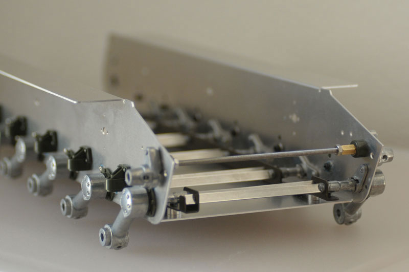

Bill, I recommend a turnbuckle or metal bar to go between the return idler mounts on both sides up front. The thickness of the hull here is no different from elsewhere, yet it has to withstand a lot more stress, carrying the track on their return run, as well as bearing the brunt of collisions with rocks and terrain. A long metric threaded shaft and a few nuts would do the trick bracing up the front by tying both sides together, kind of like the solution that Impact created for the KV-1 (you can't use this plug-and-play as the hull widths are different between the KV and the JS though), this picture I borrowed from Pcomm from a thread from another forum.

  #38
Joined: Feb 2015
Posts: 421
From: Quakertown PA
Not a bad idea I think that what I'll end up doing is get a pice of metal and span it between the mounting posts of the lower glacious. I already have a mounting point there and it should just take a few screws. That would effectivly give the front a solid piece of metal to brace the front. Good call.

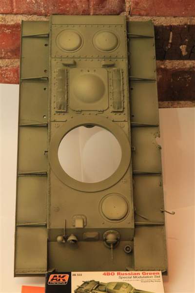

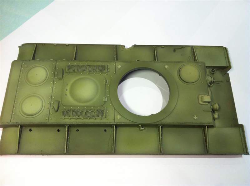

Great build, fun to watch and follow. I love the engine sound and possibilety to 'rev'
About Paint. Here are a few photos of my HL kv. I did it With the AK 4BO set and vallejo Russian green ( 71 017 ) .
it's ready for airbrush( I use the cheapes HK one) and it spray's on rather good. All the brands have some sort of 'set's' these day's so it bee vallejo, AK , ammo(mig) ore what ever, you'll find something
