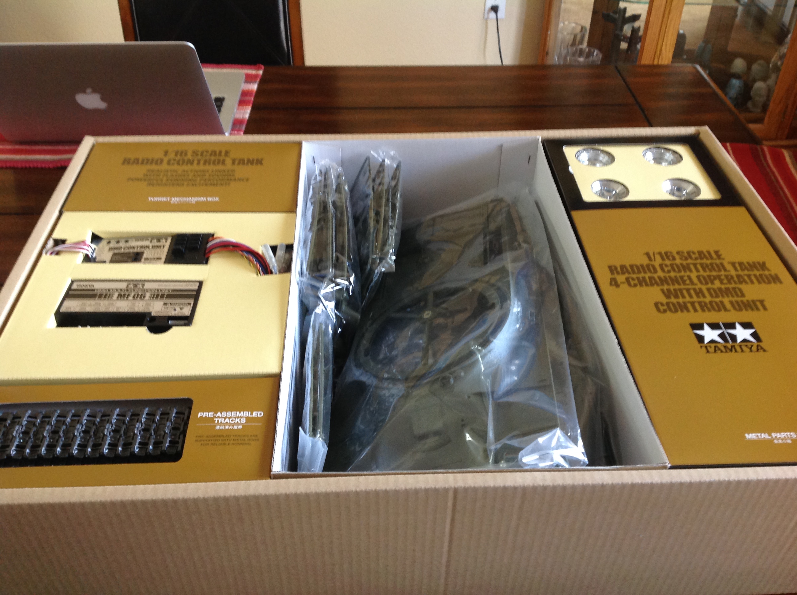

Old 04-03-2015 | 01:33 PM
  #97
Tanker 10's Avatar
Joined: Oct 2014
Posts: 888
From: Roseville, CA
Originally Posted by sergeantseabass
I think it looks pretty complete. besides adding extra stuff. Everything on it is pretty solid. The only thing that i did upgrade was the bushings to bearings. it was like a $20 upgrade. but that was it. everything on mine is completely stock. It runs good. I'll see about posting up another video of it with some close ups so you can see. just keep in mind I don't plan to tear it down to paint for about week. i still want to bask in it's glory before i do. But i'll see what i can throw together.
Look what showed up today sarge. Ordered last Sunday night, here around 1PM today.
ID:	2086057   Click image for larger version
Old 04-03-2015 | 05:14 PM
  #98
Joined: Feb 2015
Posts: 421
From: Quakertown PA
awesome. They are pretty darn quick like that. One thing that won't matter until the end. I missed this until after i finished and by then I didn't care to much. The side steps/ railings. You should have a metal set in there. It comes in the the turret mechanism box. I saw them and thought that they were servo adjusters. You have the plastic ones on the sprus. After messing up once or twice because I went past the instructions I wasn't about to make the same mistake. They are part MC 14. I might cahnge over to those before I paint. Anyway congrats on the new tank. can't wait to see it come together.
Bill
Old 04-03-2015 | 05:27 PM
  #99
Tanker 10's Avatar
Joined: Oct 2014
Posts: 888
From: Roseville, CA
Bill
Thanks for the heads up on MC14 Bill. I will probably start on it tomorrow. Thinking of trying all electronics first however, what do you think?
Old 04-03-2015 | 05:48 PM
  #100
Joined: Feb 2015
Posts: 421
From: Quakertown PA
That is actually a step onnce you get the lower chassis built. It covers all the wiring of the channels. Aslo of not there is a bit in there that tells you to set the receiver. You don't need to do this since you are using the one that it came with. Also something to note that i didn't realize until Herman pointed it out. The system has a hand brake built into it. Once you get the lower chassis together and the main electronics put in and wired up and you go to test the drive train. You have to put the throttle trim all the way down and then give the tank full reverse for about a second. This will disengage the handbrake. Then just move the throttle trim to the center and drive off as normal.
See as how you have to build the speaker box i would just wait until you get to the step to try out all the electronics. it will be more rewarding when you can hear them and then actually see when you throw it in the tank. Also on the elecronics. Just place the DMD and TK where they tell you. The tank is to shallow to stack them, and you have to put the TK pretty far forward. I put mine to right before the idler adjust screw. That way I could still get to it. IT gets tight in there pretty quick once the wires start to pile up. But it comes with zip ties and you can always buy more if needed. Enjoy
