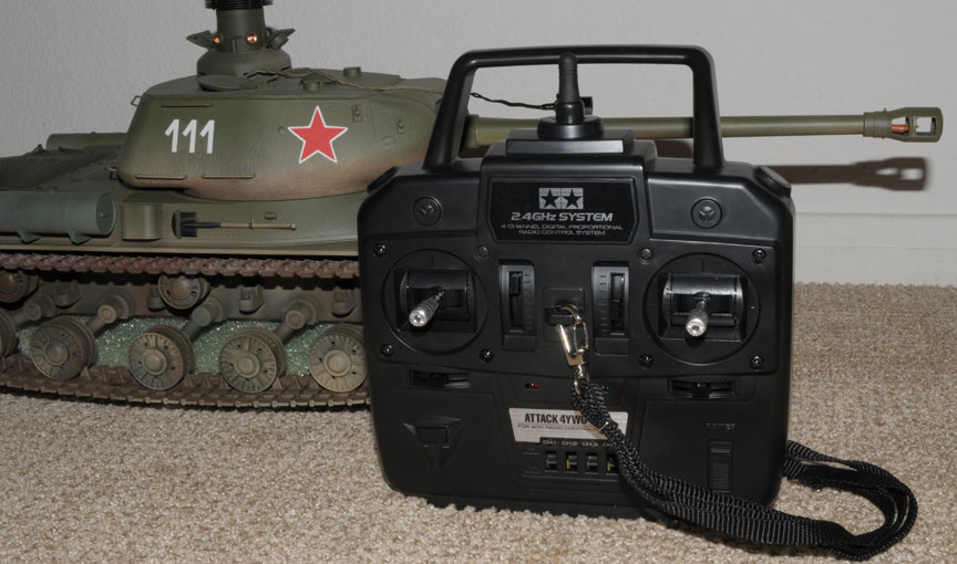

Not a bad TX that comes with it. Self centering sticks all around is a plus, plus very easy to solder in a fire button down the road.

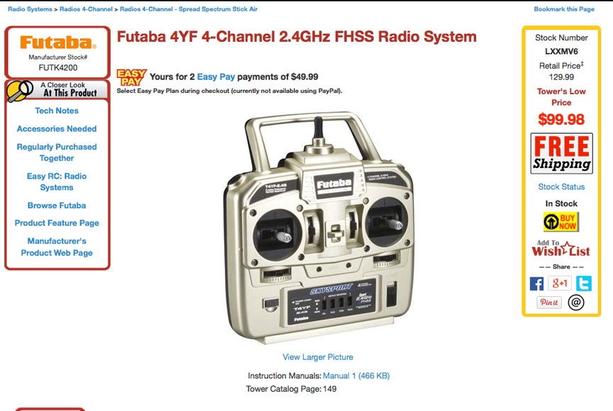

"As far as the tx/rx combo they are only for the Japan market."
FYI clarification, not true:
The kit itself is called a Japanese Market kit, but the Tamiya JS-2 Japan market kit 2.4 radio (in a black case and branded Tamiya) with a left stick self centering spring installed, is the same radio as the silver case Futaba 2.4 sold in the USA and the USA radio does not have the self centering left stick installed.
That is the radio transmitter difference. Get the Futaba 2.4 left stick self center parts here in the USA:
Hobby Services
1 217 398 0007
Parts Needed:
1. HSP78901 1M10A18201 ST-53 Swing Arm
2. HSP67450 8M00F01002 ST-41 Spring
Also, the kit includes a battery charger that does not work in the USA unless you have a voltage converter and that is the only item NOT for USA use found in the kit.
I know, I built a first JS-2 kit from the AAF Museum and a year later bought a Japan Market JS-2 Kit from Banzai Hobbies.
Enjoy your JS-2 build, fun kit.
John
ID:	2084333   Click image for larger version

I didn't know that you could buy a Tamiya kit with the radio in the states. All the kits that I have found in the states say that you still need the radio. I was not intending to imply that the kit is somehow illegal or anything like that. But the box DOES clearly state "For use in Japan only". I would assume that they are talking about the charger. I also had no intent on implying that the radio was somehow special or not for use in the US.
Old 03-26-2015 | 05:21 PM
Pcomm1.v2's Avatar
Joined: Sep 2013
Posts: 1,079
Received 49 Likes on 36 Posts
I was replying to TheBennyB who wrote, "As far as the tx/rx combo they are only for the Japan market."
I did not write or I do think I wrote you could buy a Tamiya Japan Market Kit with the radio in the states. LOL.
I wrote or meant to write, I had bought a first kit from the AAF Museum sans radio and used the silver case Futaba 2.4 system which I purchased at Tower Hobbies in the USA.
A year later I bought a second JS-2 kit, but from Banzai Hobbies in Japan, which included a Tamiya Branded rc 2.4 radio system.
The point is:
The Japan Tamiya 2.4 black case transmitter is mostly the same transmitter, as the USA silver case Futaba 2.4 transmitter.
The differences:
The silver case Futaba transmitter does NOT have a self centering left stick and the Tamiya-Futaba black transmitter DOES, other wise they are the same transmitter.
The Tamiya Japan branded 2.4 receiver is identical to the USA Futaba 2.4 reciever
Hope that helps TheBennyB and enjoy your JS-2 build.
Looking forward to following your efforts and did not mean by any stretch to divert the topic.
Build on, John
