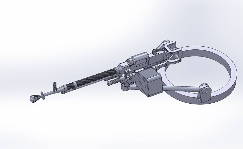

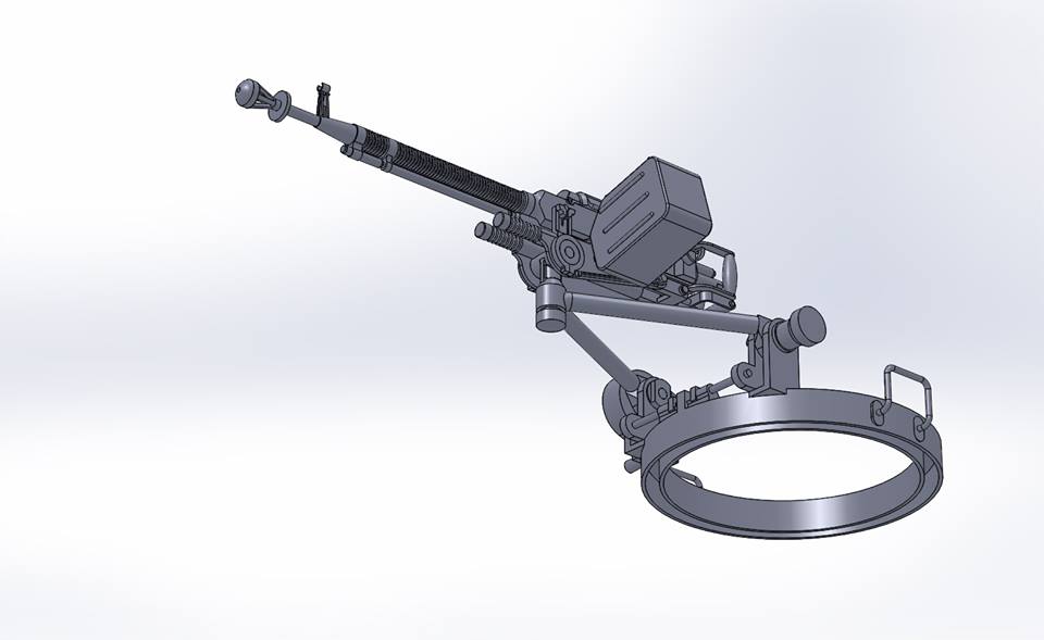

Default 1:16 DShK AA

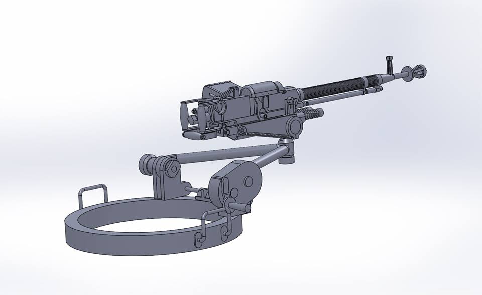

If you want AA for your JS-2, a buddy of mine is finishing up his 1:16 DShK & has it on Shapeways at a very reasonable price.
https://www.shapeways.com/product/7T...chine-gun-1-16

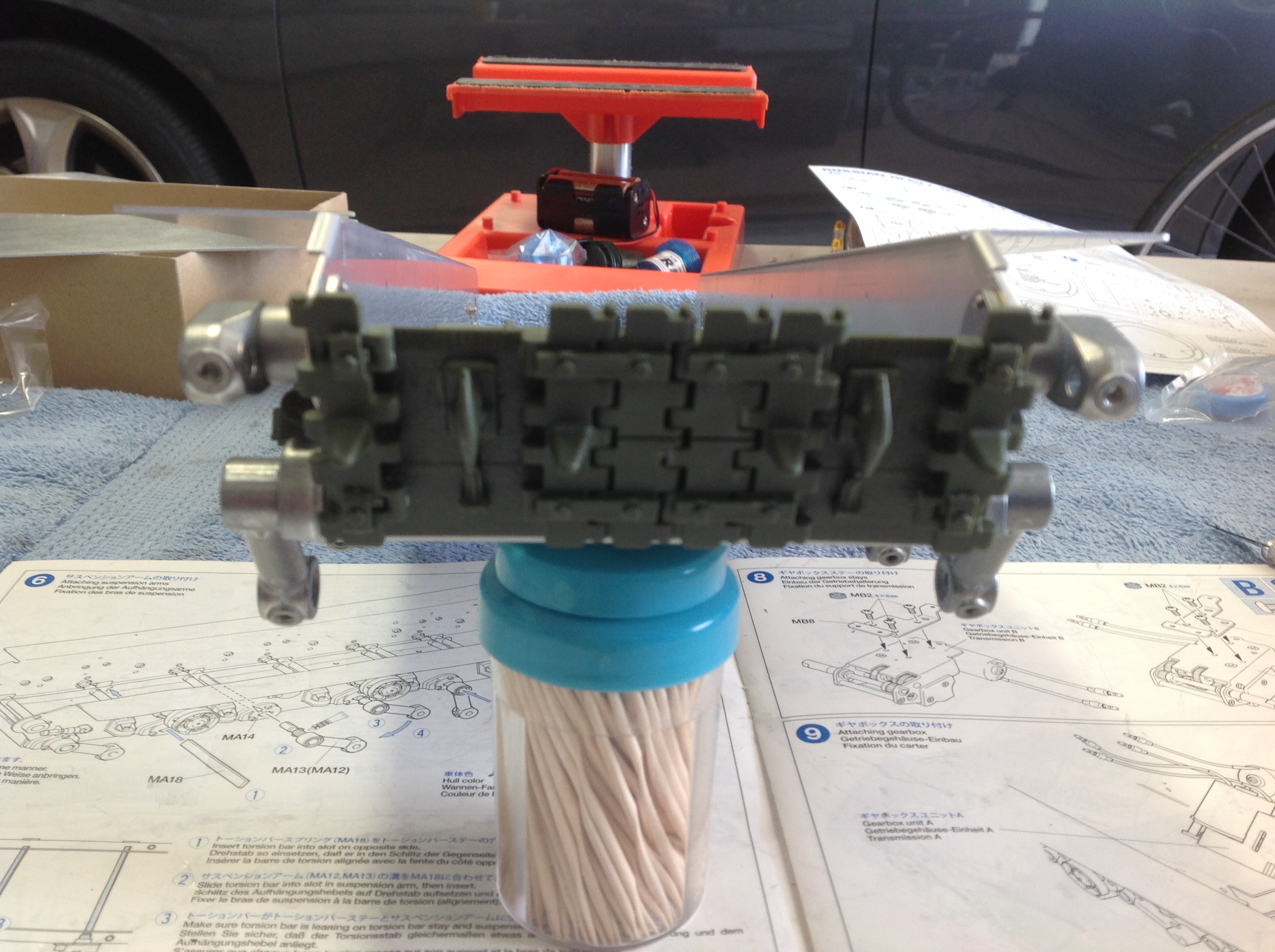

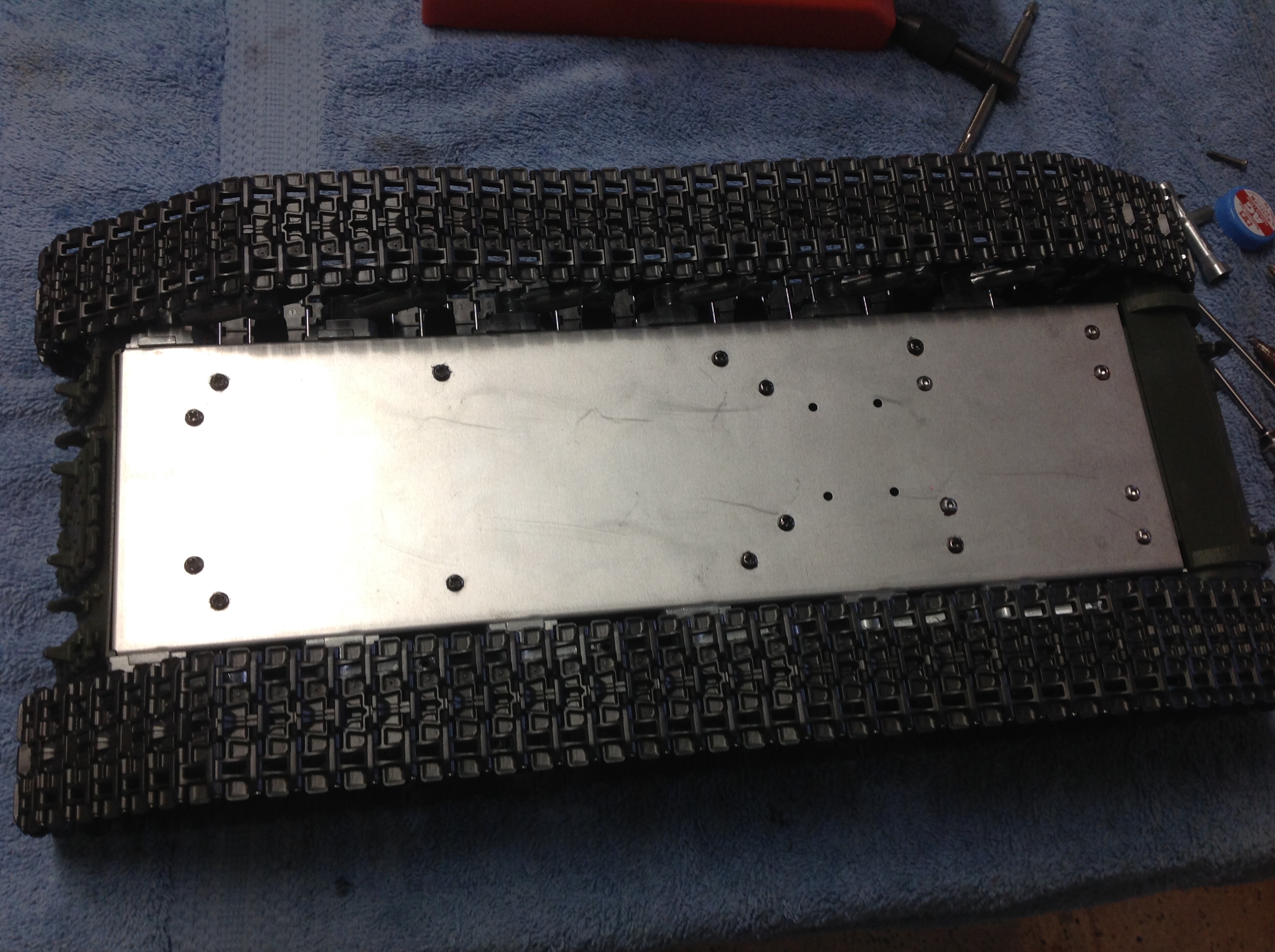

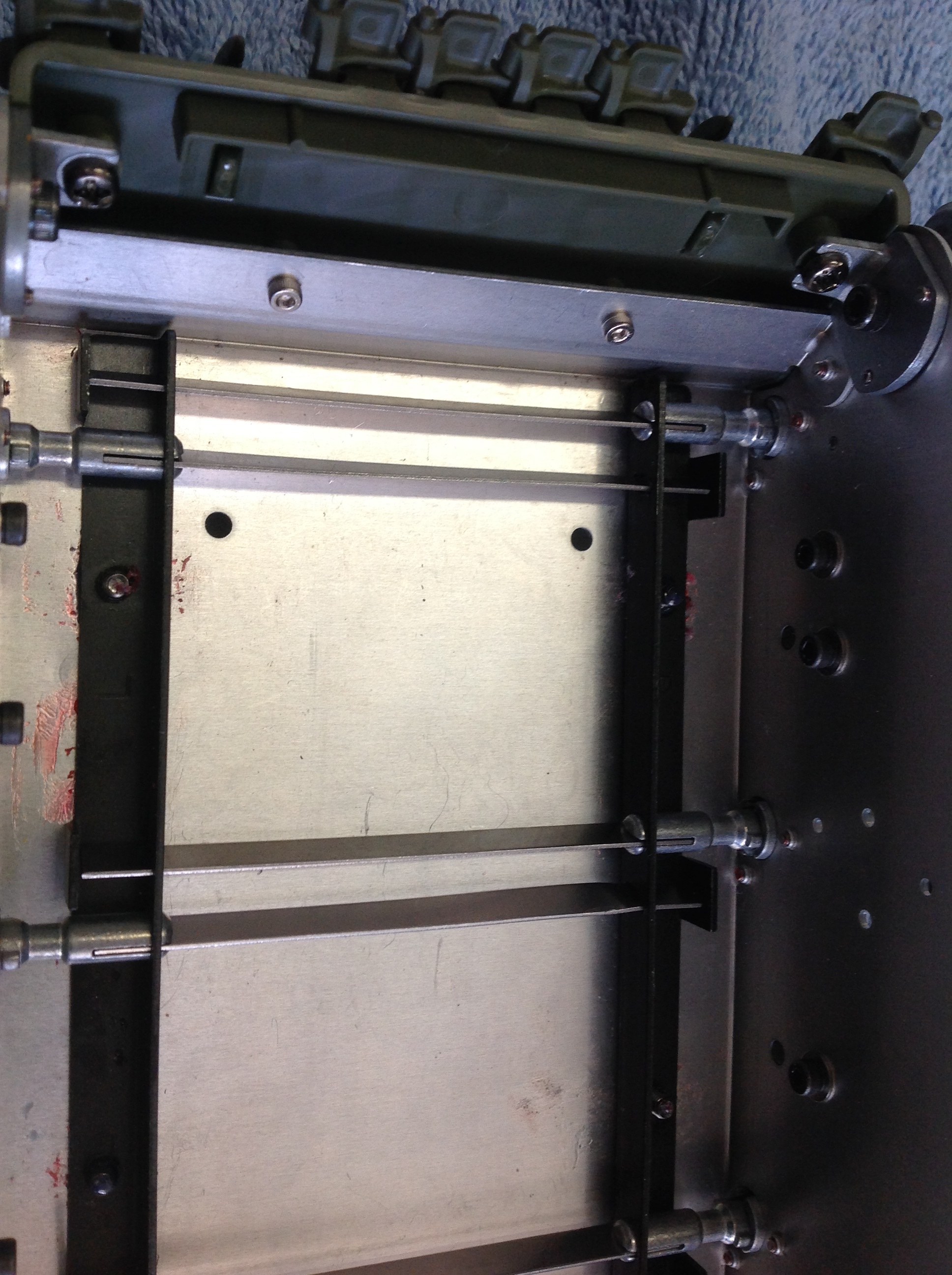

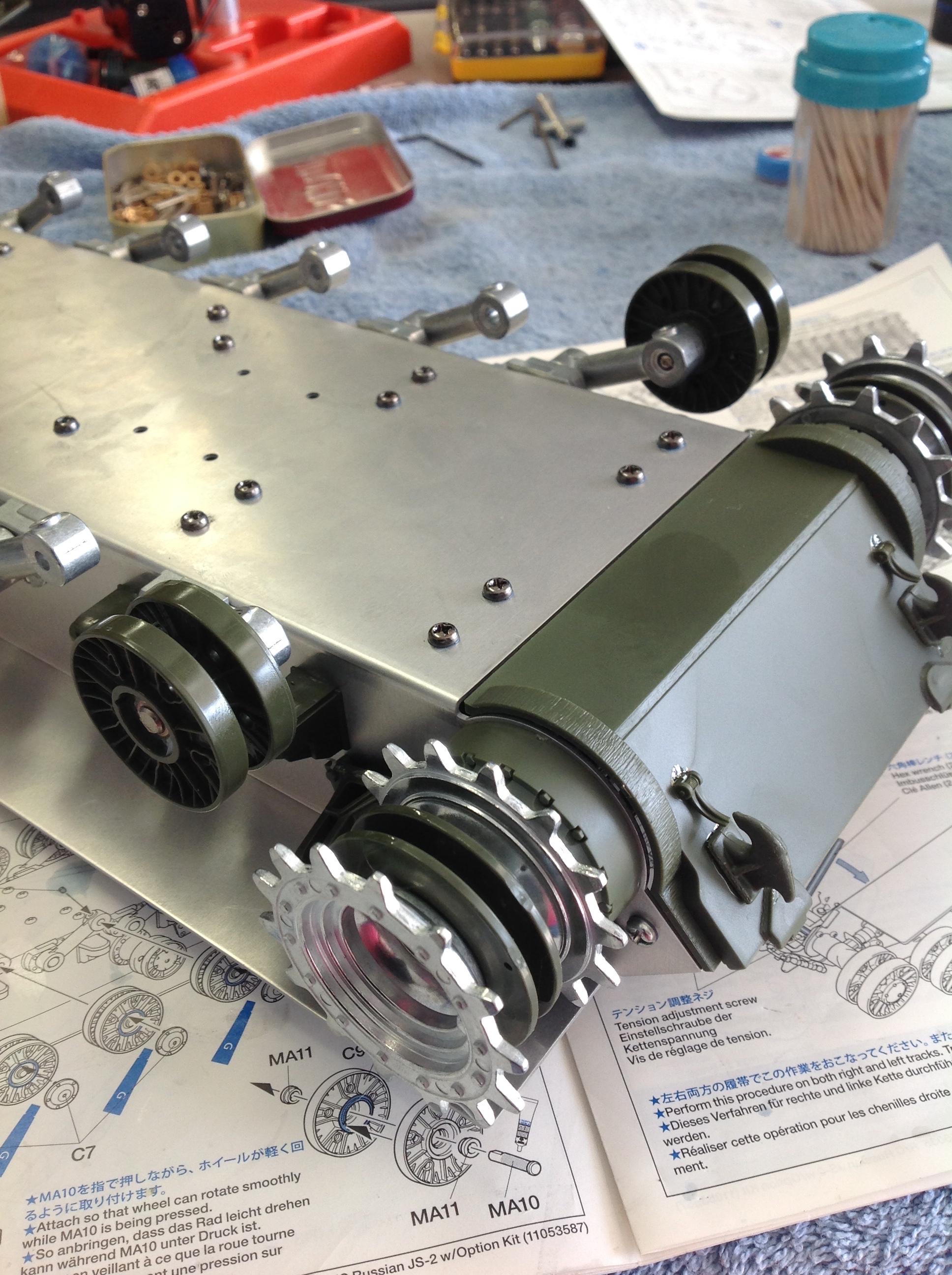

A very wise idea. Let me know if I can help you out in any way. Ohh yeah last thing i promise. A pin vise would be helpful to have for putting the metal railings/steps on. Most of the holes for those are not drilled out. you can do it with just the bit. But the pin vise would have made it so much easier.

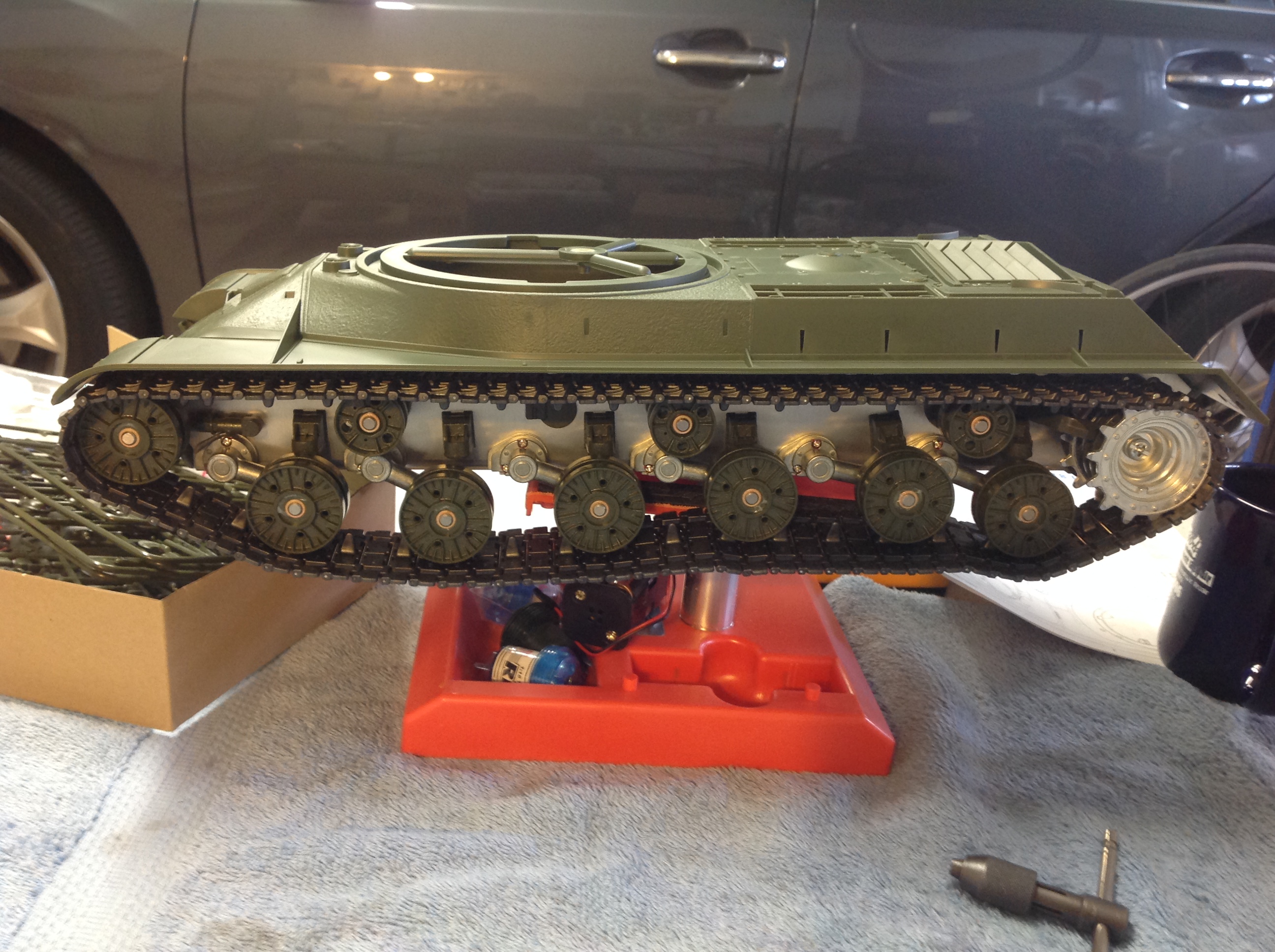

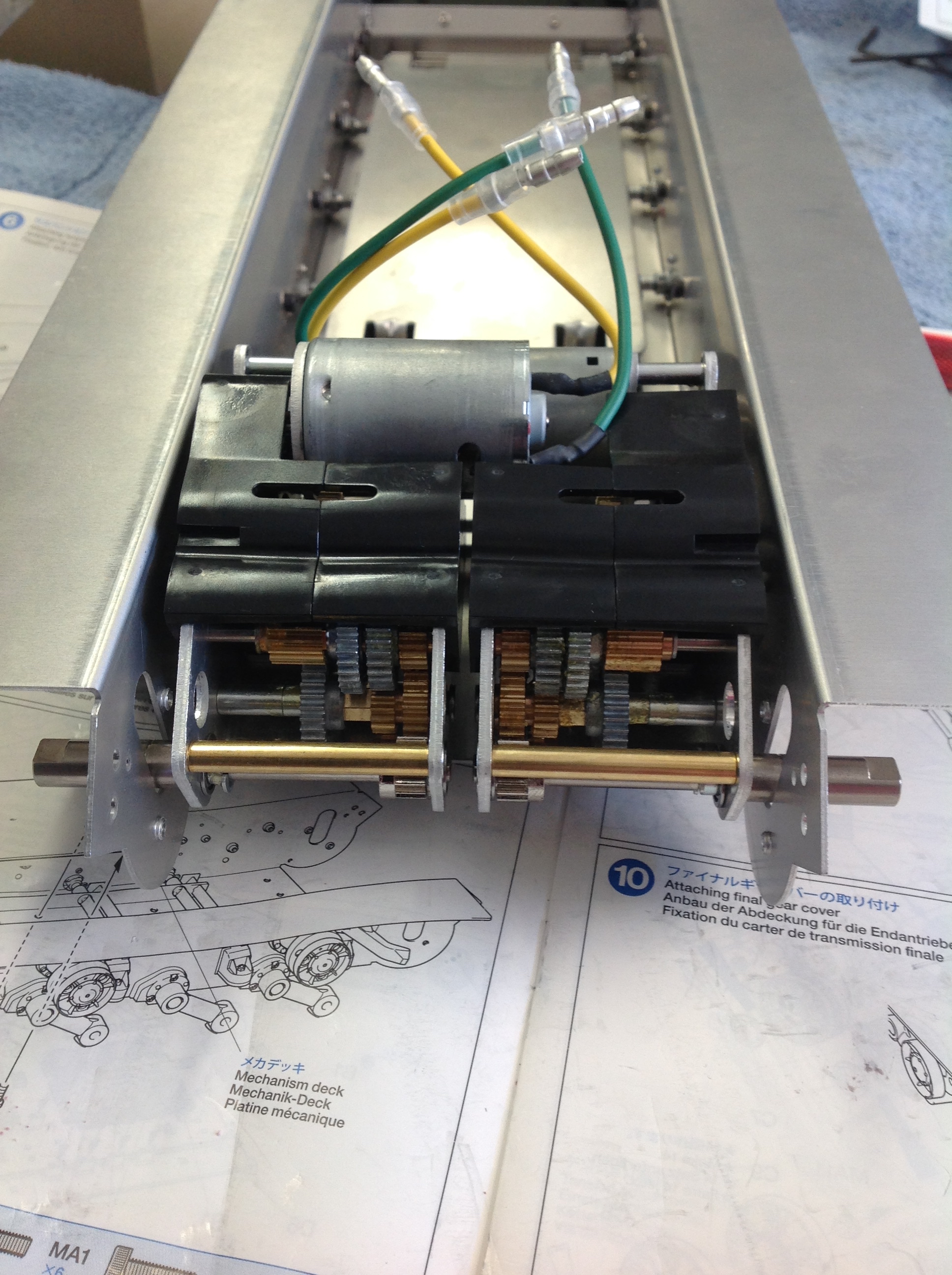

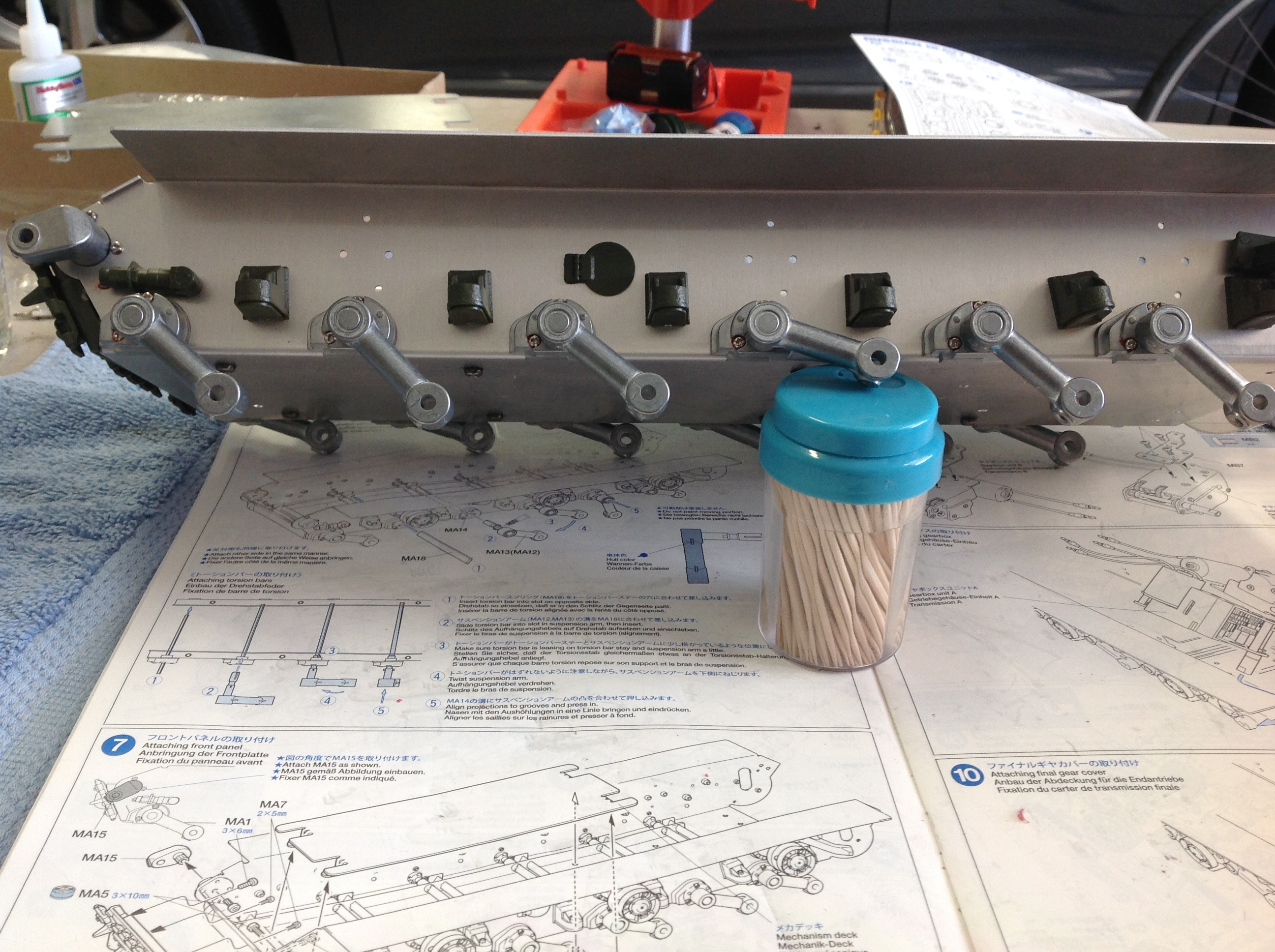

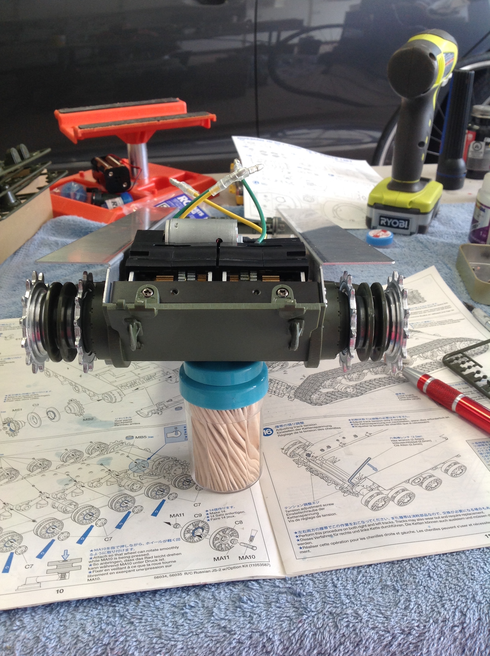

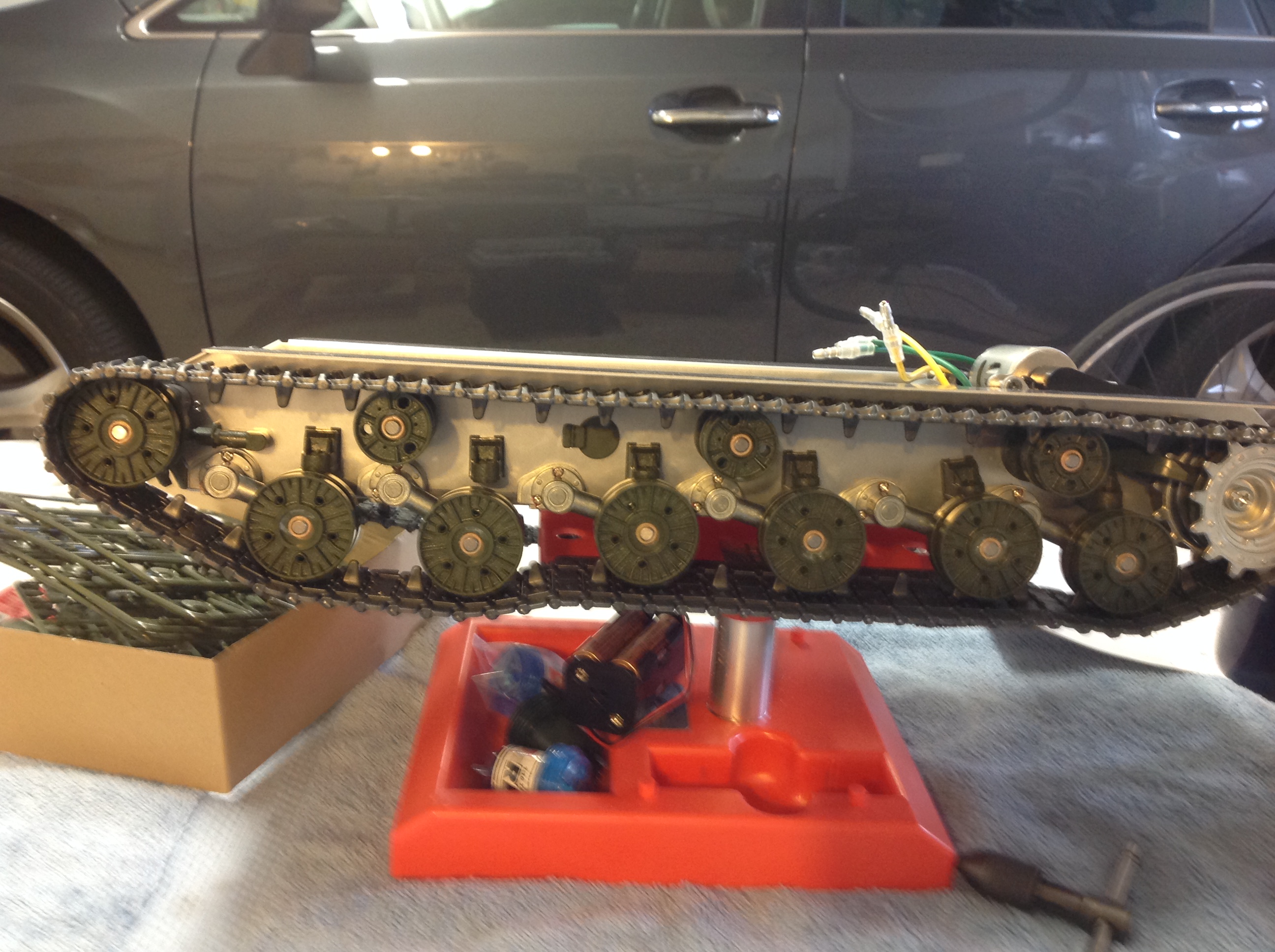

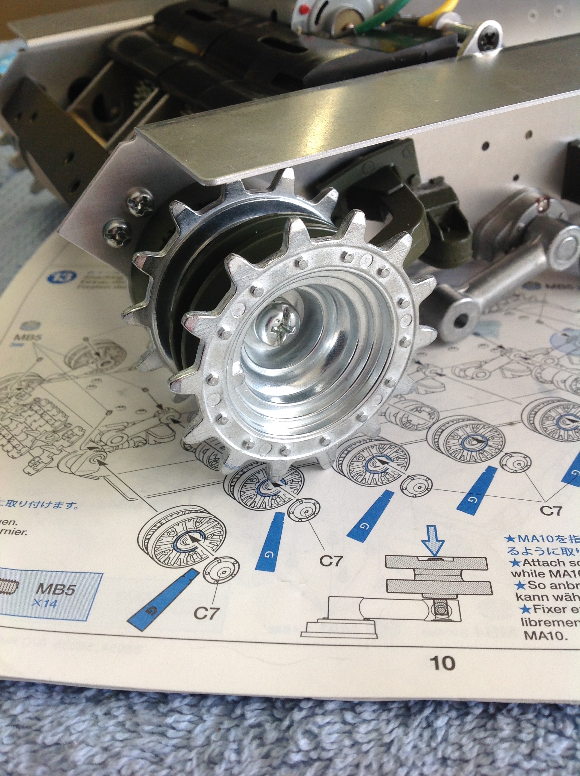

Hi Bill, a question for you. Are the road wheels C-8 and C-9 supposed to be glued together? Here are a few progress photos from today.

Yep they glue together. I put the glue on both part in the negative spaces then just press both together. It's looking real good so far.

Just to throw this out there, not assuming anything: The roadwheels are ABS, so regular plastic cement won't hold, you'll need PlastiWeld, Tenax or any other MEK based glue.
After building the first two Tamiyas years ago, when I got the IV, I glued all the roadwheels only to have them split because I missed the the ABS mark on the sprue (or in the instructions). Most of the kit sprues are polystyrene (marked PS), but a few are ABS.
Don't know why they switched in their newer kits, the PS Tiger I roadwheels are the tallest, thinnest of all their offerings and there's no issue with them, but they did and tricked me good the first time.

Glad I saved you some trouble. It wouldn't have hurt anything, they just wouldn't have connected since the solvent in the normal styrene glue won't melt ABS. They recommend their Extra thin, which is MEK based, but not easy to find. PlastiWeld seems to be the easiest to grab from the LHS.
There's a difference in feel between the two plastics and if I was paying attention the first time I should have noticed, but I didn't.

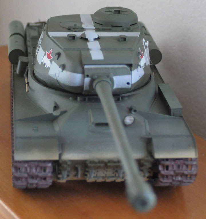

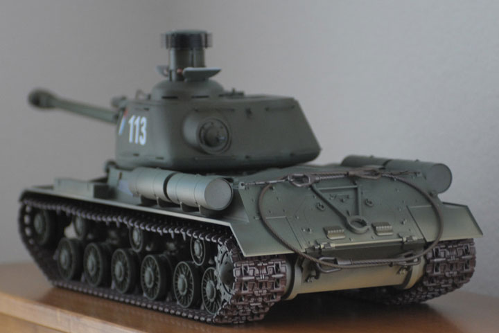

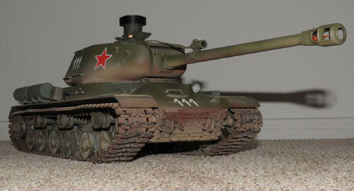

2 cent tip: From 2013 thru 2015 I have had some fun building the JS-2 for myself, a friend and an AAF Museum battle day acquaintance. Without getting to fancy, just adding ETO black motors (contact Bob) with Impact 8T pinion gears attached to the kit gearboxes allows for masterful driving on various outdoor terrain, including hilly grass-lawns and dirt.
No doubt larger motors are the single best, basic, performance upgrade for this or any of the larger Tamiya rc infrared fighting tanks. Metal tracks look great, but they are mostly a cosmetic or accuracy solution.
The tanks above run on the kit tracks using the Tamiya KV-1 wider kit tracks as often used on the Eastern Front or the kit JS-2 tracks. The model built for Danville fights has been running there off and on since late 2013.
Enjoy, John
