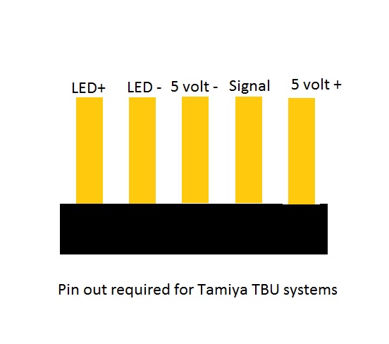

Old 08-19-2015 | 09:57 PM
YHR's Avatar
YHR
Joined: Nov 2006
Posts: 8,976
Not sure what you are using as an apple but it must be Tamiya compatible. The stock HL and Taigen apples will not work as the pin out on the IR receiver chip is different.
You need to be sure the Sensor you are using has the following pinout. Anything different will result in LED that won't flash to indicate the programming is actually worklng.

Old 08-20-2015 | 03:50 AM
Joined: Feb 2015
Posts: 494
From: Alexandria, Minnesota, USA
You have to re wire your Apple if you havent yet. You need a Red LED and wire that to your apple. Then You need to wire a IR Emitter LED directly to the Clark TK22. Then when you program and take hits, the Red LED you wired to the apple will blink. Have you done this yet? While you are at it you may want to adjust the IR LED in the mantlet for Tamiya specs if you ever want to battle other tanks. I think its 6mm hole 9mm back form front edge to bulb tip.
After I read this it sounded even more confusing.
Remove the Taigen IR LED, wire in a Red LED and run that up and out the hatch next to your Battle Unit.
Get a new IR Emitter, Tamiya or Clark, I got mine with my Clark TK22s when they sent it to me, PN IR005/IR010.
Install the new IR Emitter in the mantlet and plug it into the J3 port on the Clark.
I hope this is less confusing. If you already done this then disregard.

First let me say I am not Clark guy, but I have a general Idea on how all of these work. The programming LED is probably triggered from the two LED pins I identified in the image I posted If nothing else you will need to wire up an LED. You will most likely have to wire in a 68 ohm resistor as well. I am not sure if the Clark board lowers the voltage to this pin, so the 68 ohm resistor will protect the LED from over voltage. This LED will then flash as you go through the programming steps and indicate things are being accepted.
The user interface with this board is not friendly, but if you hang in there you will be rewarded when you get to actually use the features it has.
