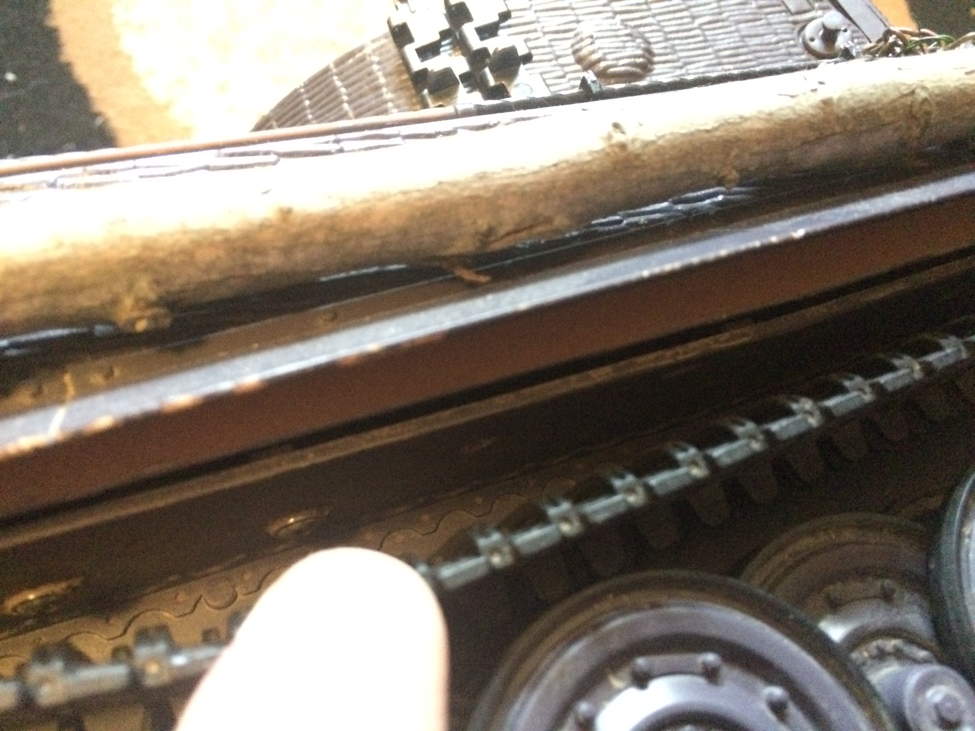

I'll try the weights first. Also when I got my Tiger from my local hobby store the plastic strips that are right above the tracks that run front to rear on the lower hull were bowed a bit and I've noticed a gap between the upper hull and lower when I put the top on and click it in. I've tried attaching a strip of thin firm metal to each side however it didn't straighten it out at all. I'll see if I can get a picture of it to better explain
Old 01-13-2017 | 08:07 AM
Joined: Mar 2016
Posts: 22

[QUOTE=GermanTanker91;12295715]
I might be using mistaken reasoning,
But the quick release on Taigen Tanks is a later addition to the original design,
And that was where the Hull was screwed to the Body, With all the screw points along the hull taking up the slack it pulled in the Tank Body which the quick release which only contacts the back and the front only cannot,
This also happens when you adapt a Heng Long Body to the Taigen Quick Release.
Shaun..

You might want to trim that post down a bit that touches the lower hull, that hopefully should help a bit. You might also want to see if it is the lower hull drooping and not the upper hull pushing on it. If it is the hull drooping a bit we do have some braces that can help. Does your tank also have the front brace on it near the gearboxes?
Old 01-13-2017 | 09:31 AM
Joined: Mar 2016
Posts: 22
It's the lower hull. It's not bad it's just enough for dirt to get in at times. I'll try dremeling down the posts and see how that works

And yes it does have the brace going across the gearboxes
Old 01-13-2017 | 10:08 AM
Imex-Erik's Avatar
Joined: Mar 2013
Posts: 3,216
Received 37 Likes on 33 Posts
From: Brooksville , FL
Just a hair, try around 1/4" first.
We do have those same braces in stock here, you can also run a brace along the middle there, that should straighten up the lower droop. They are pretty cheap if you need one, I've got them on the site here: http://www.taigentanks.com/requests/t1brace
