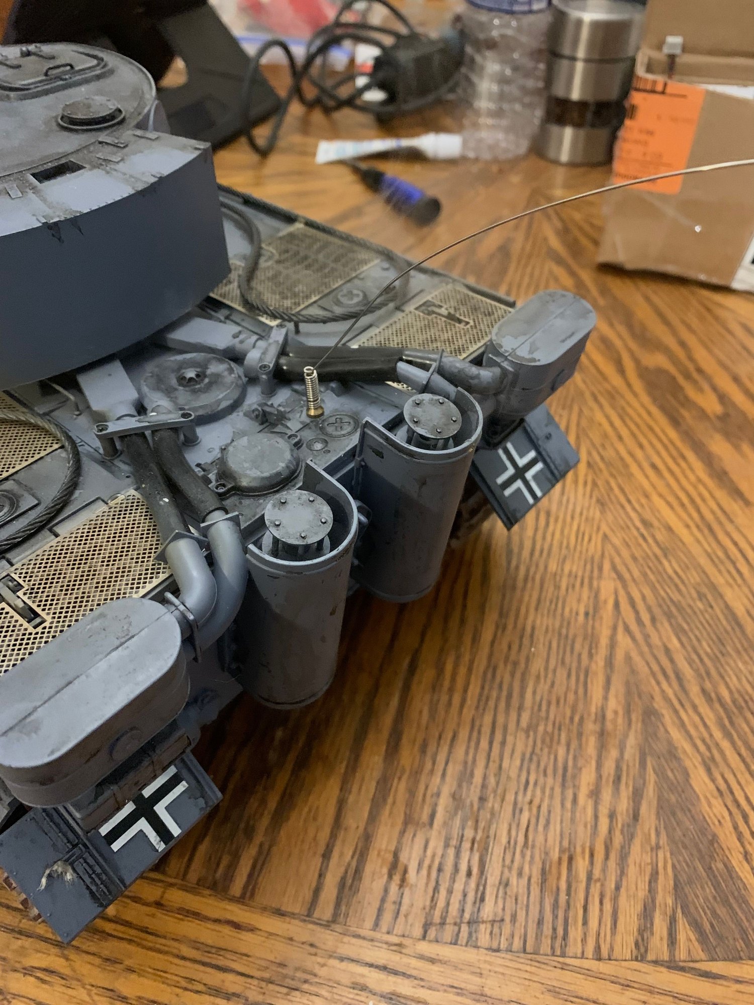

Hope someone has a old type Henlong multi function unit,, I’ll pay with PayPal. My new smoke unit is working but not when it’s plugged in.[img]blob:https://www.rcuniverse.com/26ae3c1c-69a1-408b-af38-00520988fce1[/img]

Do you own a volt meter? if not they are cheap at Harbor Freight and will help you determine if you have voltage coming out of your control board on the smoke unit's plugs, would be much cheaper than buying a new board and even if you need a new board the volt meter is an indispensable and very useful tool to have around. https://www.harborfreight.com/electr...ter-63759.html

I do own a volt meter and checked the plug for the smoke unit, no volts. So it looks like a new board

I've had the same problem. The heater and the blower start up but there's no smoke coming out. Now you might think you need a new smoker or even a new control board.
Take the top 4 little Philips screws off the top of smoker heater. Not the blower, the heater. Take out the the cotton package inside the component and gently wring it out - let it dry out. Then gently put it back together. The problem just might be that the cotton in you heater is over-saturated. When this happens, it won't work anymore. Maximum application of smoke oil to your heater is about 10 drops; anymore than that and you risk 'drowning' it.

The OP said his smoke unit works, but not when it's plugged into the motherboard. That would lead me to believe that he bench tested it. If it's working on the bench but not in the tank, I would check the voltage coming off the mfu. It should be at least 5 volts.

Thanks guys for all the ideas , Panzerpaul gave me a motherboard and circuit board. I swapped everything and still no smoke or movement with the smoke unit. I don’t know what to do.

Does the new motherboard from Paul work with other things for the tank? If so, I would just buy a new smoker after checking all the wires for any breaks (the small guage makes them very flimsy). Your volt meter should find that out. You might not have the unit plugged into the right ports? I only know about the 7.0v and 7.1v so I'm not familiar with the older boards. Or the heater is saturated inside and needs to be dried out? If the blower part of the smoker makes a humming sound, then that is at least working (maybe turn the volume down or unplug the speaker so you can hear it better).

Thanks to all you gave input and advice, I asked about a on/off switch and sure enough on the bottom is a switch that has a,b,c on it.I turned it to the next position and she smokes!
