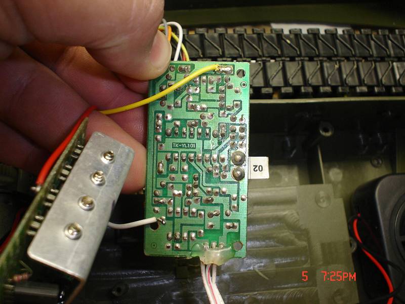

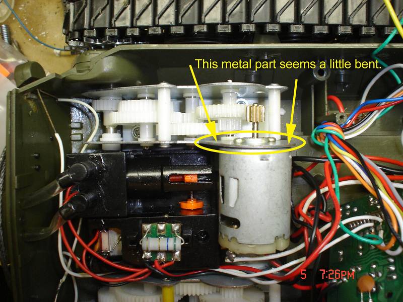

Ok, so I cracked it open and started looking for anything out of the ordinary. Nothing was screaming fix me! Could it be the transmitter? How does a crystal act if it's going bad, or acting erratic? The tank motors are definetly stopping briefly and I don't see anything binding, their just stopping split second and then go on. Any other suggestions to look at in particular? The stop and go action or bump and go, like a bumper car is annoying.

I didn't see any "Alice" tracks so that is good! Bend that motor mount back so the pinion makes good contact with the gear.
Make sure the battery is fully charged and take it outside and run it without the top on. Then run it with the top on. Run it away from homes and power lines and such.
It could be an antenna problem or interferance with electronics in your home.

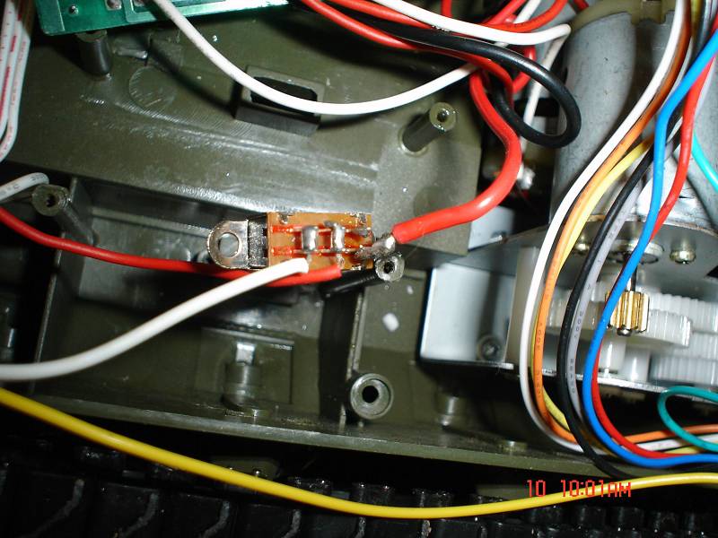

Ok.....how much are the boards?...... this one seems to have got smoked. It's definetly shorting out, cause the board smokes everytime I put power to it.
All because of the power switch........does anyone have a pic of how the wires are connected on the main power switch? I just barley moved the wires and the one thick red one came off. I thought it might have gone across both side like the other two, but i'm just not sure.
Breaks my heart..... I was soo looking forward to playing with it.

Take a deep breath, wacky's manual has all of that, other wise I have a picture somewhere! The power switch cuts the hot on two of the switches legs the thrid wire engages on the off position of the switch, this is for the ground and can be clipped off of the on/off switch! Then all you have is the break in your positive line, one side goes to the board and the other connects to the battery!

Can somebody post a pic of their switch? I want to make sure mines right. Here is what mine currently looks like.
Thanks!
Skitt

so far that has not been my problem.....but thanks for the suggestion......my problem turned out to be the switch. One of the connections was poorly soldered and it shorted out my board. Blitz came to rescue and now i'm running again.
