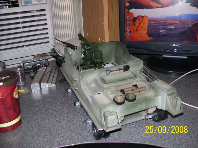

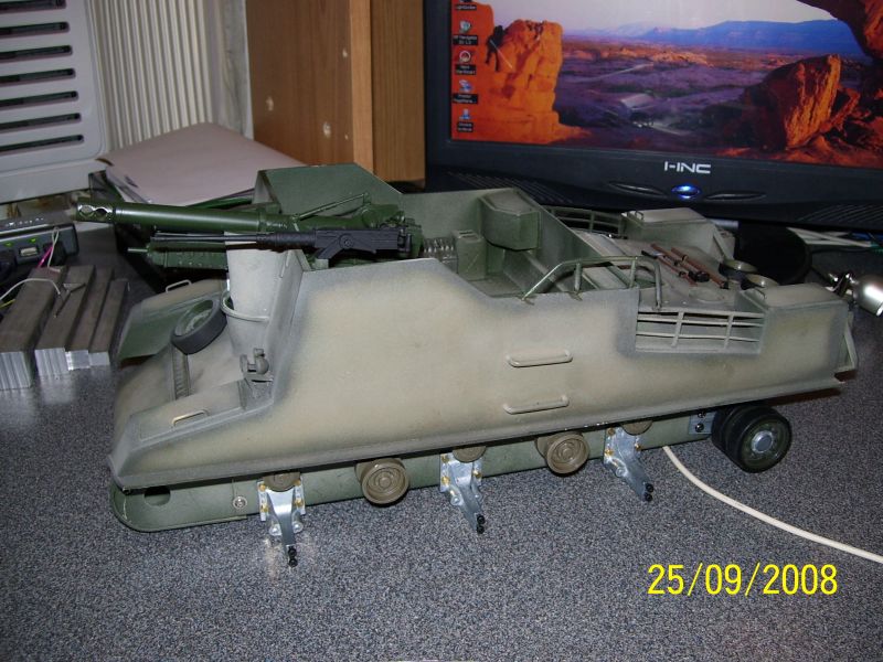

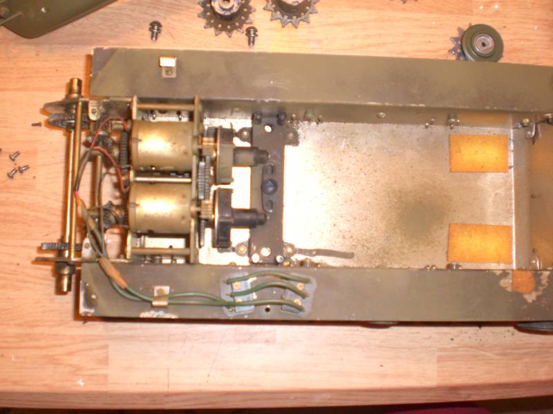

well I have some work done on the sexton but need to find an early sherman daul motor drive and I mean early the old clutch type with daul motors
and am still looking for the outer axle plates as I have not found any on ebay as of yet
here is what is done so far

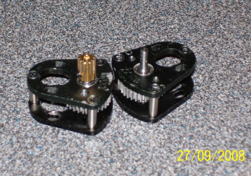

here are 2 of the gear boxes I have out right now they are brand new
the small ones are tamtoy the other is tamiya as most of use know by the size

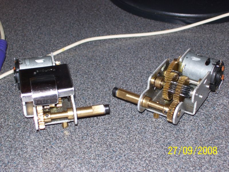

here are the out drives and reducers that i can also use to build the early 3 piece gear housing used on shermans

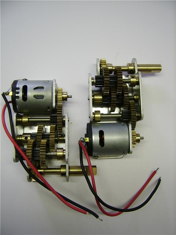

BubbaJoeXX:
Look to be standard Tamiya DMD gearboxes, the ones on the right with the tab in the opening seem to be Type Two gearboxes (first black-cover'd ones) I blew the pics up, could see that annoying plastic gear (someone have the repair/replacement gear packet #?) They should fit fine inside a Sherman (and motors sit even lower with the 3:1 reductions)
You can apparently adjust the ratio on the new boxes ( on the left) manually by removing the cases and adjusting the spacers on the gear-shafts, or so I think I remember reading on ArmorHut a while back. You may still want some 2:1 reducers on 'em...

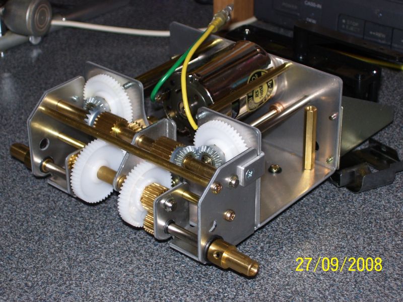

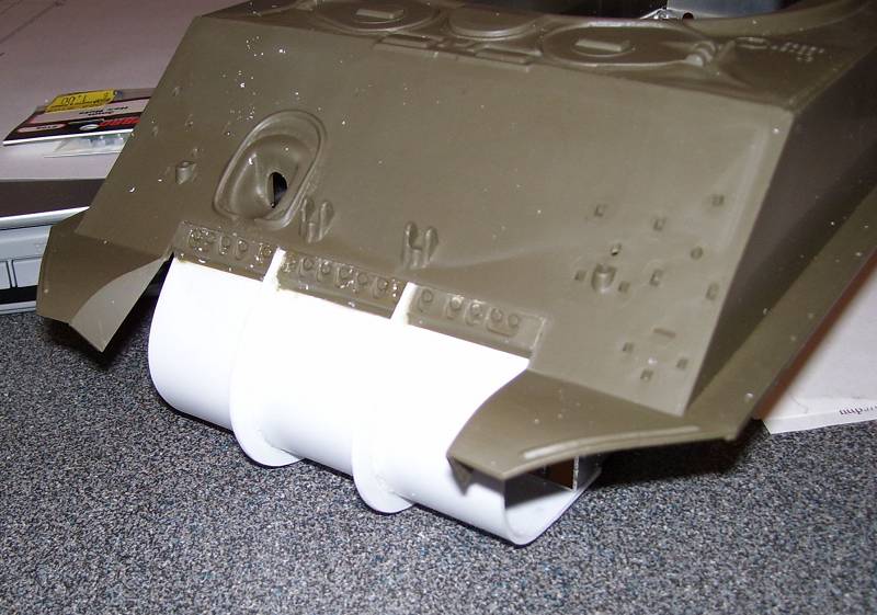

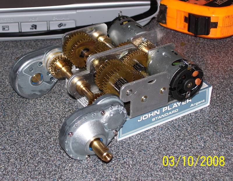

just finished designing the new gearbox for the sexton it uses tamtoy gearbox with pershing gear housing so that I can make the 3 piece trans cove for the right look
just added a finished pic of the gearbox for the 3piece trans the pic shows thw 3 piece trans I am makin

started the 3 piece trans cover here it is so far
