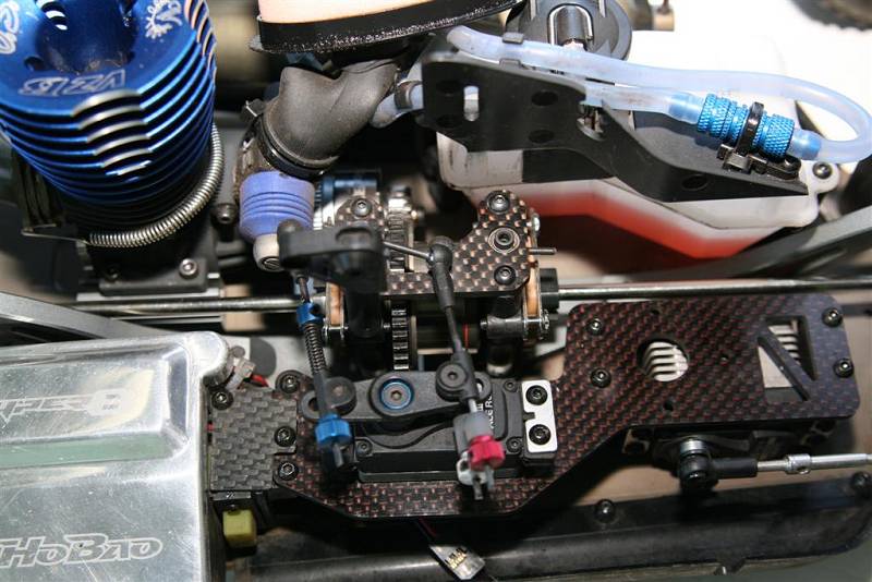

#732
ORIGINAL: kx_maduk
i have taken my st apart know to rebuild the diffs and shocks with new oils , Which ones i am going to try i still dont know i think its gonna just be a trial and error thing
just bought 2 ACE 8128 digital servo
it has nearly 15 kg of torque is that enough for the steering ? . it is also pritty fast 0.1 sec
Or do you think the ace ds1015 would have been a better choice?
here are the links for the servo specs
http://www.amainhobbies.com/product_...oducts_id/5994
you posted link to ACE 1313

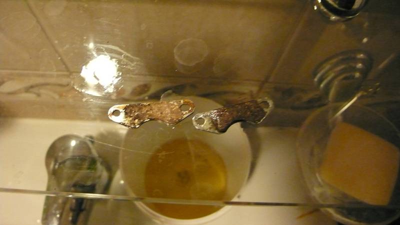

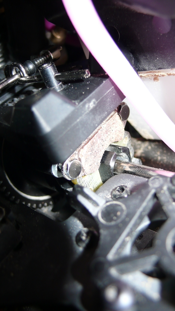

Alright. This is for everyone FURUSTRATED with not getting their brakes able to work.
Whats it costs to do this mod : 1 set of [link=http://www.amainhobbies.com/product_info.php/products_id/4499]Racers Edge Brakes[/link] , $17
What you need :
--1x Set of Racers Edge Brakes
--1x Plyer ( I do not recommend needle nose plyers)
--250ML of Nitro @ 30%, 350ML @ 25%, 450ML @ 20%, 500ML @ 16%. The Higher the %tage, the lower amount needed
--1x Sharp Hobby Knife
--1x Saftey Goggles
--4x Standard Ho Bao ( Hyper ST) Brake Calipers
How Long It Takes :
15 mins to an Hour.
How to do it :
Firstly rinse the standard brakes with water. Dry them completely and then drop them in Nitro. What happens when you drop them in nitro is the brake pads ( The Hard Stony Granite Thing), starts to oxidize, making it easier to remove. Let it set for about 15 mins, then pick up the calipers with the plyers and start scraping the pad material off with the knife. Do this until no furthur pad material will come off, and let it set. Repeat process as needed.
Once all the pad material is off, and you are left with completely metal calipers, rinse it down with a bit of water, and spray a lil' bit of WD 40 onto them, and dry down with a tissue or cloth.
Now attach the side where the pads were not originally located ( The side which you did not have to scrape the pad material off ) facing the brake pads.
Now would be a good time to open up your instruction manual to Page 10.
Assemble the brake cams ( I did not use the plastic Bushings ) making sure that the rear brake cam DOES NOT scrape against the spur gear . Once that is done, assemble as shown in the manual, and adjust brake linkages back to stock position
Braking power should be extremely good by now and all wheels should lock up.
Attached are a few pictures to guide you along.
PM me for anymore questions.

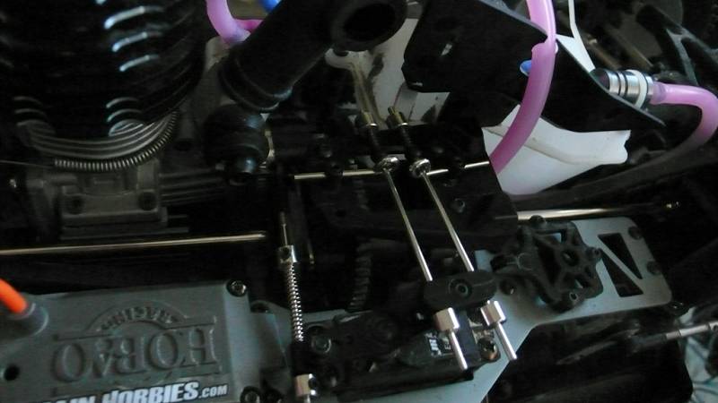

#750
This is my setup, all you need are these parts:
http://www.amainhobbies.com/product_...ducts_id/15646
http://www.amainhobbies.com/product_...oducts_id/3678 (you have to trim them a bit yourself they don't fit right on)
http://www.amainhobbies.com/product_...oducts_id/4499
This brake setup can flip your car over!
