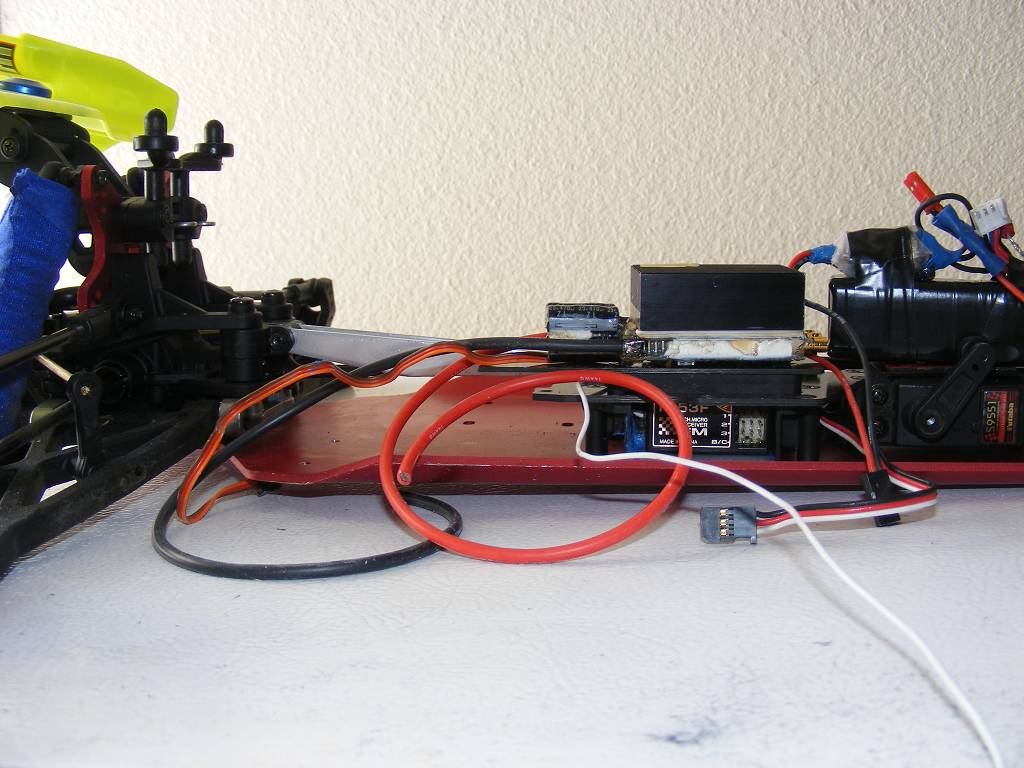

So here's the chassis which has been stripped down. If you notice, I've removed the battery box and have decided to move the receiver to where the throttle servo used to be. I've cut out an opening in the servo box so I will be able to access my receiver and have welded another piece of plastic to the bottom (it's the slick white stuff and I've forgotten what it's called). I've then sealed the corners from the inside using gasket sealant.

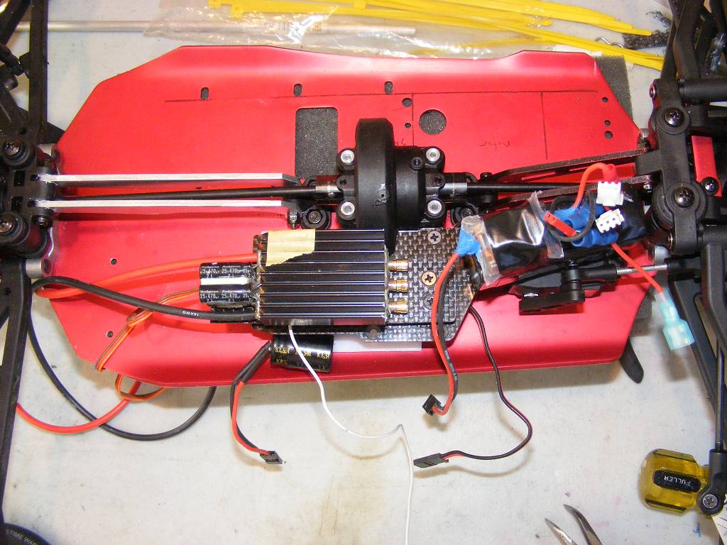

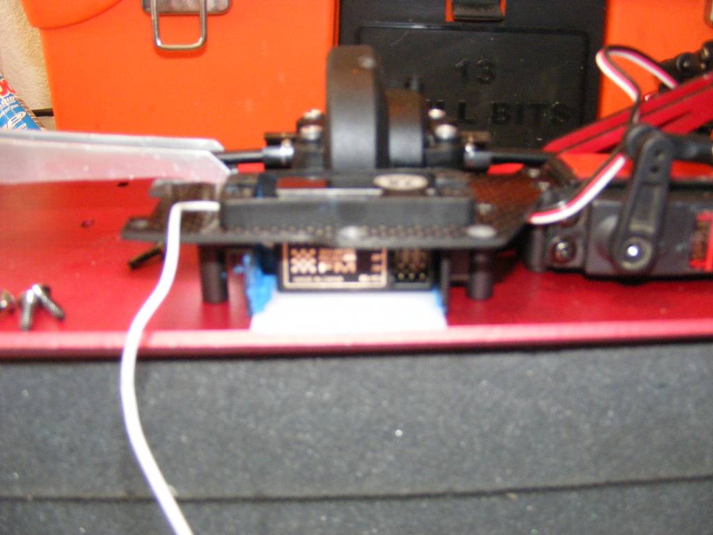

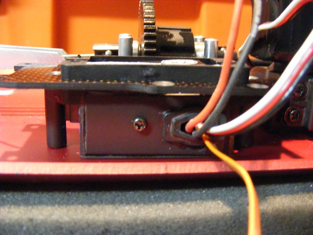

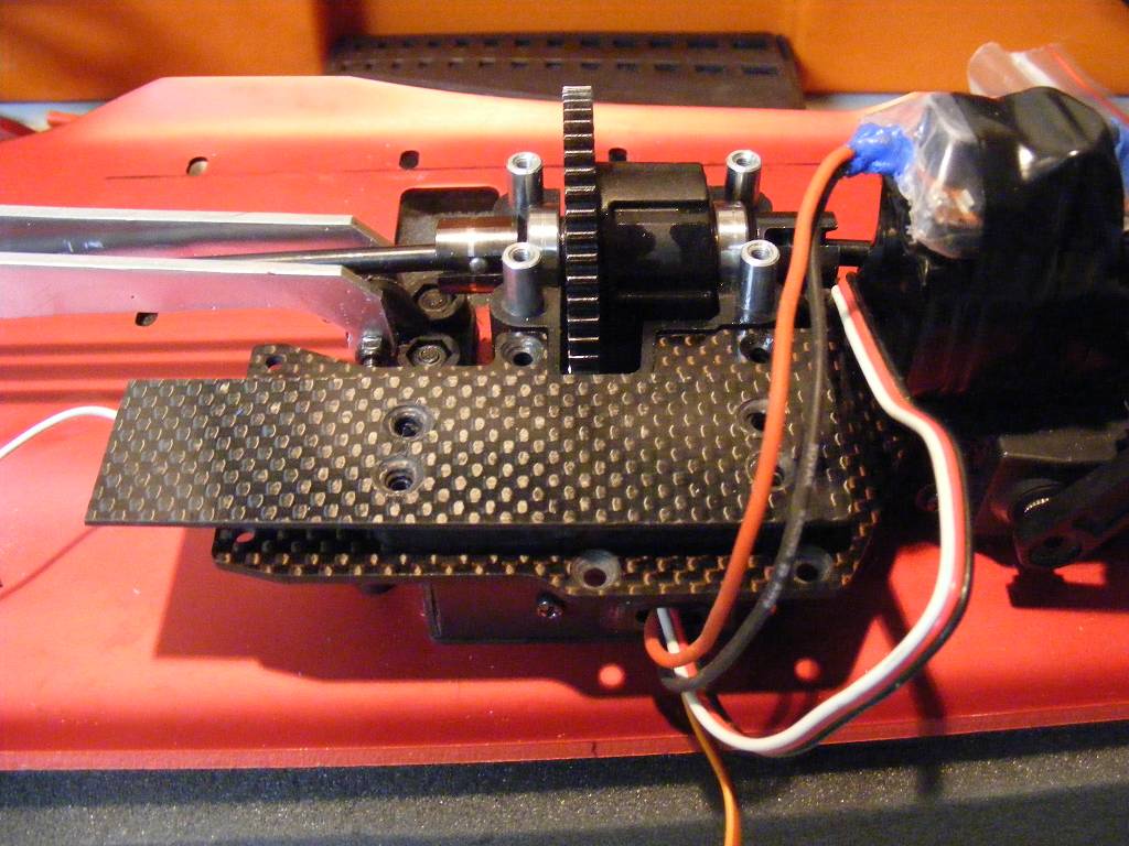

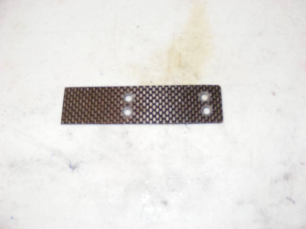

1. I had some .062 carbon accent panel laying around (from cstsales.com) and decided to use it to do two things: secure the receiver below it and give me a platform on which to mount the Schulze 18.97KW ESC I will be using.
2. You can see (sort of..the pic is fuzzy) how little clearance there is between the side of the receiver and the top of the servo box on which the upper plate will be mounted; so with a little strip of servo tape it will be a nice tight fit.
3. The holes I drilled into the ESC plate were then countersunk so my screw heads will be flush with the surface. I may end up trimming the length of both the plate I made and the carbon fiber radio plate below it, but I won't know until later.

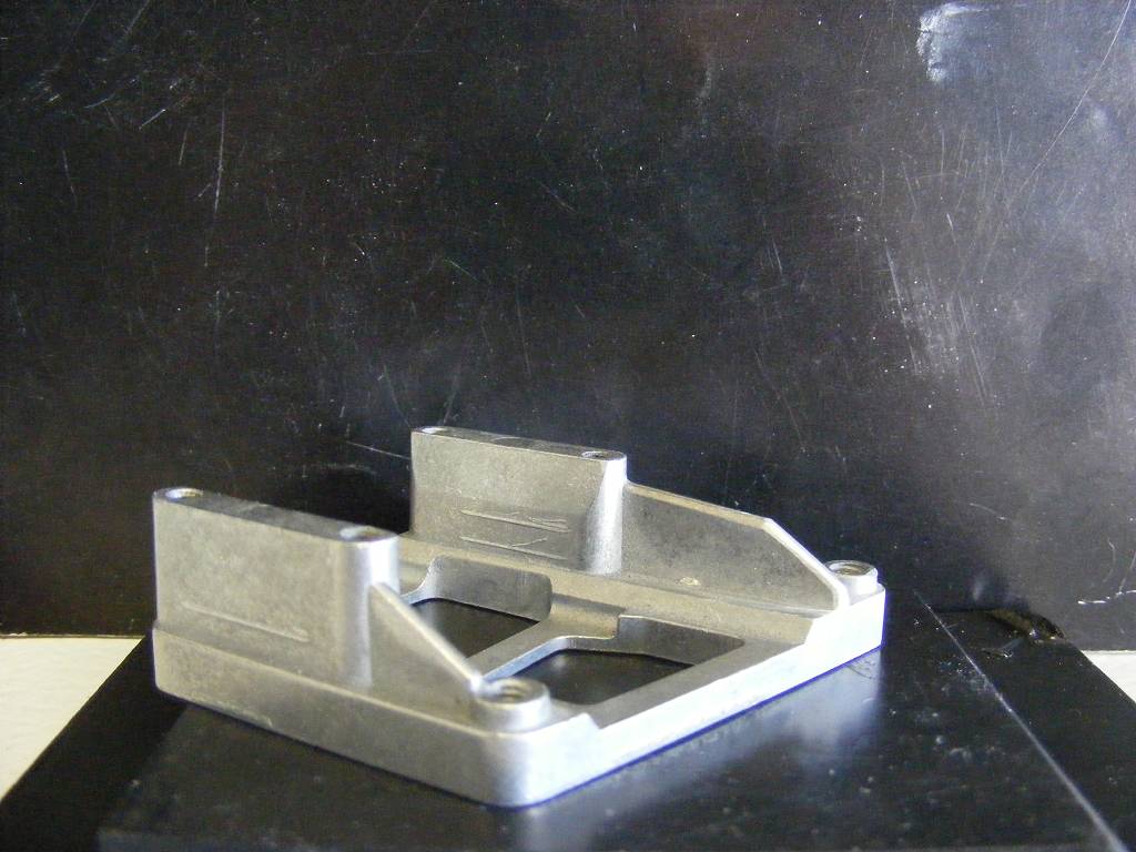

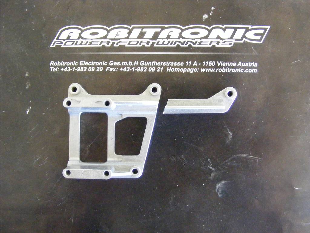

I've been thinking about what to do about a motor mount and realized that I could use what my good friends at Robitronic have already provided. That's right, I'll use the engine mount that came with my kit. After all, it's sturdy and will fit with a little bit of work.
1. Here you can see where I cut the mount.
2. After cutting I ground the cut edges smooth, angled the corner and rounded the edges a bit with a file.
3. This is where I plan to mount it.
I will still need to make the upper half of the motor mount and grind the rear profile but I won't do those things until the motor actually gets here.

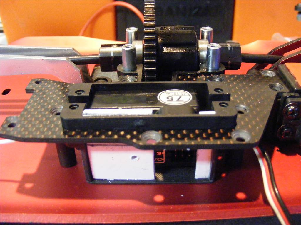

1. So now that I am adept at getting close ups, here is a shot of the minimal clearance I talked about in an earlier post between my receiver and where the upper plate will mount.
2. I had to cut a larger (rounder) hole into my cover and CA the rubber seal in place. Now all the wires fit and the door sits flush.
3. Mock-up with the ESC plate positioned.

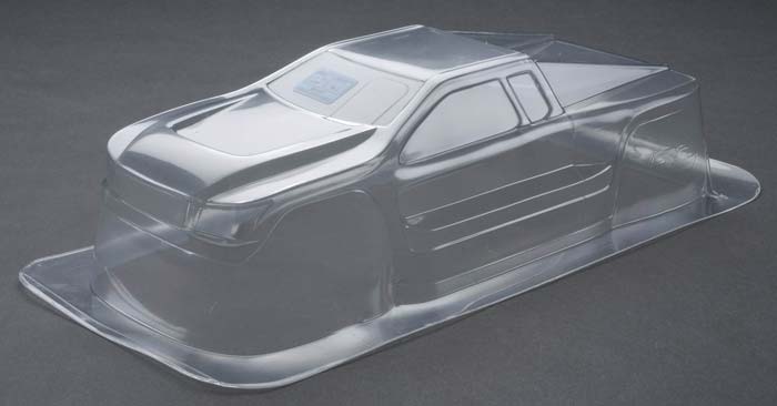

Yesterday I purchased a Pro-Line Shift body and AKA I-Beam tires in medium compound from the LHS (Hobby Masters). The owner, Craig, is a great guy in my opinion and has done a phenomenal job of building, organizing and maintaining a REAL 1/8 scale track for the Redding/Anderson area. Way to go, Craig!
The Shift body is for the Mugen MBX-6T and is the one I thought fits this truggy the best. I also considered the Bulldog body but it was a bit too long; which may interfere with the front bumper and frankly, I didn't care much for it. The Shift body will have a very low CG (Pro-Line's statement), be the correct length, as well as have a narrower side fit on the chassis than the Mantis body which, since I no longer have an exhaust pipe, will better shield my internal components from under-chassis debris.
The package I ordered is somewhere between here and San Francisco so it will probably show up tomorrow.[8D]

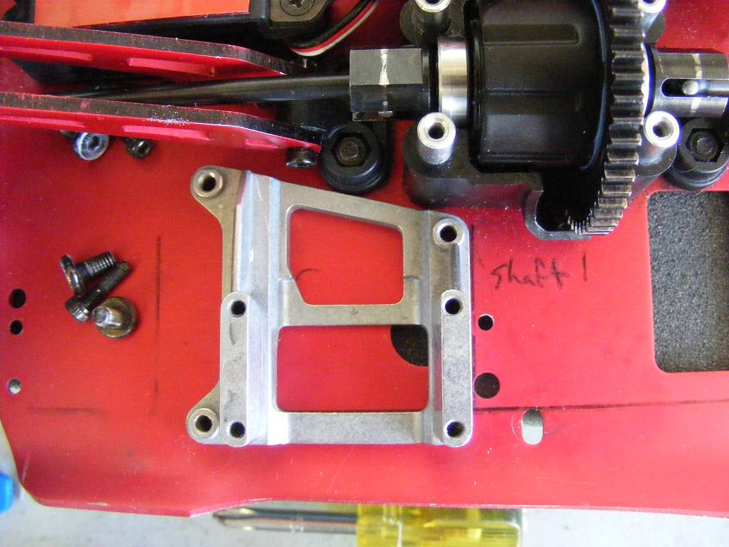

My package actually arrived Friday and I have spent several hours fabricating a new motor mount since my original plan to use part of the stock one was a no go: this motor is HUGE! It's one thing to see the measurements on paper and a whole other thing to be holding it in my hand.
The only power tools I have have at hand and have used thus far are a grinder and an air drill: no joke. So I have literally spent Friday evening and most of Saturday creating a new motor mount. I must say that it does look good, though. I will post pics later tomorrow or Monday since it's late and I'm dead tired.

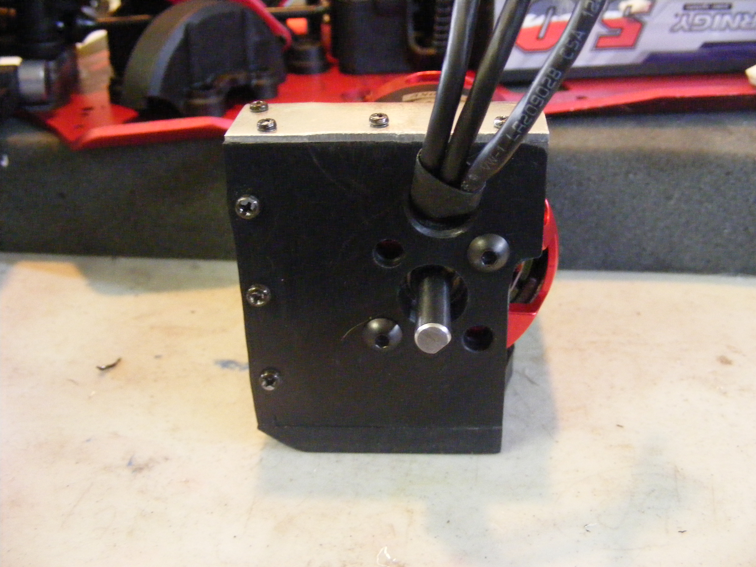

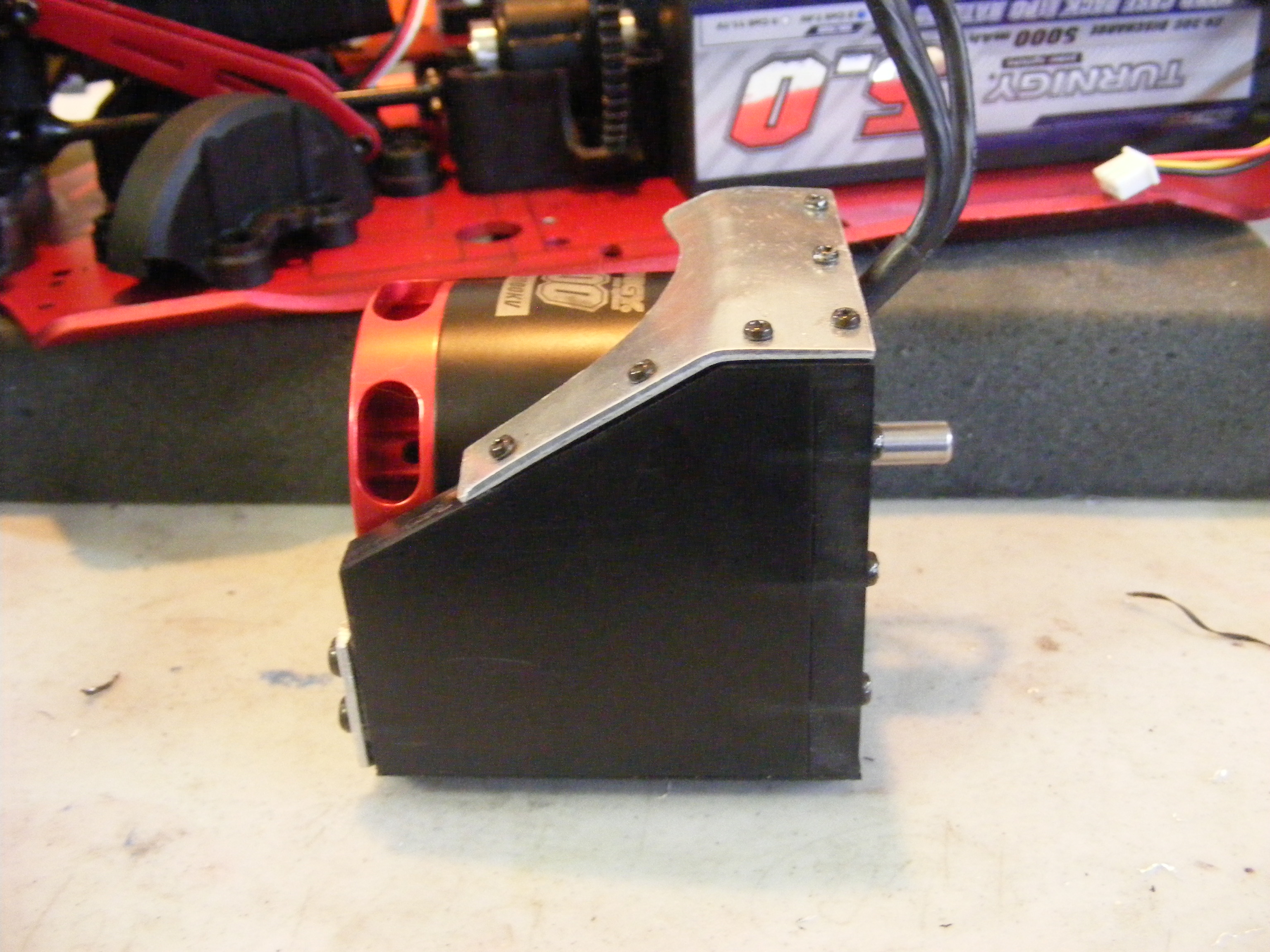

Pictures 1,2,3,4 & 5:
Well, here's the motor mount. The mount is made out of ABS (I think) and reinforced with screws and some aluminum plate. It looks bulky but I wanted something to protect the motor well. Thankfully, it's not as heavy as it looks though I will still be drilling out some holes later for added weight savings. Like I said, this motor is huge and since it's an outrunner, everything past the front housing actually turns.
6. You can see from this view how close the motor is to the front of the vehicle. I've ordered a shaft extender which will enable me to use a wider range of pinions and allow me to have the motor as close to the front as possible. With the stock shaft, I would half to mount the motor close up to the diff housing. The size of the motor limits me here since the use of a smaller pinion will cause the motor to hit the diff housing. Mounting the motor this deep up front along with the side plates of the motor mount will help protect it from debris. Last thing I want is for a stone to get stuck between the can and the chassis. The shaft extender will be about 43mm total length and made out of stainless steel. I'm not really concerned about the extra rotational weight of the metal since I will be losing some or all of that weight through the use of an acetyl pinion and a nylon spur.
For a spur gear, I've ordered Losi's quick change set-up with a 45T nylon gear. This will enable me to change the spur gear easily without having to dismantle my entire diff which I think is necessary for a project like this.
For pinions, I've chosen 6mm bore Mod 1 Acetyl with brass inserts. I've got three coming: a 24T, 26T and 28T. Why acetyl? First of all its a strong, abuse-loving material and its cheap. Also, the physical properties of the acetyl plastic pinion do a couple things: they will cause it to run quietly against the nylon spur and provide self-lubrication. These pinions, mated to the 45T spur will net me an approximate and theoretical speed of 38, 42 and 45 mph on 4S Lipo.

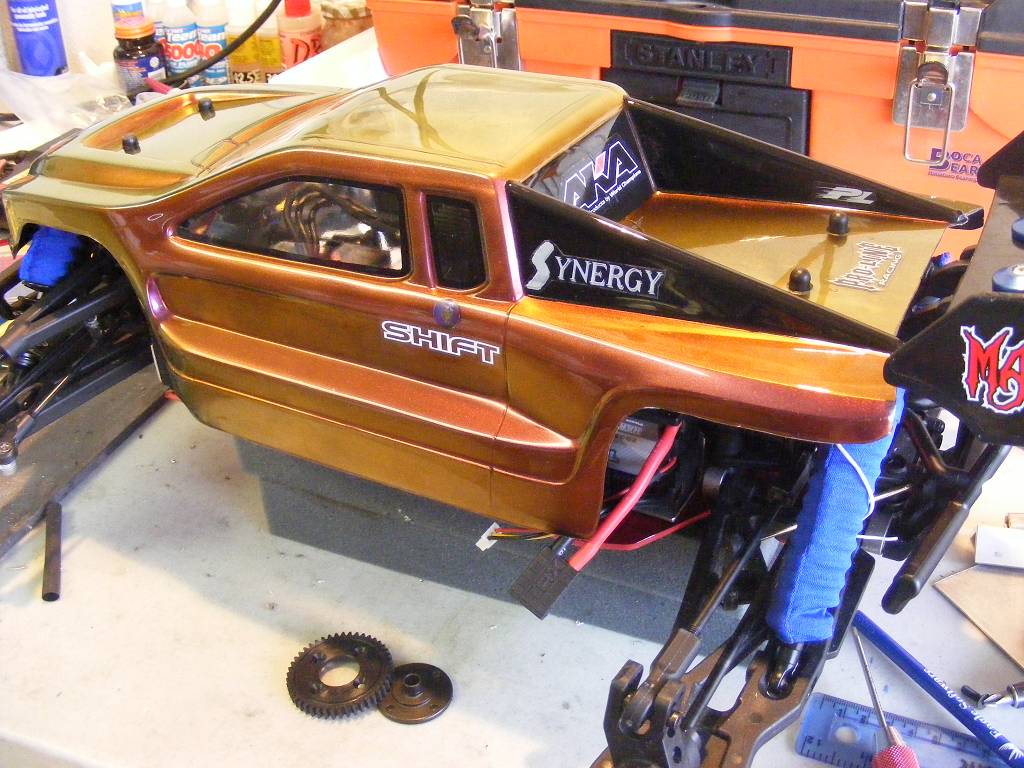

So let's start with the body. As hard as I tried to get the body prepped, it seems there were still smudges on the inside. I was not aware that the color change paint would highlight those things so well. It does. You probably can't see them in the pictures but they're there. Oh well, let's move on.
1. So here's a front shot. Shift baby.
2. Side profile. You can see how the paint really makes the details pop out.
3. You can see the black window trim.
I did try to adhere the prismatic decals on the inside of the windows and headlights however, it proved to be too much of a nuisance so I canned that idea. I may use a chrome paint for the windows but I haven't decided. I may just leave them clear.
I do have a ProLine high down force wing but it's in yellow and really doesn't seem to match well with the body color. I wouldn't exactly call it an eyesore but that's my own opinion; so I mounted the stock Mantis one to see how it would look.

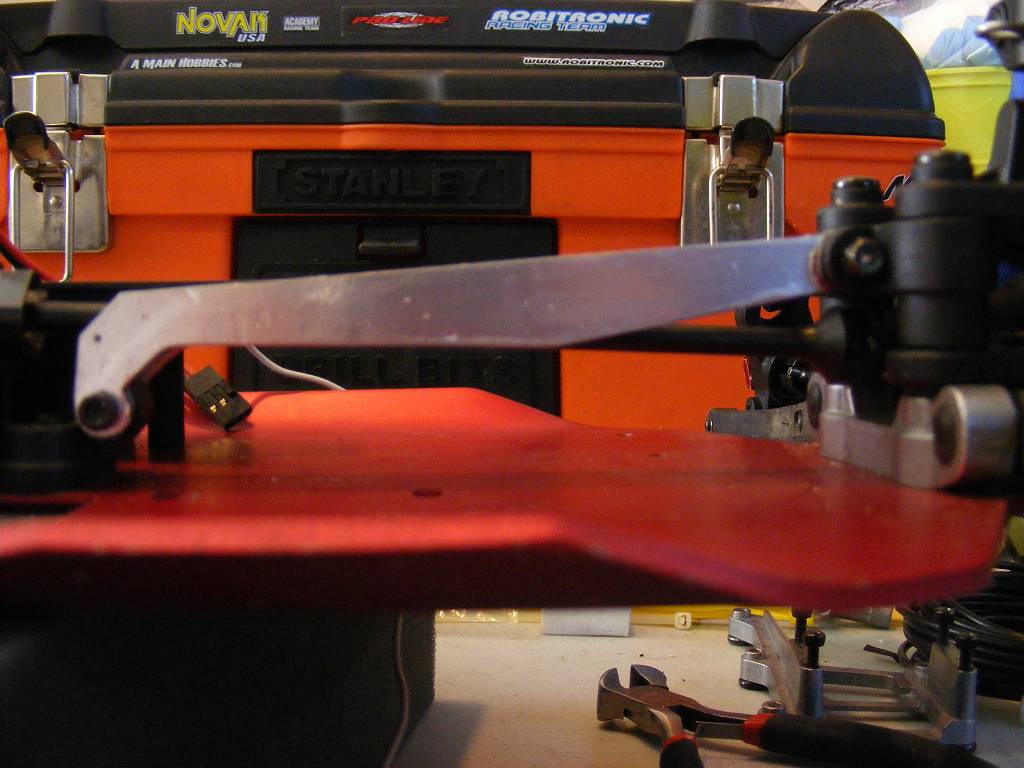

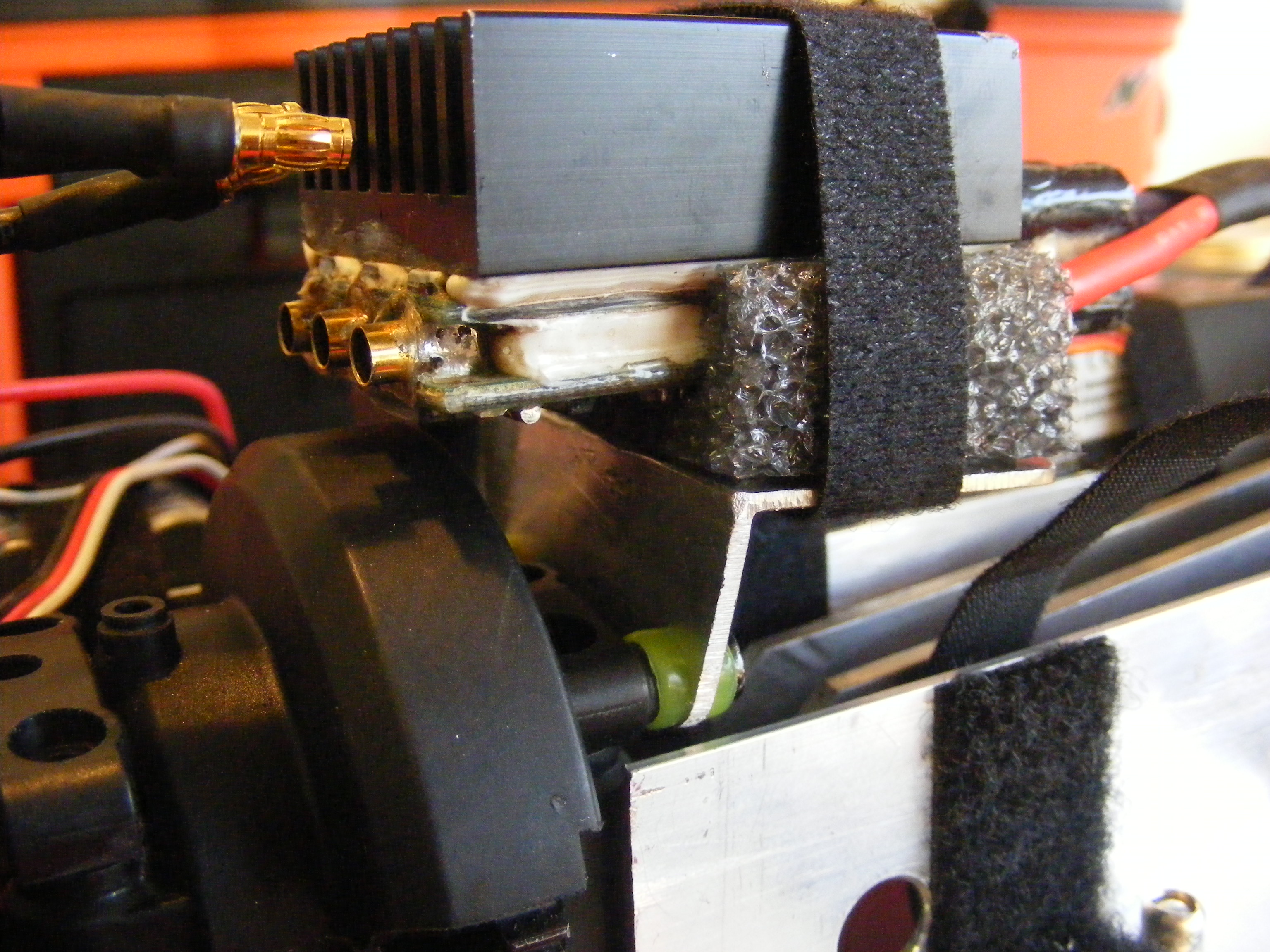

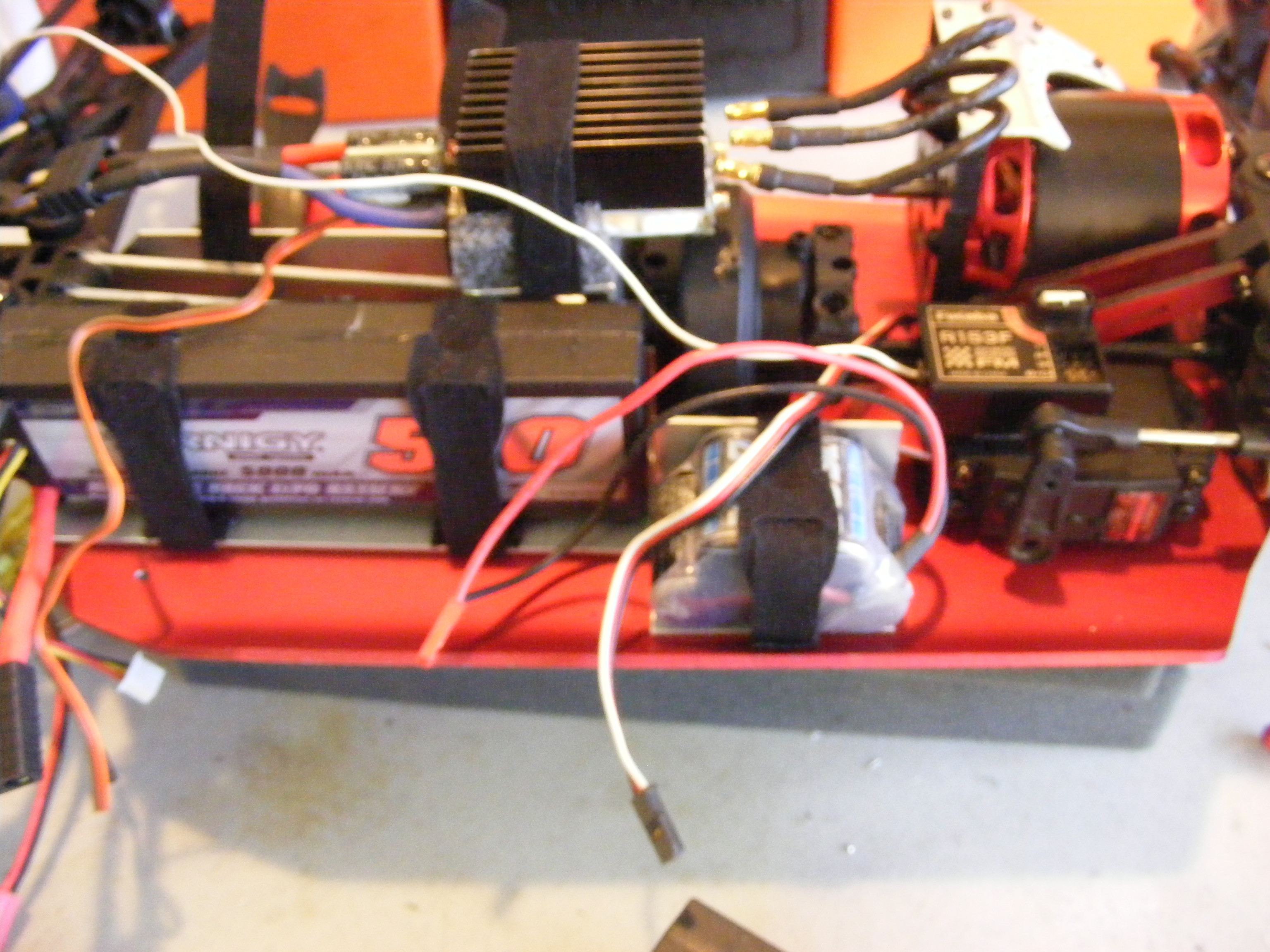

Here's some body-off shots.
1,2. Top profiles. You can see the battery trays and how they actually fit on the chassis. If you look closely, you can see that the top battery has some scarring. This is because I actually managed to rip the stupid 10awg wire off the top of the battery pack when I was attempting to push a soldered tab into a Traxxas connector: I pushed a bit too hard. So I had to disassemble my brand new pack, re-solder the wire to the top of the battery and weld the plastic back together. I think next time I will use Dean's connectors since they don't require me to push something stupid into another stupid something. [sm=drowning.gif]
3. Here's a side view of the battery tray. Just a piece of aluminum angle cut to size. I drilled out a hole as you can see so I can access the screw which holds the chassis brace. These aluminum angles are quite lightweight. I used servo tape to fix them in place and then riveted each angle to the chassis with 2 "skookum" aluminum rivets (5mm3/16). "Skookum" is a word I learned while on Vancouver Island and is Canadian slang for heavy duty (actually, I think it's native in origin). Now you know. I figured if rivets can keep airplanes together, why not the battery packs in my truck? I mean I've seen a jet wing flap like a birds' 30,000 feet in the sky in harsh turbulence....and the rivets held. The rivets do slightly protrude on the bottom, but they are rounded so they won't catch on anything. The servo tape, along with the Velcro, will act as a good shock absorber for the battery packs.
4. The ESC is mounted using...you guessed it, aluminum angle. Yeah, I know, I had another location I was planning on putting it and I was going to use a nice piece of carbon accent panel too. But I'm not going to talk about that. [sm=tired.gif] It's attached to the diff where the brake assembly used to be. I custom cut some foam to act as a cushion for it and, if you can see, mounted it between some fuel tubing on the screws. This will further help with absorbing vibration and shock.
5. Here you can see the new location for both the battery pack and the receiver (which is dead now, thanks to a brain fart.) [sm=punching.gif] I'm now using a standard 5 cell receiver battery pack (1600mah) rather than the Lipo one I made since this one actually fits. I've fastened the angle aluminum in the same manner as the larger battery trays except I've only used one skookum rivet.
