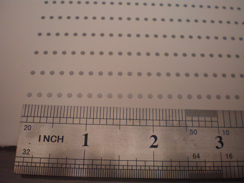

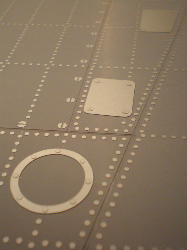

For scale details on model modelers use many different techniques. This I want to introduce here is simple, trouble free, and give perfect results...
Create scale detail never been easier... With Mirce Finish Set, you can made panel lines, rivets, dummy screws...
Mirce Finish Set is made of Oracal silver self adhesive film, and contains:
- 100 meters - 1,4 mm wide
- 15000 - 2 mm diameter circles - rivets
- 250 dummy screws 2,5 mm diameter
- 250 dummy screws 3 mm diameter
- 250 dummy screws 4 mm diameter
- 2 meter transfer film for applying

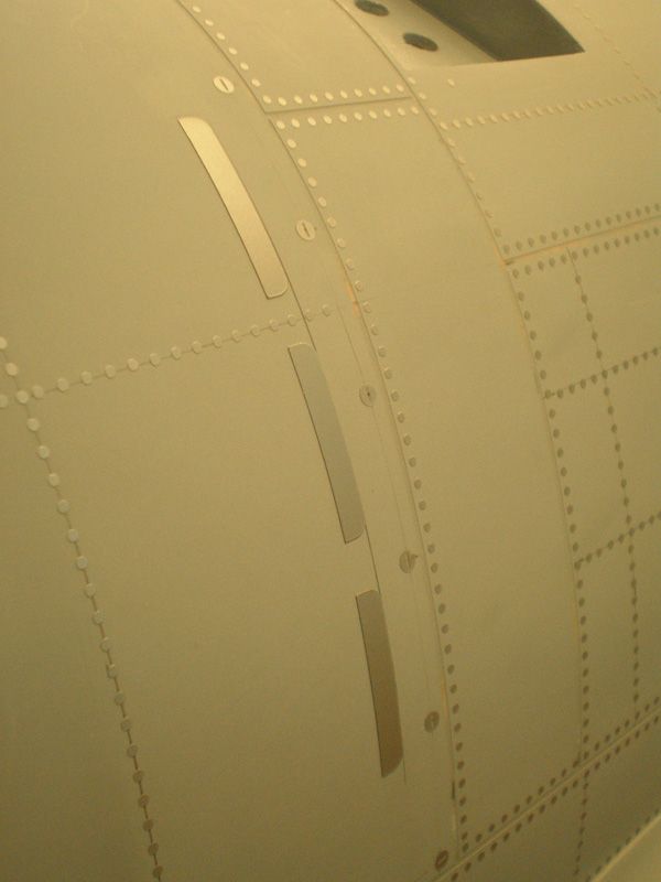

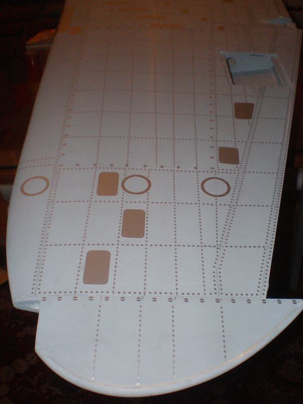

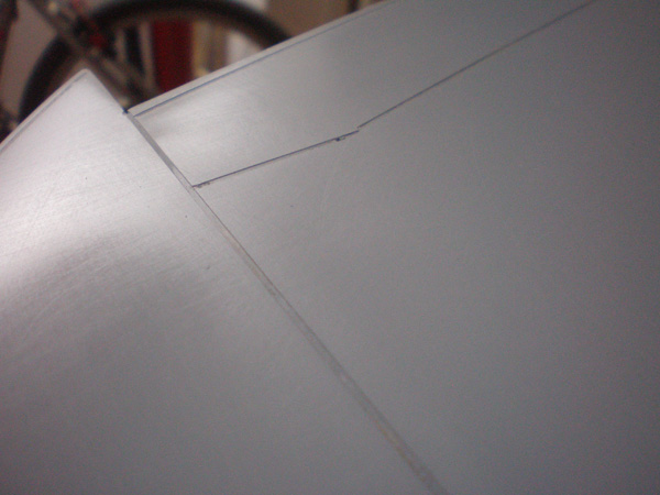

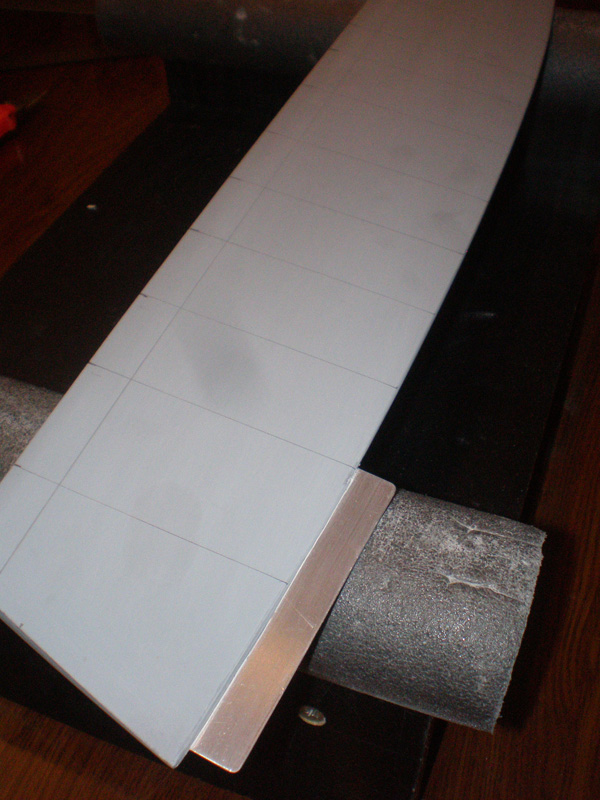

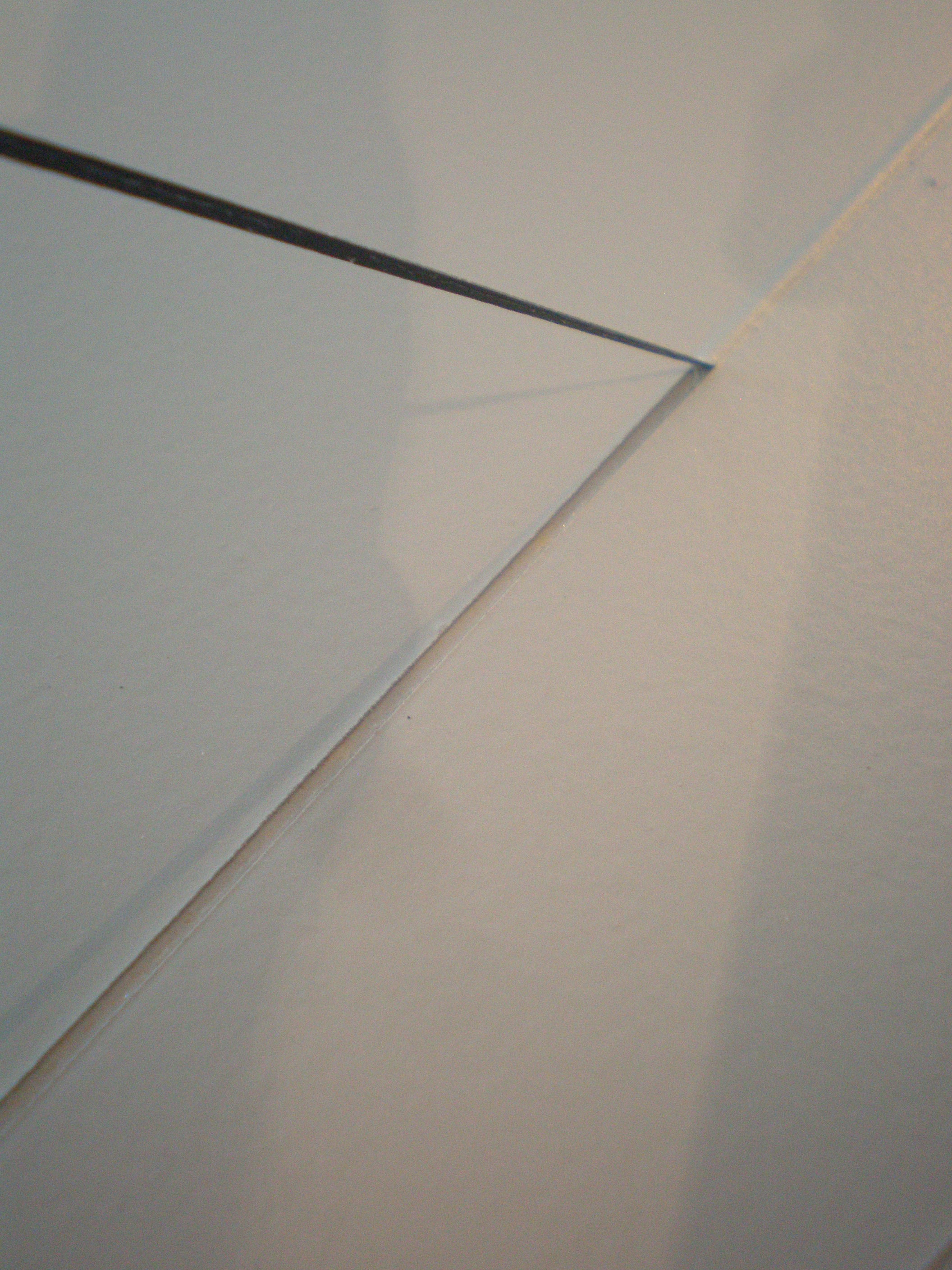

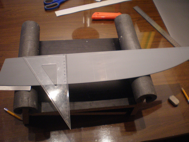

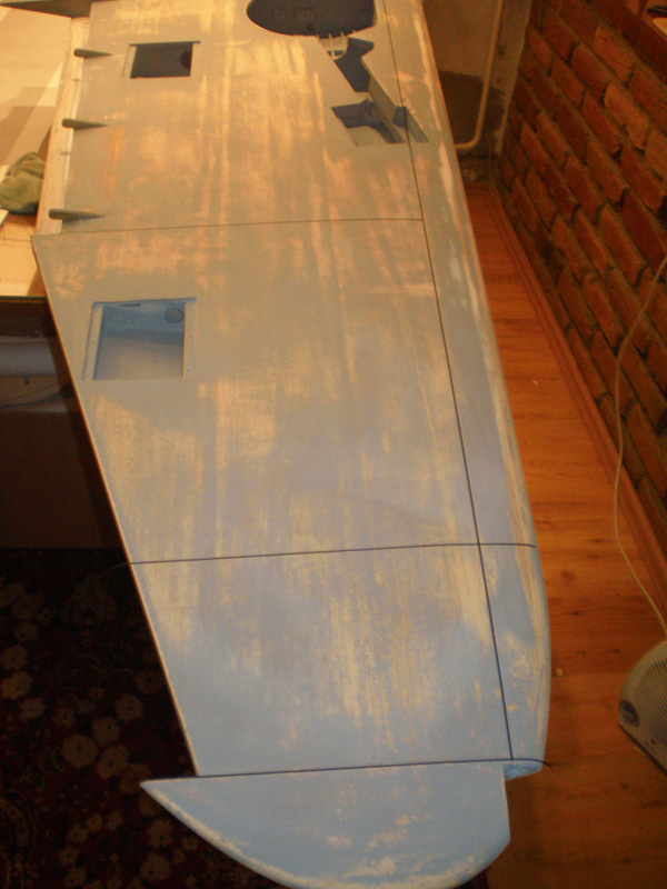

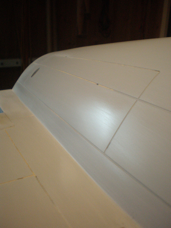

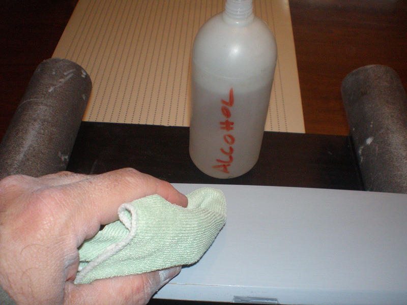

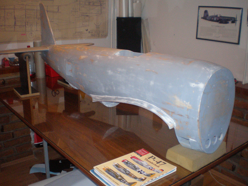

Panel lines placed on the prepared surface... After glassing, adding filler and sanding surface is ready for setting panel lines...
Surface must be clear, and before setting you must wipe it with alcohol.

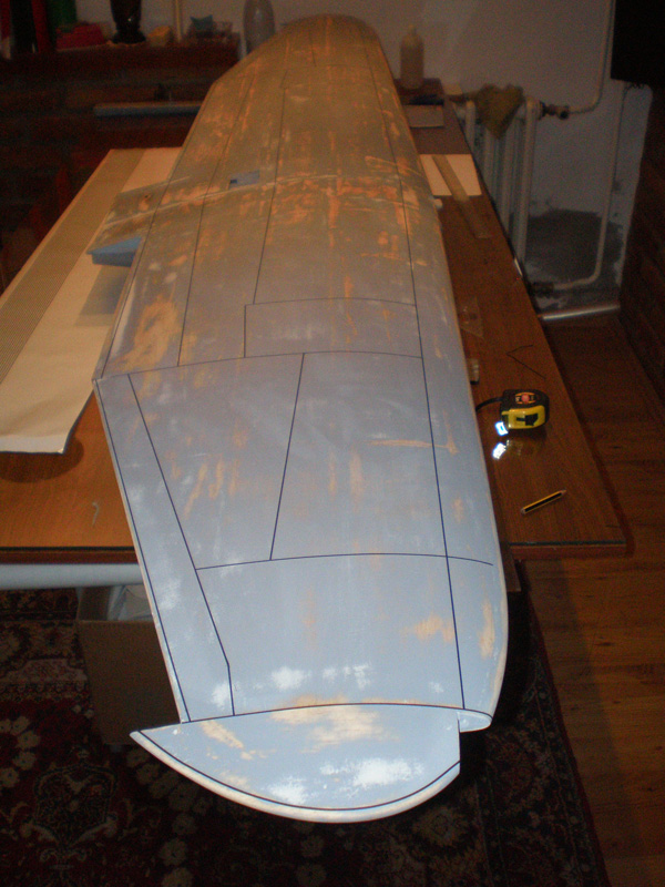

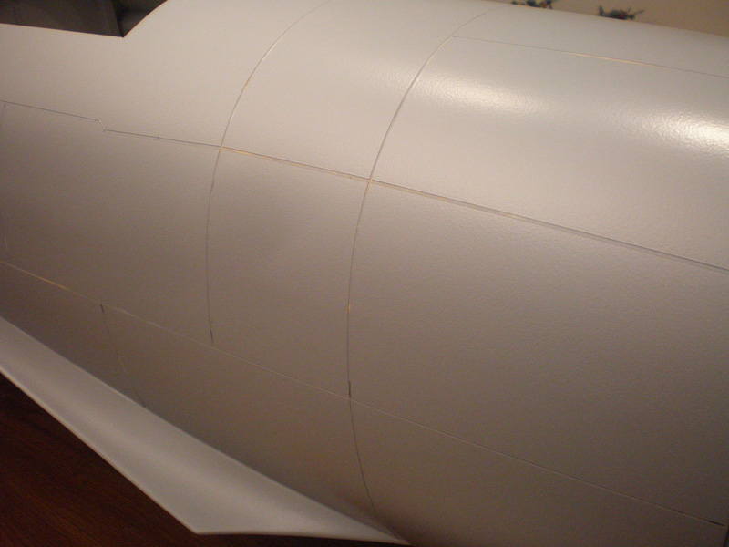

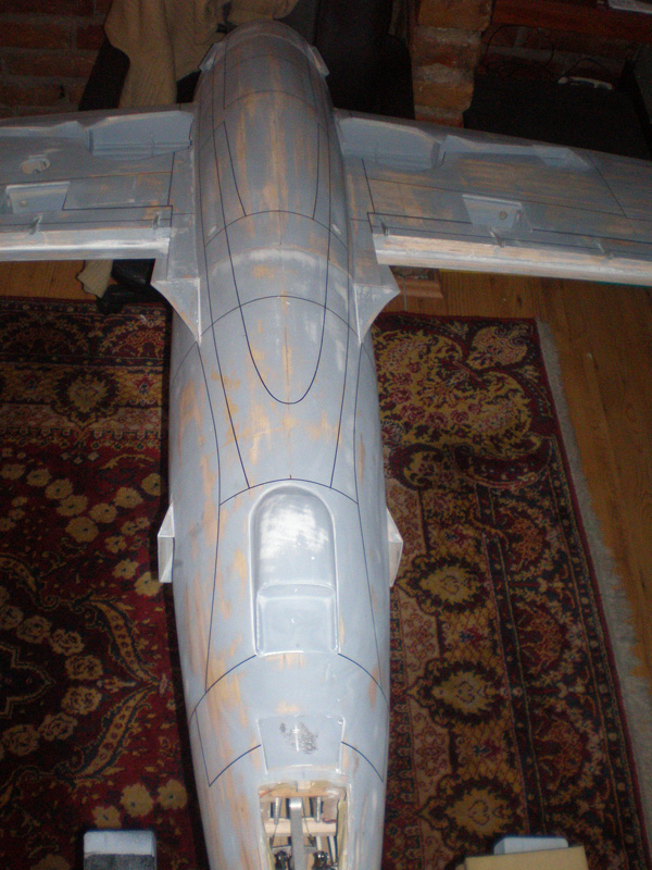

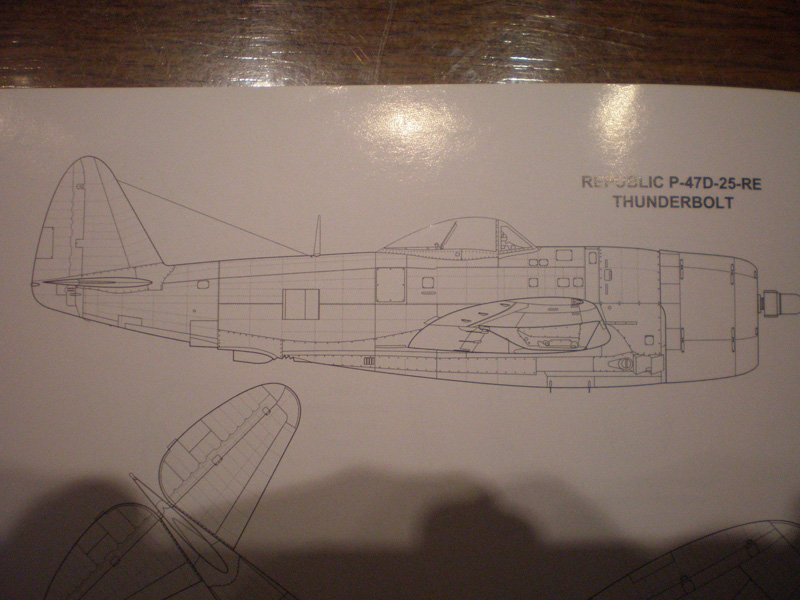

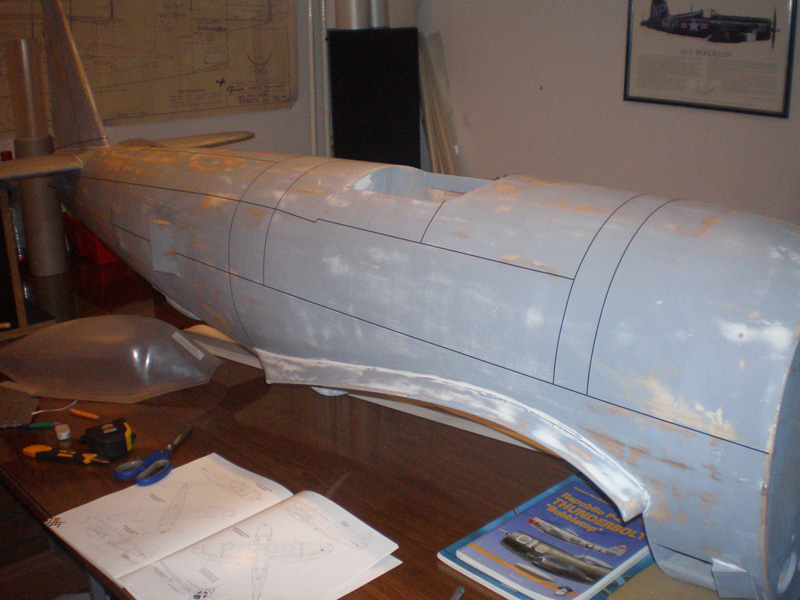

For my P 47, I used scale draw for measure where every line must be placed...
Every line is now on place...

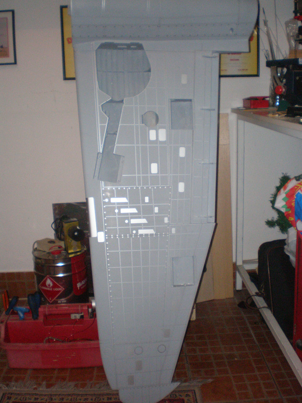

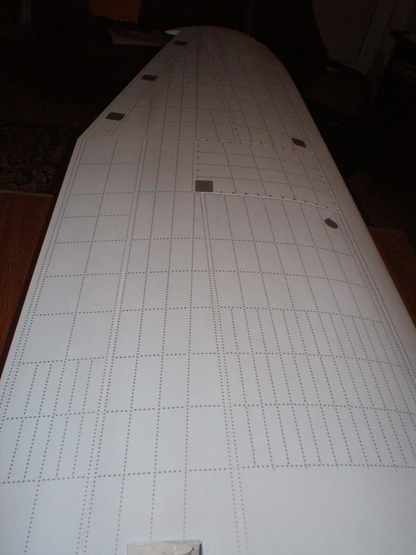

Same procedure is on the wing...

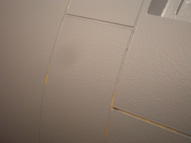

After this stage, my friend put few layers of acrylic filler. You need 4 - 5 layers to get good thickness...

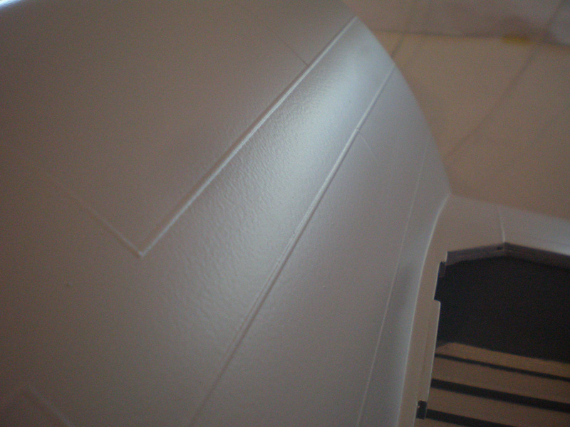

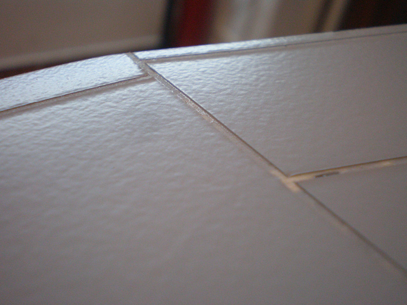

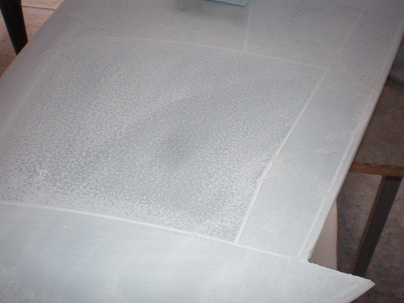

When filler was dry, surface look like this... Next step is taking lines out from filler...

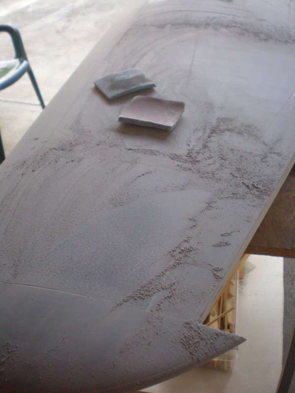

Next step was sanding, first with 240 grade sand paper...

...and then with 800 water sand paper...

Surface is now nice and smooth.

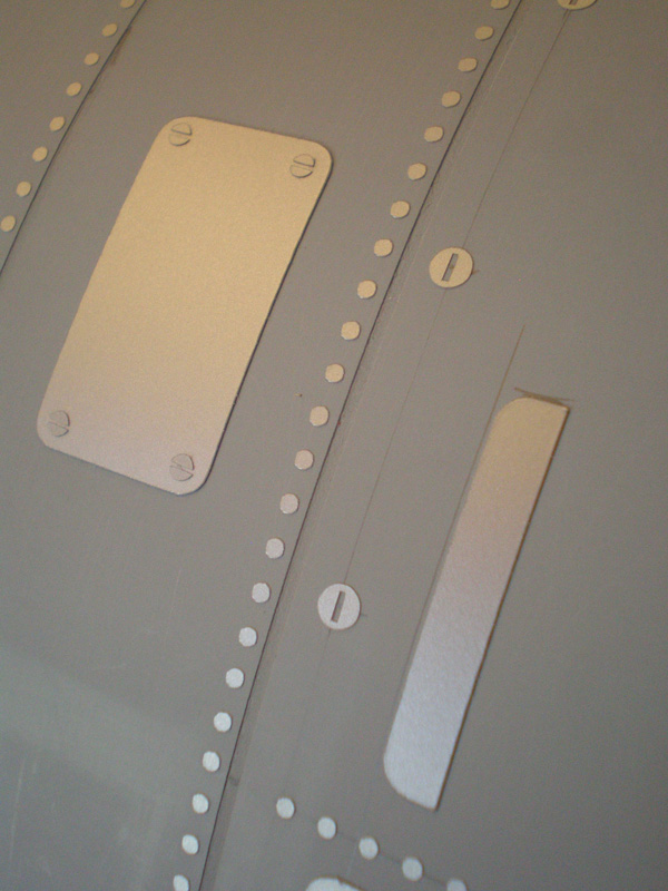

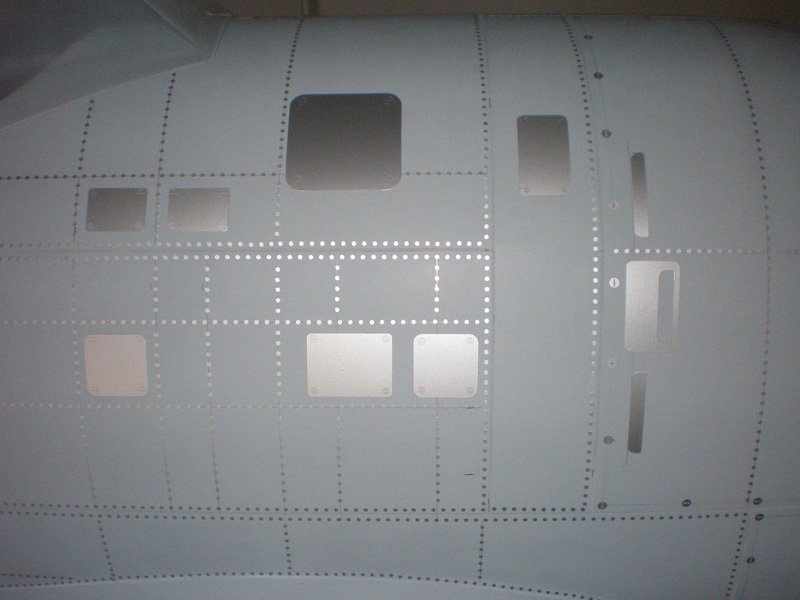

Rivets...
First step is to wipe surface with alcohol and draw guide lines with pen...

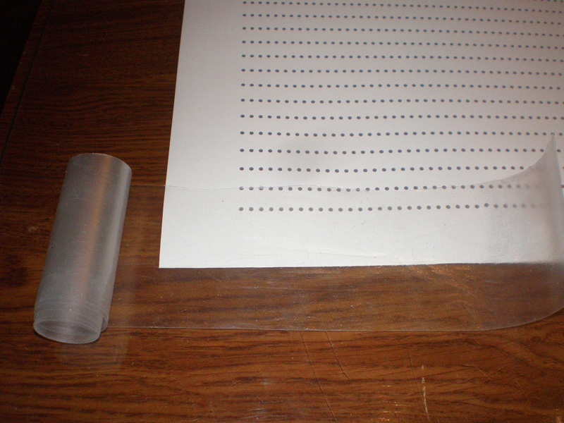

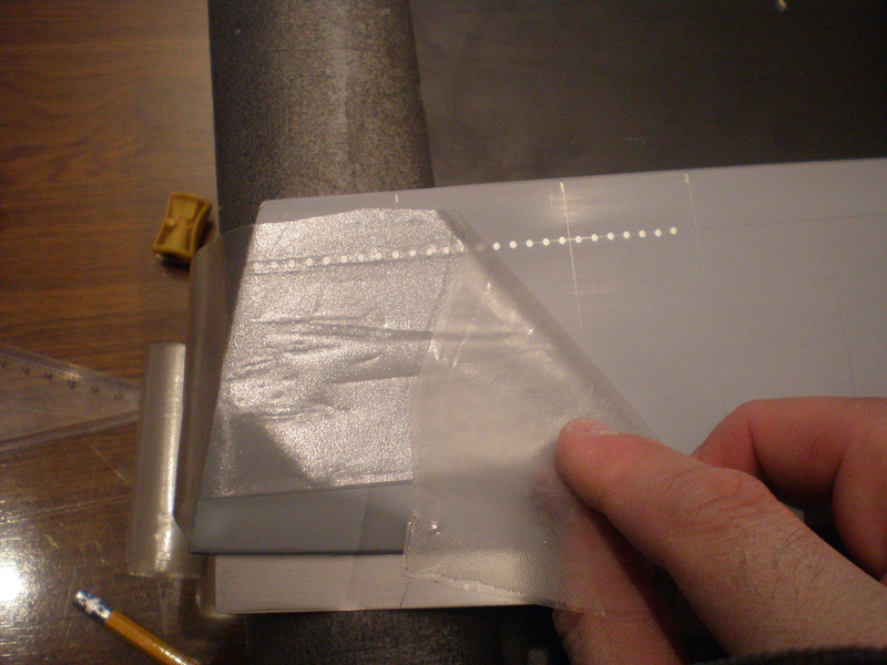

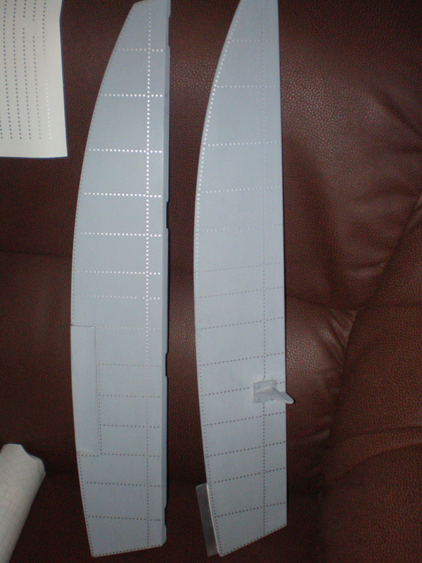

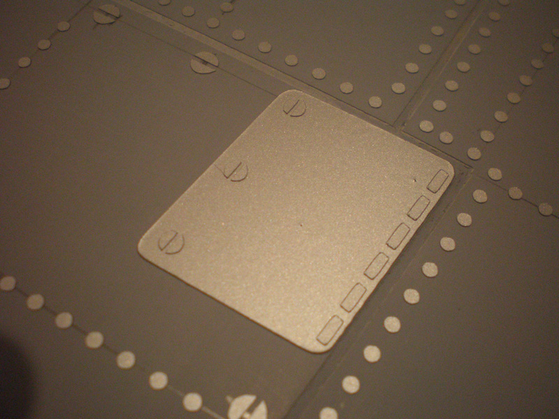

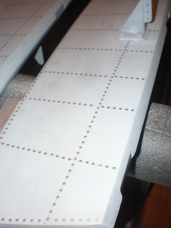

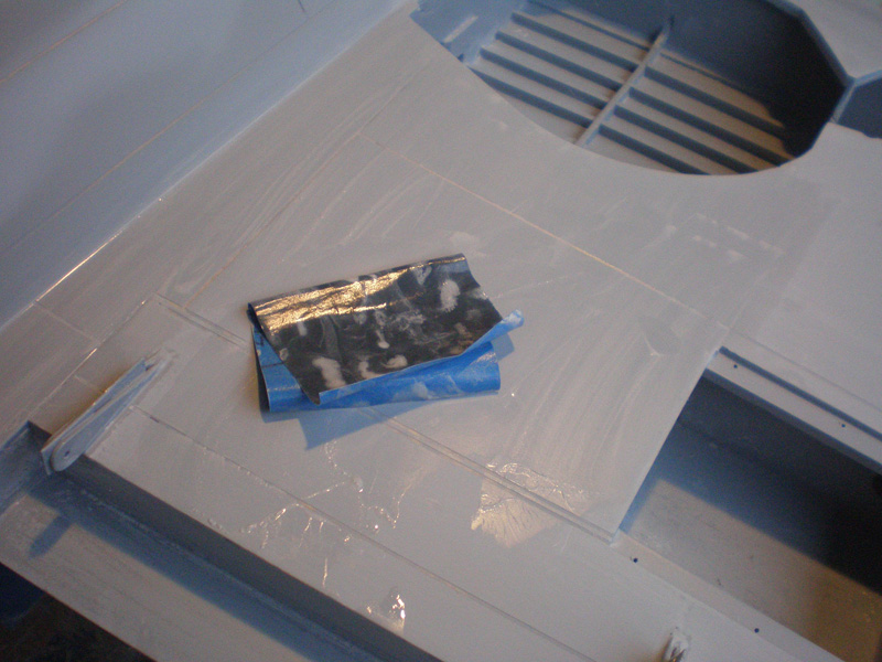

With transfer foil pick up one line of rivets and apply it on surface...
Than gentle push a transfer film with rivets, and take it down...
Transfer foil you can use multiple times...

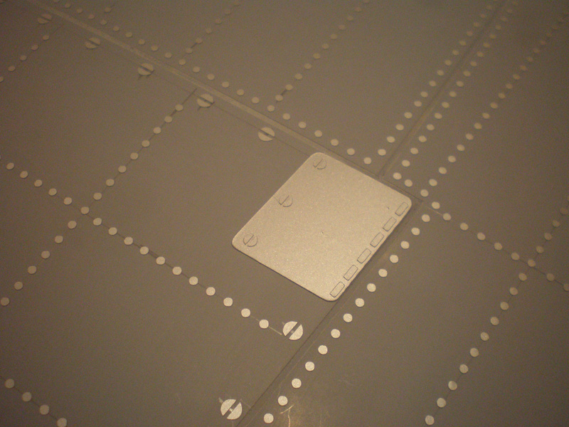

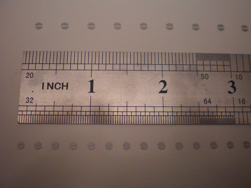

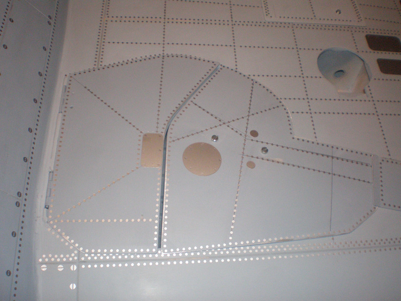

Finally, surface look like this...

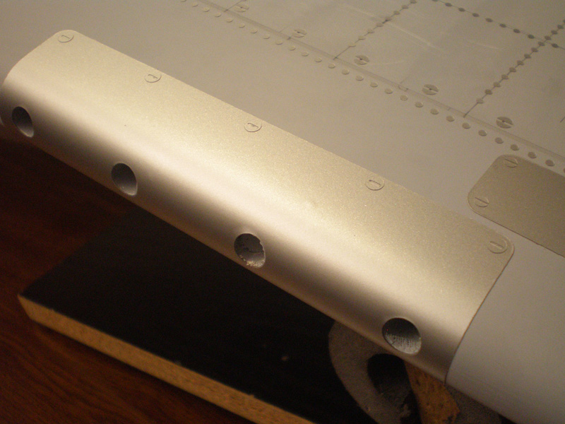

In meantime I finished P 47, and this is continuing of how Mirce Finish Set look...
For 100" P-47 I can offer Detail Set with complete details for wing and fuselage surfaces. Some pictures you can see here before, but here are few more...
Mirce Finish Set has dummy screws in few dimensions. Some I use on lower part of the fuselage and the wing...
For cowl I used pictures from Thunderbolt which is in Belgrade Air Museum...
When I put flaps on cowl, it look like this...

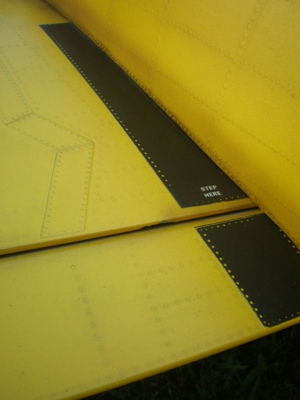

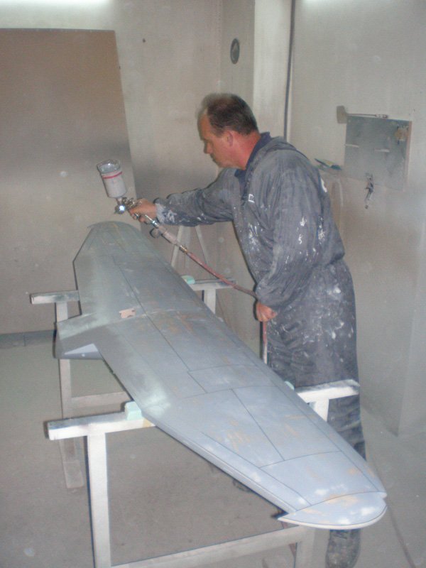

After adding all rivets and other details, parts was ready for painting. Silver color is all caught up...
Before other colors I must made paint masc. For stars and bars I made it from Oracal's Oramasc foil, which is designed for this propose.
Paint masc are also available for this P-47, but for some other models also...
Same procedure is for under side and fuselage...
Than everything was wrapped in paper and prepare for next color...

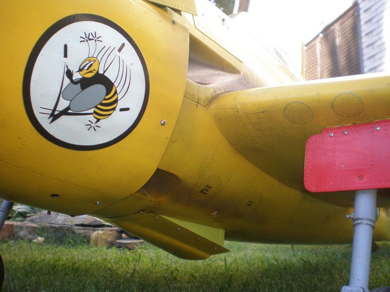

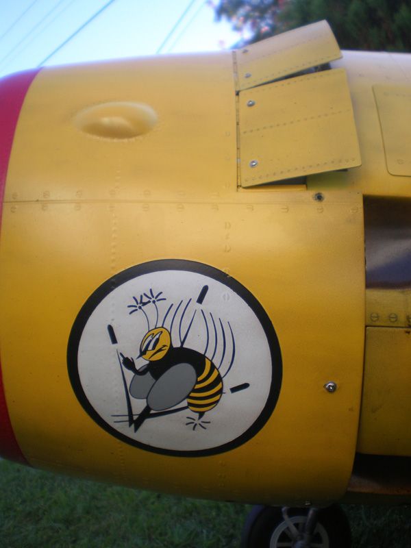

After painting insignia on fuselage and wing look like this...
As I told earlier, for paint masc was used special Oramasc foil, which is made for that propose. This foil is little gummy and it can apply on every surface. Edges are sharp, and because it is made for painting, stripping foil is easy without any glue left on surface...
Same paint masc I used for all letters on model...
...and for line on fuselage...
After painting...

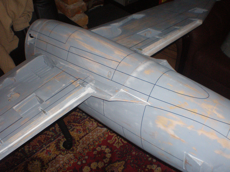

When all colors was painted I made weathering. OK, this is not something what I can offer like some set, but it take model on next level...
On P-47 I used pastel colors for this process. Most important is to after all colors you add on model in this last step, if made some mistake, it can fix without any problem. Pastel color is easy to take off...
I use tree tone of pastel: black and two brown tone...
Pastels are soft ant it is easy to sand it...
...than use cloth and apply it on model surface...
In model this size must be done part by part. But at the end result are great.

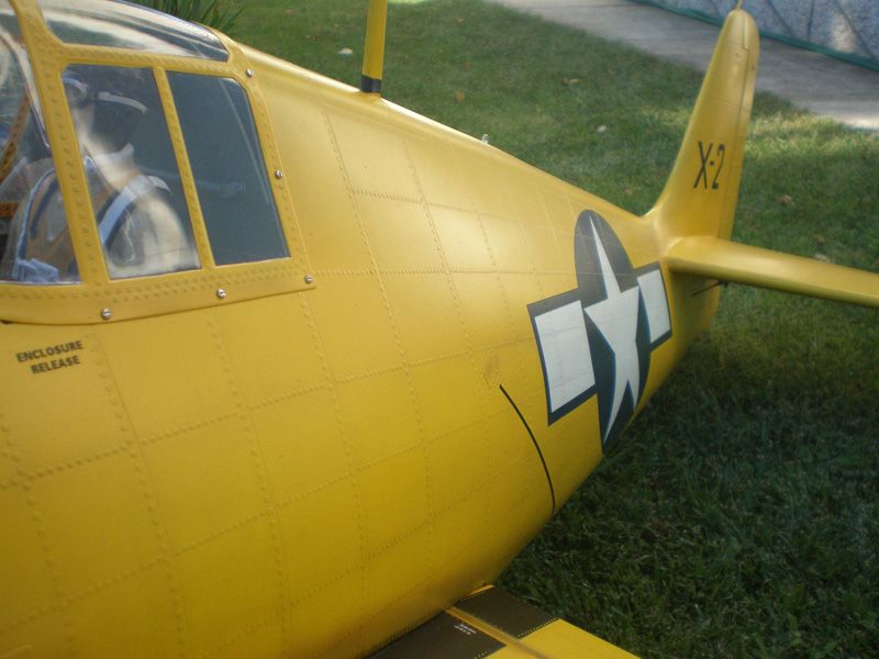

Finally, last step was painting clear cote...
Same procedure was made on my Ziroli F6F Hellcat. On yellow paint result are maybe even better...
Mirce Finish Set can be used not just for Thunderbolt or Hellcat, but for any bigger model.
I can made bigger and smaller rivets, depends of model size.
