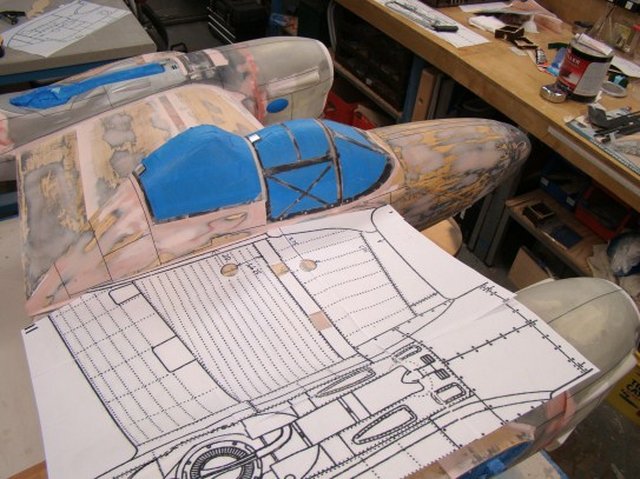

Hi guys,
Ok; I am no expert , this is not a tutorial and by no means is this the only way to do it, but I like it.
Peter.

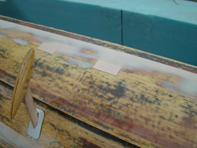

Yes this technique does work well when combined with panel lins and rivets. It should be employed on the right panels and parts of a plane to replicate raised panels. Typically panels assembled on wing ribs are even in height.
At this stage if you striped a panel line with anything from pinstripe tape to fishing line you can build up the other panel edge like youve done so far. This will result in depressed looking panels that span a structure underneath. Then add rivets and the job will be impressive.
Cool work so far! Ive done this before on older scale helicopter master models and the effect is realistic.

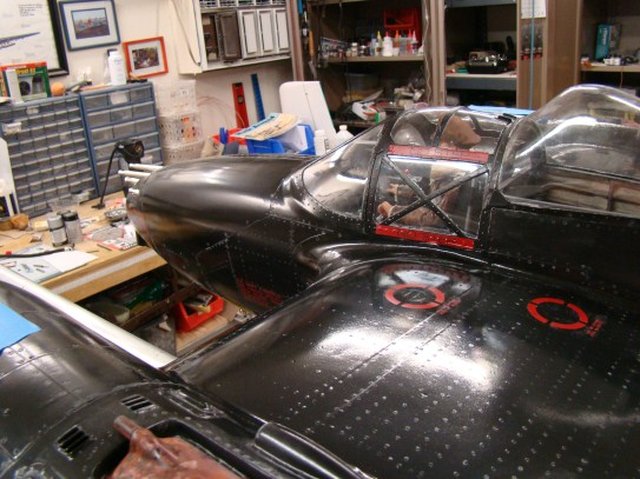

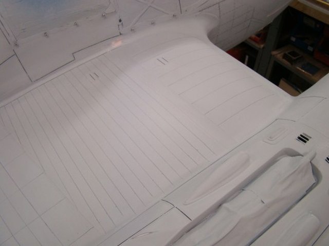

Fuselage in primer with rivets shows finished product.
Flush panel joints on front half of fuselage are done using same technique back to back leaving small .015" gap.
Joint is then pre-shaded using fine tip marker which will bleed through.

I use the same method for overlapped panels and the results are worth the effort. I do use electrical tape instead of paper based masking tapes as the electrical tape will go around curves and does not disentegrate when wet sanding which I prefer to dry sanding. The hardest part of the process is often just figuring out in what order to proceed with application of the panels and then not accidentally building up on the wrong side!

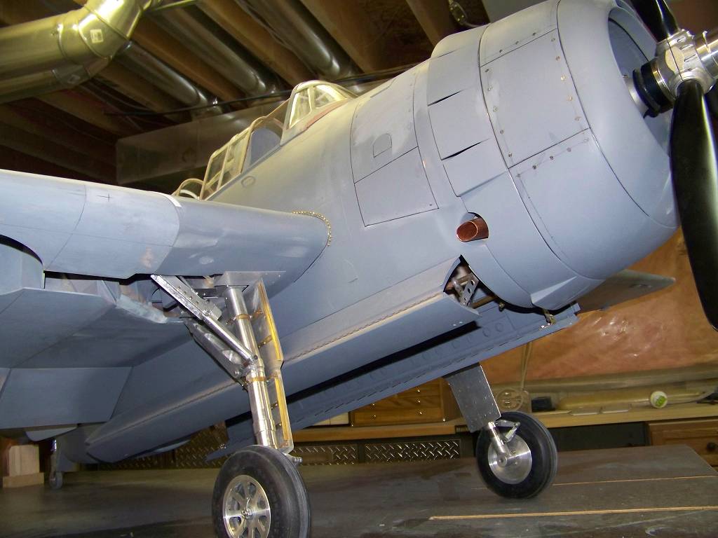

You are on the right track. I made not ony the panel lines also access panels/ fuel caps this way.
Pencil for rivet lines

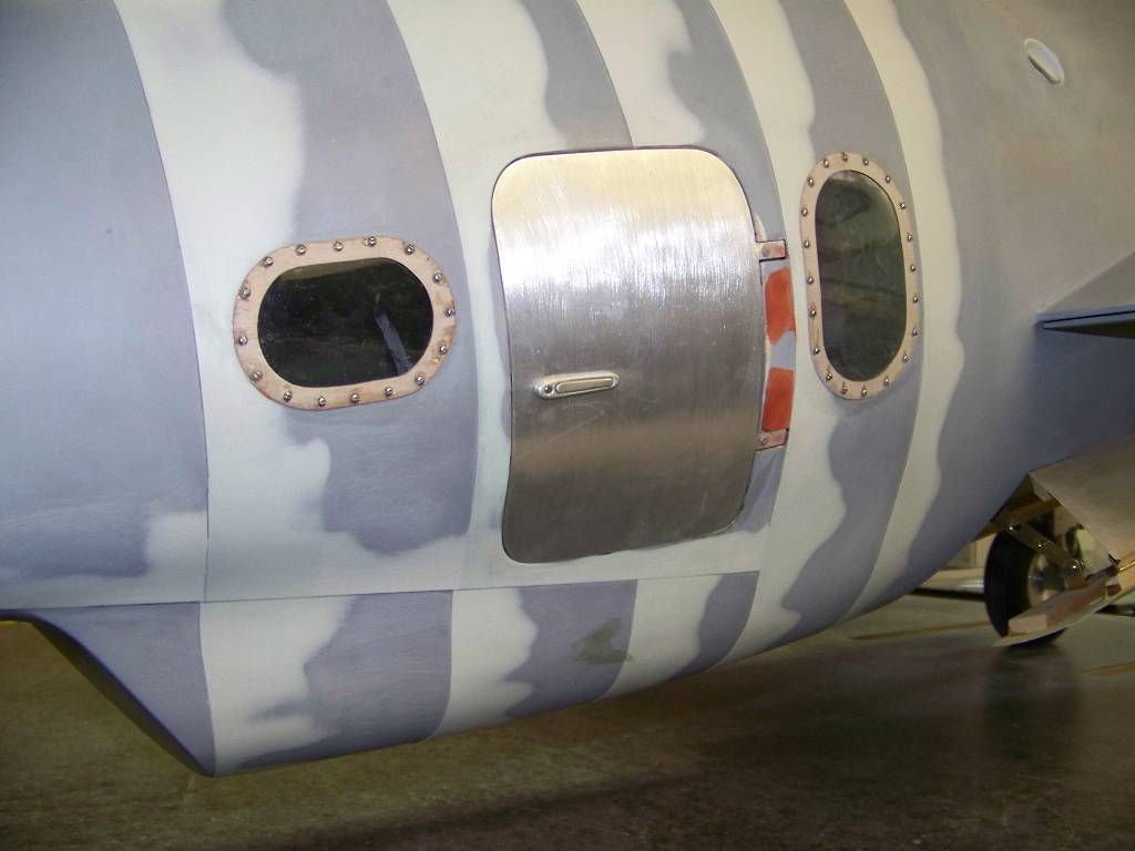

Hey G-pete looking good.
Good Idea using filler for shaped non-functioning hatches.
For functioning doors and hatches I like to use aluminum (maintains it's shape).
For fixed (non operating hatches) I use .020" thick plastic.
