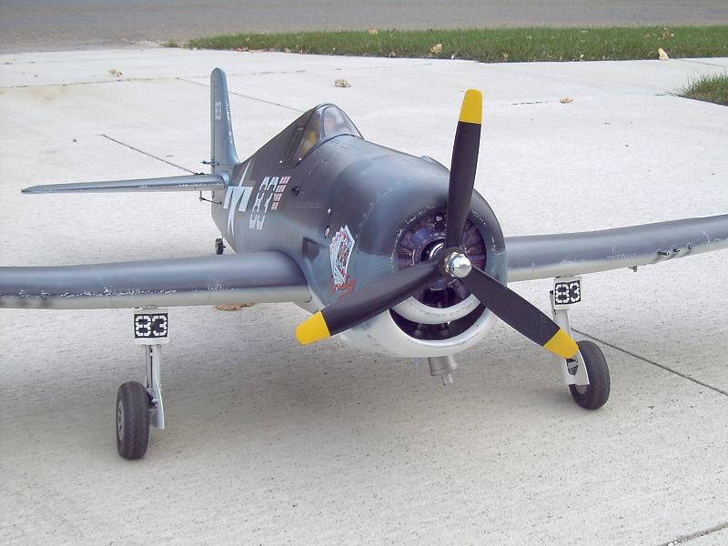

I think mine were long enough. Keep in mind, the blind nut purtrudes into the firewall a ways, so the screw doesn't need to actually go past the back of the firewall.
I had my Maiden flight a couple of weeks ago. The plane flew great. It was a bit faster than I thought it would be, but I'm not complaining. I'm running a Saito 1.20 with a 15 X 8 APC Prop. I have a Graupner 14 X 7 3-blade that I'm going to try next. I finally got a chance to finish up some of the details, including the cockpit and gear doors. I'll post some photos of the complete plane when I get it all back together. Here's a couple showing some of the details and the gear doors before painting.

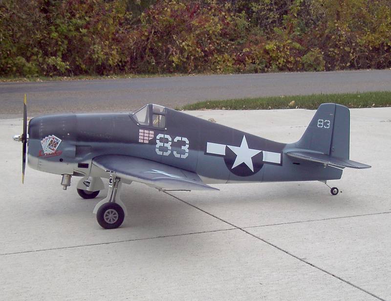

This plane flys great, and can look pretty good with a few added details. I repainted mine using Testors paint, then coated it with Polyurethane. I think it turned out pretty nice. Made the gear doors myself, and they seem to work pretty well. Since I live in Iowa, I'll be waiting a while to get some more flights in. Check out some photos.

Radio switch, glow plug remote, retract valve, they are all fairly exposed. I wasn't really going for a high level of scale. Look at the tail wheel and the tail feather controls and you see other things that could be improved. I knew this would be a good flyer, so I was more after a plane that looked good but was easy to use day to day.
As for the paint, I used testors spray can for the intermediate blue. The darker blue is called sea blue, and only comes in the bottles from testors. I had to thin it and spray it on with a gun. The white is just rustoleum white, but the polyurethane topcoat darkens it up a bit. Decals are from Major decals, and it takes two sets to get four of the large stars with bars. The paint was applied right over the original, and seemed to stick very well. The polyurethane is minwax (NOT water based) and is very fuel resistant.
