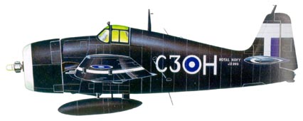

Why not do it up as a Gannet, in RN camo?
Andy

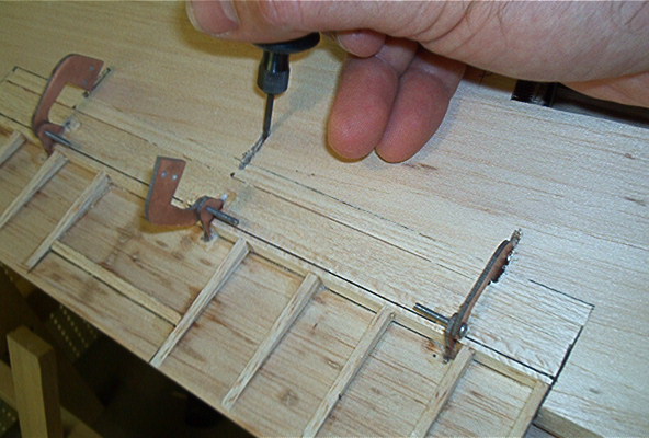

I was going to show more on the drop tank, but I've had some questions about the aileron hinges so I'll post more detailed pictures of those for the guys that may want to do them, very easy and I recommend them. VERY slick![8D]
Using the drawings mark the hinge pivot point on the aileron itself. (At this point the aileron is not shaped and it is tack glued to the wing with 3 small spots of medium CA to hold it in place.) Then cut out 3 pieces of light ply with a pivot hole drilled at the proper height. Using a piece of wire as a guide align the ply pieces on the hinge line and tack glue them with medium CA. Mark the location of smaller aileron hinge pieces and using a Dremel with a small router bit cut those slots out. Pull the wire out and install on the smaller hinge pieces holding them in alignment with the wire. Glue them in with Medium CA making sure to get plenty of glue in the glue holes you drilled. I fill any voids with Micro-Balloons and thin CA.
Next Pull the wire out and assemble the hinges. Using the bigger wing mounted side of the hinge as a guide to Dremel out the holes on the wing side. Make sure that you installed blocks in the wing for these things to mount to! I marked the hinges on the side so I knew how far they had to be buried in the wing and aileron. Just scribe the parts with a hobby knife, works good. Glue those in the same way as the other hinge parts. Take the bolts out and pop the aileron off and then shape it as shown on the drawings.
Dion
