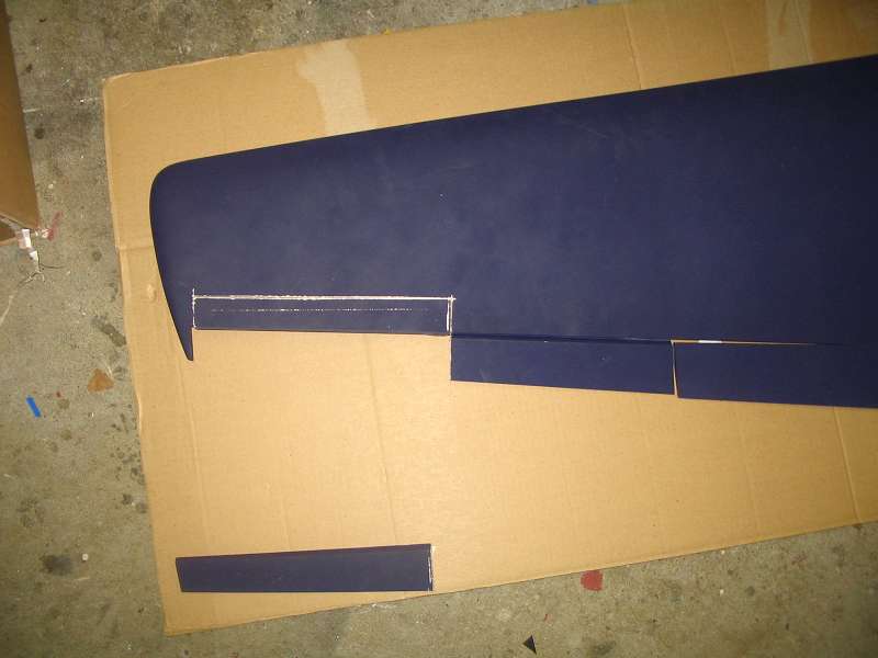

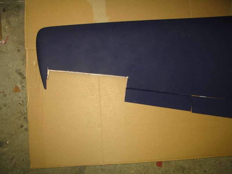

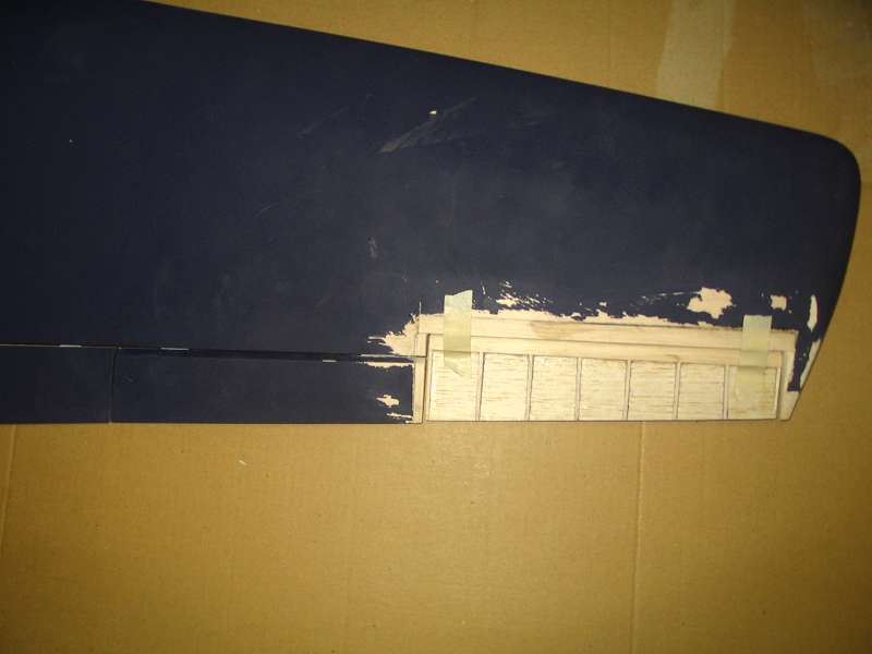

First pic is the stock wing with second flap section cut and new aileron outline. Second shows aileron piece reoved. Third shows area for new barn door aileron
