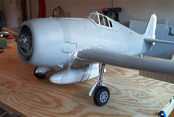

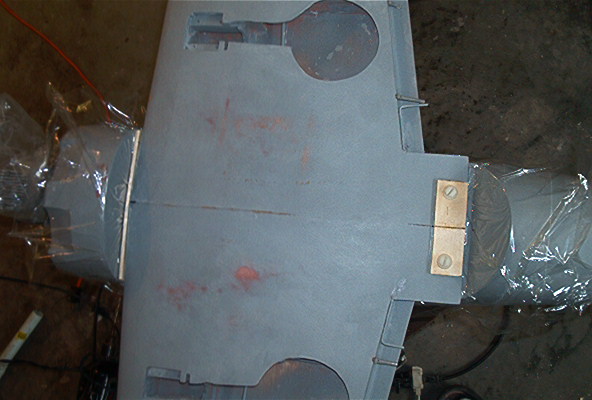

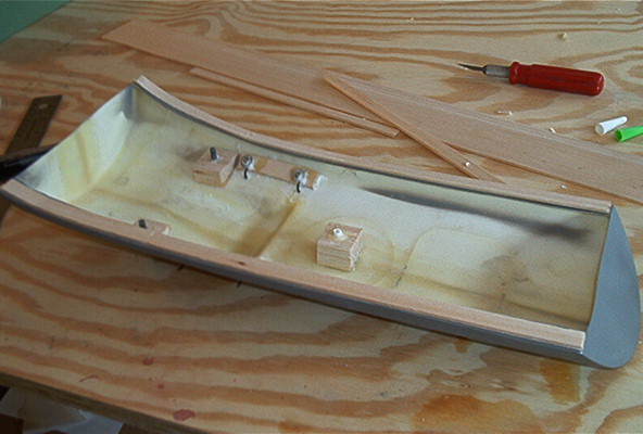

I'll try and keep the pictures coming so you all can follow along (even people who say they stopped reading my posts a long time ago but somehow knew I was on vacation!lol)
If you cut the 3 inches or so off each wing half you will have to install a spacer at the leading edge of about 3/16†balsa. The wing has to sit in the center of the wing saddle, so you should have a small gap at the trailing edge also. Notice that I attached the wing with some plastic wrap to keep glue and filler from gluing the wing to the fuselage.
Next I added 1/8†balsa to the belly pan, I just needed to sand a little off on the front to get a good fit.
I glued the belly pan to the wing and added a little extra thin CA to the joint.
Then I mixed up some resin and Micro-Balloons and filled the gaps, both in the leading and trailing edge areas.
You know how it is, you have to set it up on the gear for the first time to see how it looks! The gear location looks almost scale to me, much better than stock if not scale anyway. I’m currently experimenting with the Hangar-9 3 ½†wheels, they are almost exact copies of the Robarts! Only difference is that the tire is much thinner and therefore fits into the wheel well very easily. 3 3/4" wheels would probably be perfect, but I had to get them to fit in the wells using CJ gear, not easy to do. I can almost smell the paint, getting real close!
Dion

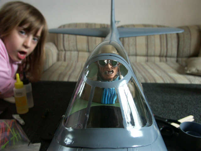

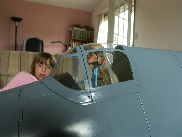

Finally. I had to wait untill my pilot reported. Although I did fly it this weekend with the new canopy, and it certainly does add immensly to the plane's looks.

Looks great Andy! LOL, she also has that pilot expression down pretty good!
