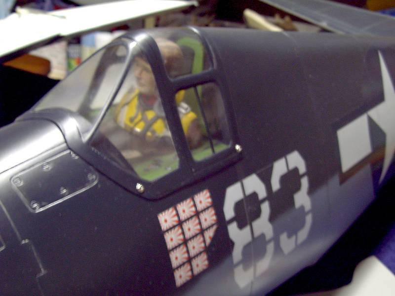

I find it's best to use something with low gloss to get the best effect. Add high gloss to the lips and eyes only.

Great stuff, i completely afree regarding the use of flat paint...It makes all the difference.
Those are some impressive busts!

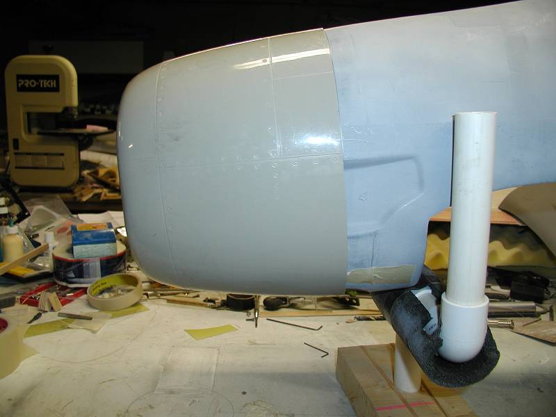

I have the new canopy painted and installed. Here is a before and after pic. The big difference will be more apparent when I get the plane outside for some overall shots, but it sure does look better. Thanks Luke!

Your airplane sure does look much better.
I have a cowl that came with a Bob Holman/Brian Taylor kit and it is nearly identical except the BH one is much sturdier. The fuselages are nearly identical even the wing saddle is the same. The Holman one has no bulkheads inside the fuselage. By using Brian Taylors plans one could build a much closer to scale wing and tail surfaces. The CMP kit could be purchased and then the plans and wing /tail ribs could be purchased from Holman seperately. Considering what I paid for my CMP it would amount to a saving of almost $100.
It would be best to buy all of Dion's upgrades to make a really nice model.

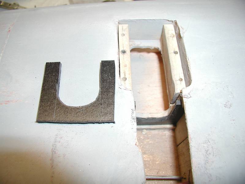

As all of you know the Hellcat, P-40, AD Skyraider, and Corsair use rotating retracts. They require cutting away part of the wing spar. I have made from carbon fiber plates that I am installing to reinforce the area that had to be removed.

Hal great idea , I did not think of the carbob fiber for that area can you please give me your source for CF , hobby shops are scares in Pa
