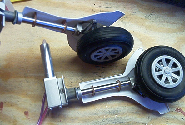

The ones that Tower sells are not correct. The struts are too short. I think that CJM makes a set that would be correct. You will need to order them direct. Send them an email [email protected] The correct part number is 36699.

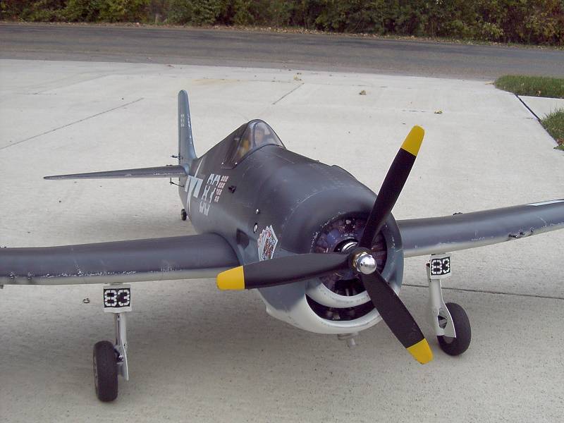

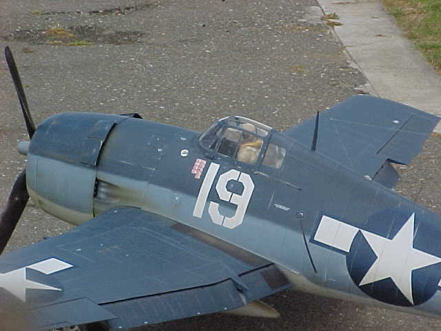

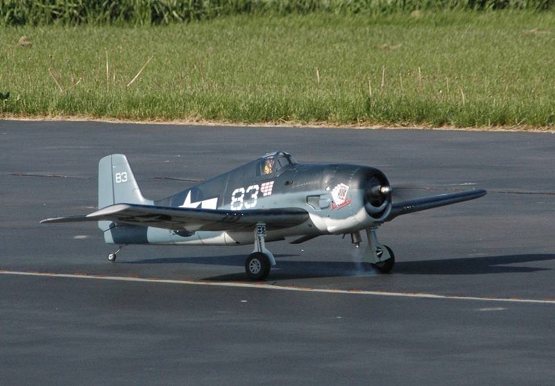

Your friends Hellcat looks very nice. It is so nice to see an airplane that is painted with the correct colors and markings. How well did it place as far as static and flight points ?

Thanks for the post and compliments Ernie! I have that same kit, but I do have some problems with it. The canopy and cockpit area is to small, I'll have to fix that on my plane. (Look at the picture below) He has done a great job at detailing it though, I'm going to do Vraciu's markings on mine! I'm doing his last plane #32 though. I've been working on my Hellcat now, but I'm going to wait to post pictures. The details really don't show enough to take a picture.

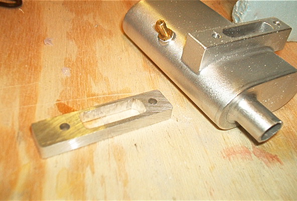

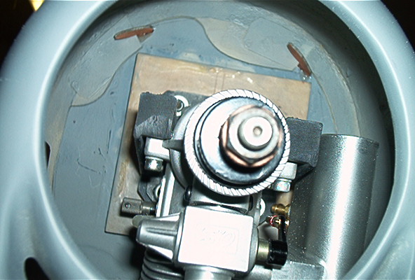

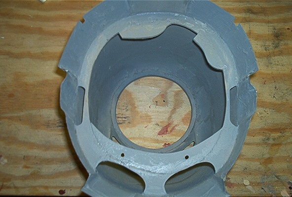

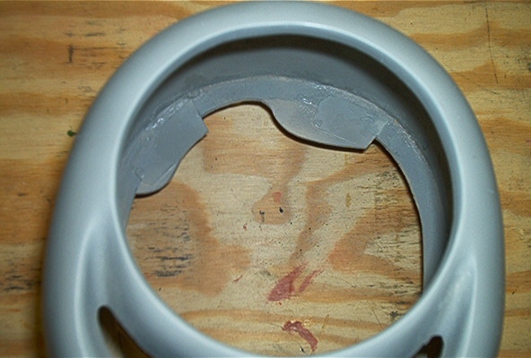

OK, I know I said I was not going to post another how-to but I just could not resist! I have a few things I’d like to share in this post.
First one is cowl attachment with no screws showing. You might say big deal, right? Lol My system has just 2 cap screws that have to be installed and even if they came loose the cowl would probably hold on the entire flight! I cheated a bit, I saw what BVM was selling and used his hatch hooks idea, or a form of it... with a twist of course! I like 50’s stuff so I’m calling it the twist-O-matic cowl retainer!
The cowl goes on quite easily, just slide it on slightly off center and twist as you push it to the firewall and it locks on. To add the blind nuts on the bottom I cheated a bit. Not wanting to try and stick them in from the back I just cut slots and installed a piece of 1/8” ply with a blind nut already installed.

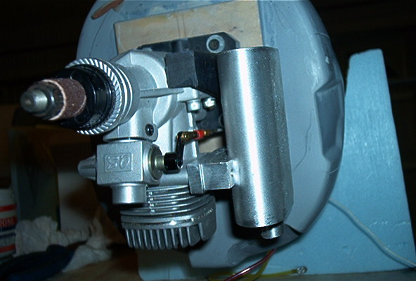

Hal and I are using the Brisson muffler, fits nicely in the cowl but it does need a spacer to clear the engine mount. I machined one out of 3/16” aluminum and that gives plenty of clearance.
Dion

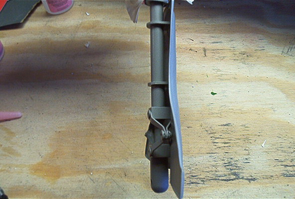

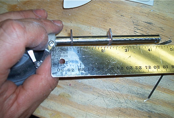

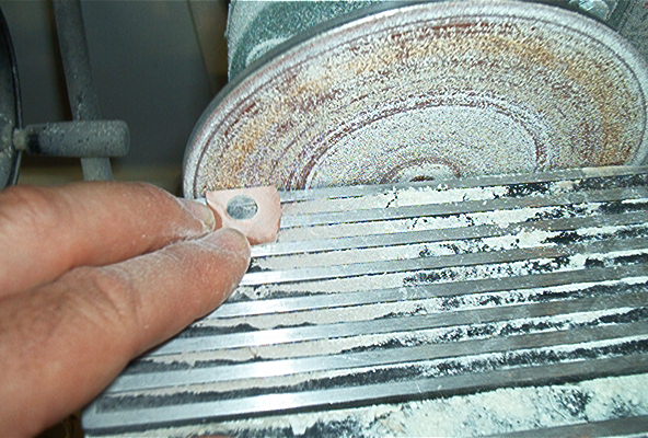

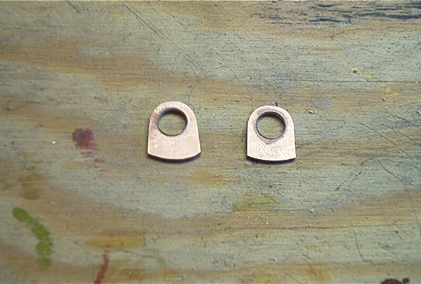

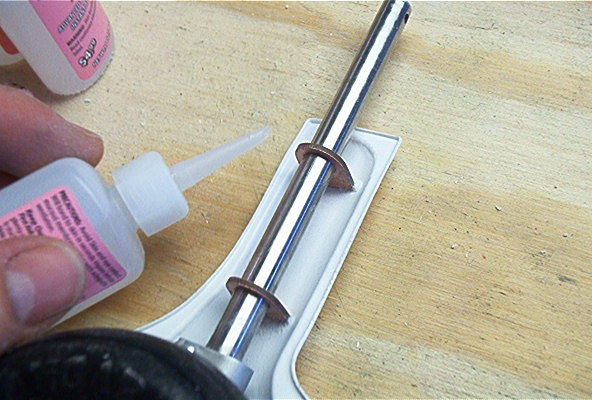

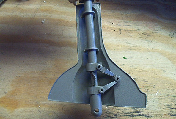

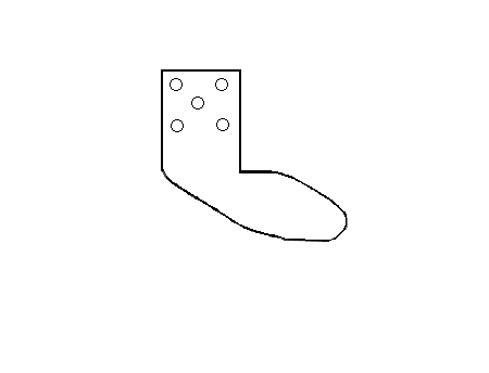

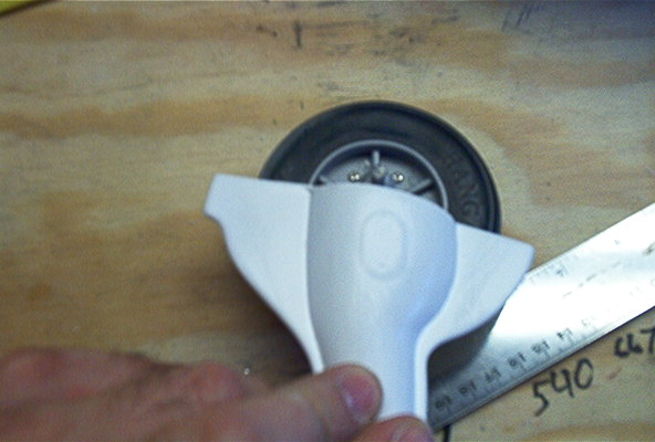

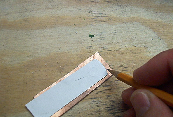

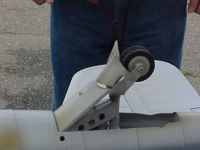

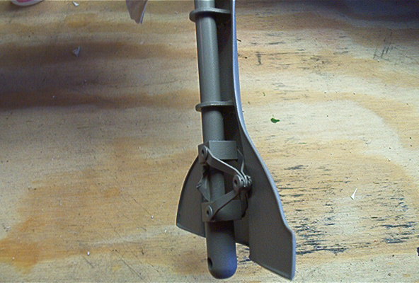

For those that want a more scale gear door retainer you can use PC board. I’m using the CJ gear so the struts are ½”. Drill 4 holes in your PC board with enough around the sides to work with. I used a template for the top and bottom door retainers, mark them off and sand the PC board parts down with a disk sander. Remove your struts from the gear and measure as shown from the top of the scissors. For the bottom retainer measure 5/8” up and for the top one measure 2 5/16” up. They will be a tight fit so no glue or anything is needed, also the paint will help to hold them in place. Glue the doors on with thin CA and dash the wet glue with some Micro-Balloons. If the doors ever need to be replaced I’ll just pop it off and glue on another one. Mask and primer, then paint!
Dion
