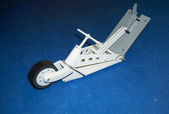

I made a more scale appearing tailwheel. I turned a piece of hardwood dowel so that a 1-1/16" heater hose would just fit over it . Made the wheel 7/16" wide. Drilled the center to 1/8"and inserted a piece of brass tubing for a bearing. I am using a 2/56 socket head screw for an axle. Marked and drilled the holes in the sides of the wheel.

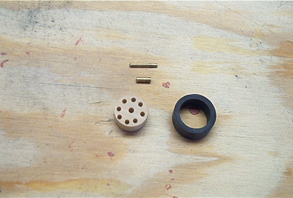

I was just giving Hal a hard time! This was a collaborative effort by both of us. We started talking over the phone about a scale tail wheel, I said that I could machine a hub out of aluminum and use a rubber hose as a tire. That’s what I thought we were going to do, but then Hal got to tinkering as usual and came up with the wood idea. I would have never thought wood would work well, but it worked out great. Aluminum would be to heavy for this size plane anyway.

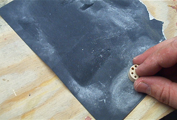

I used some ¾†inner diameter universal fit-all drain hose and a large hard wood dowel.
I used my mini lathe to spin the hub so that it fit my tail retract forks. Make it just small enough for a tight fit in the rubber tire. The center hole was drilled on my lathe and the rest were drilled on my drill press. As in all my tail wheels I use a 1/8†bearing axle and then the smaller brass tube as the main axle.
I sealed the wheel with thin CA and then hit it with some 320 grit sandpaper. Use a small round file to clean up the holes.
Now that’s a Hellcat carrier wheel!

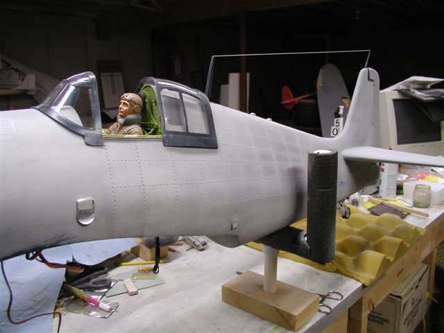

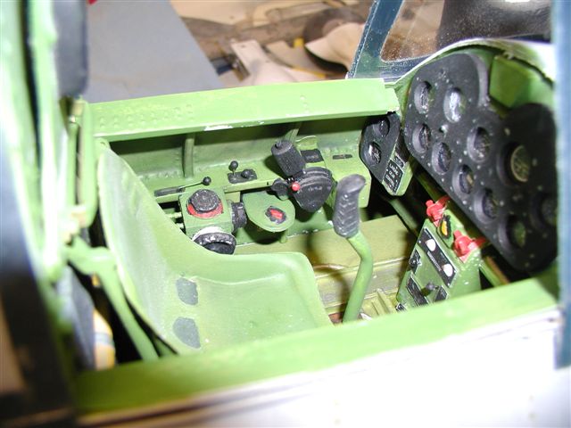

OK, what has Hal been up to? He is kind of slow at posting pictures so I though I'd show you a few of his cockpit. The back window still has the film on it so it looks a little cloudy, but that will come off after painting. Looking great so far! Nice work Hal!
Dion

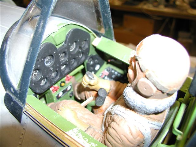

which pilot figure is that?
Old 05-21-2006 | 03:57 PM
  #1039
dionysusbacchus's Avatar
My Feedback: (25)
Joined: Dec 2002
Posts: 2,490
From: McQueeney, TX
Default RE: CMP Hellcat

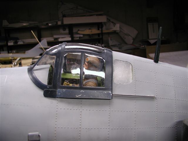

Don't know, Hal who did you say made that pilot? Here is another picture of Hal's Hellcat, pilot sure does look good! Can you tell it's a CMP? lol

I have had that little guy for many years and I don't remember who made them. I am sure they are no longer available.

The pilot looks like the IM piolots that Circuss Hobbies used to sell. They were light weight and easy to paint. I think they were 1/6 and 1/7 scale.

I know he's not 1/6 scale and he's even to small for 1/7. I would say he's right on 1/8 scale by the looks of him in my cockpit. Hal is going to send him to me so that I can make one for myself, so he'll be back from the dead in a way! I'm going to change a few things on him, like his big fluffy neck piece for instance. I'm going to pour a silicone mold and slush cast him in resin, so he'll be light.

I have a pilot in my ZOLLNER COCKPIT that I squeezed into my Customized H9 CORSAIR that I am selling(hint hint) ehehhe
It was an ACADIANA R/C Pilot from LOUISIANA...and it looks a lot like that pilot you have HalH...
It is vacuum formed plastic front and back pieces glued together..mine is 1/8 scale...Pretty cool little dude...
