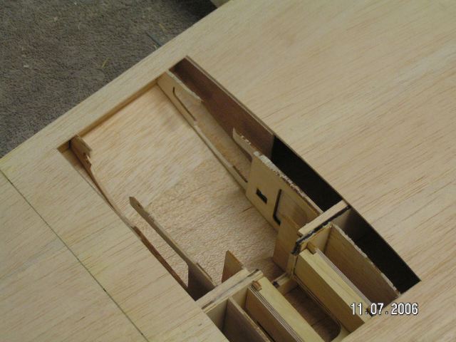

I didn't get to take a picture tonight. Glued my home made wheel wells in. I thought about to use a piece of graphite but ended up using a piece of hardwood 3/16x1/2 instead. Once epoxied in it will as strong as graphite. The rest is up to the retracts.

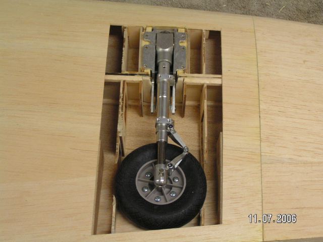

Here is my picture of the custom wheel well and the beefed up spar.

Looks good, if I can't find the carbon fiber I'm looking for I'll use some ply over a bigger area than the template I showed. I'm going with the open bay. I'll paint it green zinc chromate and use some carbon fiber mat in the bay.

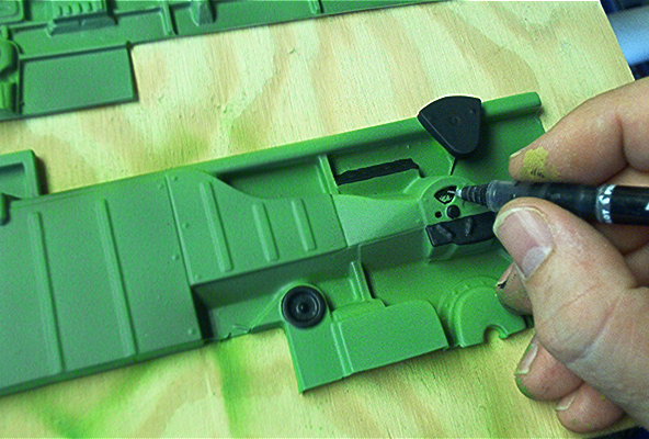

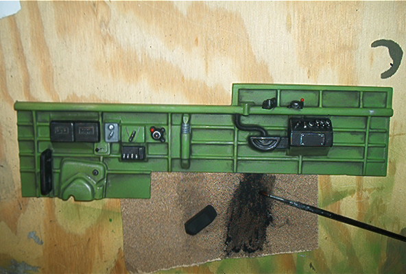

Remember that not all details need to be painted, you can use a fine tip felt marker to draw on small lines.
Here are some tips for cockpit painting. First one is you don't have to use paint! I use a silver pencil to add paint chips and weathering, even drawing on small gauges. If you don't like how it looks just wipe off and try again.
Use a fine felt tip pen to add the small details, like small slits for levers or small dark boxes and things. The parts will be clear coated, so the shine or durability is not an issue.
For shadows get some pastel chalk and rub it on some course sandpaper into a fine powder. Use a dry brush to add shadows to recessed areas or to give the appearance of dirt. Wipe off the excess if you get carried away.
These pictures are of my Black Widow Cockpit, but these techniques can be used on any cockpit obviously.
Again, congratulations on your work so far, looks great!

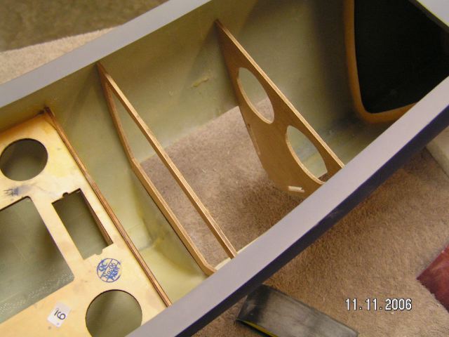

Hi Pappy,

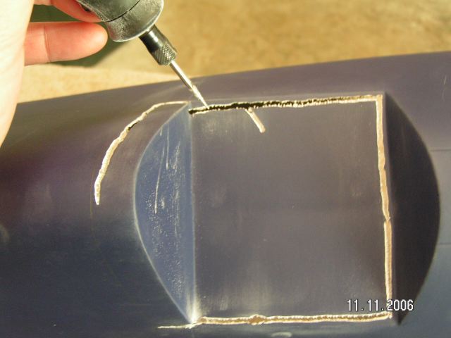

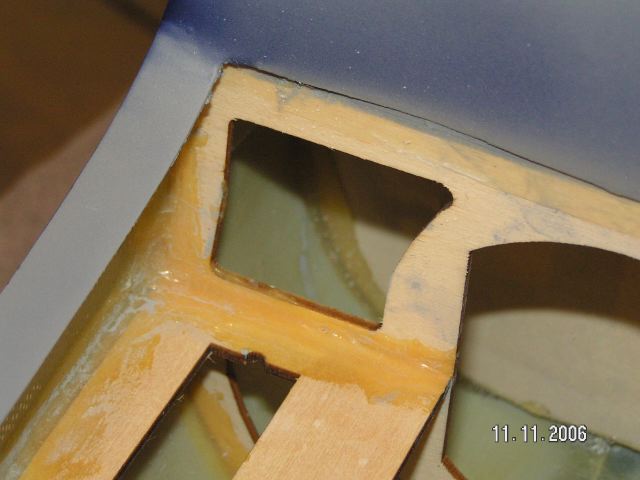

I was talking mostly about the getting the gages in the instrument panel to line up when gluing the panel to the bulkhead. It's my skill level that's the problem. It will be good enough for what you are going to be able to see with the canopy on. [:@]
I bought myself a couple of sharpie's the other day for just that use but didn't think of pencils, I also got some graphite chalk but haven't started that yet.
Do I want the gun site on now? Might it be in the way during installation?
Thanks for posting pictures of your work Bob, your interest has rekindled mine, thanks! I will cover the fuselage installation, no problem.
You've got to be the busiest guy in the world with all you do.
Do I want to install the F-1 and F-2 Formers before I cut the old floor out and extend the cockpit hole. If so, where do they go.. It seems like it would maybe support things more while you are cutting. Speaking of cutting, I'm thinking of an abrasive wheel on a dremel?
I must not have a handle on how this goes in yet, if you look at last picture you can see the formers aren't anywhere near level so they must not be where their supposed to be.

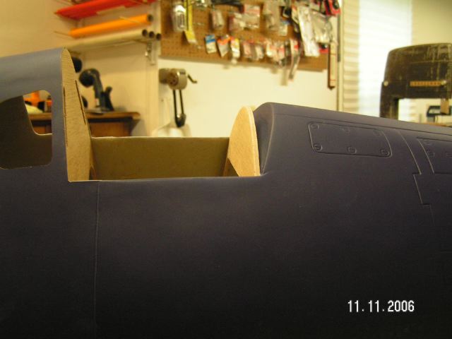

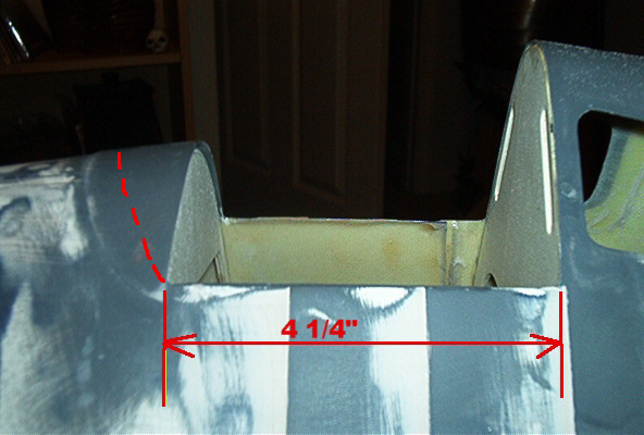

Bob,
Don't sweat the gauges, they will look fine and do the way you have them.
You must cut the cockpit out before you glue in the ply formers, the fuselage is plenty strong.
I have attached some pictures to help explain things. After you cut the cockpit in the fuse, you need to add some 1/32" ply or flight skin for the anti-glare shield, or dash if you are driving a car!
You have the formers in correctly, I set it up so the cockpit floor rests on the bottom of the rear former and on the top ledge of the front former, look at the pictures closely.
You can use the stock servo tray with the cockpit, I just had to raise the elevator servo 1/4" with some ply strips. You can clearly see them in the picture.
I see said the blind man! Thanks that helps.

The Formers come in template form with the cockpit kit, you have to cut them out of 1/8th ply. Are you using Luke's cockpit kit?

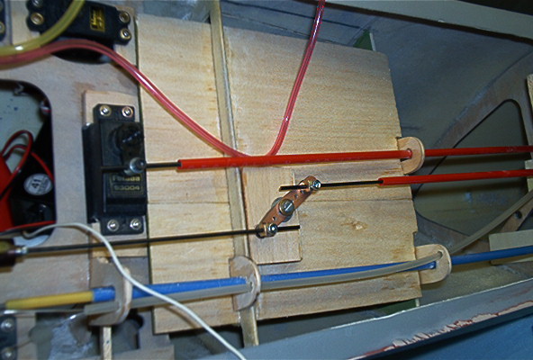

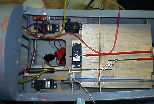

ORIGINAL: hookemut
Hi,
As a former Hellcat flyer on active Navy duty, I have followed your detailing with admiration! The more effort that goes into detailing, the more precious the model becomes.
That being said, and as an active RC modeler, I view with alarm some of your control set-ups! I have come to respect the wisdom of MURPHY the longer that I live. When you use Quick Connectors, especially on primary flight controls, you invite the screw becoming loose and control failure-'If a thing can happen, it will'- and how many times have I heard the post-crash wail 'But I CA'd the screws' This admonition is especially aimed at the users of gasoline engines which in general produce a higher vibration environment.
Z-bends on one end, metal clevis attachments for adjustment on the other.
respectfully,
hookem
Thanks for your compliments! A real Hellcat flyer! Wow! I hope I'm still flying RC at 85 years old! Good job!
Don't get your dandruff up to much about the quick link or whatever it is on my elevator pushrod (it came with the ARF), I used that early in the set up to just get everything in it's proper spot. That's one of the problems with showing work as you go, everything you do must be explained. Although I've not flown full scale Hellcats I've found that doing so would not really help you fly a model of one nor will it make you a better builder, so I have to rely on my experience. I've been working with balsa since about 1974. This is a 1/8 scale model and I've been using Z bends and metal clevises on 1/8 scale models since the 70's and I've never had one fail. Again thanks for your concern and good luck on your quest, whatever that may be...
Old 11-11-2006 | 03:17 PM
  #1299
Posts: 449
From: Arlington, TX
Default RE: CMP Hellcat
ORIGINAL: BlackSheep-1
[/quote]
Well, wrt to time building-I began in 1938 with rubber powered models, and RC with single tube Ace in 1957. I have assembled and flown the model that you are detailing, as well as numerous others. Time in the ' full scale Hellcats' sure doesn't hurt.
My 'quest', as you noted, is simply to help my fellow modelers. I was afraid that my suggestions would ruffle your feathers-not my intent.
hookem
It seems that's about all most of the hardware that comes with it is worth. Personally I like the E/Z link Great Planes has, they're much easier than z bends and as long as you install them right they're great. 60 size is the largest I've done though...
I was dreading the cutting of the Fuse but it wasn't bad. I got out my trusty iPod/ear muffs/safety glasses and dremel.
First I cut a rough outline, then with a cylindrical diamond bit, got as close as I could to the line. A little sanding and presto. Well, I thought it turned out pretty good.
The front former seems a little low but it matches the template. Seems about perfect for a 1/8th balsa "dashboard"
While I was inside messing around I noticed the firewall had a lot of epoxy on one side and none (that I could see) on the other. I will definitely add some!
Thanks Pappy
Bob
