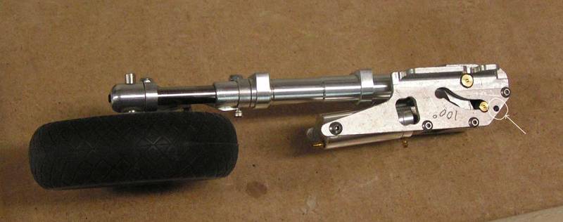

For anyone who has used the Sierra retracts, can you tell me if this is a missing screw or not. (see pictures) Both retracts have these threaded holes on both side with no screw in it...

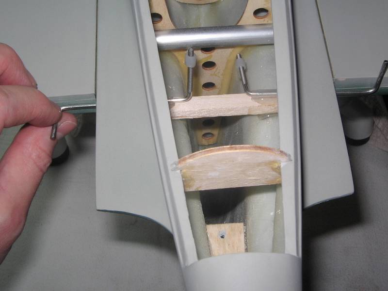

I'm not sure if the CMP Hellcat is constructed similarly to their Zero which I am building, but I had concerns on how the separate elevator halves were to be installed. On the Zero, the horizontal stabs attach to the fuse very securely with two aluminum tubes which connect one half through the fuse and into the other stab half. However, the actual elevator halves are totally separate (not joined together) and attach to the H. stab with 3 CA hinges. The elevator control rods just "float" in a small hole drilled through each side of the fuse and are then glued into each elevator half. I was worried that this did not have any support other than the small fuselage hole to pivot on, and would put undue stress on the elevator hinges. So I glued a small balsa stick inside the fuse across from each of the elevator pivot holes and then used two torque rod type setups with the rods in short plastic tubes to support and pivot the entire elevator assembly. (Similar to how aileron torque rods would be installed in a wing.) I also decided to use separate servos and carbon fiber rods to control each elevator half, as opposed to the single servo and wooden dowel "Y" rod setup described in the manual. I'm sure I am adding some unwanted weight to the tail with the brace and torque rods, but I feel these changes are much improved over the existing setups. I'm still completing the retracts and engine install, so I can't comment on how well this helps the actual flight characteristics.
If the construction on their Hellcat is similar I would think that this type of modification would greatly improve the rigidity of the elevators. See attached pics of the original manual and my modifications.

I really like your idea for setting up your elevator on your Zero. I just think that you should of used hardwood for the supports though. I am going to copy your setup for another airplane but not use balsa for the supports. The "torque rod" approach for the tail section is fantastic when there is enough room or you install an access hatch.

One word of caution regarding my setup shown in the last pic. I ended up replacing the ball links that were attached to the elevator ends of my setup. I found that they wanted to make the horns on the elevator torque rods turn on the threads since they essentially push/pull on the side of the horn. Once the horn turned on the threads, it resulted in an offset in the elevator halves. (Not a good thing!) I ended up replacing them with standard clevis' which will not allow them to turn on the threads since the pin of the clevis prevents it from rotating. I left the ball links on the servo end, but have the regular clevis on the elevator end and it seems to work fine now with no tendency to rotate on the threaded torque rods.
I don't have a pic of the replaced ends, but they are just regular 4-40 clevis.
Johnny,
Your probably right regarding the hardwood support as opposed to the balsa I used. I know on the Zero with it's very short nose that it tends to result in a very tail heavy condition, so I wanted to limit the amount of weight I was adding to the tail section. I figure there is still enough strength in the balsa stick to adequately support the torque rods. It just gives them a surface to mount to and allow even push/pull on the rods.
