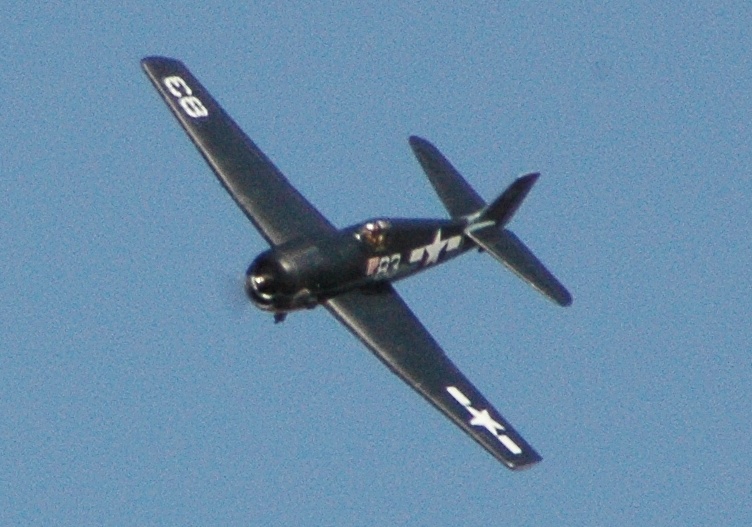

Good luck with your Hellcat. I was getting some elevator flutter in a dive with the stock linkage. I used a stronger rod (arrow shaft) and 4-40 rods on both ends and it cured the problem. You may want to make sure your elevator linkage is tight if your expecting to use a good size motor and power dive her. (I have a Saito 1.20 in mine).

Very Cool inflight picture!!!
As for pushrods... you cant beat CF and titanium..... http://www.centralhobbies.com/contro...e/pushrod.html
