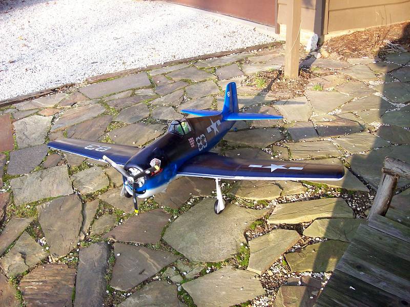

I am putting the finishing touches to mine, Saito 1.20 , glassed wings and tail surfaces, Robart retracts. I strengthened the tail and the fuse with expandable foam. You have to be careful though that you don't get too much in the tail (if you do you can drill some relief holes.) I bought several item from Dion . I still need to mount the belly tank and replace the retracts to robarts. I also just have the gear doors taped on for these pictures and i accidently have them on the outside.

Looks great! What did you paint yours with? Type or brand anyway. I'm glassing mine right now, well the wings and tail anyway. I'm thinking of making mine E-powered with A-123 cells. I picked up some nice retracts from a guy on e-bay. They are century jet but with aftermarket scale struts. They look very nice. I'll post a pic of them soon. However the struts dont go into the wing far enough to have very scale doors so I'll have to work on that.
I'm debating on the retractable tailwheel. I need to see what I'd have for mounting options. But I'd hate to do all this work to the rest of it to have the tail wheel look like crap.

gnir , is that a H9 or a CMP ??? THe gear looks like stock H9 and so do the windows and cowl ?? Looks better then the CMP
You can see the molded panel lines on the fuse. Would be very hard to get that out of a Hanger 9 Hellcat. The CMP Hellcat can be made to look much better then the Hangar 9 one if you put some time into it. Working on mine this weekend trying to get the wings glassed and sanded smooth. Lot's of sanding to do.

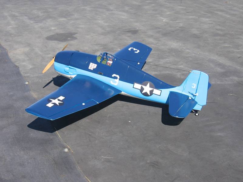

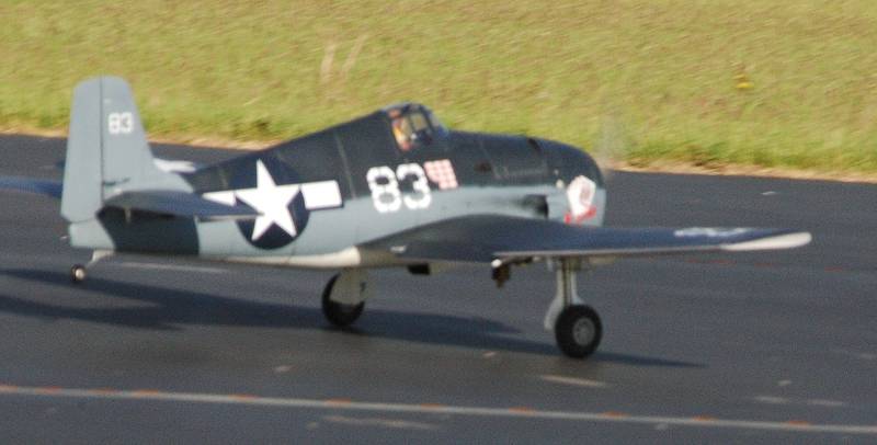

Here is a picture of my CMP Hellcat. It's powered by a Saito 120 with Serria retracts. It's a great flying warbird.

It's the CMP version. The Canopy is not stock and I tried to go cheap and bought the Hanger 9 retracts (good observation) I am in the process of changing the retracts to Robart (might be a little better) I added more panel lines to the fuse and also added panel lines to the wings using chart tape and painting over the tape with a couple coats of primer. I also added rivet details to the entire plane and even though it's sport scale I'm real happy with the added scale details. I was going to spray with enamel paint but I changed my mind and went with Tamiya paint, what a great product , no clean up and the qualty of the spray cans is very good.

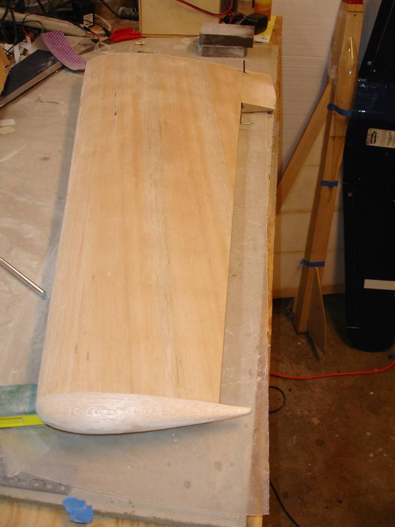

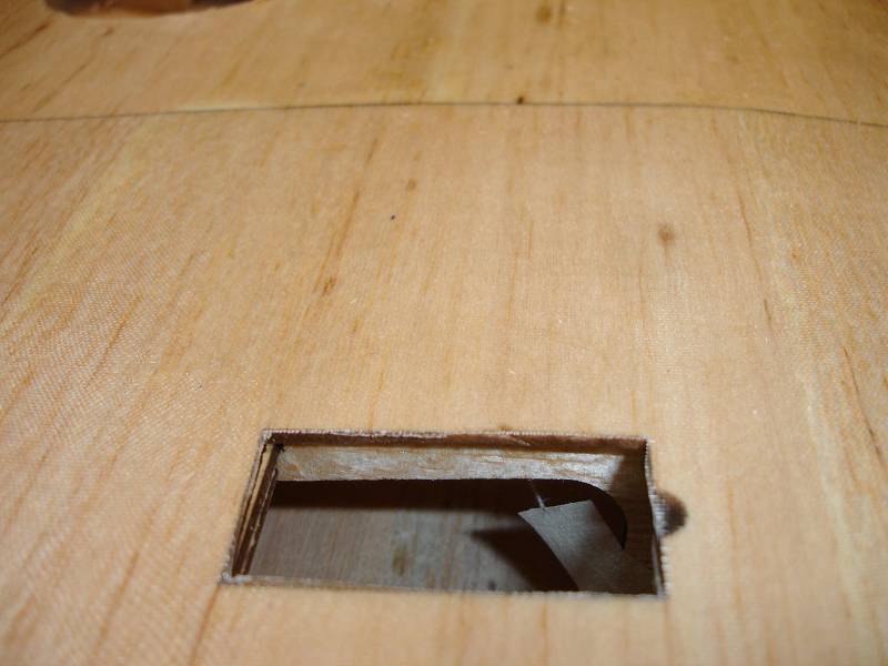

Here are the pics of my wing glassing in progress. It's a bit cold in my shop and I think I need to thin out the Zpoxy on the second coats so it smooths out more.

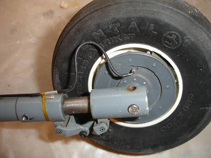

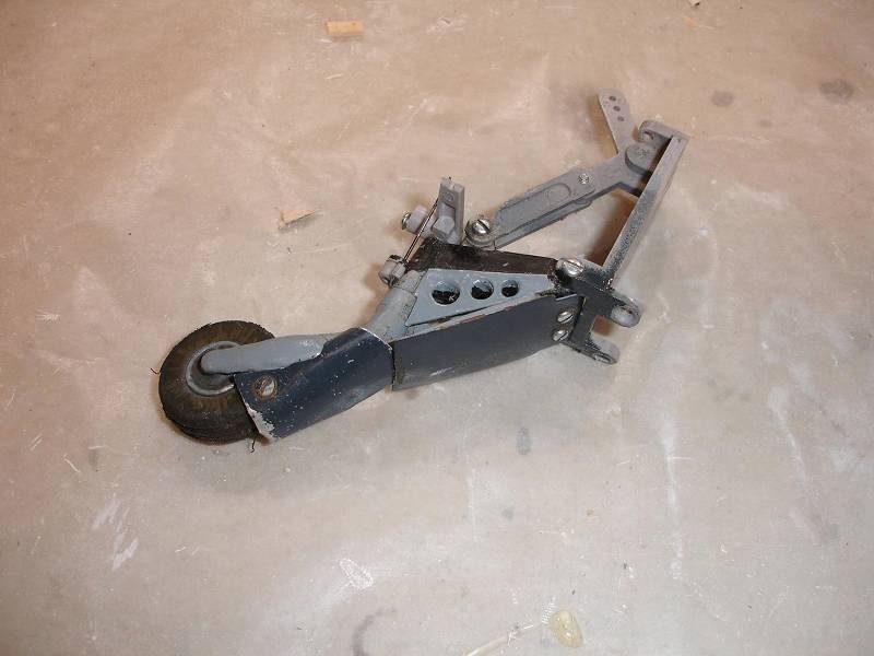

Here are some pics of my retracts that will be going in the plane. I picked them up from a guy who had them in a Top Gun scale Hellcat. They look great and I hope and can make the rest of the plane do these retracts some justice. I have not built the rails for mounting them to just yet. I also have to work the running of the airlines. One of the inlets to the cylinder is right into the ply wall of the retract housing in front of the spar. The tail wheel I still need to decide on. It looks great and would be a great compliment to the plane but I have to see how well it will fit and mount without tearing too much into the plane.
Steve
You should never add a second coat of resin if you want to build a light plane, it's completely unnecessary and a lot of extra work.
See page 29 post #711 for the lightest and easiest epoxy resin system I know of: [link=http://www.rcuniverse.com/forum/m_2530290/mpage_29/key_/tm.htm]Click Here for the lightest finishing system![/link]
