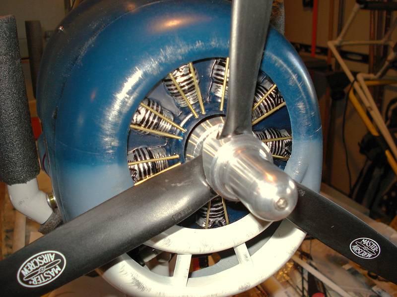

IS THIS FRED QUINN??---THIS IS ED SARK---HUSTELLING ON MY RCU FACT GATHERING MISSION FOR TH CMP HELLCAT AND ZERO(1.20 SIZE). I AM GETTING THE OS 1.20-----FROM LINDA AT HOB HUT------THX FORTHE HEADS UP, FRED. AND FOR THE PHONE HELPPP----ED "SARK"

What dummy engine is that, and the prop hub??? Thanx---Ed Sarkisian

Here is my finished dummy radial from www.darehobby.com. Only $4.50, but you have to paint it.
